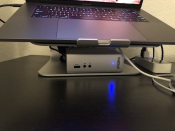

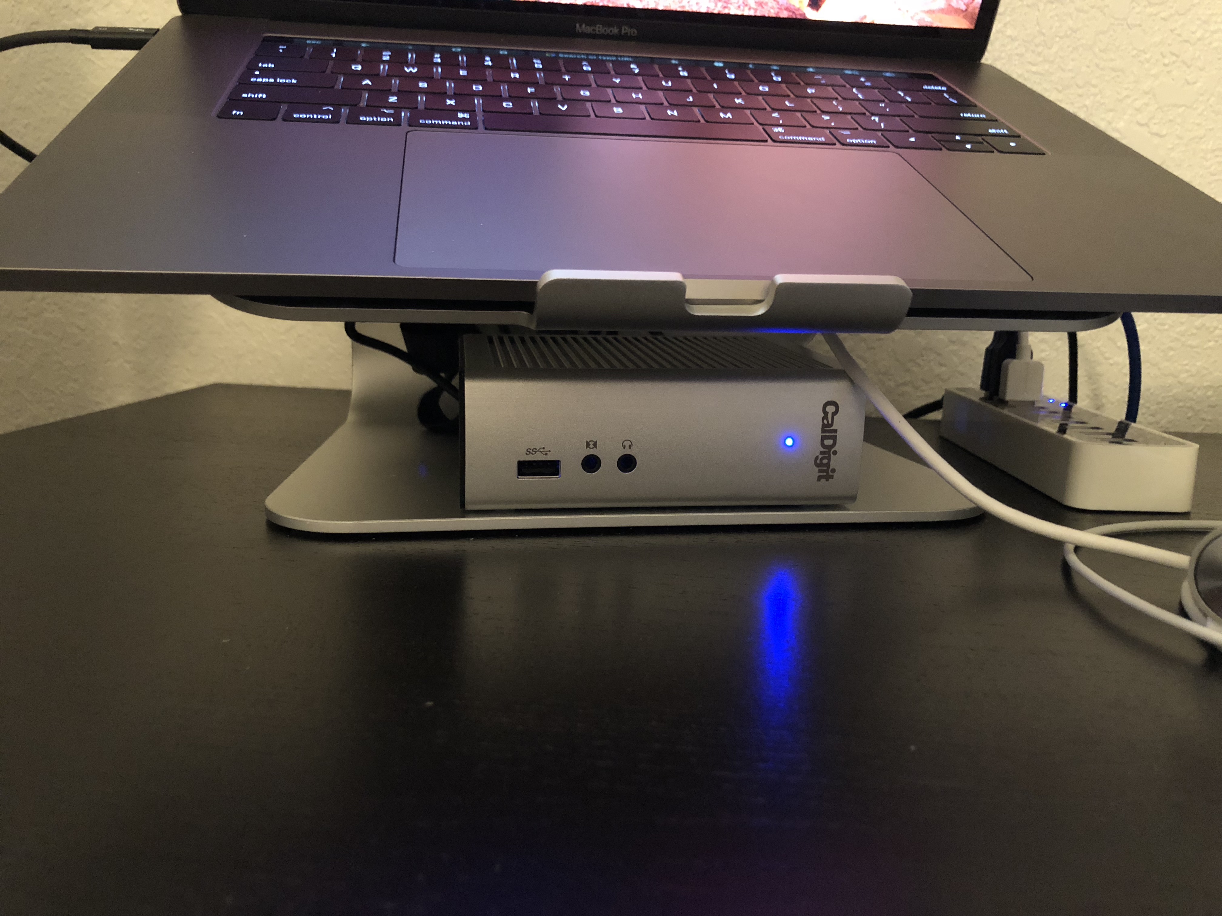

Caldigit TS3 is the best one I have found. I had the Elgato TB3 Dock before this and it had issues charging my laptop when under load. And their support was terrible. The TS3 has no issues under heavy load keeping it charged at 100%, and I got my 34" Ultrawide hooked up, with Ethernet, headphones, and all my USB devices with no issues. It is definitely worth the price.

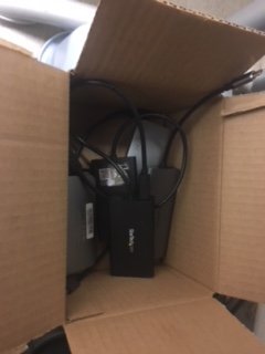

I manage 60ish MBPs for an architecture firm. We have about a dozen touchbar MBPs in circulation. We need two external displays, ethernet, usb.
In one port I put a basic HTMI+USB; those are usually ok. In another I've been through several brands (OWC, Satachi, Lenton, Startech) and, so far, none are close to what I'd call "reliable." Some needed to go back immediately, some work for a while then stop, some work intermittently. Some worked for long enough that I can't send them back now and are sitting in a box under my desk. Colossal waste of money.
Currently testing something called "Choetech" on my own machine and for the past couple weeks have been fine. Of course, I tried for order more from Amazon and now they don't exist. I ordered direct form the company in China and still waiting for shipping (if they didn't somehow abscond with my PayPal account).
It infuriates me to have to spend $100 per $3k+ machine, plus hours of my time, just to try to make it functional in a real working environment.
