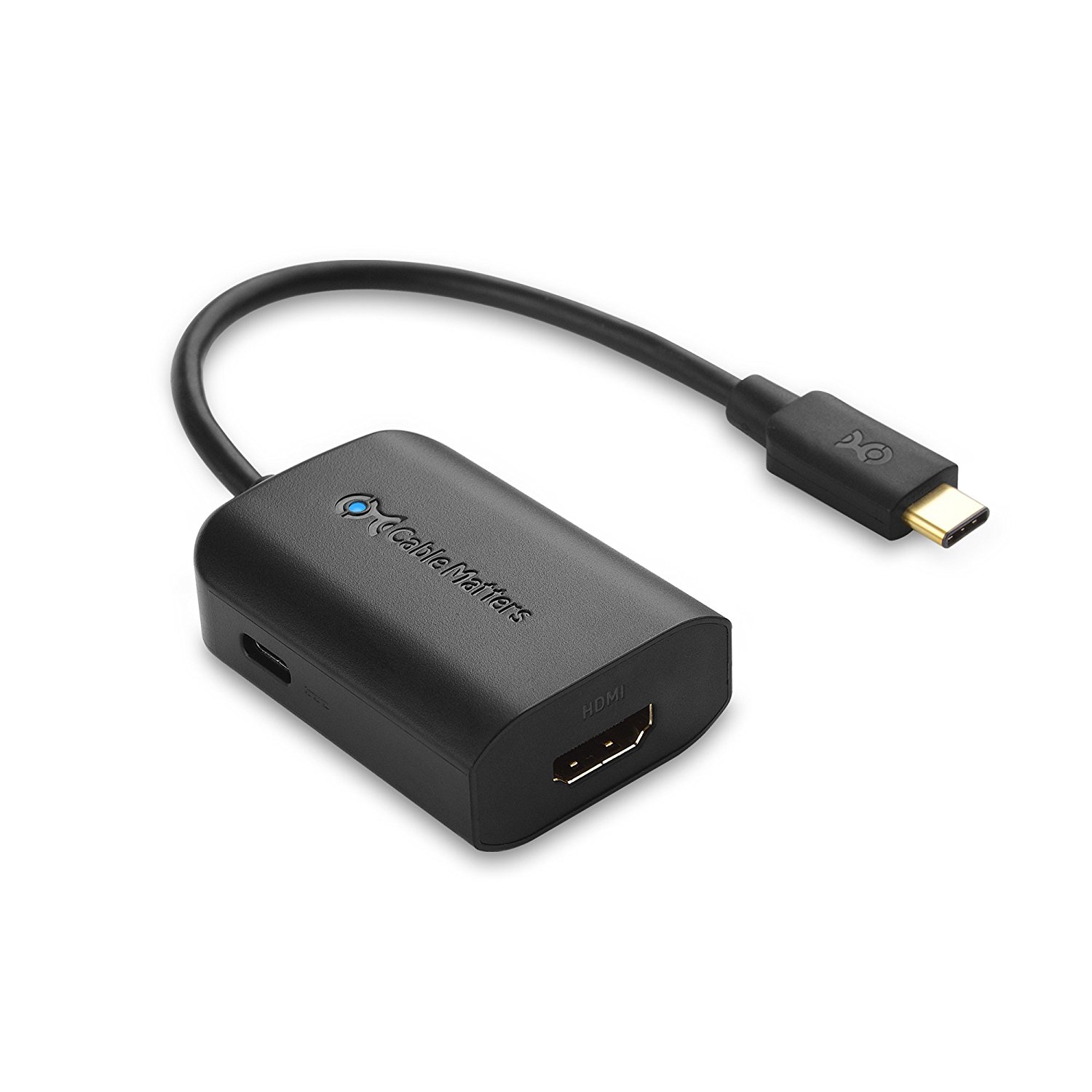

I've decided for my 12" MacBook, I don't like those all-in-on adapters with HDMI and USB and other stuff. For USB-A I use a simple adapter that I carry on my keychain, and for HDMI, I bought a separate 4K 60 Hz adapter that also has a charging port. The adapter is much smaller, and doesn't get hot. I don't need the charging port to run HDMI, but it allows me to charge the MacBook at the same time.
The one I bought is from Cable Matters (via Amazon):
http://www.cablematters.com/pc-893-...sung-galaxy-s8-thunderbolt-3-compatible.aspx#
Works great with my 2017 Core m3 12" MacBook. Apparently some adapters don't like the 2017 models, but this one works perfectly.

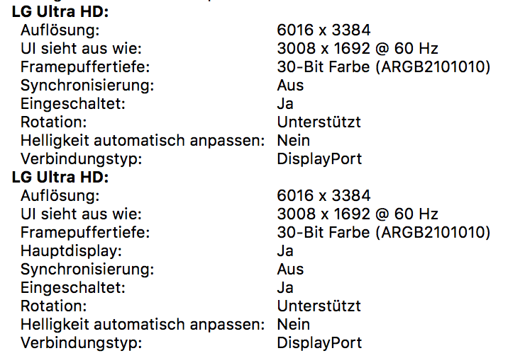

I got the Caldigit now. It is a 100% better than the Elgato. The screens turn on immediately. Even from sleep. I did not have any issues with it so far.
Check display resolution on the display itself (on Dells its on the bottom of OSD menu on one of its pages). It might be less than 4K@60Hz. If it's 4K@60Hz then your Dell model is not affected, congratulations.
Other than that yes, CalDigit is amazing.
Best thing is: I don't own a Dell =) I own two LG
