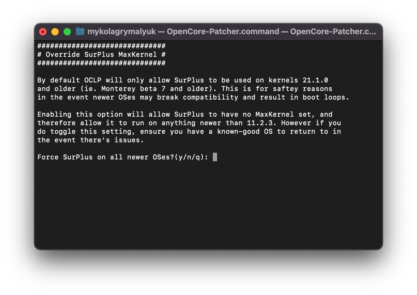

@Syncretic Amazing work with the research, documentation and patch sets! I updated OpenCore Legacy Patcher to support the SurPlus patchset, this will land in 0.3.0's release or can be grabbed via our nightly links right now. Additionally there's a setting in the Patcher to remove the MaxKernel limit for those who want to experiment in newer OSes:

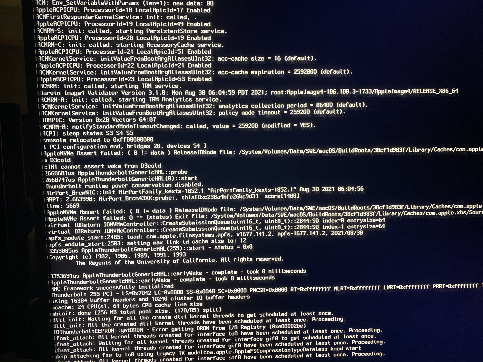

I wasn't fortunate to get my 11.6 5,1 working with this.
I rebooted warm, rebooted cold and also did 5 PRAM resets and still won't boot.
Clearly I didn't put it in the correct place. I added the latest to the same place that latebloom was added but at the end of the kernel section.
Here's what I captured on boot.
EDIT: I confirmed that I didn't put it in the correct place. I don't have time right now to go back and fix it, but will before the end of the day and confirm booting or not then
