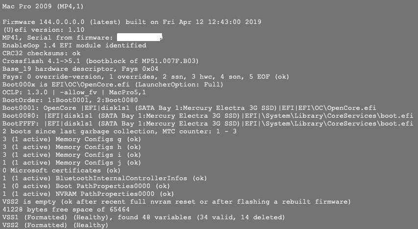

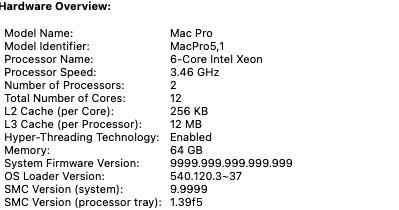

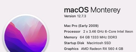

I was asked to post in here by MacSoundSolutions... I installed OCLP and Mac OS 12.7.3... no boot screen - monitor says something like "input not recognized" and then about a half second before the login screen appears I will see the black screen with white apple logo. I followed the instructions to install enableGOP and seem to have successfully done so, however there are no changes. Computer works fine, just no boot screen. Prior to 12.7.3 I had 10.14.6 installed and instead of "input not recognized" the monitor just acted like the computer wasn't on yet.

Close, but missed. Thats the thread: https://forums.macrumors.com/thread...pport-for-efi-era-imacs-and-mac-pros.2378942/
