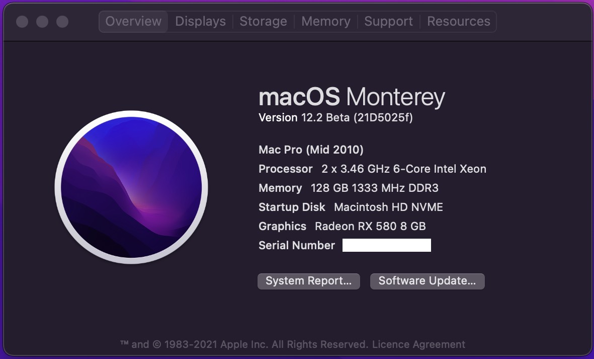

Edit: 12.2 beta 1 (21D5025f) installed with no problems at all, this was using the regular update feature in macOS. I'm just using the Martin Lo 0.7.5 package.

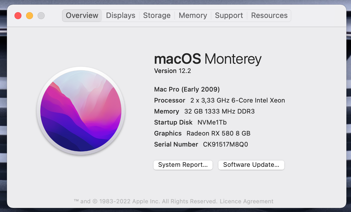

12.1 works like magic, 11.6.2 sadly not, but who cares about Big Sur when we have Monterey working.

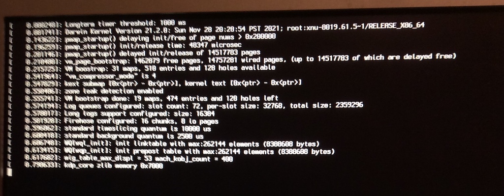

It appears to be a simple patch that just sets the default value of disable_serial_output to 1, the same value that is used for the default value of the DEBUG kernel.
https://github.com/apple-oss-distri...a151b24afbff733/pexpert/i386/pe_kprintf.c#L62
This has the effect of beginning kprintf output earlier. I see these additional lines in the kprintf output before the usual set of lines begin being output:

The usual set of lines (first ≈200 of them) that occur with or without the patch:
Code:
kprintf initialized
Serial mode specified: 00000003
version_variant = 0
version         = Darwin Kernel Version 21.2.0: Sun Nov 28 20:28:54 PST 2021; root:xnu-8019.61.5~1/RELEASE_X86_64
KASLR slide: 0x000000000dc00000 dynamic
Hiding local relocations
WARNING: ignoring first page in [0x0:0x8e]
Physical memory 63488 MB
avail_remaining = 0xf7f7bc
Kernel virtual space from 0xffffff8000000000 to 0xffffffffffffefff.
Available physical space from 0x128f9000 to 0xfffce4000
initialize_screen: b=80020000, w=00000A00, h=00000640, r=00004000, d=00000001
pmap_startup() delaying init/free of page nums > 0x200000
pmap_startup() init/release time: 48347 microsec
pmap_startup() delayed init/release of 14517783 pages
vm_page_bootstrap: 1462879 free pages, 14757281 wired pages, (up to 14517783 of which are delayed free)

The lines that appear in the graphical console appear to be the same as usual. They are a subset of the lines output to the serial port:
Without kprintf output enabled in the boot-args, no serial port output would occur and the graphical console would continue from the point you see above to show console messages until macOS boots.
