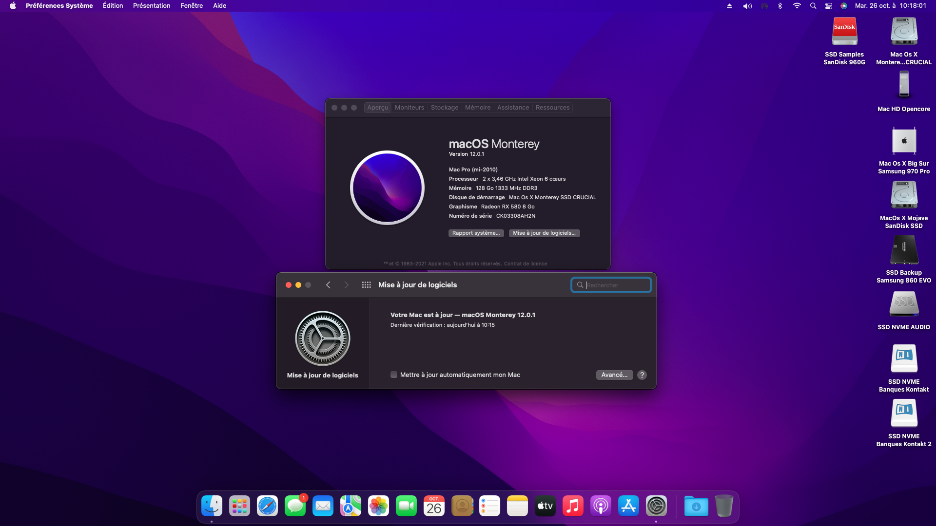

I run Big Sur 11.6.1 and tried The New Monterey working great on My Mac Pro 2010 !!!

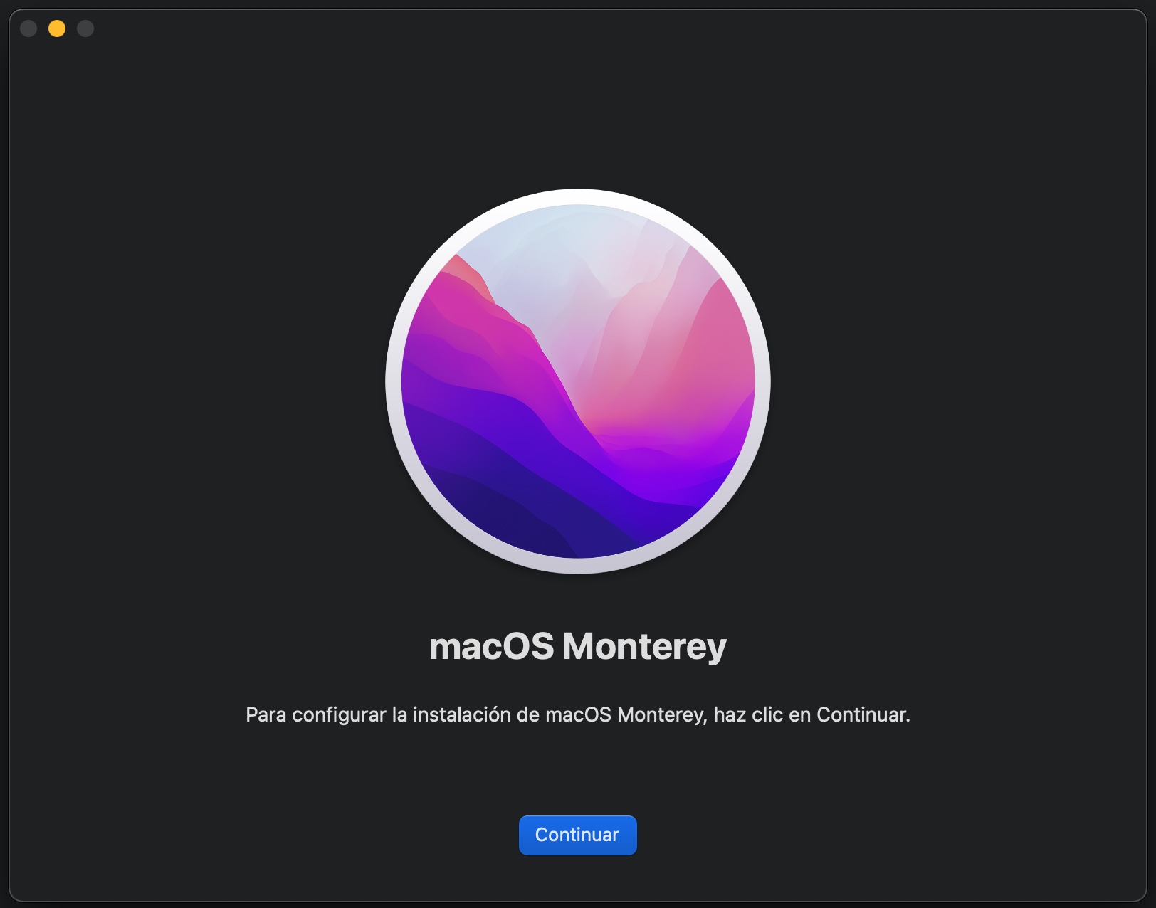

I try to update to Monterey from 11.6.1, but don't install... don't throw any error...
I run the Monterey installer (from system update) and seems working, but when reset 3 times (one of them I can see how many minutes left), BigSur again...

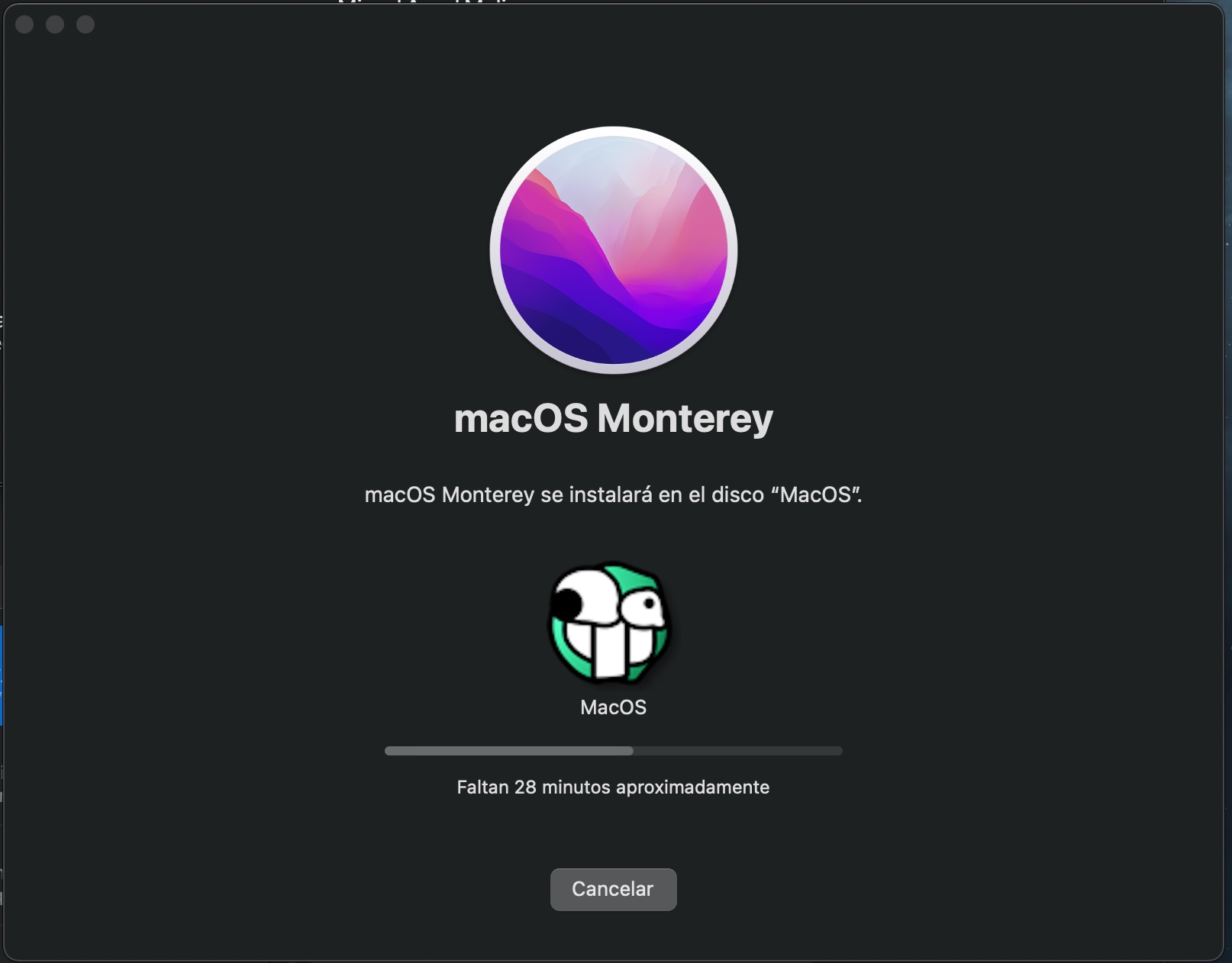

This is the third try...

Similarly I've tried 3 times and it boots back into Big Sur - very strange indeed. I tried installing 11.6.1, unplugging my Time Machine disk and retrying but to no avail :-(

Yeah, that’s what it does. I tried again and did the trick I used above for getting 11.6.1 to work. Same result - restarts without completion. It’s too late tonight to do more. I’ll try tomorrow and thanks Kevin for the attachment. I think I know what’s happening but no time left to verify today.
There are two Macintosh HDs that display on the boot picker with the first selected for first boot moving to the second on the next reboot.
I tried manually switching to the first with no result
I tried resetting the NVRAM and reinstalling for the 5th or 6th time with no result
...it would be interesting to hear if anyone else is experiencing this problem - I'd rather not have to install from scratch if this is where I'm leading.

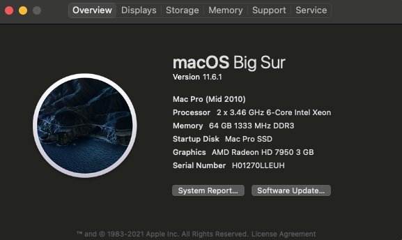

I updated my 2010 cMP from 10.14 to 11.6.1 with the help of SurPlus. No issues so far.
