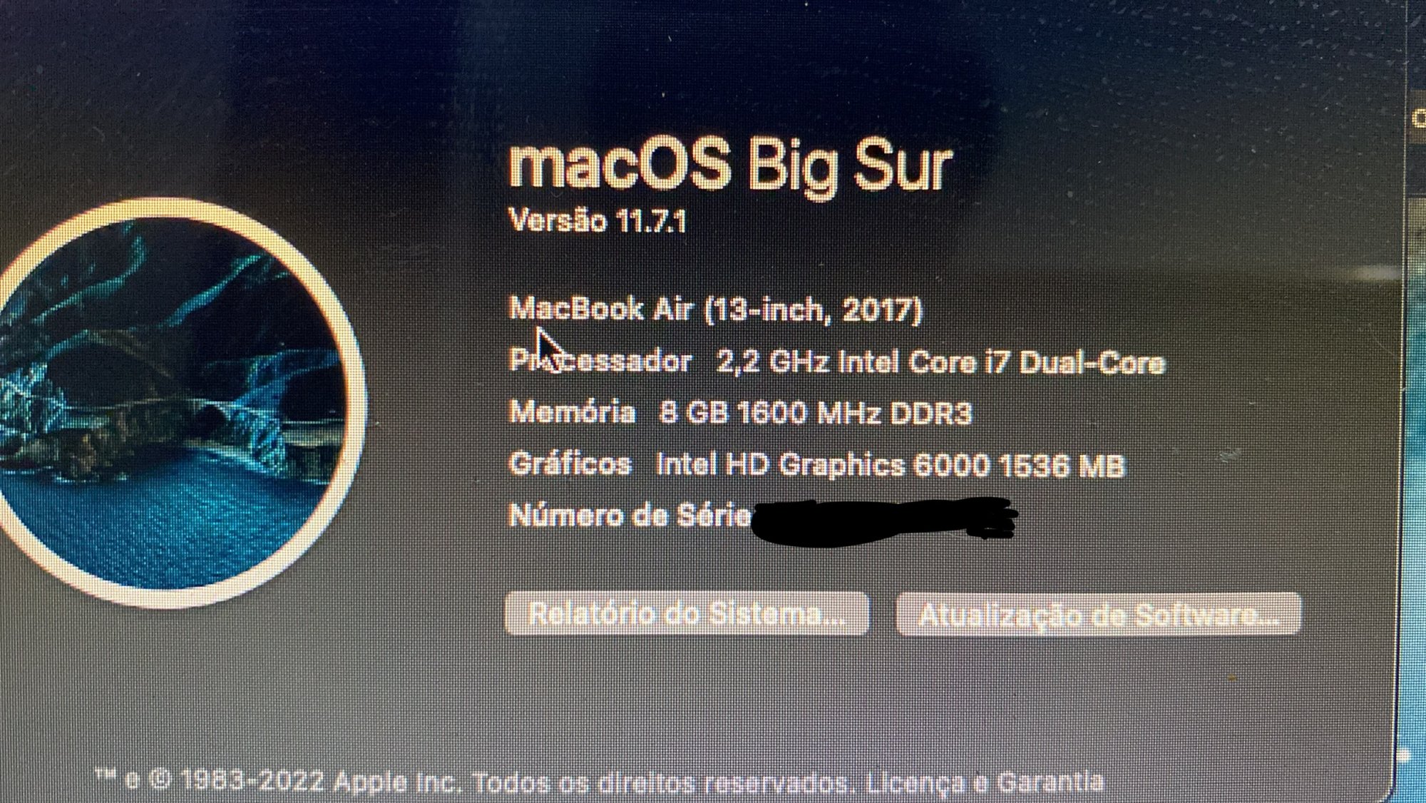

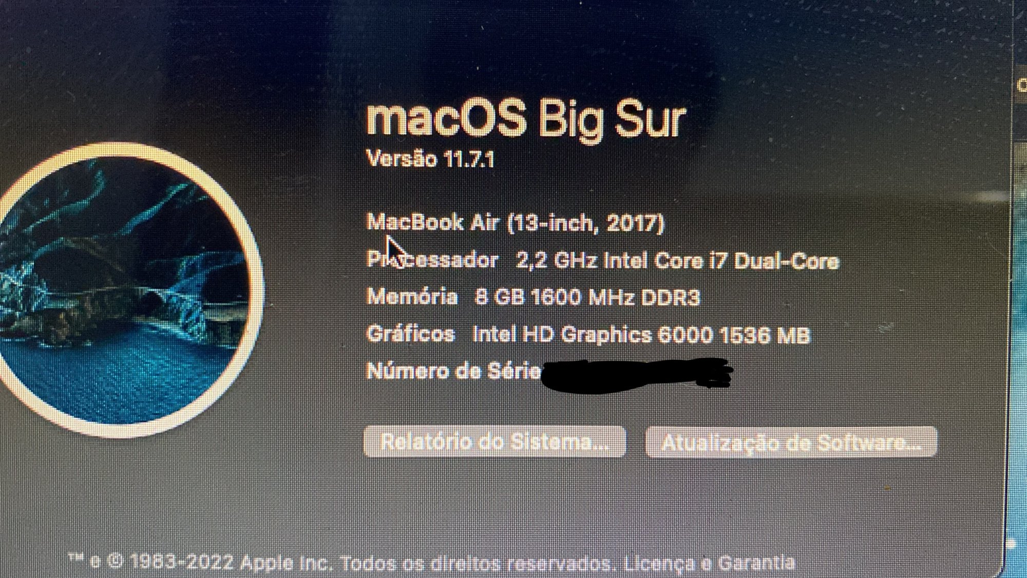

I just swap my 2013 i5 1.4ghz 4GB ram to a 2017 i7 2.2ghz 8gb ram logic board and everything went well. Thanks guys
