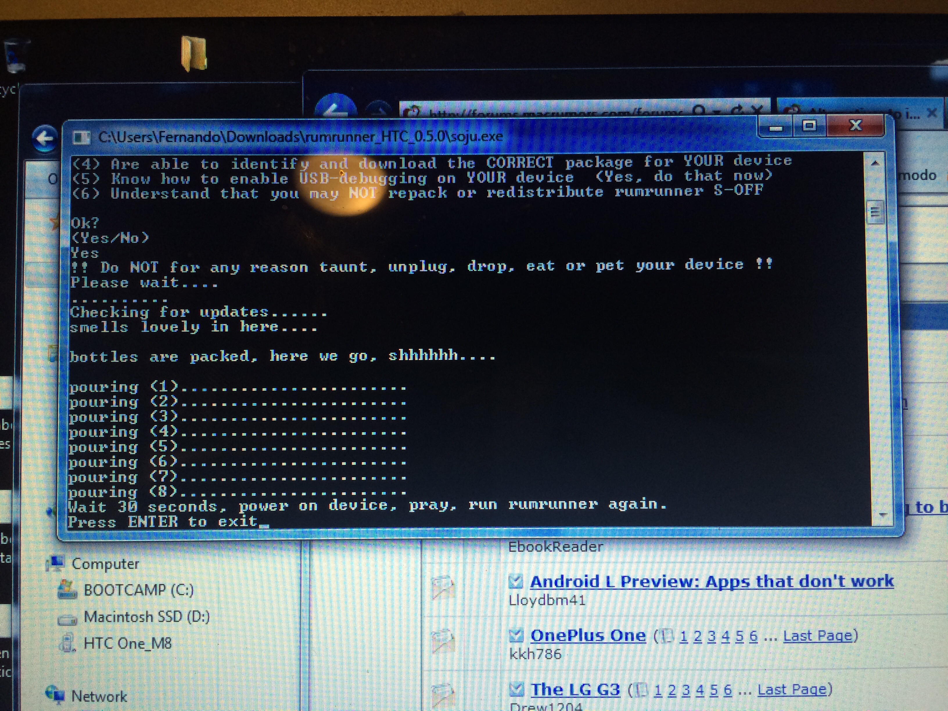

Just tried rum runner and same thing. Going to try flashing a different rom to see if that will work.

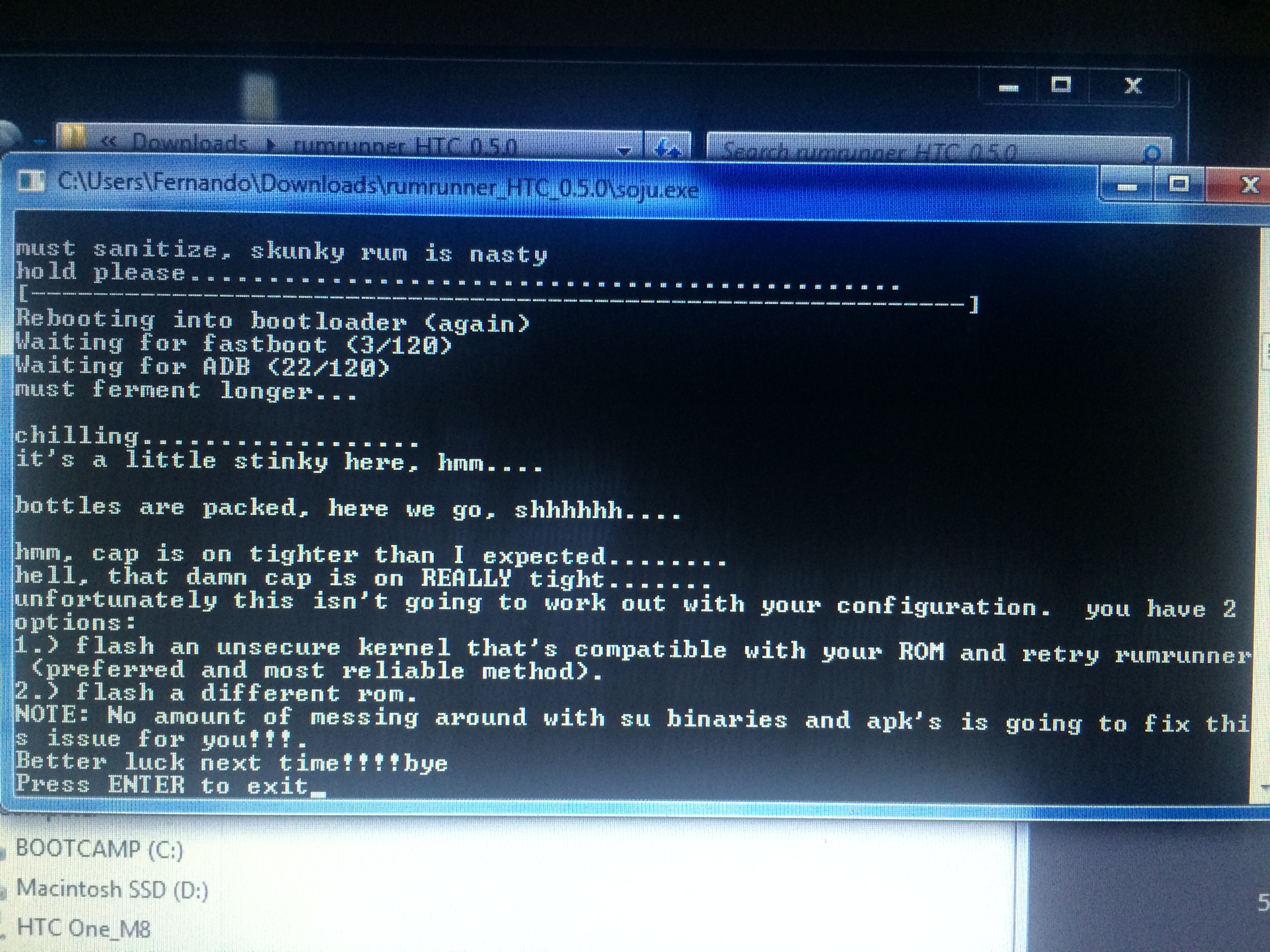

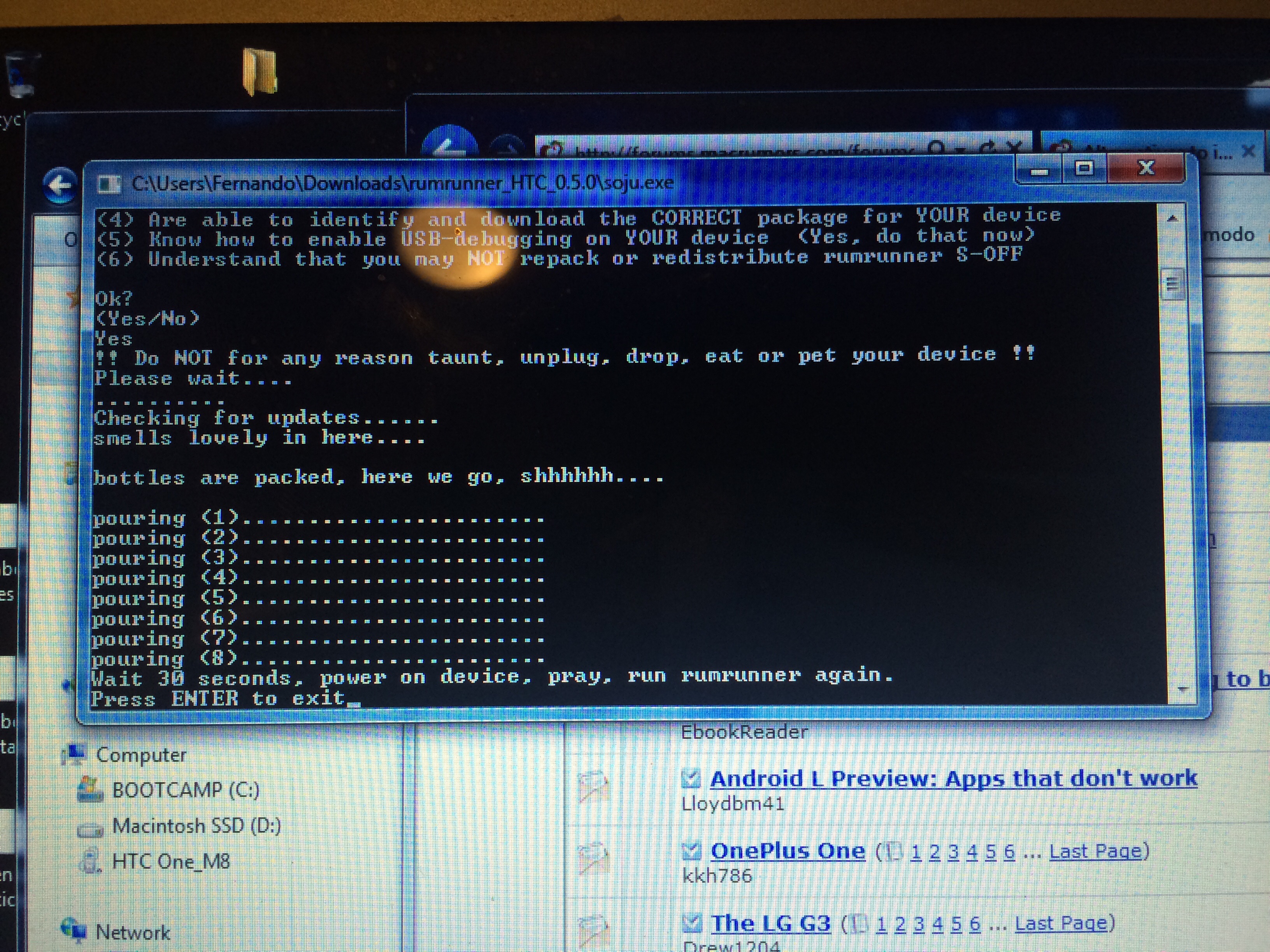

Well, tried with the insertcoin rom and everthing seemed to work fine, but alas still no s-off, rum runner tells me to power on my device, which is weird since it's on and to run it again, which I've done 3 times now and each time it gives me the same message and no s-off.
And firewater gave me the same message as before.

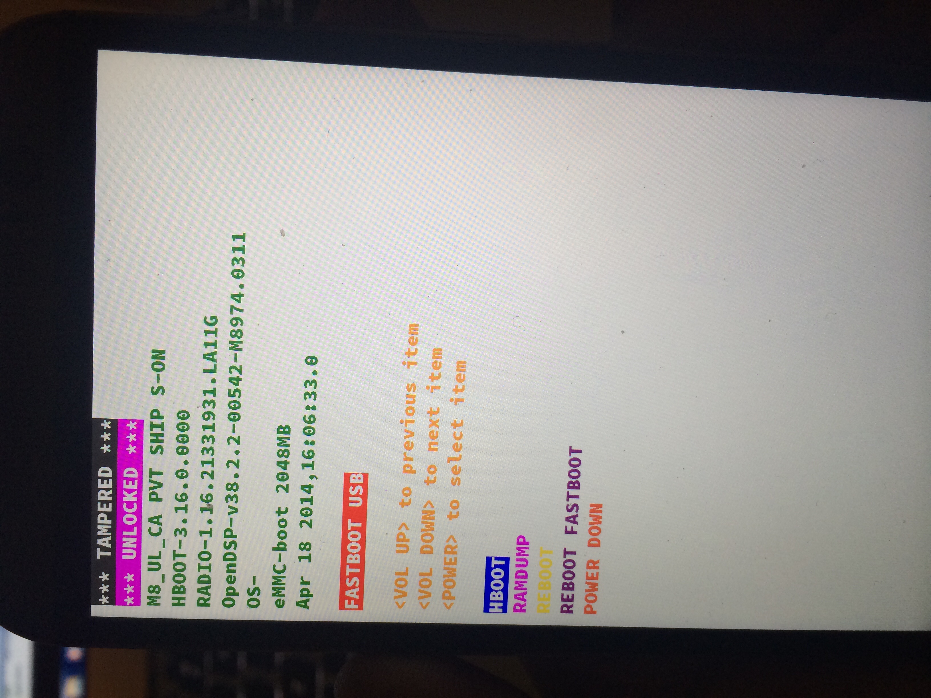

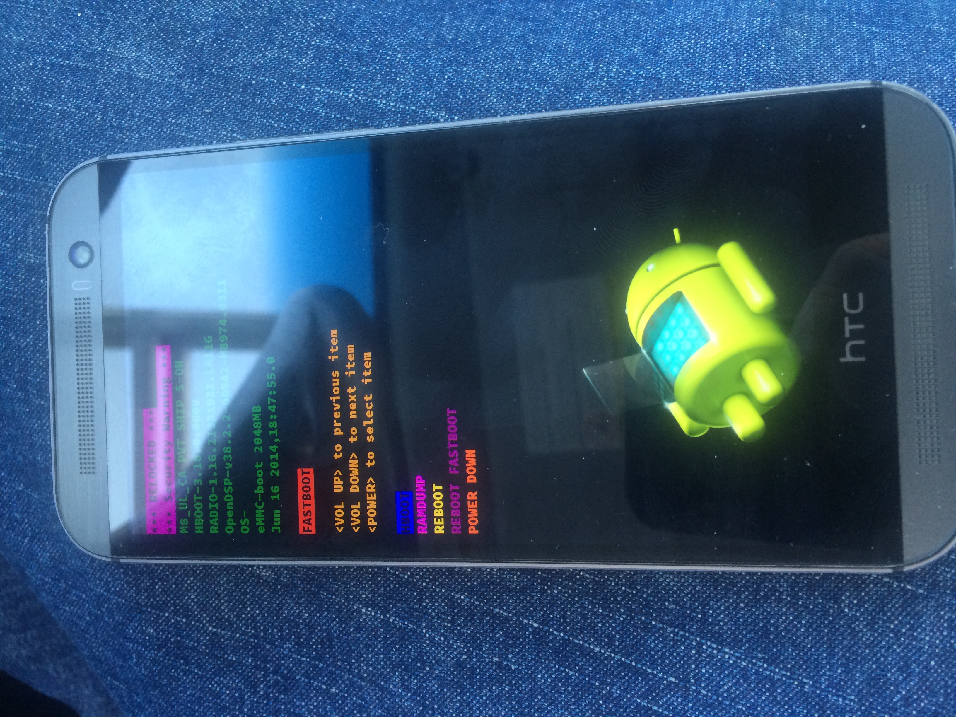

I wonder if my hboot has anything to do with it? It says it's version 3.16 while in xda I've seen comments about it suppose to being on 1.56?
I just checked mine and it say the same as yours. My hboot is 3.16 as well. This is turning out to be quite the PITA huh?

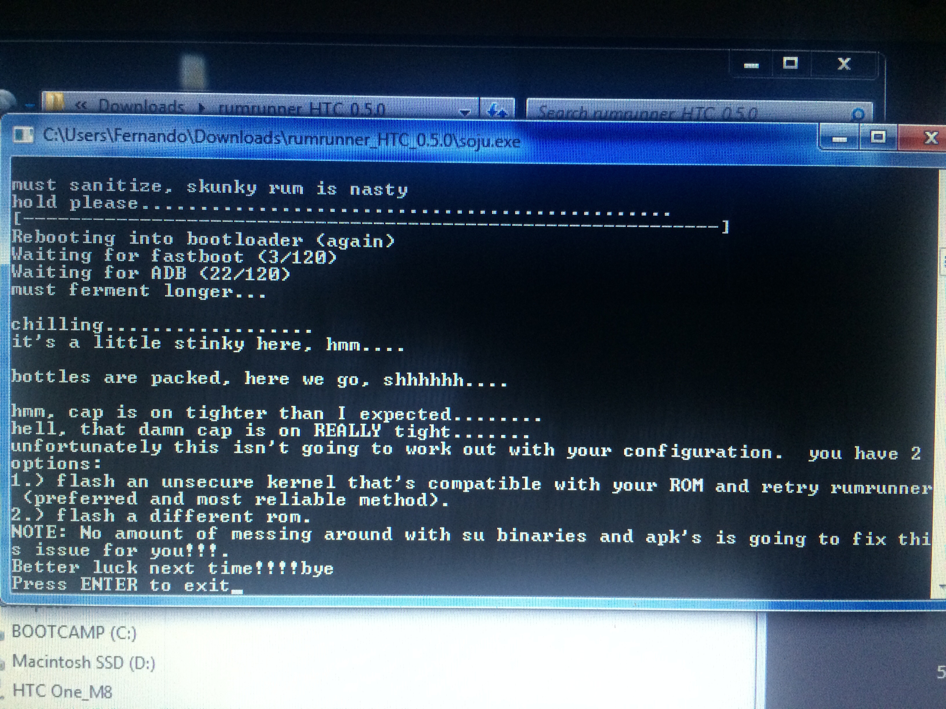

Well, I had some time so I tried moonshine, still didn't work but at least I saw where it got hung up. Seems adb failed when it rebooted to the boot loader. Not sure if that's where the others had trouble too or not, since they just showed a progress bar.
I did try an adv command while in the boot loader and adv gave me a message that adb was outdated. Not sure if that's referring to my phone or what was loaded on my computer. Will have more time tonight to tinker some more.

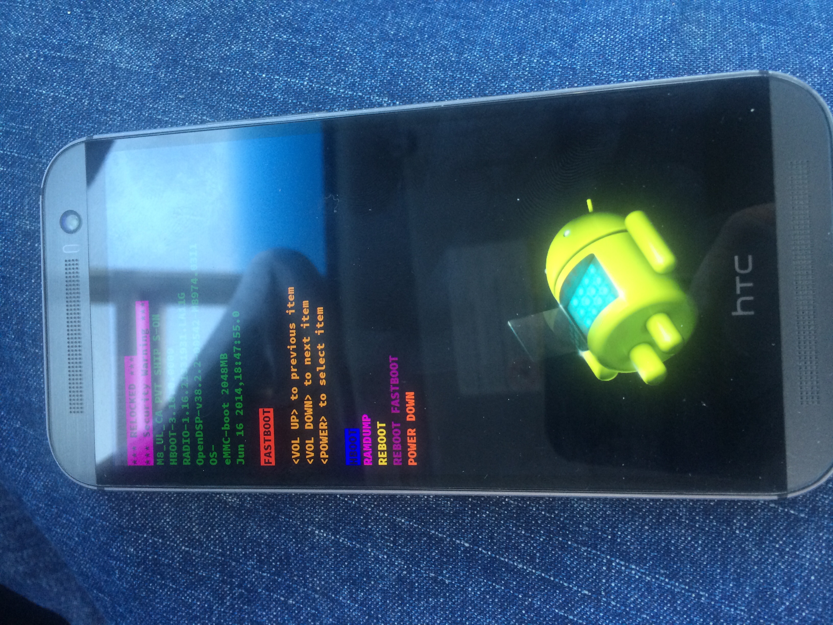

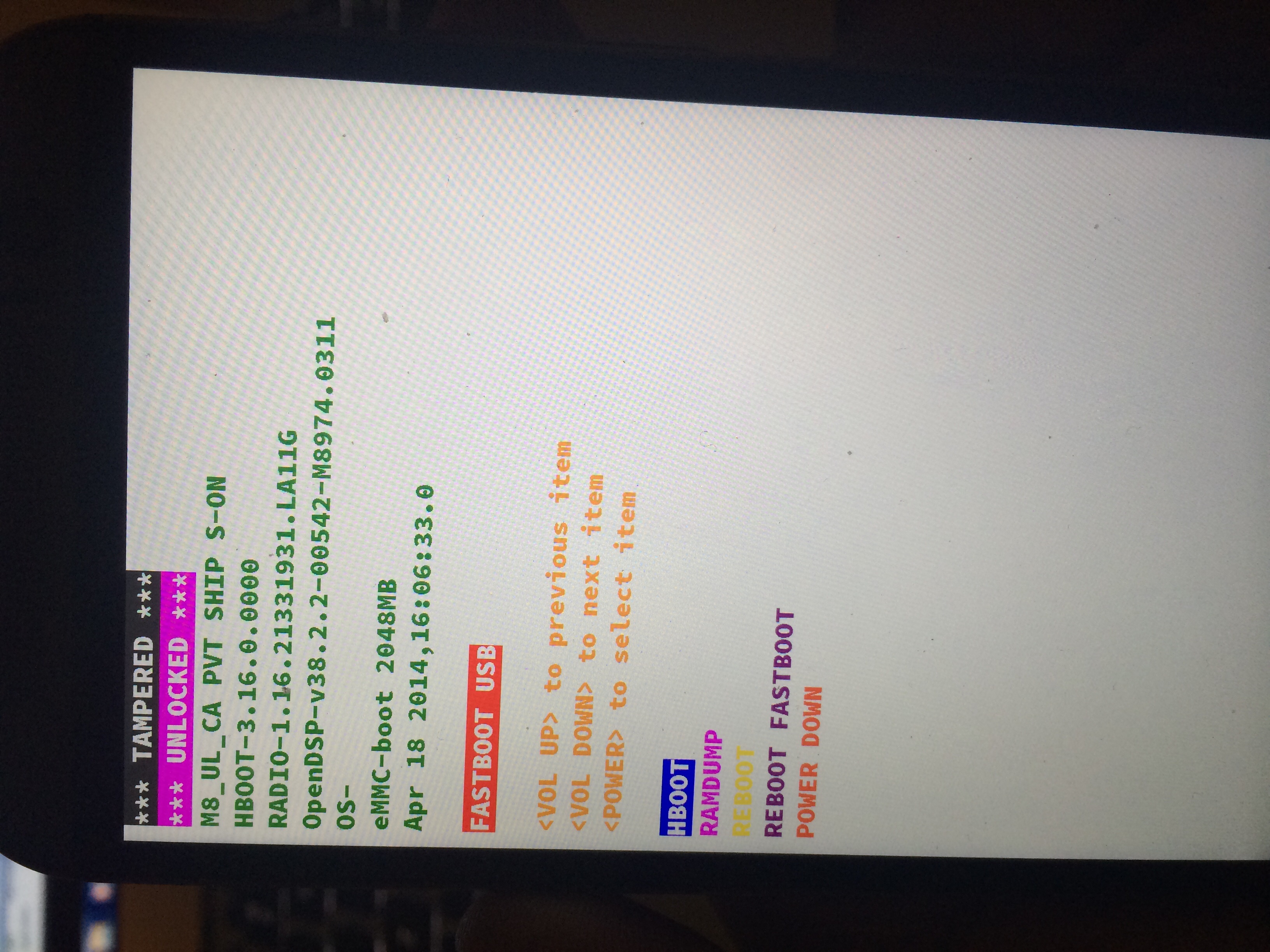

Also my fast boot screen is now different than what it was before. It used to have a white background and now it's black, not sure if that has something to do with it not allowing to flash Roms or restore to stock or not. It's been that way since I tried the ota with the gpe rom.

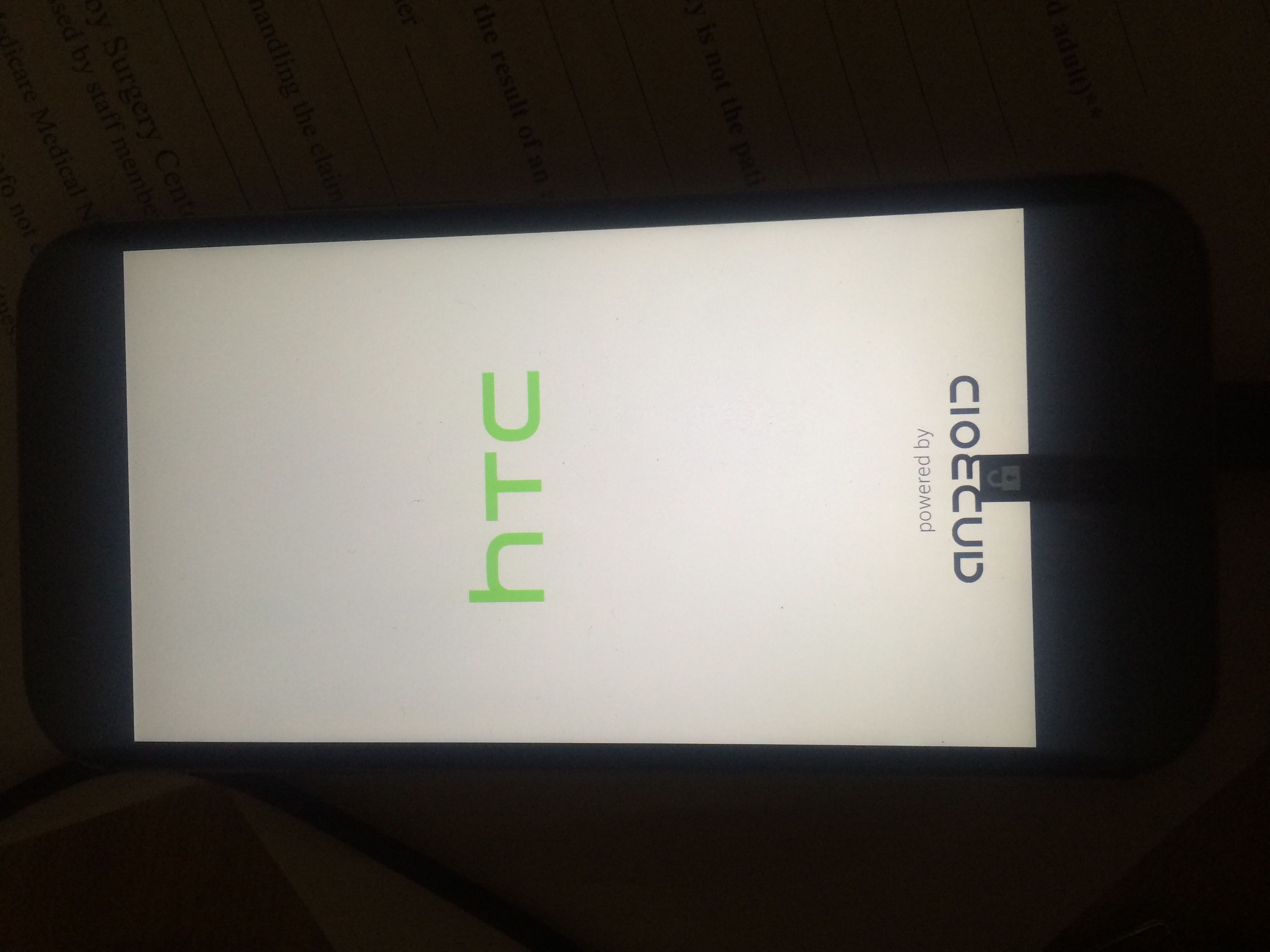

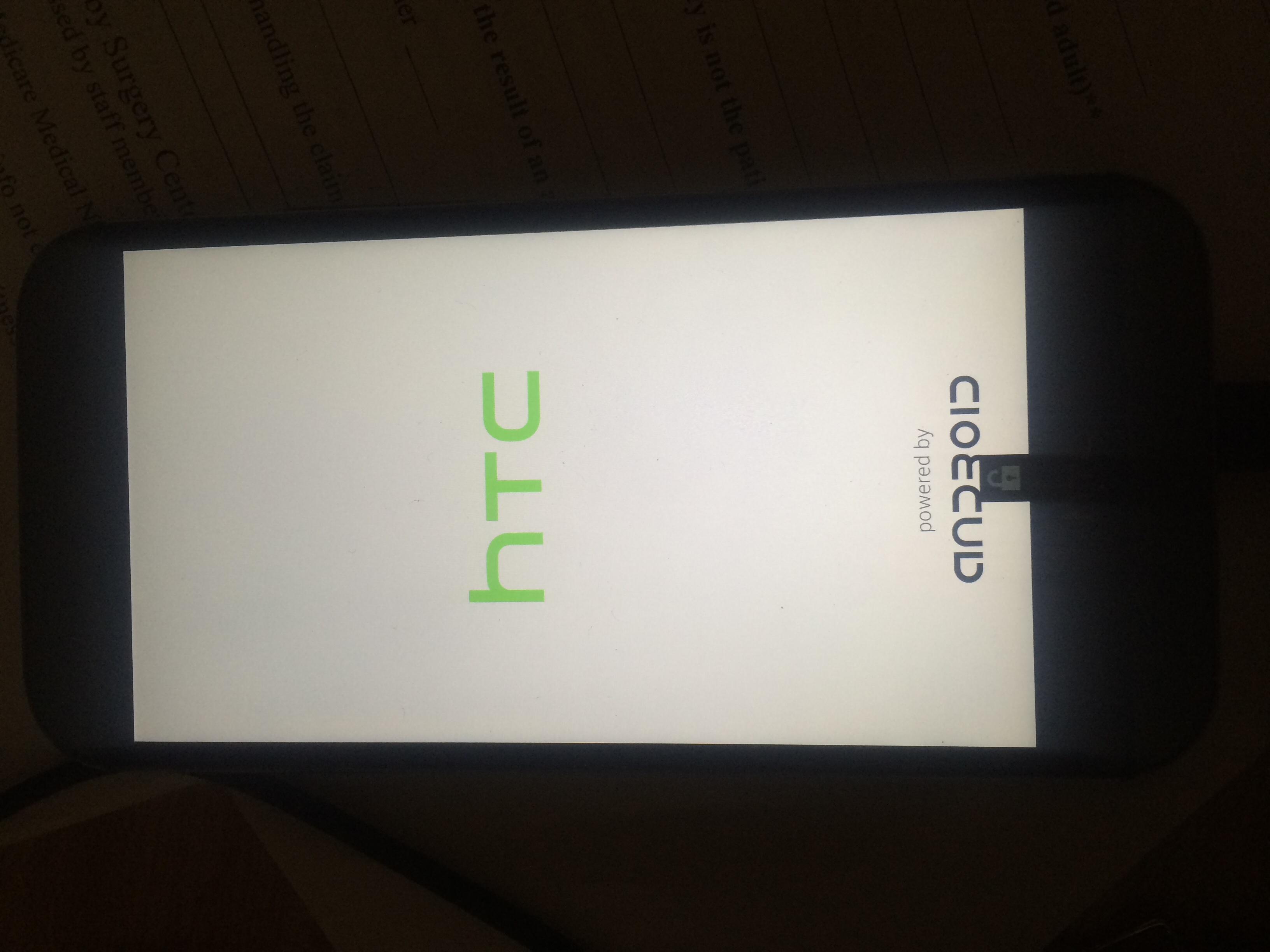

Thanks, I'm at work now but I'll try these out tonight. Here is what my phone shows when I try to boot up, it just sits there on the HTC logo with an open lock at the bottom. If I relocked my boot loader the lock goes away but it still hangs there.

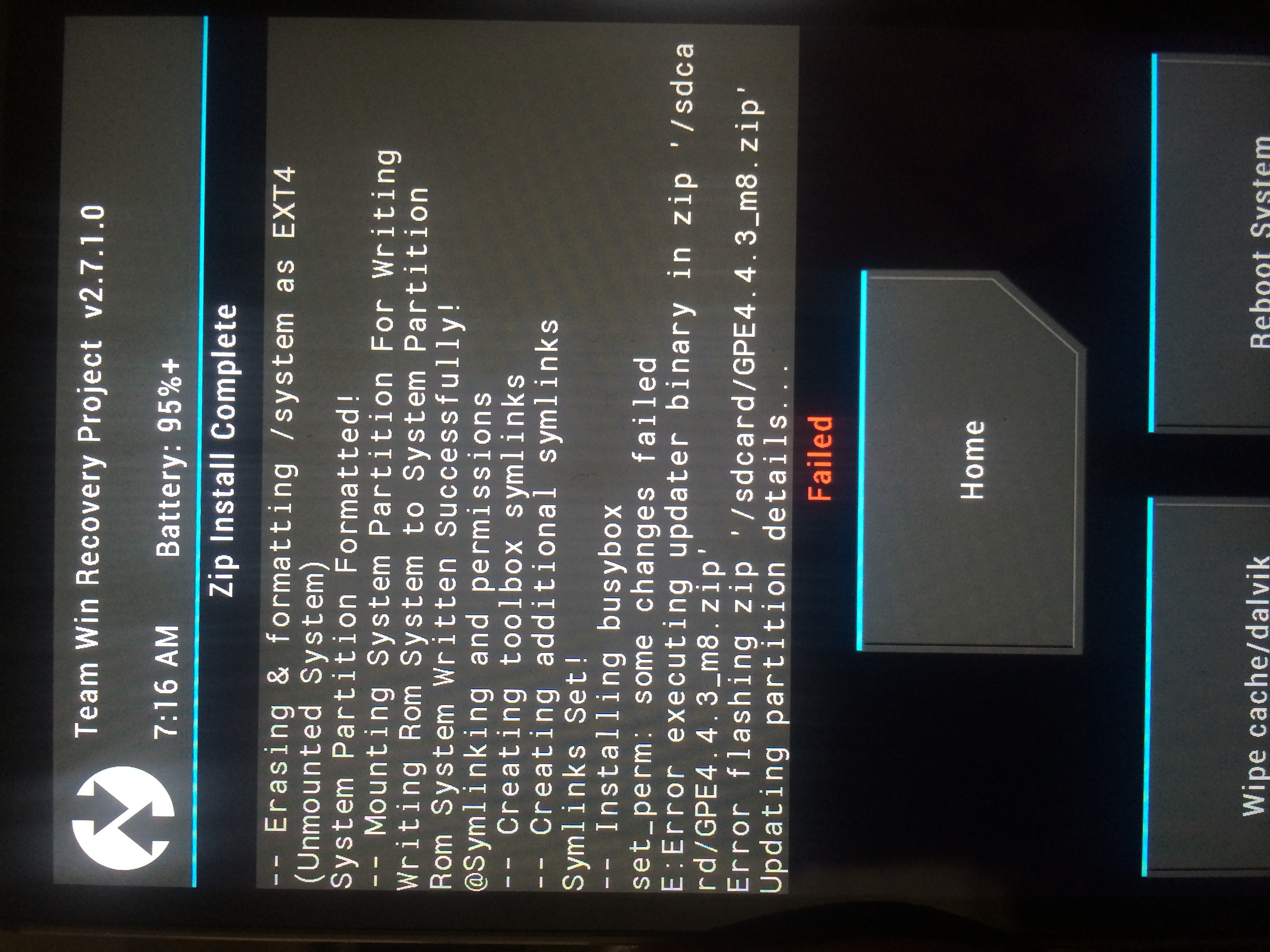

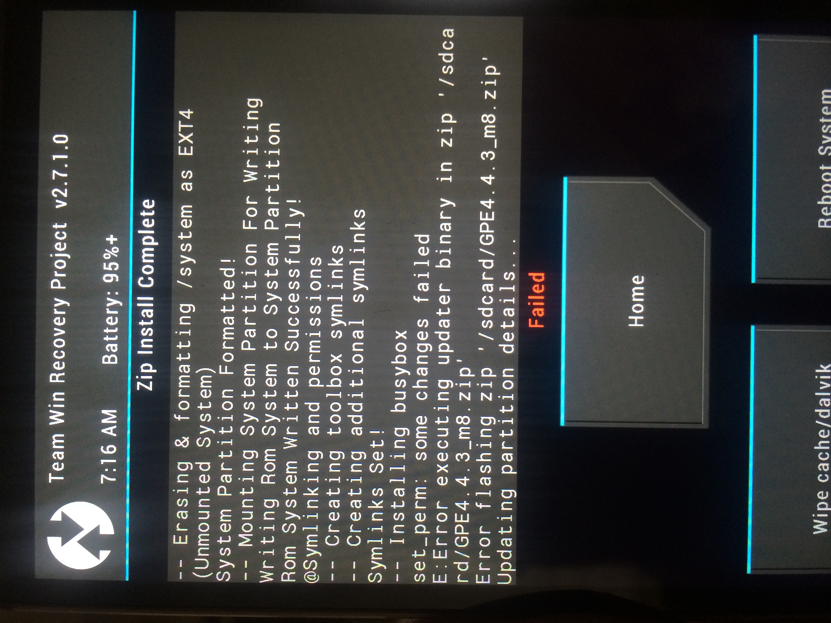

And here is what it shows when I try to install the gpe rom. When I tried insertcoin it would actually say it was successfully installed, but it would boot up and when I would go into recovery, the sd card was still empty.
