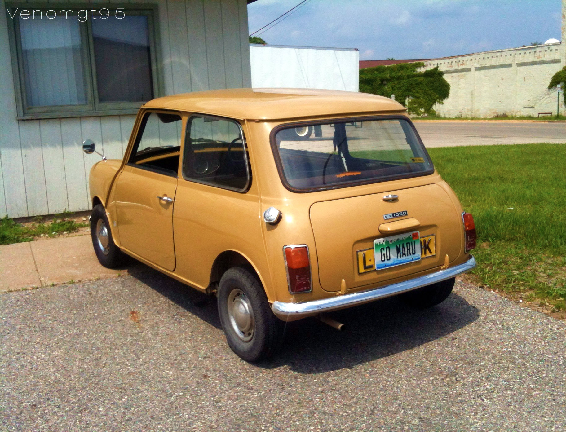

I saw this Vintage Mini in my town last Friday
Reactions: AustinIllini
why would they put the MI plate OVER the euro plate? y not just remove the plate in the back?
