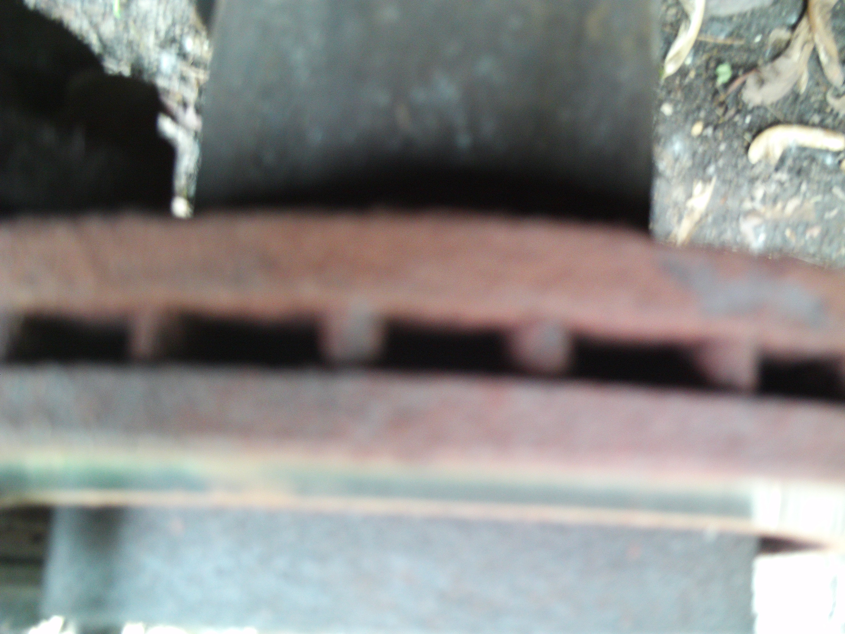

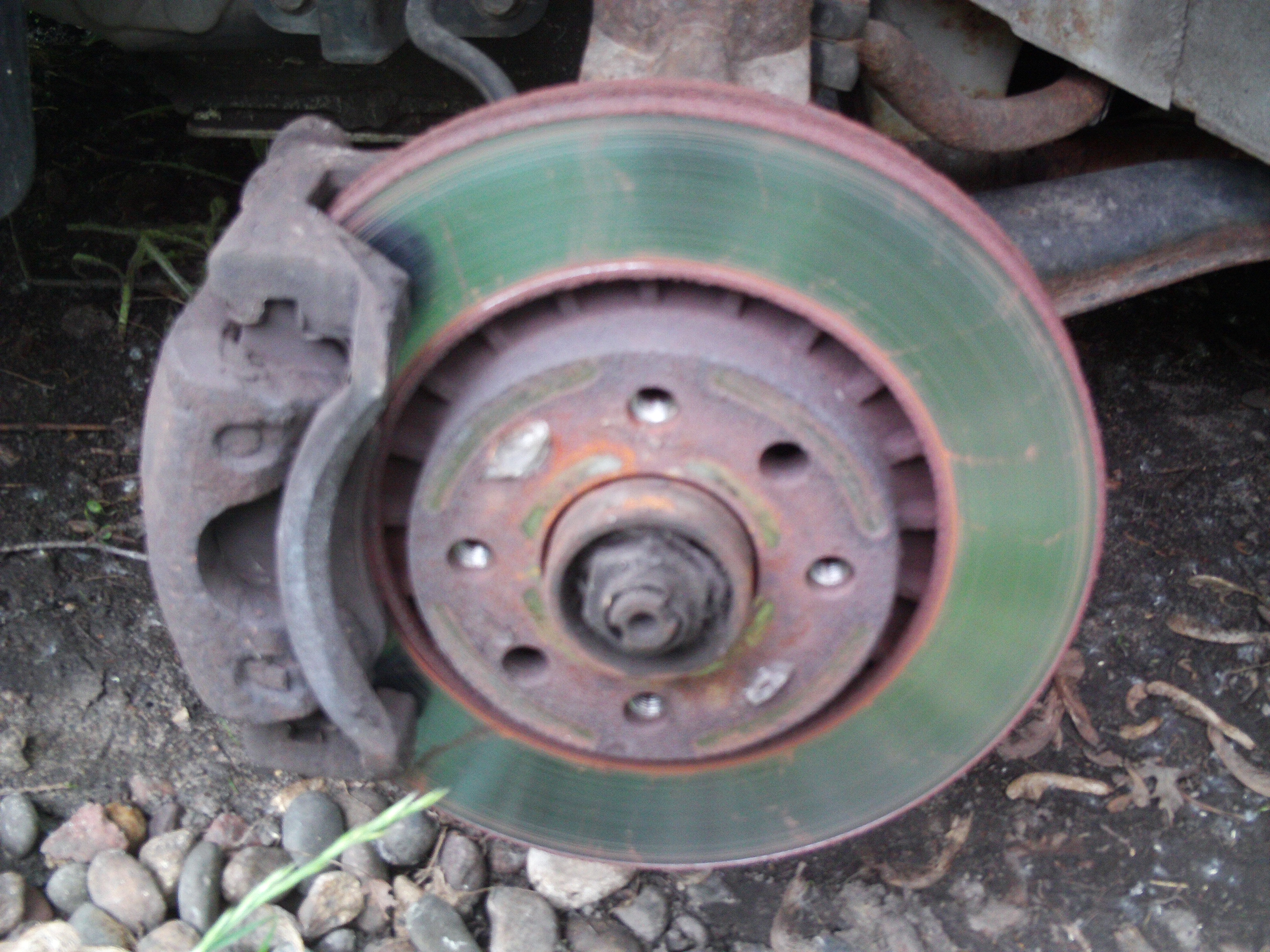

Well, I have removed the wheel. The rotor is not ruined, rusted on the edges but not ruined.
EDIT: Caliper is rusted. looks like there is no pad material left and I don't need a brake "key" I can remove the caliper with a 5MM socket (HOPEFULLY).

well everyone.... here is pictures of the caliper and rotor.....

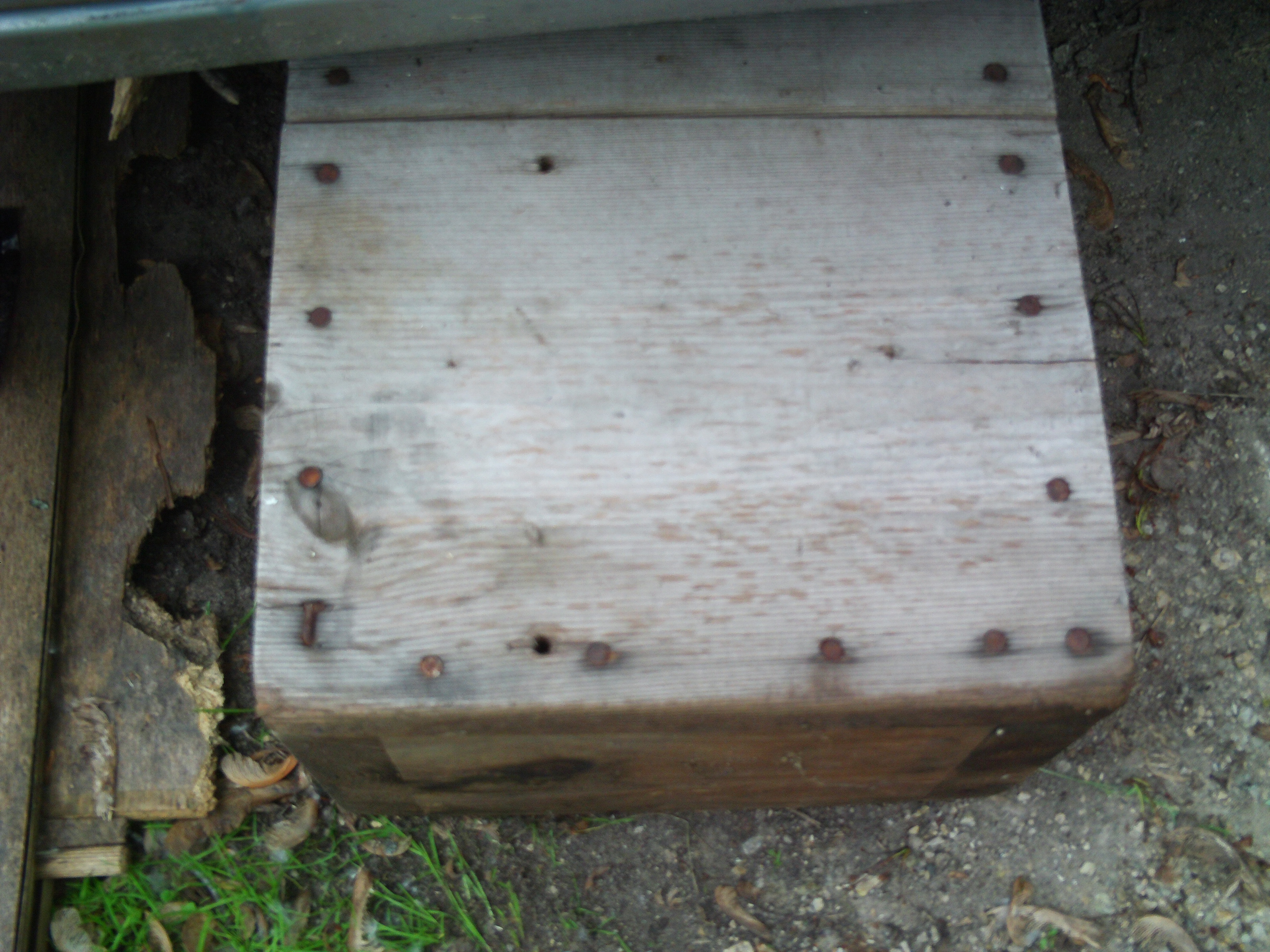

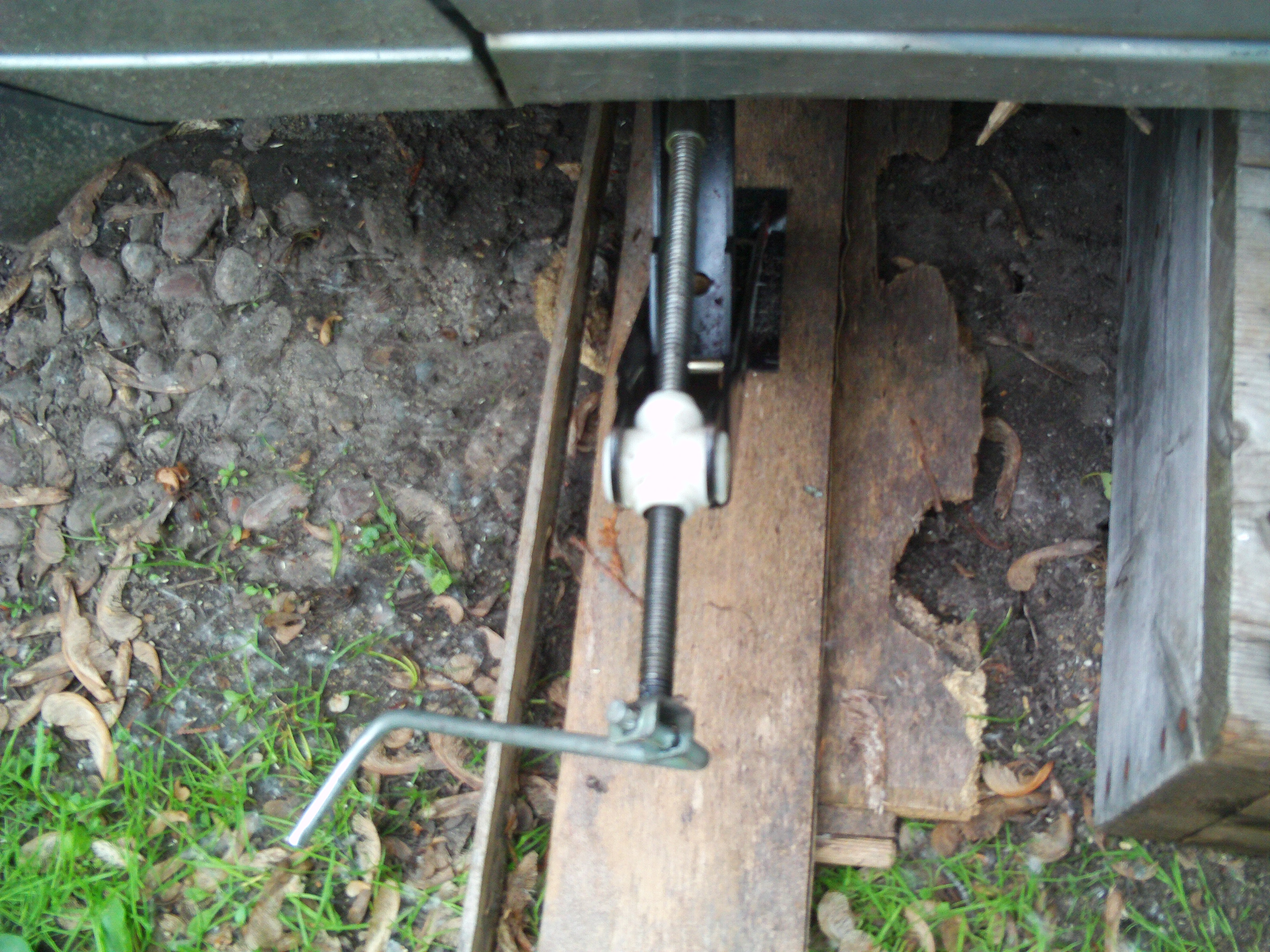

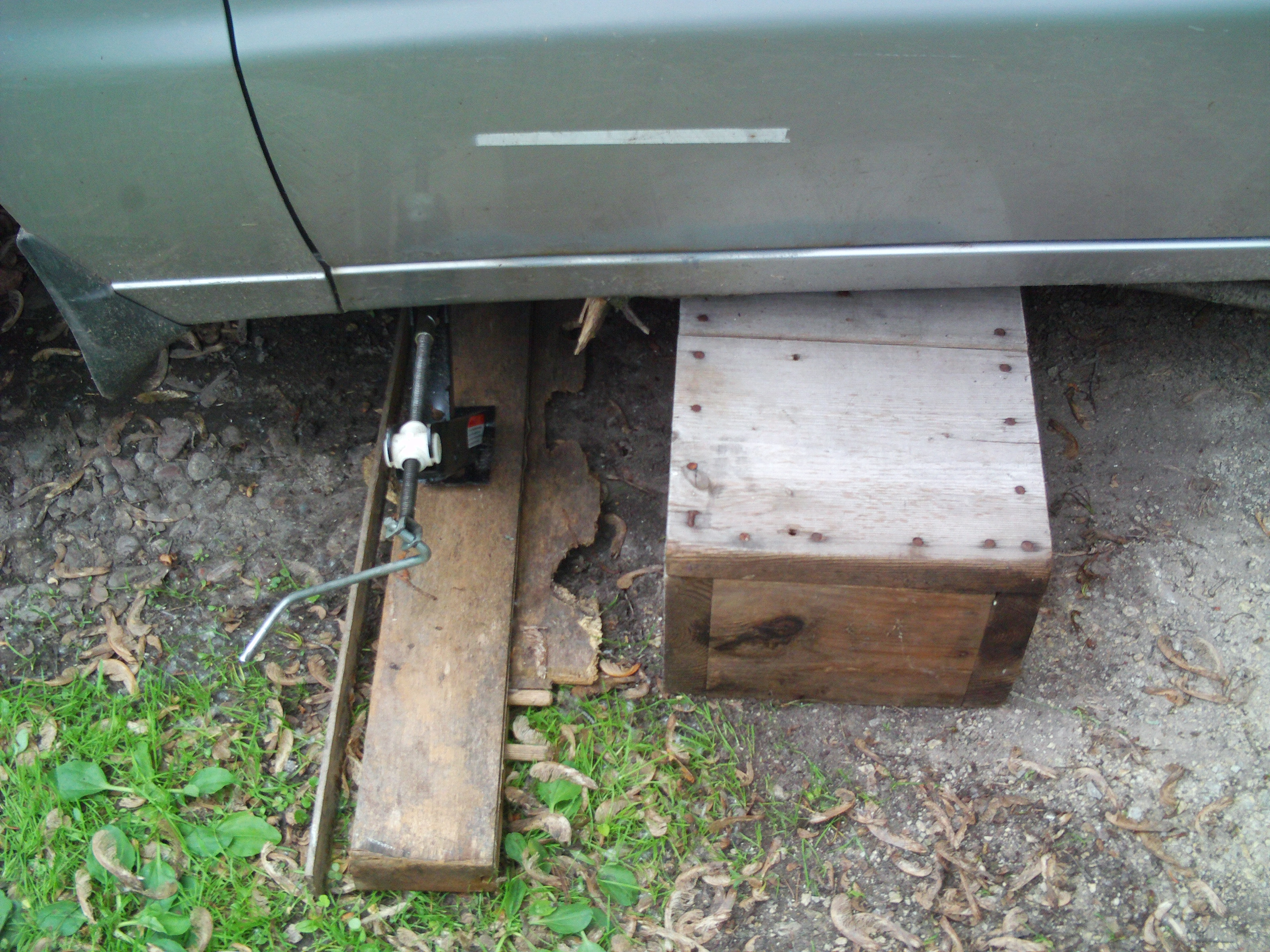

this is my improvised jack stand setup.......
How do you know that your rotor is okay? It could be warped but not necessarily obvious.
I'd still take it to a brake shop and have it machined. I'd want to do it anyway after driving with a seized caliper, and they will be able to tell pretty quickly on the lathe if it's warped. Most shops will charge $15-20 to machine a rotor. Of course, it's also not a bad idea to check and see how much replacements actually are-some aftermarket replacements for economy cars run $30-50 a piece.
BTW, with your improvised jack set up-be sure you place the front tire/wheel under the front axle. It's a good idea in general any time you're working with jack stands, and can save you a whole lot of trouble along with your life if your improvised jack stands give way.
I think I paid $15 or $20 for a pair of jack stands at Big Lots. I've since upgraded to a nicer set, but those worked fine for a while. That beats the heck out of having your car drop and really damage something on it or on you.
AutoZone sells a rotor for $35. I said it was ok as in it is smooth it's not chewed up. I didn't look for warpage. The new Caliper is $40 and new pads are $30. No core for rotor but there is a $22 core charge on the caliper.
I actually have the wheel off to the side. If i put the wheel under the front the car wouldnt be supported by the ramp i have under there.

Well i Turned my wheel to the left to get better access to the caliper Looking, the pistion is completely rusted and believe it or not there is atleast 1/2 of pad material left on the pad controled by the piston. The piston is sticking out 1/8 of a inch or so.

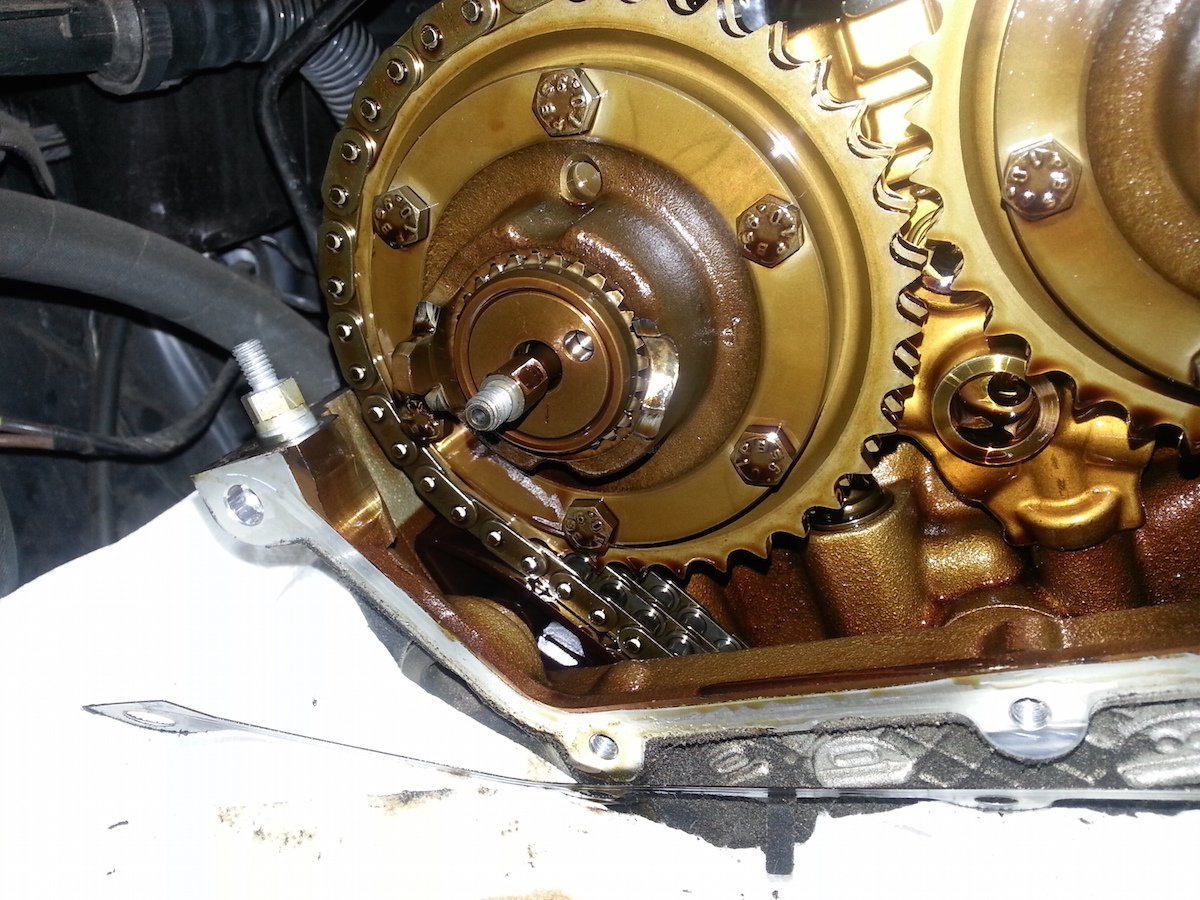

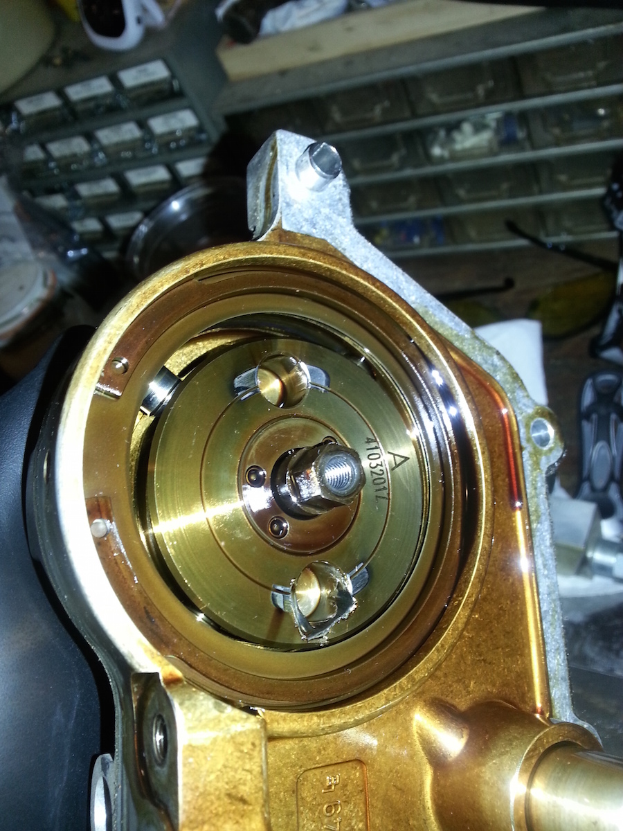

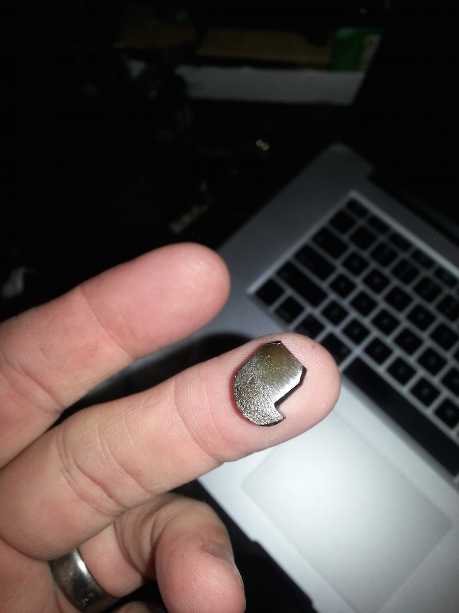

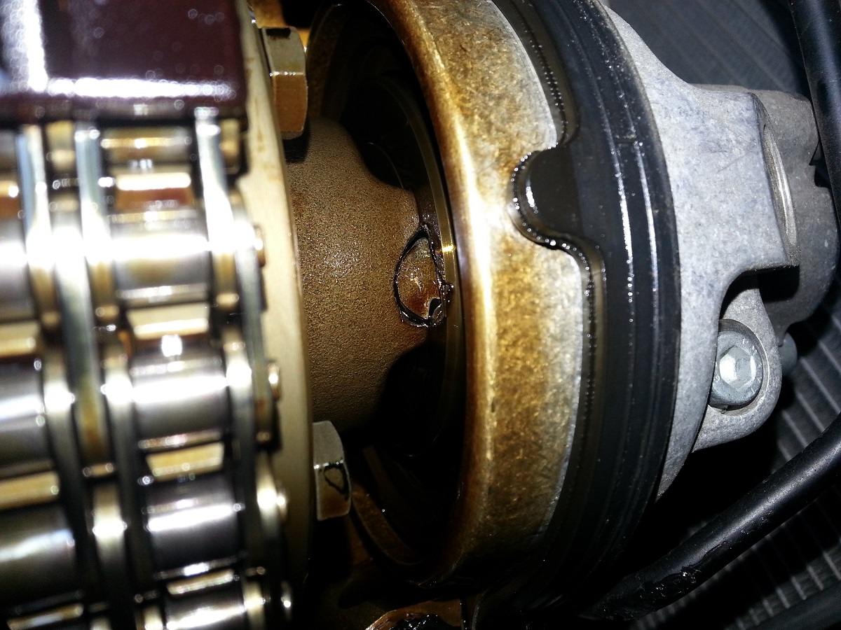

Speaking of the BMW, I found this when doing my valve adjustment last weekend:
That tab came off of this hub:
....and chewed up the vanos oil pump disc:
So yeah, that's about $1400 in repairs/upgrades as a result.
