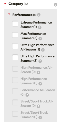

As for tires, aside from the big differences like truck vs. car tires, off-road vs. street, tires come in different categories like Touring, Rain/Snow, Summer, Ultra High Performance, etc. I tried to find a good source to explain the differences but have thus far failed. You can always Google for "summer tires vs UHP" and get details. Just for reference, here's a screenshot of the categories you can find on a site like Tire Rack.
The main differences will be tread life (how many miles you can expect the tire to last), grip level, wet vs dry performance (grip), road noise, and ride comfort. Because MINIs are small, most do not include a spare, but come equipped with runflat tires from the factory. While providing some security against getting stranded, RFTs typically ride much harder and do not handle well. As I'm a performance-minded driver, and live/drive in a warm climate (Florida) I can safely run a higher-performance summer tire year-round. I sacrifice some tread life for much better grip and handling characteristics.

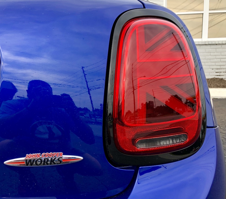

Lastly, there's the issue of "are MINIs British?" and "are MINIs their own cars since being bought by BMW?". The answer here is subjective, and somewhat splitting hairs or getting into semantics. But I'll say this: MINI is as much BMW as Lamborghini is VW. (That may be exaggerating a bit, as some MINIs like the larger Countryman do share some platform parts with the smaller BMW SUVs or Crossovers.) But my two-door hardtop JCW, for example, is pure MINI. It was designed by MINI and built at the plant in Oxford, England, where 3 million other MINIs have rolled off the line. Because MINI has expanded their lineup, some cars are made in Austria, but mine, which is the closest thing to the Classic or even first gen MINI available today, came from jolly old England and is British to the bone.

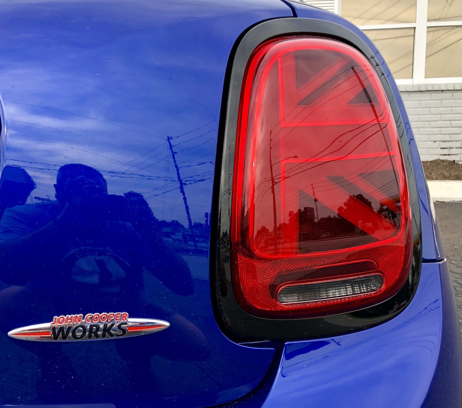

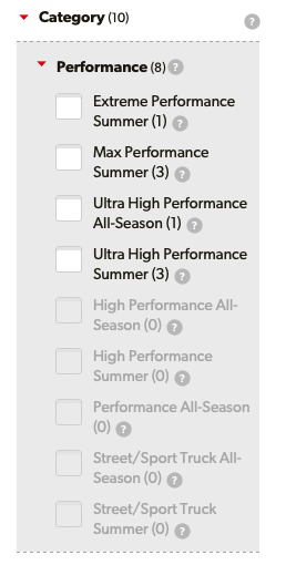

I've driven cars(often without more than a cursory look at the tires before driving to make sure they're halfway serviceable) and said "These tires are absolute crap and need to go."
Even at the high end from the big names(Michelin, Bridgestone, etc) you often have two major lines of tires, the "sport" tires and the "grand touring" tires. Sport tires are usually somewhat lighter(in something like a 235/50/17, which was the size on my previous daily and one where I experimented with tires a fair bit) something like a Michelin Pilot Sport A/S(sport tire) was ~20lbs, while the OEM spec "touring" MXM4 was 25lbs.
Touring tires usually give up a bit of dry traction for better wet traction and low temp traction. The often use somewhat harder rubber(not too much harder) to give a good balance of performance and life, and the tread pattern is often designed for low noise and smooth riding(which you can feel both in the seat of your pants and in the steering wheel).
Sport tires usually have softer rubber, which gives better traction than a touring tire as long as the pavement is warm enough, but comes at the expense of tread life. The tread pattern is somewhat more aggressive, and gives better dry traction(often at the expense of some wet traction, although a street tire can't safely sacrifice too much wet traction) but usually is noisier and not as smooth riding. "Summer" rated tires can be dangerous below about 50ºF, while All Season can handle somewhat lower temperatures although they are not as good as a more general purpose tire at lower temperatures(and really not as good as a true winter tire).
Over the years, I've had touring tires from Michelin(MXM4 and some other related lines), Bridgestone(Turanza Serinity) and Pirelli(Centurato). I'd rate the Michelins best in ride quality/noise and overall wet/dry traction balance. The Pirellis were the noisiest but I thought gave the best dry traction. The Bridgestones are a good middle ground and I felt like had the best wet traction. One point Michelin has been emphasizing the last few years is that they claim better traction toward EOL than many other tires when new. I could reliably get 40K miles out of any of them. I've stuck to Michelin Pilots for sport tires, but get maybe 20-25K miles out of them.
Below those two tire classes, you can run into more economy tires. Many times these use harder rubber that gives great life ratings but can hurt traction. A more aggressive tread pattern often makes up for this somewhat, but makes them noisy.
Basically your standard all season street tire is a balance of a couple of factors-dry traction, wet traction, noise and ride quality, and tread life. You can't really improve one factor without giving on some of the others, and it can be a matter of finding the right balance that fits your application.
As an example, many higher end passenger sedans will ship with a touring tire, which really is a great meeting point of all of those factors. For sportier trims that can benefit from more traction, a sport tire may benefit the driver who understands its strengths and limitations.
And, of course, many folks no matter what the price will go into a tire store and buy the least expensive correct size for their car. This is especially true as wheel sizes have crept up, and you get hit with $300+ per tire for say a 19" Michelin or Continental run-flat, and those Dorals or Generals or whatever start looking appealing. I don't skimp on tire quality, but many people do balk at the cost of good tires.
BTW, my personal leaning is toward Michelin first and Bridgestone second, but Pirelli, Continetal, Yokohama, and several others make great tires. Even among "economy" brands, a lot of MG owners love the General Altimax(the selection of tires in our size is limited, and the OEM Pirelli Centurato carcass that's no longer made by Pirelli and is now a 60 year old tread design is only available in the US through one specialty supplier I know of for about $250 each).
Also, that's ignoring other big factors. In general, tall sidewalls give a better ride but "roll" in turns, while short sidewalls have less flex for sharper turning but also less to soak up road bumps.
