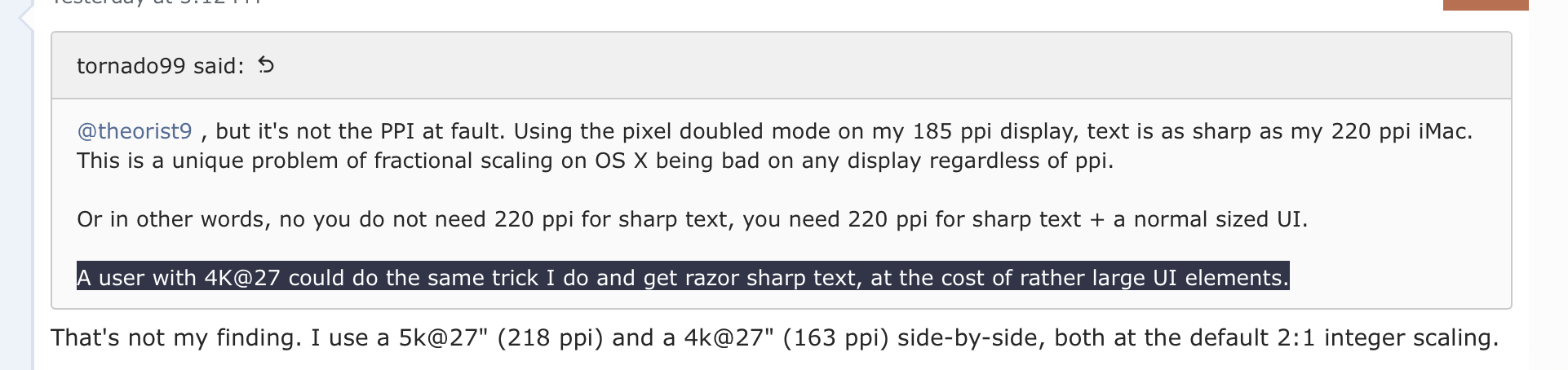

@theorist9 , but it's not the PPI at fault. Using the pixel doubled mode on my 185 ppi display, text is as sharp as my 220 ppi iMac. This is a unique problem of fractional scaling on OS X being bad on any display regardless of ppi.
Or in other words, no you do not need 220 ppi for sharp text, you need 220 ppi for sharp text + a normal sized UI.
A user with 4K@27 could do the same trick I do and get razor sharp text, at the cost of rather large UI elements.
That's not my finding. I use a 5k@27" (218 ppi) and a 4k@27" (163 ppi) side-by-side, both at the default 2:1 integer scaling.
To my eyes, the difference is clear. Comparing the same absolute text size, I find the 5k is noticeably sharper. And the same if I don't re-size the text on the 4k to make it the same size as on the 5k. It's more blurry (softer) either way.
Then again, I have very good close vision (I used to be able to read the microprinting on US currency, and while I've lost a bit with aging, it's still quite good), and have always been very sensitive to text sharpness.
As I keep emphasizing, we're all different, and you can't extrapolate your experience to someone else. Yes, there is a pixel density beyond which no human could discern the difference, but the limited studies I've seen indicate we're not close to that with large displays.
Plus your 4k is 24" (185 ppi) rather than the usual 27" (163 ppi), so the difference may not be as noticeable.

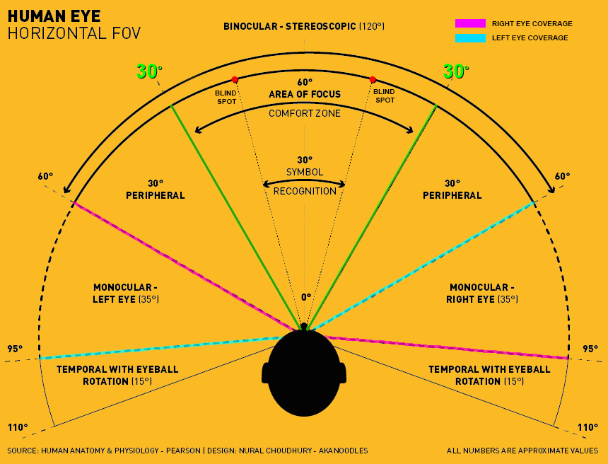

Also, I think ppi is not a great metric to discuss monitors, as it ignores the fact that we sit further away as the device gets larger. The central vision of the human eye is most comfortable at a 30 degree FOV. But of course you can turn your head whilst working. Too much turning, and you might as well be watching a tennis match.
Using this calculator, and my real viewing distance of 50cm from my 24" 4K I get 56 degrees FOV, and 69 PPD. Maintaining that FOV for a 27" screen, and using 35cm viewing distance for a laptop I get the following:
  • 13.3" MBP - 58 PPD
  • 21.5" 4K iMac - 73 PPD
  • 23.8" 4K - 69 PPD
  • 27" 4K - 68 PPD (don't own e.g. Dough Spectrum)
  • 27" 5K - 91 PPD (don't own but a colleague at work owns one e.g. ASD)
and for my glossy portable monitors
  • PM 1 - 74 PPD
  • PM 2 - 61 PPD
  • PM 3 - 53 PPD
Out of the above, the only monitor I could see pixels was the PM 3, and possibly the MBP/PM 2 if I pushed myself. For me 69,73,74, and 91 PPD are equally sharp. So my real visual acuity is between 58 - 69 PPD. Tallies nicely with the benchmark that human vision is "60 PPD".
Adding in matte monitors introduces a significant degradation in sharpness. I returned a 285 ppi monitor with a light matte finish as it was blurry in normal daylight conditions, which is higher than 163 ppi with subpixel antialiasing.
Of course, some people will have higher visual acuity, but very few will need 91 PPD. I don't see anyone complaining their Macbook Pros are pixelated.
