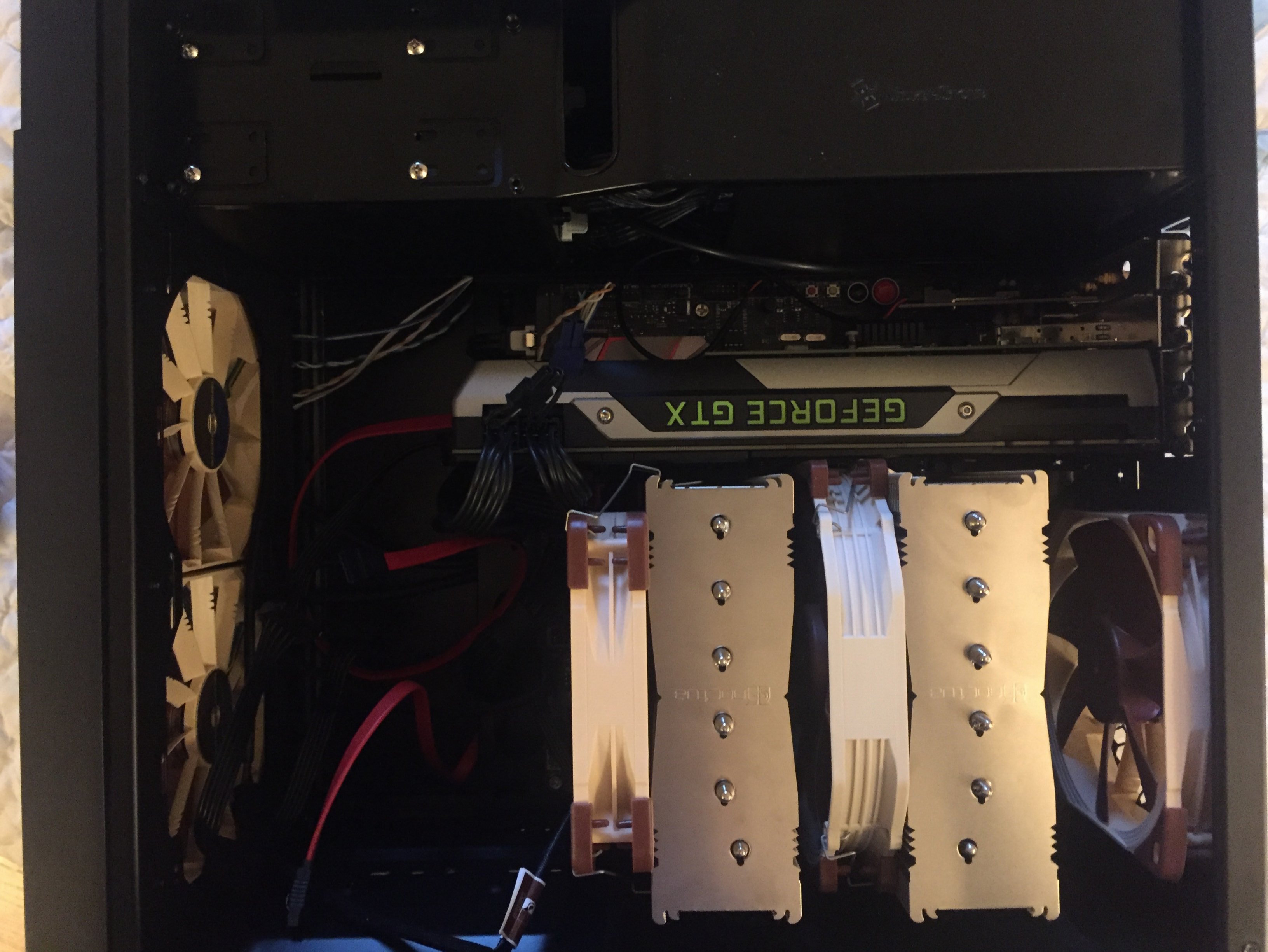

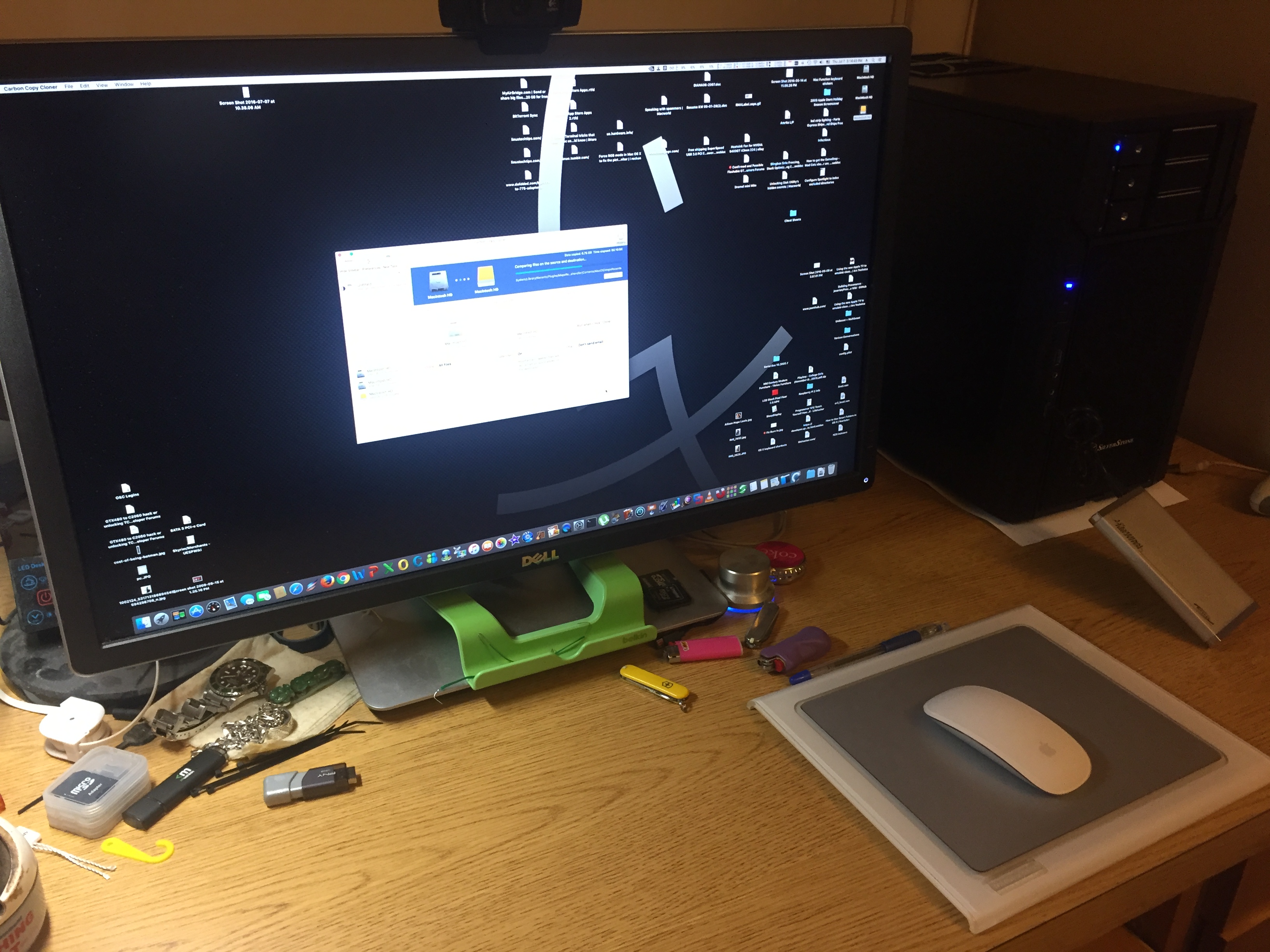

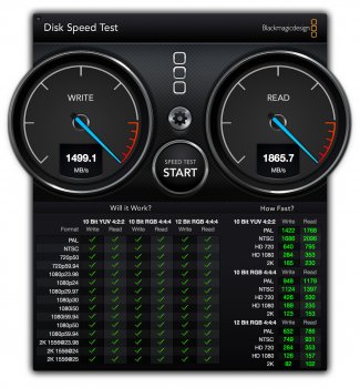

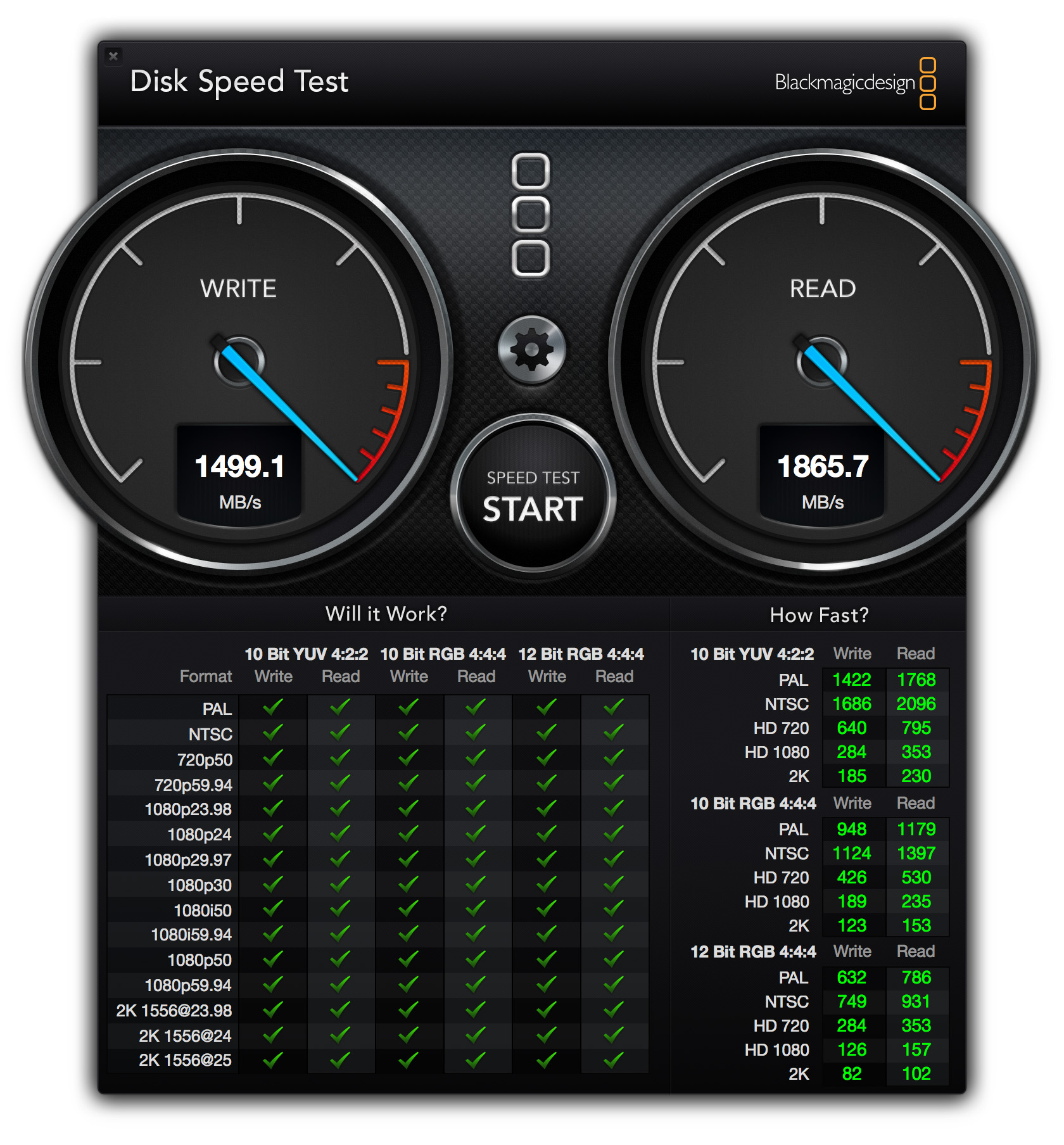

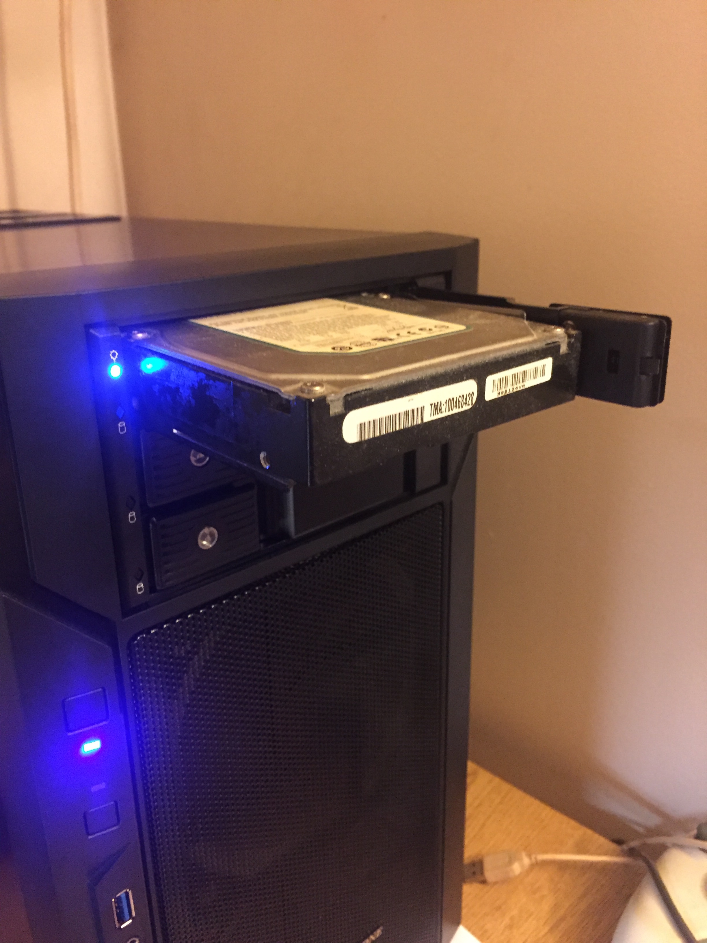

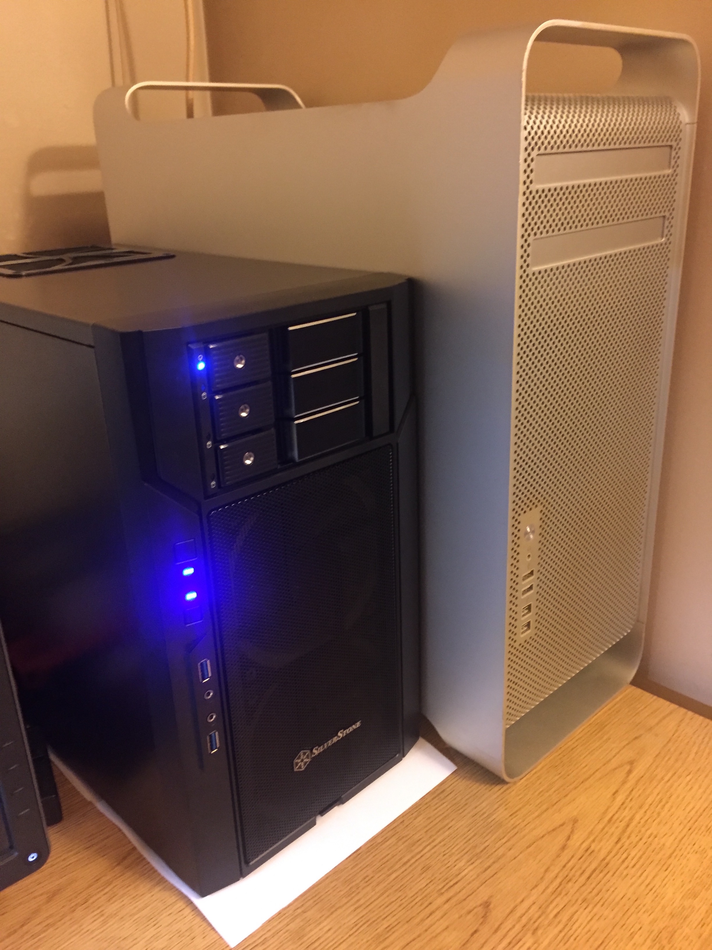

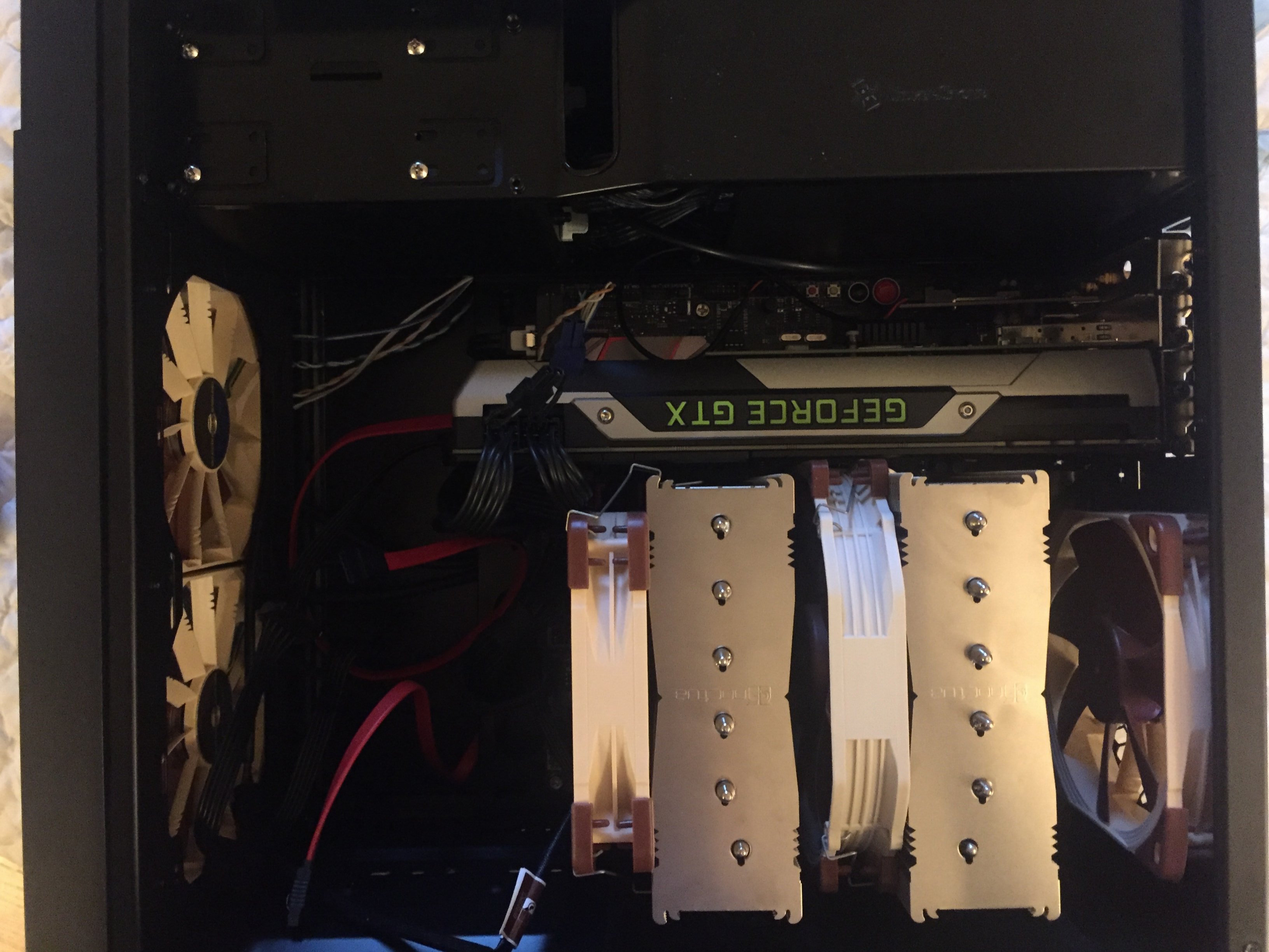

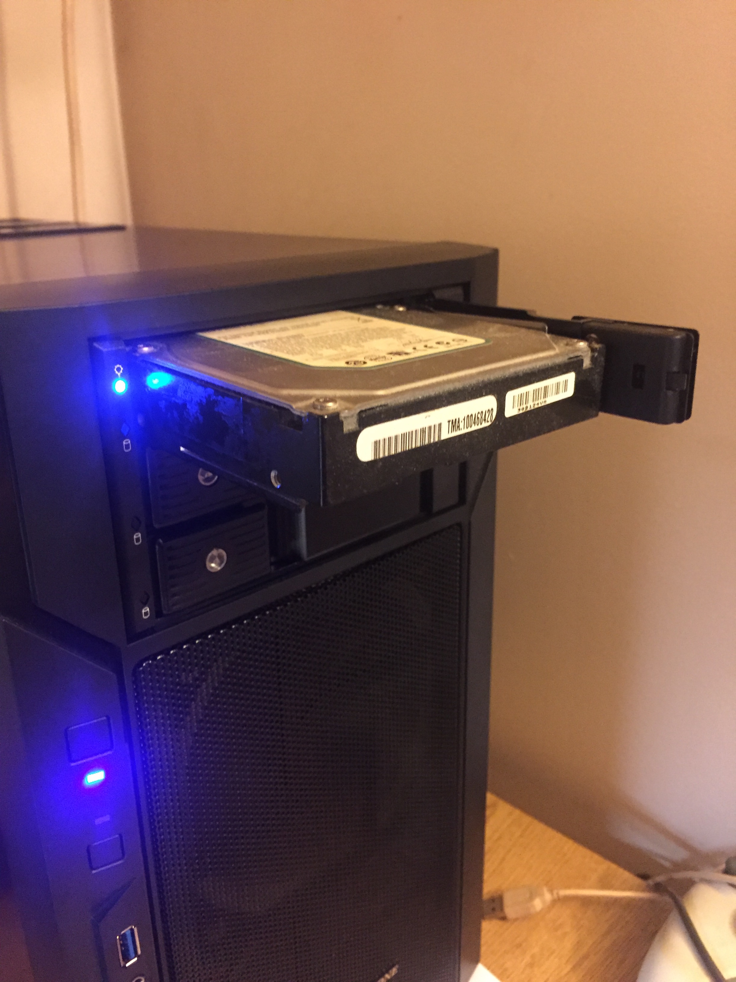

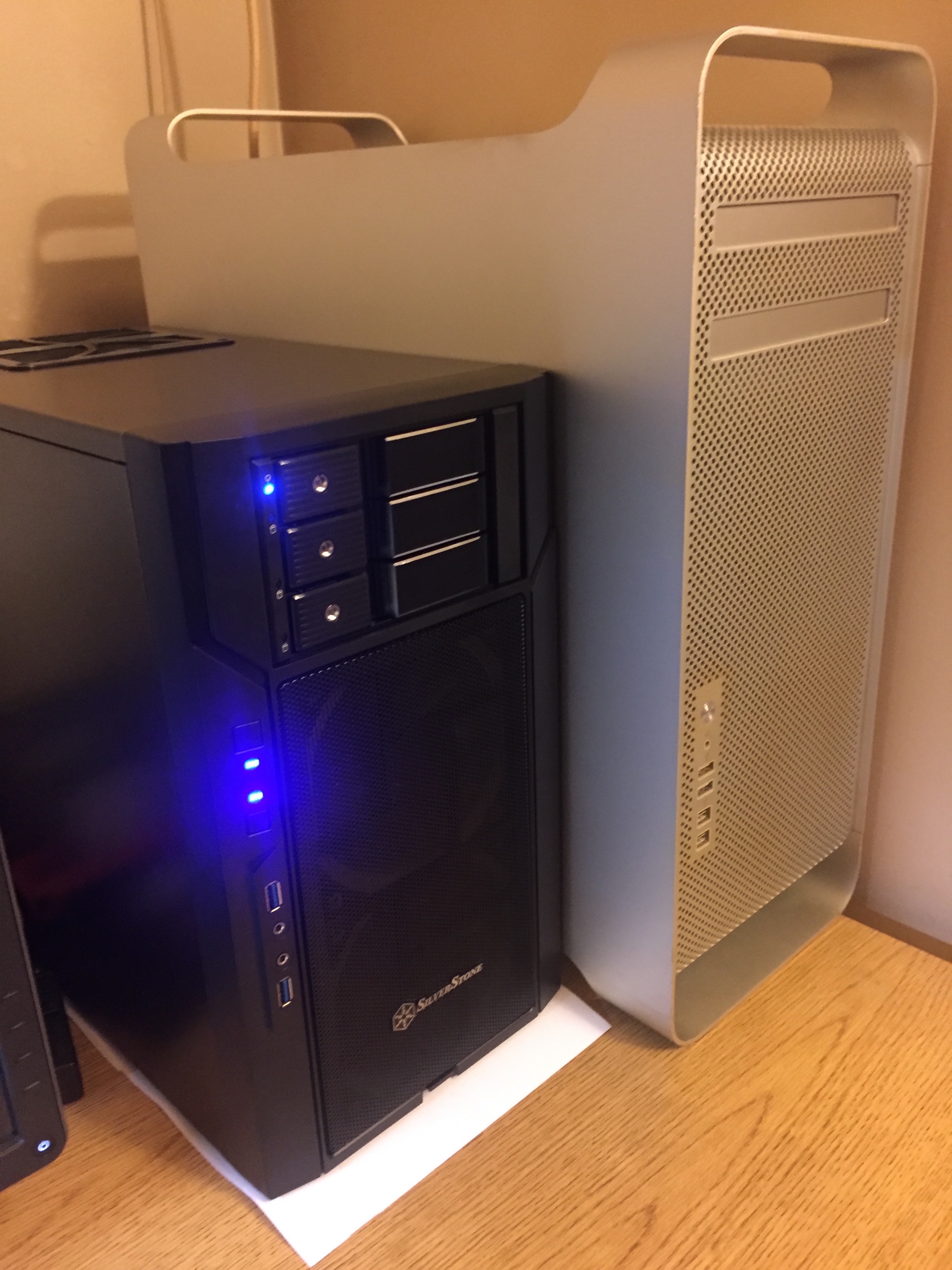

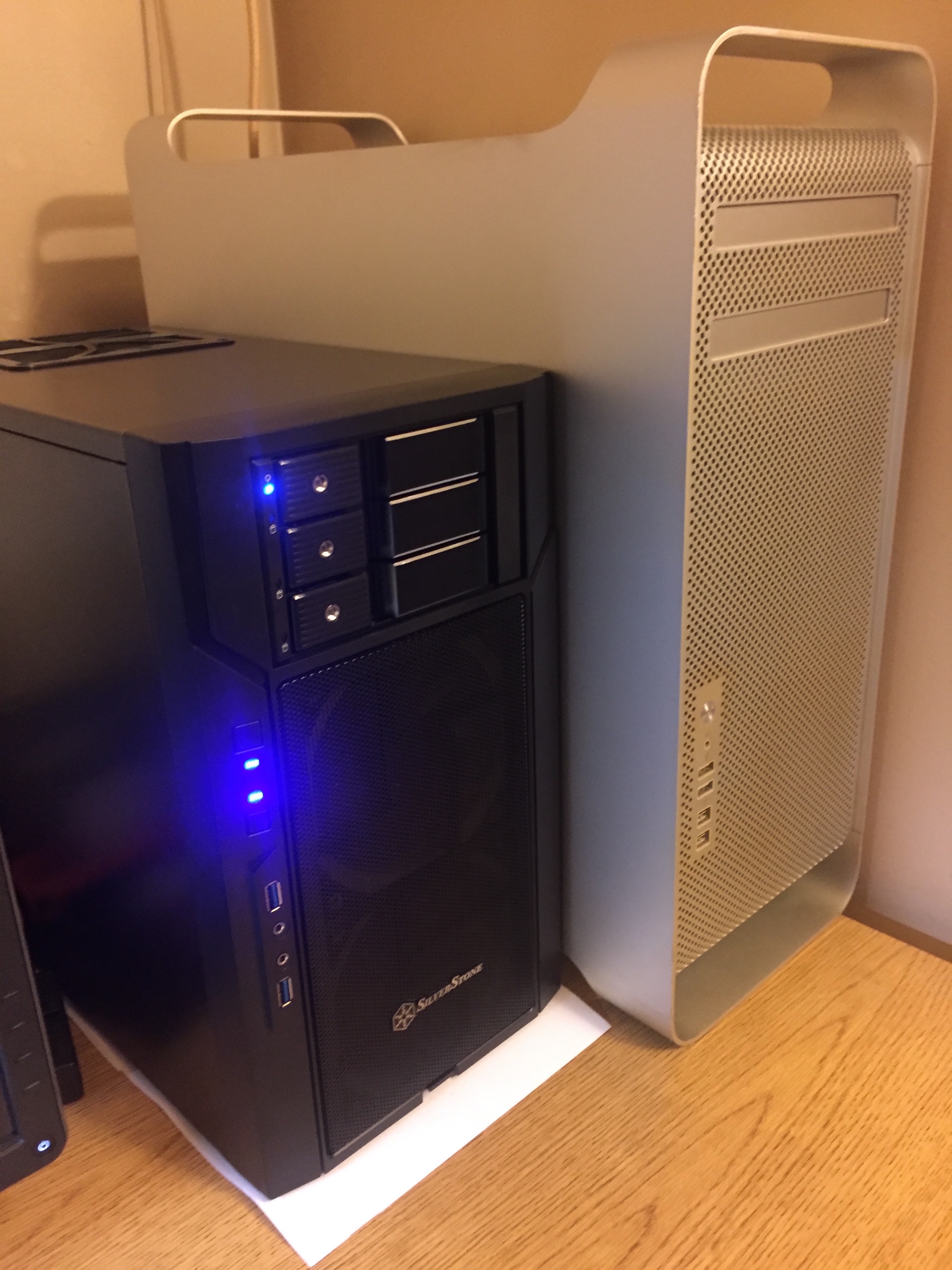

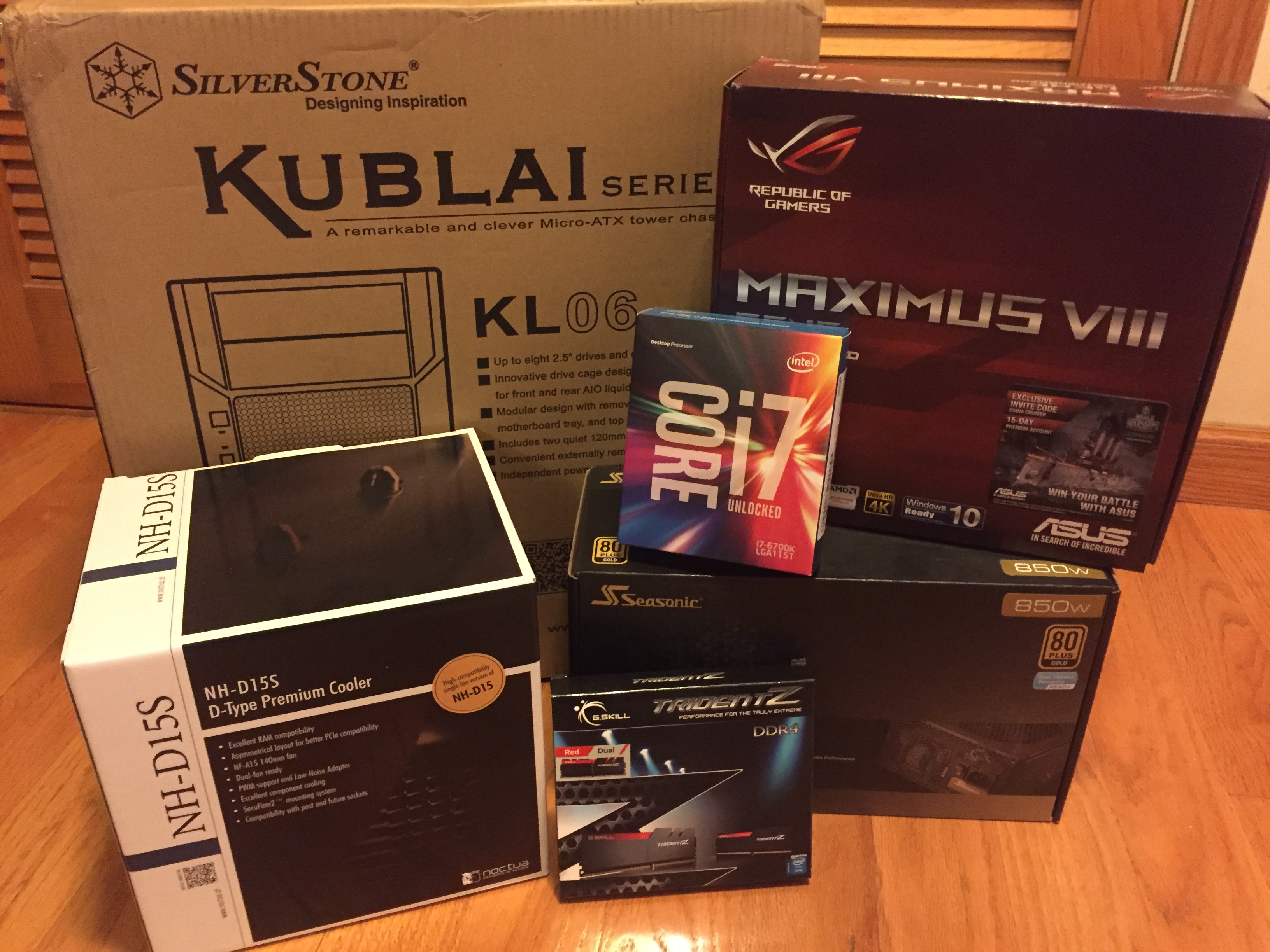

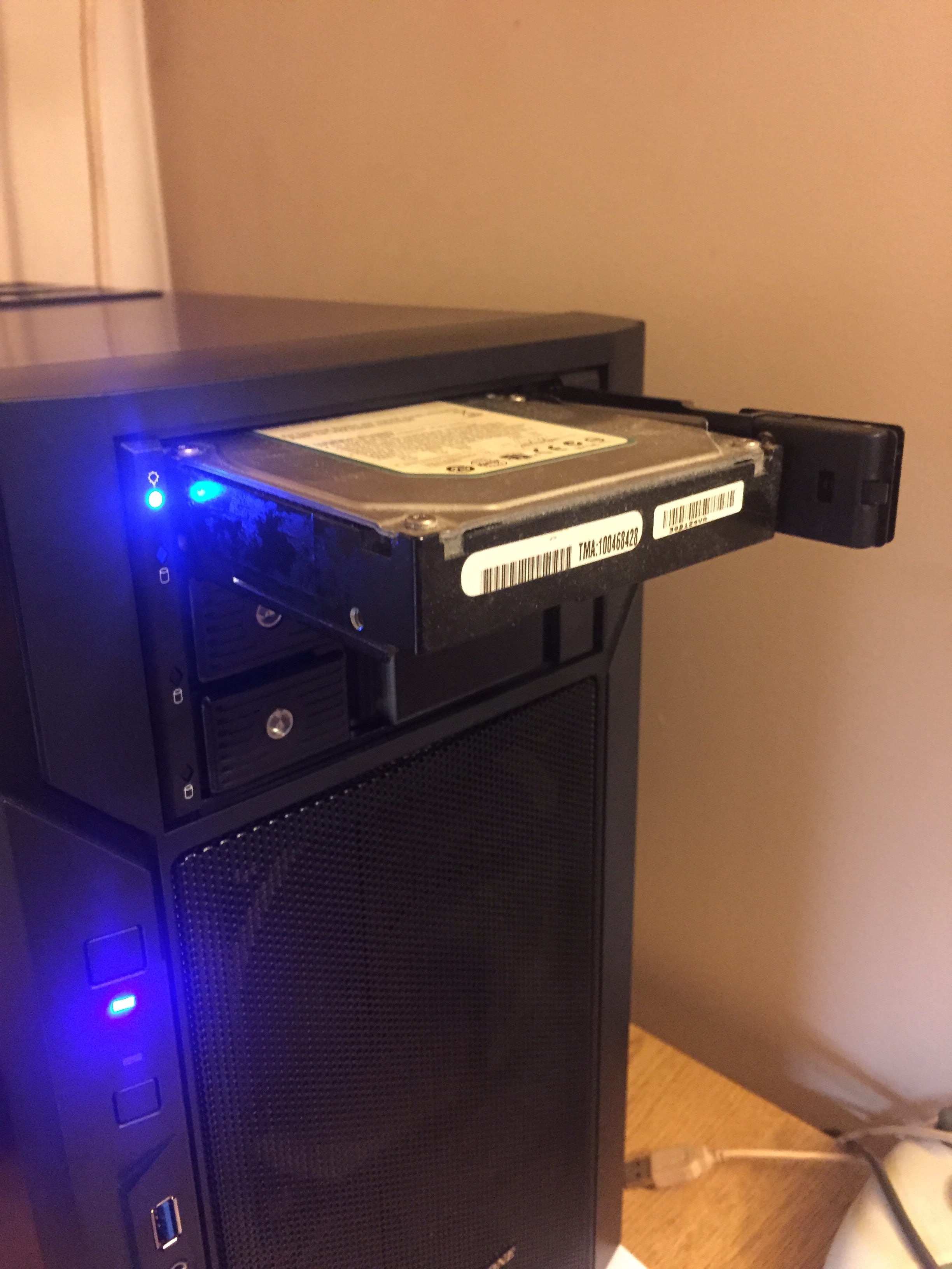

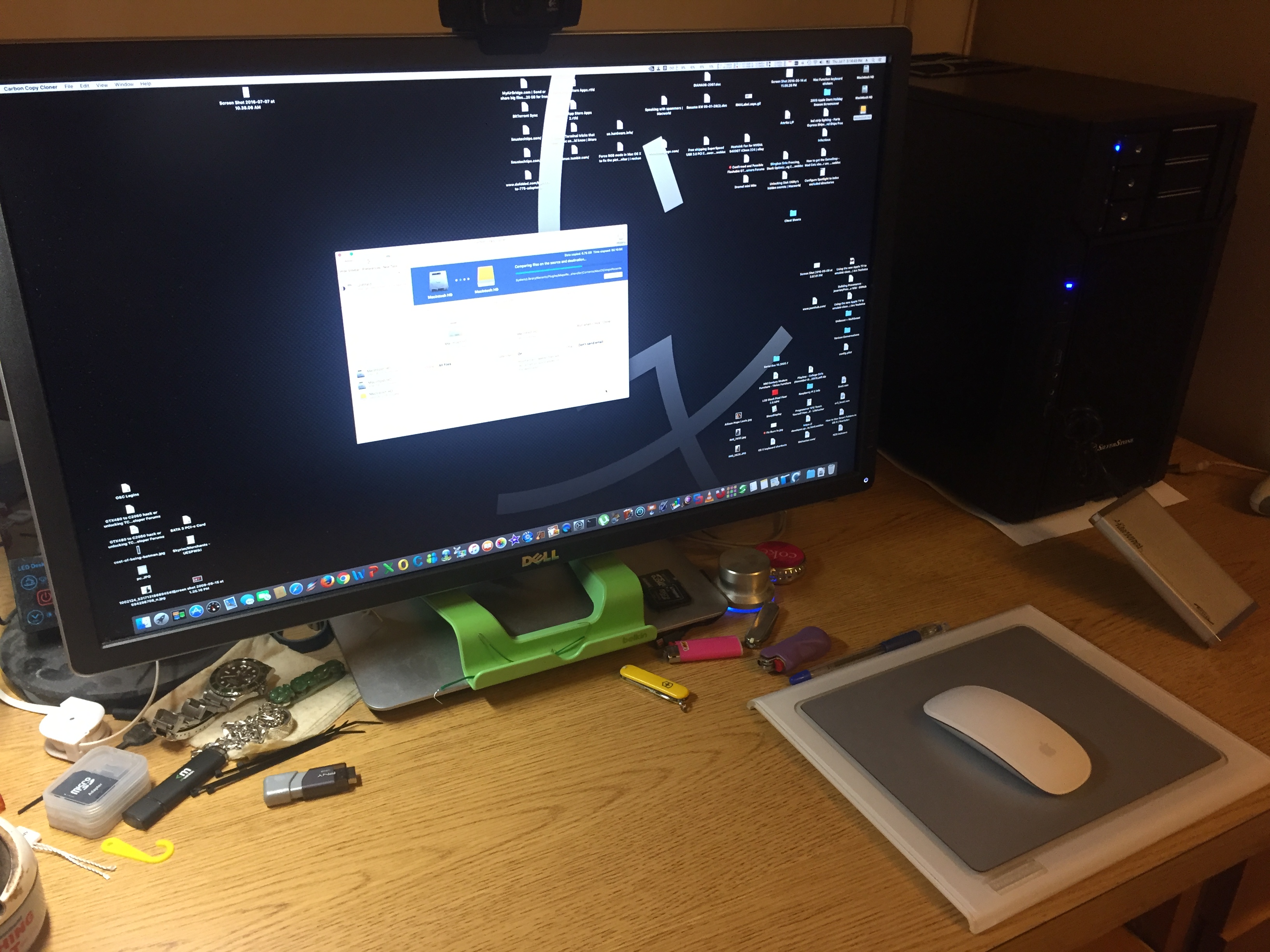

I finally got my hackintosh completed. Specs are:
Asus Maximus VIII Gene
i7-6700K
64GB RAM
GTX 980
Solarflare 10GbE
Broadcom BMC94360CD
Apple 512GB SSUBX on M.2 adaptor
Silverstone KL06
Noctua heatsink and fans
IMG_6409.JPG IMG_6412.JPG IMG_6416.JPG IMG_6414.JPG IMG_6415.JPG Screen Shot 2016-07-09 at 3.54.20 AM.png Screen Shot 2016-07-09 at 3.51.32 AM copy.jpg
The only issue I'm having is a sleep issue related to the wifi card. Otherwise, everything has been fantastic. 4900+ single core and 20K+ multi core Geekbench scores.

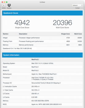

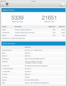

Power consumption vs my old 12 core Mac Pro 5,1 is:
Idle: ~64W vs ~170W
Internet surfing: ~70-100W vs ~ 210W
Full load: ~153W vs ~410W
Huge thanks to Stork and tonymacx86.com.

I think I'm done transferring everything from my old Mac Pro to the hackintosh. I had problems transferring my Windows license and had to spend 2 hours on the phone with Microsoft... Anyways, let me explain some of my purchase decisions and some experiences.
I'm really loving this system. It's physically so much smaller than the Mac Pro and doesn't lose any functionality except for lack of optical drive which I never use anymore. The interior layout of the case is very similar to the Mac Pro in that (1) the huge CPU heatsink is sandwiched between 140mm intake and exhaust fans, (2) mid section has its own 120mm fan blowing right at the PCI-e slots, and (3) the top is where my drives and power supply are. I put in a hot plug backplane to make access of my 3.5" drives a breeze. I went with all Noctua fans and I think I made a good choice. I sit approx 3 feet away from the computer and can honestly say I can't hear it at all. From what I've read these are very high quality fans and should continue to perform well for years to come.
The motherboard I chose is mATX and only has three PCI-e slots but since the motherboard itself already has SATA 3, USB 3 (and 3.1), and M.2 SSD connector, I felt I could live with one fewer slot compared to the old Mac Pro. I went with Z170 and Skylake for its compatibility. Getting OS X installed was really very easy. I didn't even really do a clean install on my system. I cloned the drive from my Mac Pro, re-installed OS X on top of it using Unibeast, then ran Multibeast and did a few simple post installation steps and was done!
As I mentioned earlier, installing Windows was more challenging due to issues transferring my license. Fortunately, Microsoft support helped me resolve it and I have my "Bootcamp" drive in my new system. As I did on my old Mac Pro, I use the Bootcamp drive with VMware Fusion within OS X and I continue to do so now without any issues.
Looking ahead, I will enjoy not having to worry about boot screens and/or EFI firmwares for video cards anymore and the video cards themselves will no longer be bottlenecked. While I did spend a good amount cash to get this system together, if/when it comes time to upgrade motherboard/CPU, it should be far less expensive assuming I can reuse my case, power supply, fans, and maybe heatsink. As for upgrading to future OS X releases, I don't foresee any major problems seeing as how compatible Skylake is.
So far, the only incompatibility I've come across is hackintoshes' inability to play DRM protected videos purchased through iTunes. Fortunately, I don't own many and for the few that I do, I still have my iPads, my MacBook, and my AppleTV.
