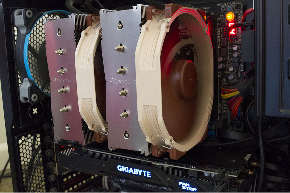

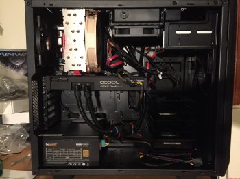

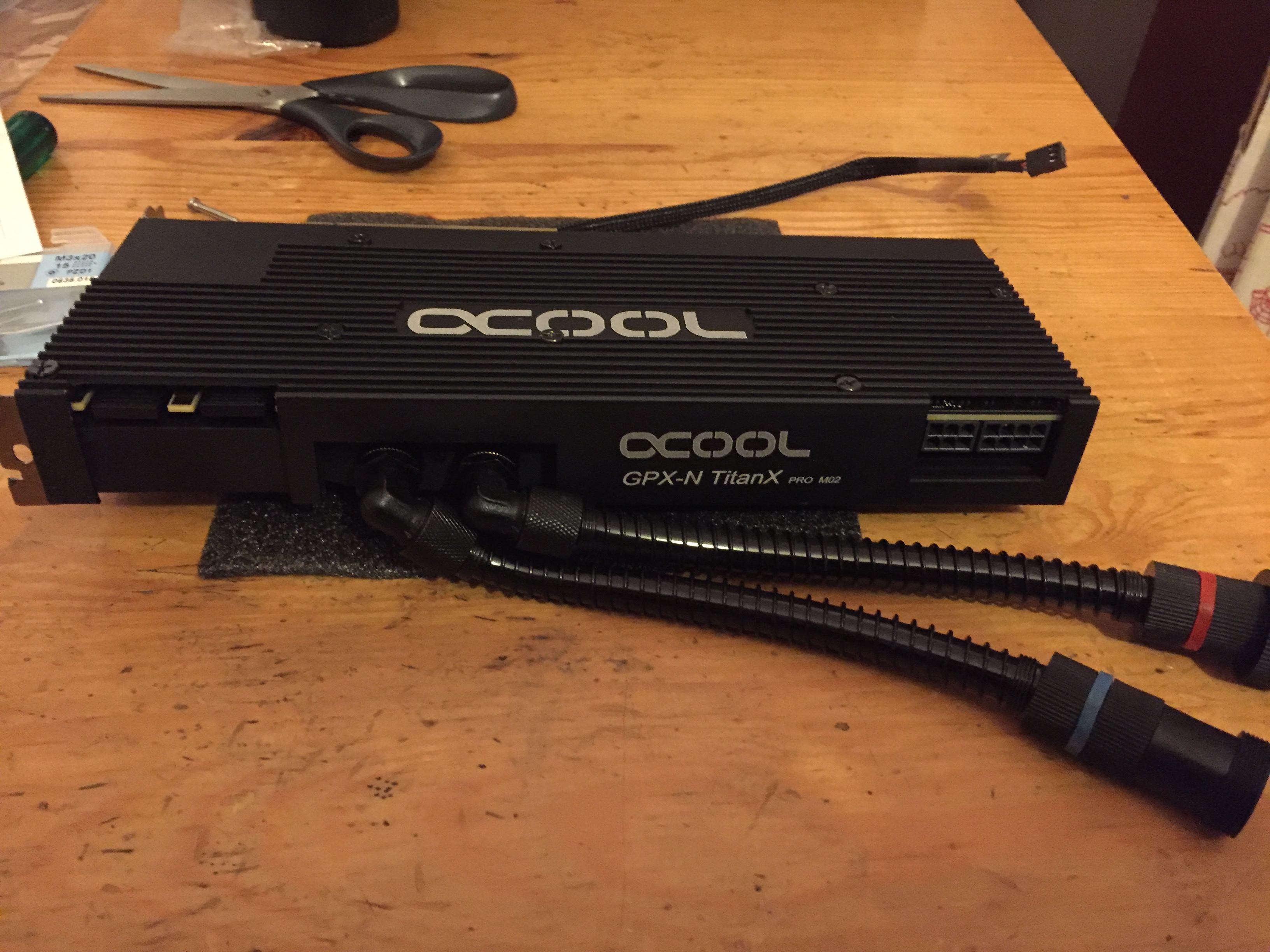

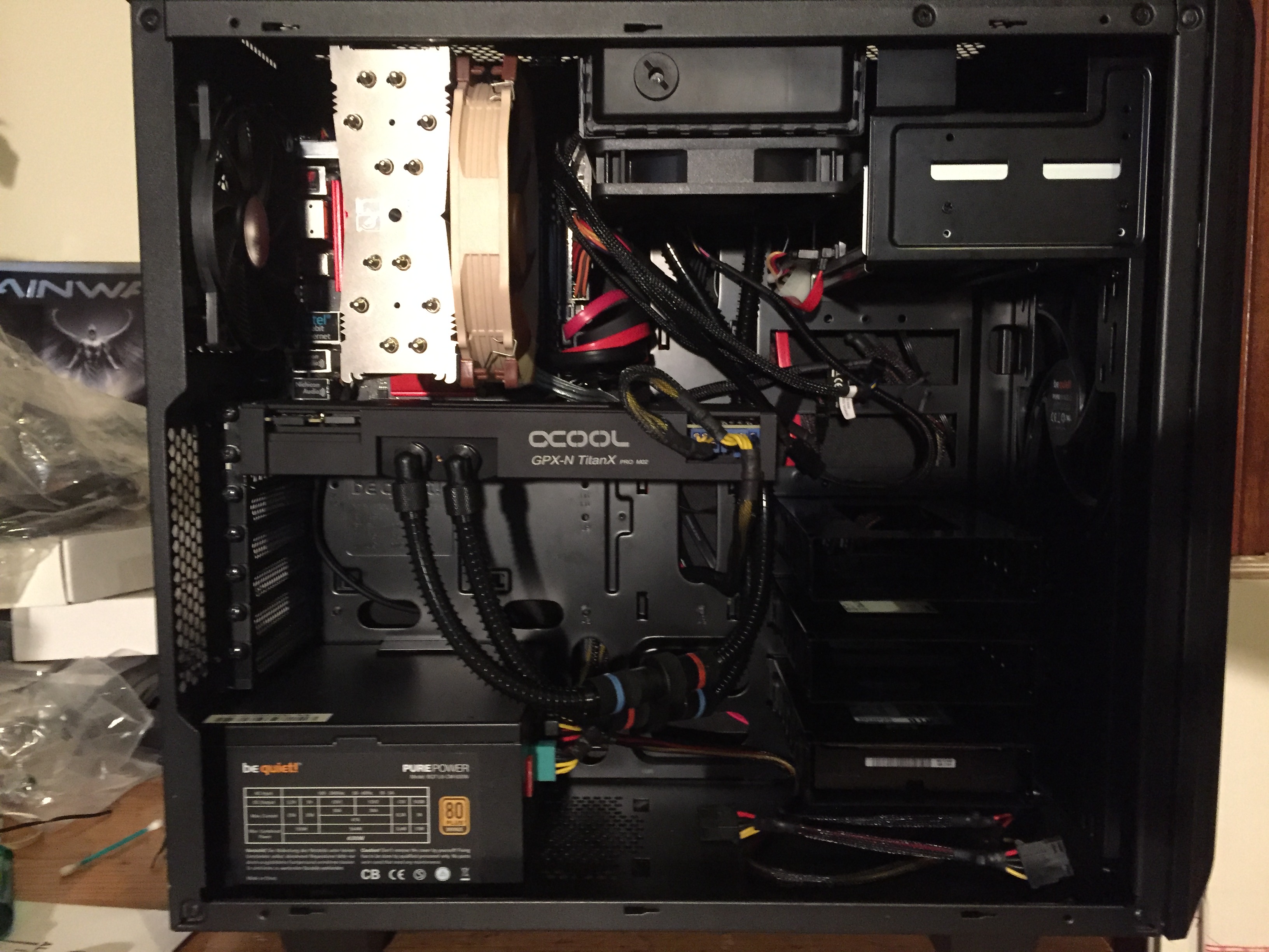

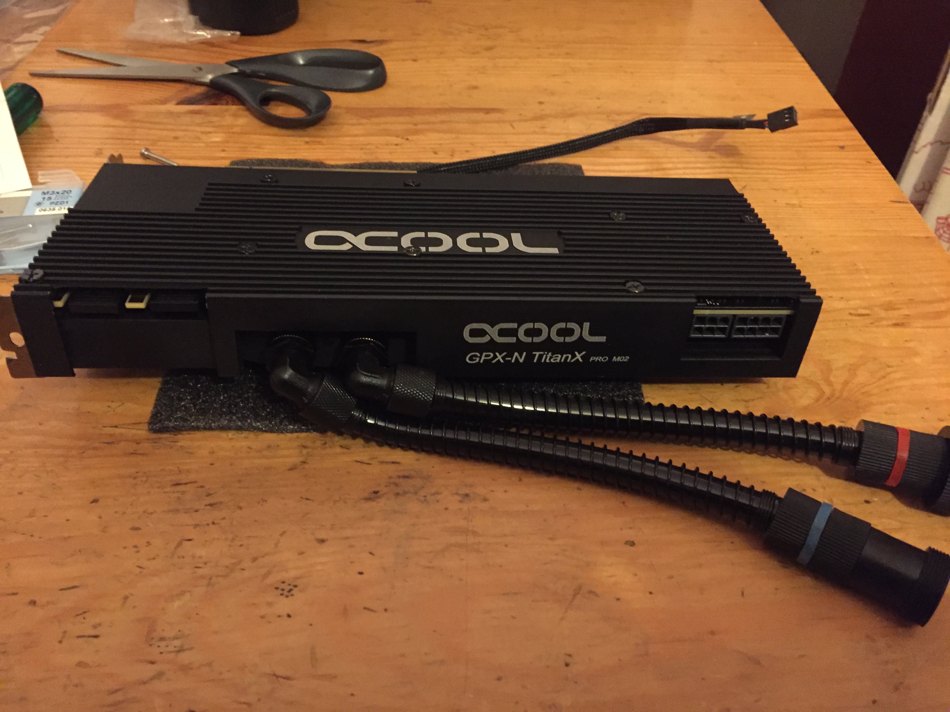

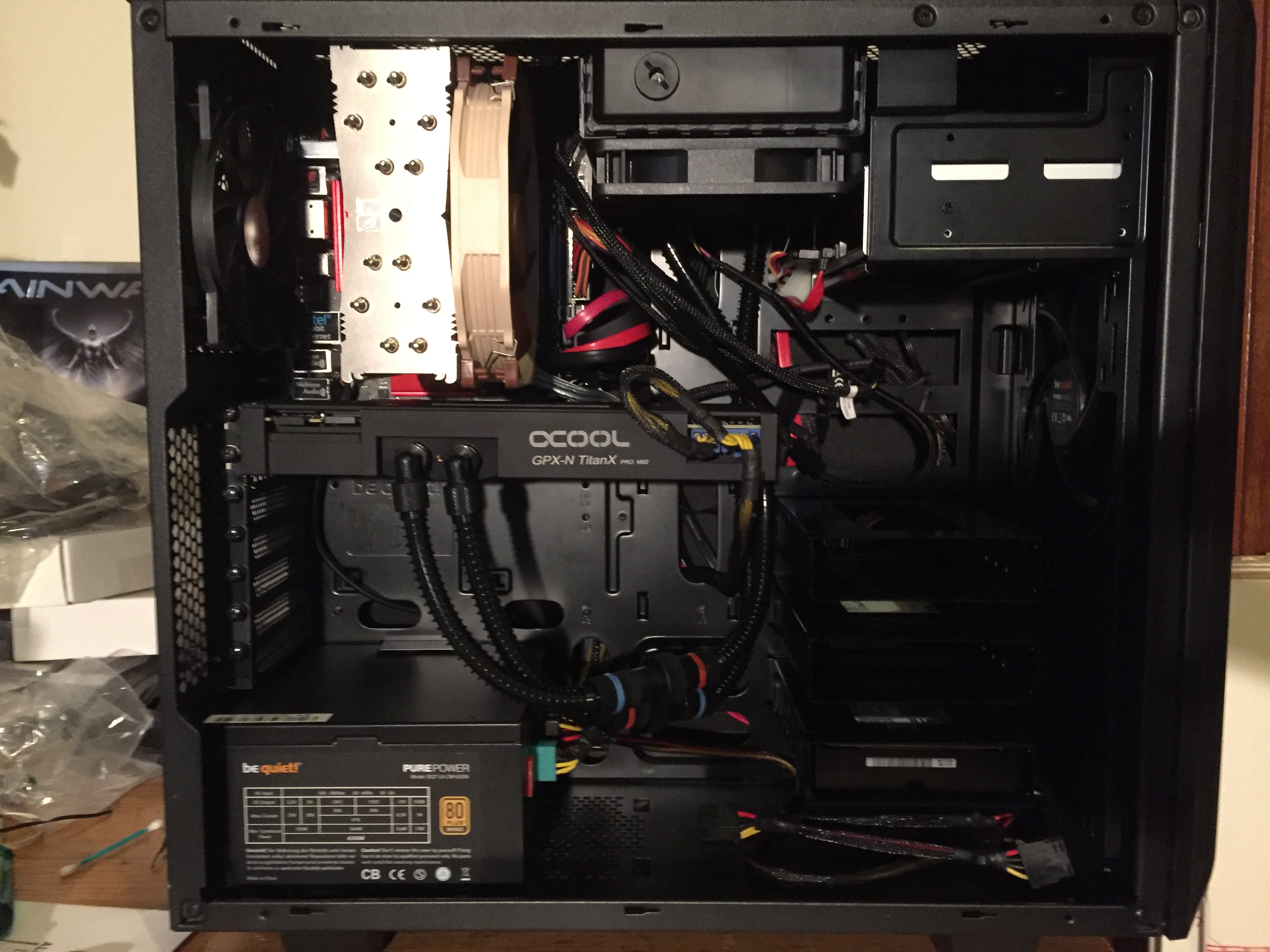

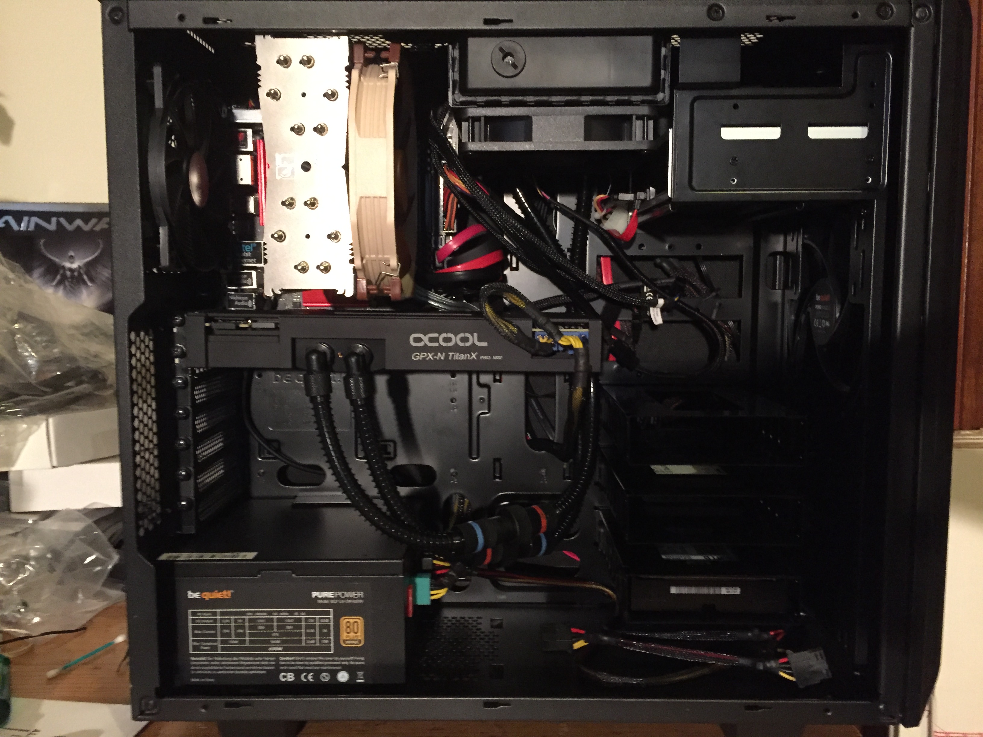

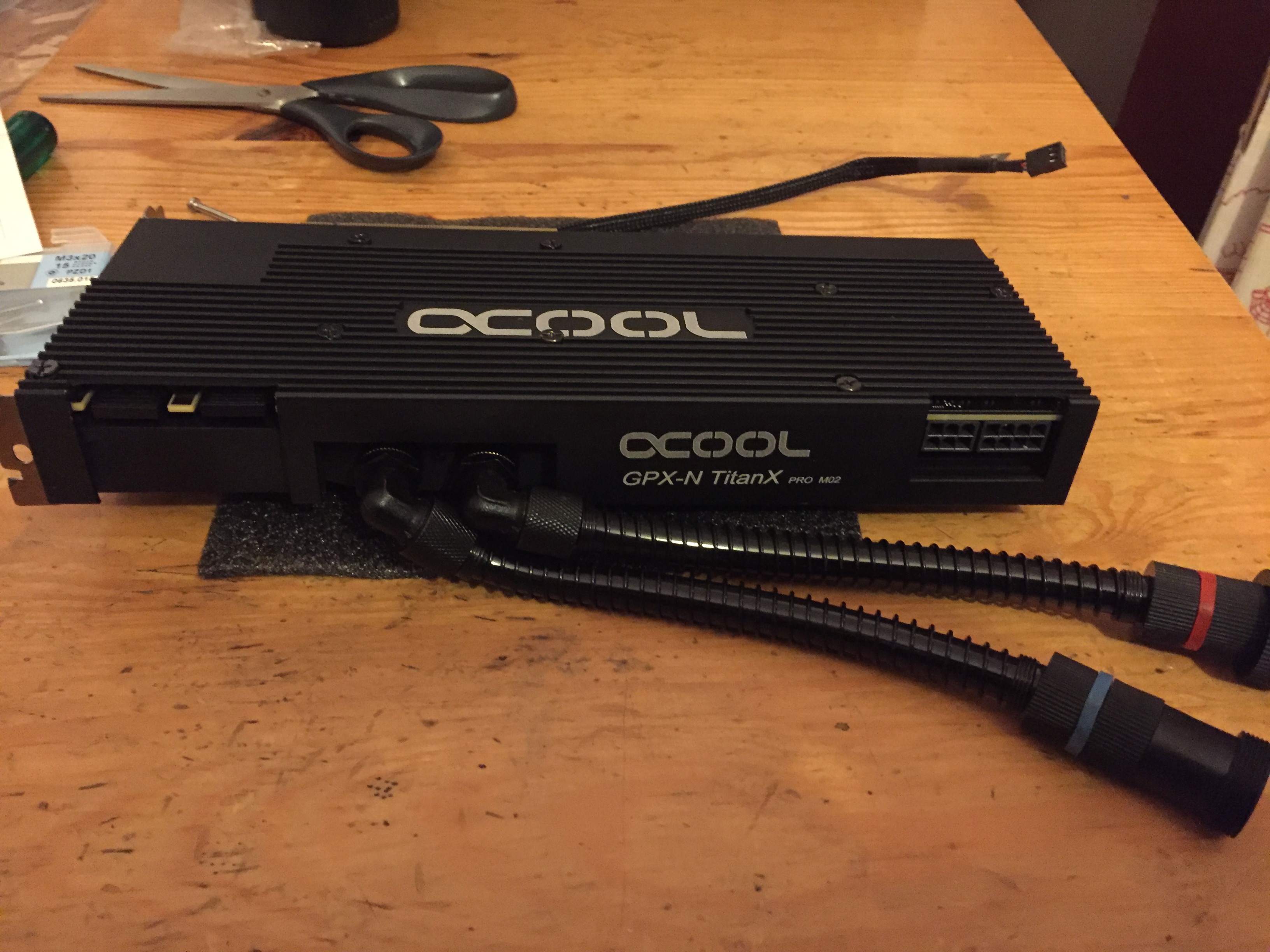

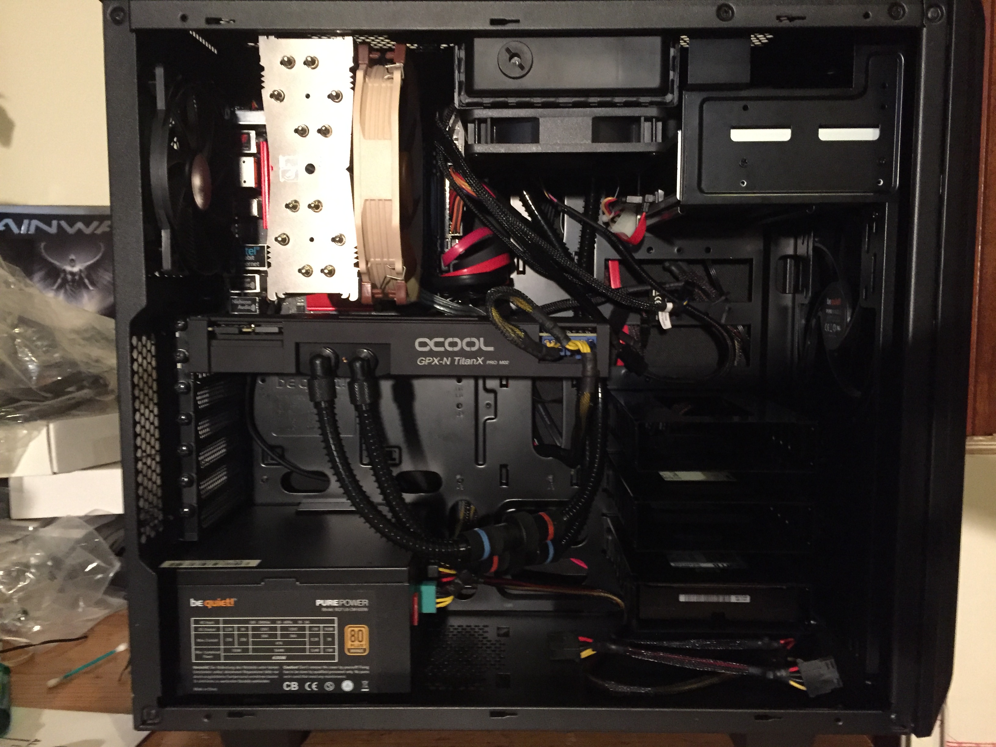

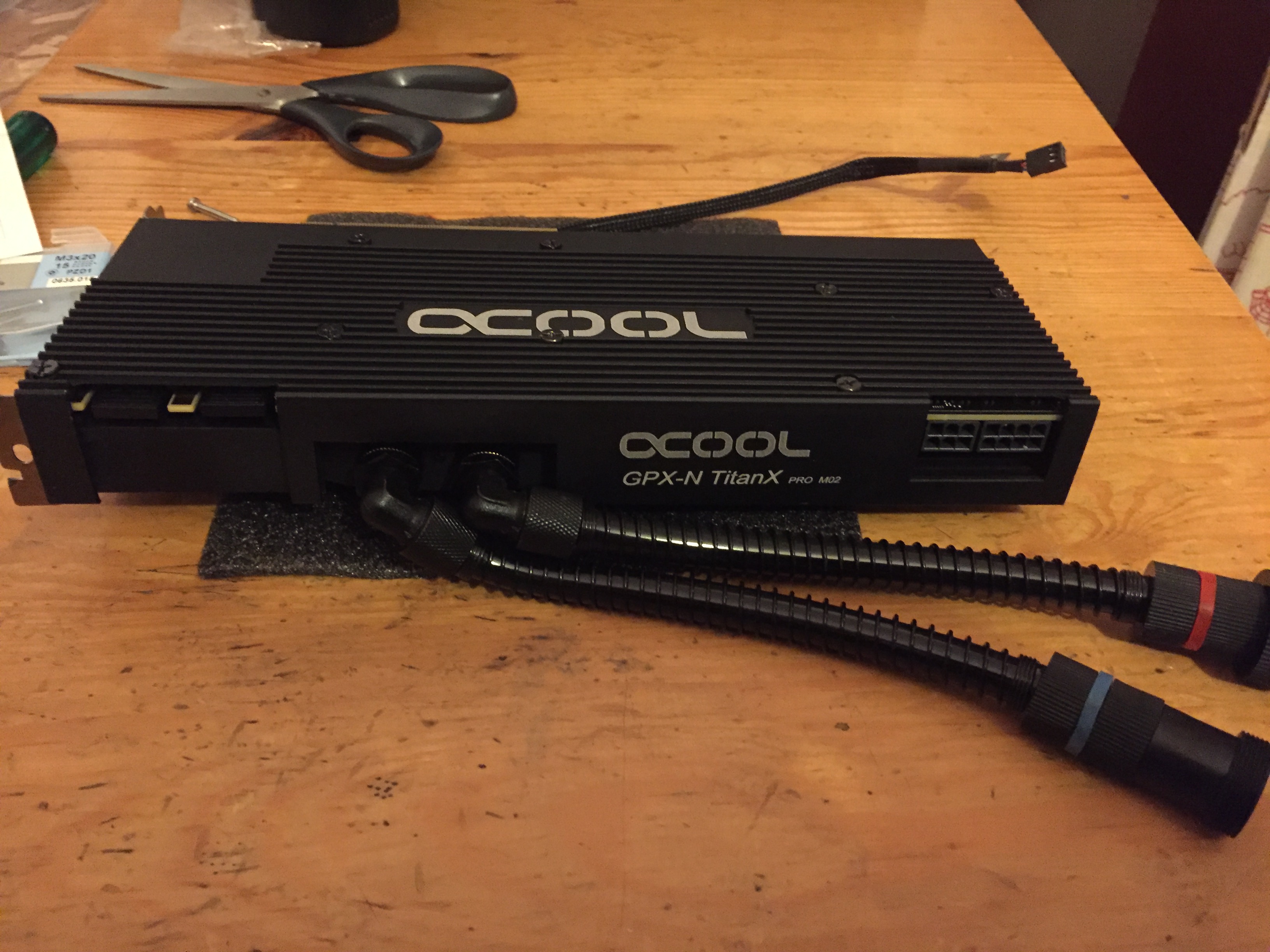

My latest construct. i7-7700K, AsRock Fatal1ty Z270 gaming-itx/ac, DDR 4 2400 MHz.
Noctua CPU cooler not that big, but the GTX 1080 Ti with water cooling (Alphacool Eiswolf 120 GPX Pro M02):
View attachment 710667 View attachment 710668
Nice!

Nice. Is Thunderbolt working for you?
Not yet. But I will try a special UEFI for the ASRock Z270 this weekend.

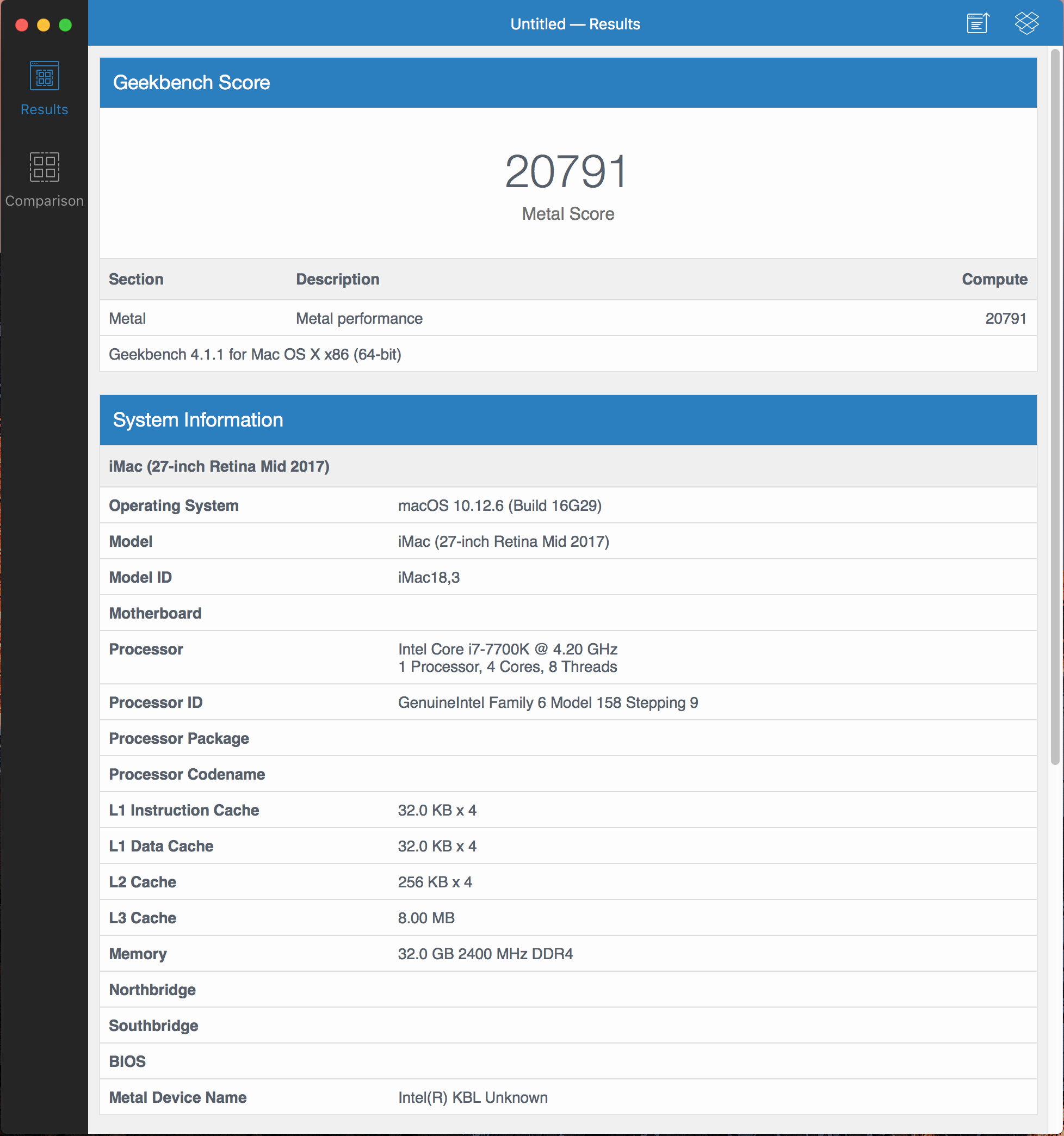

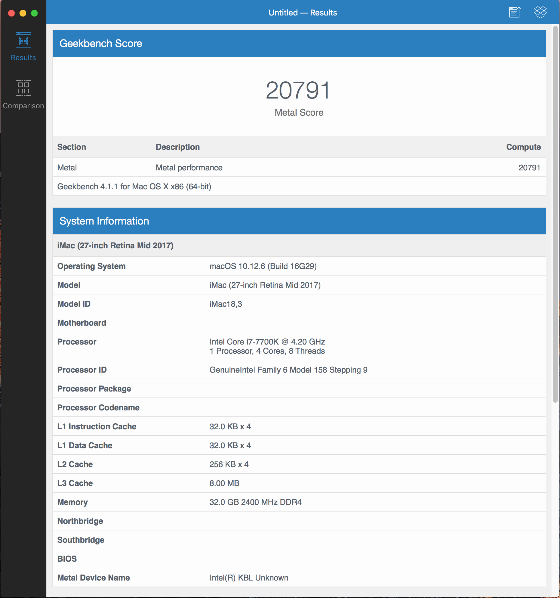

So far the Hackintosh with i7-7700K is better than a native iMac 2017 with i7-7700K (CPU):
GTX 1080 Ti not overclocked.
Geekbench 4 CPU (no OC): https://browser.geekbench.com/v4/cpu/3905497
Geekbench 4 OpenCL: https://browser.geekbench.com/v4/compute/1081327
Geekbench 4 Metal: https://browser.geekbench.com/v4/compute/1081348
Geekbench 4 CUDA:https://browser.geekbench.com/v4/compute/1081354

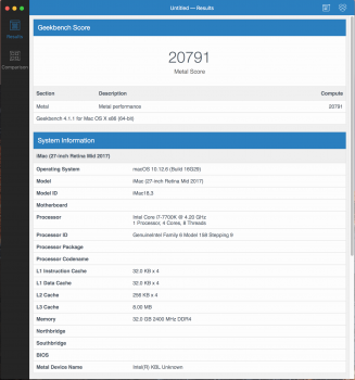

And the Intel HD 630 is working too (Metal):

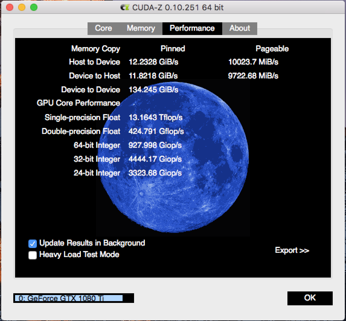

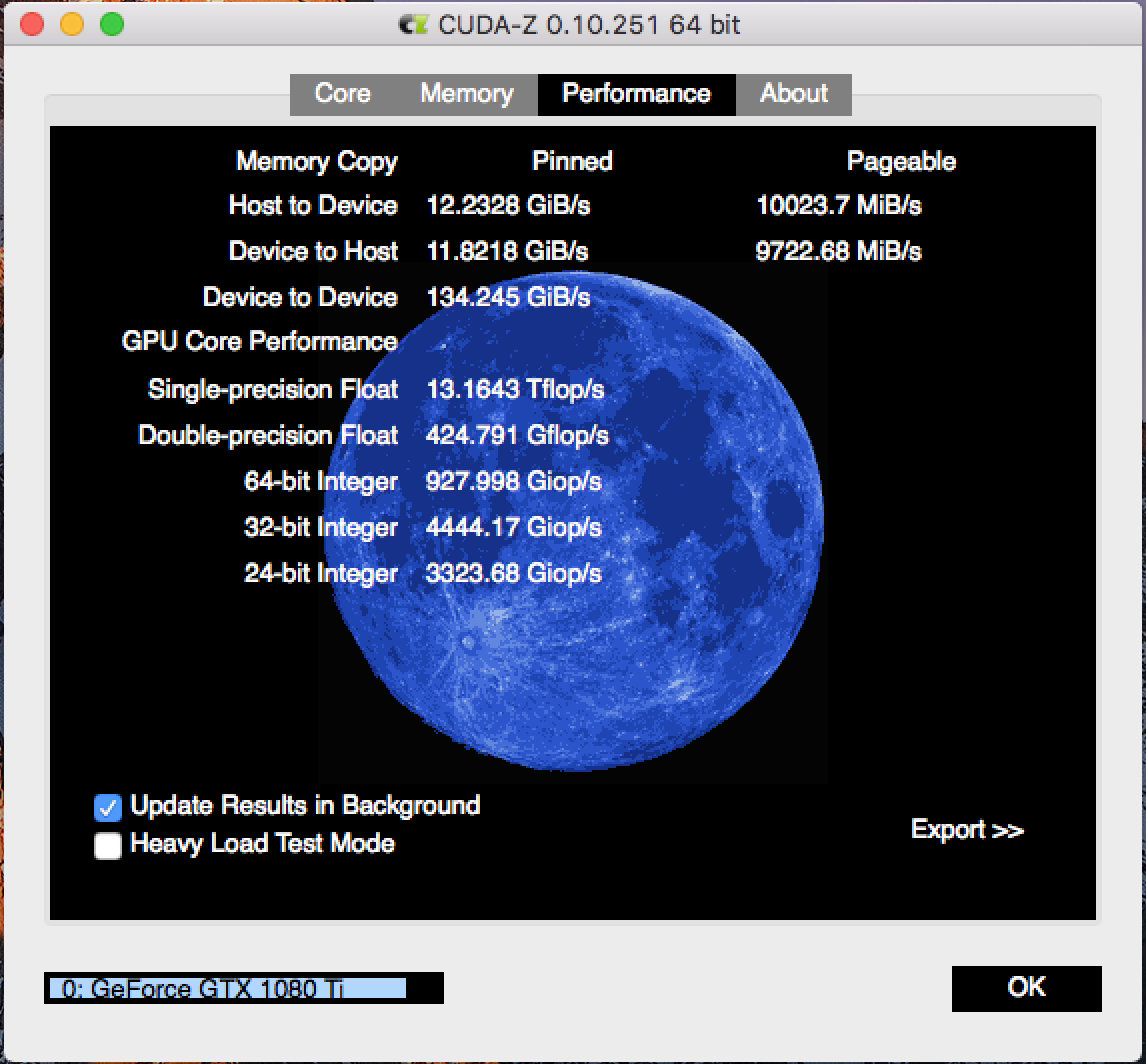

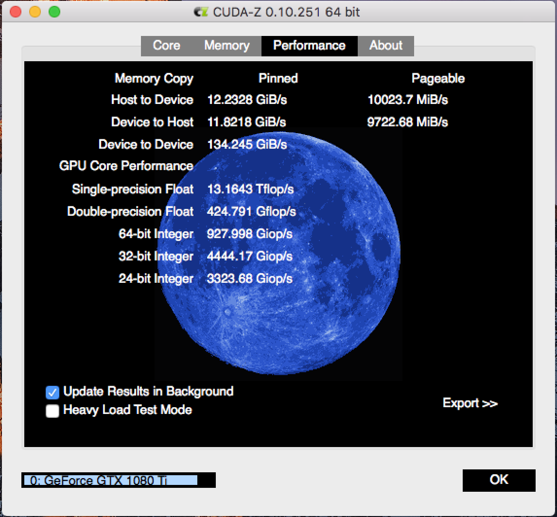

CUDA_Z:
