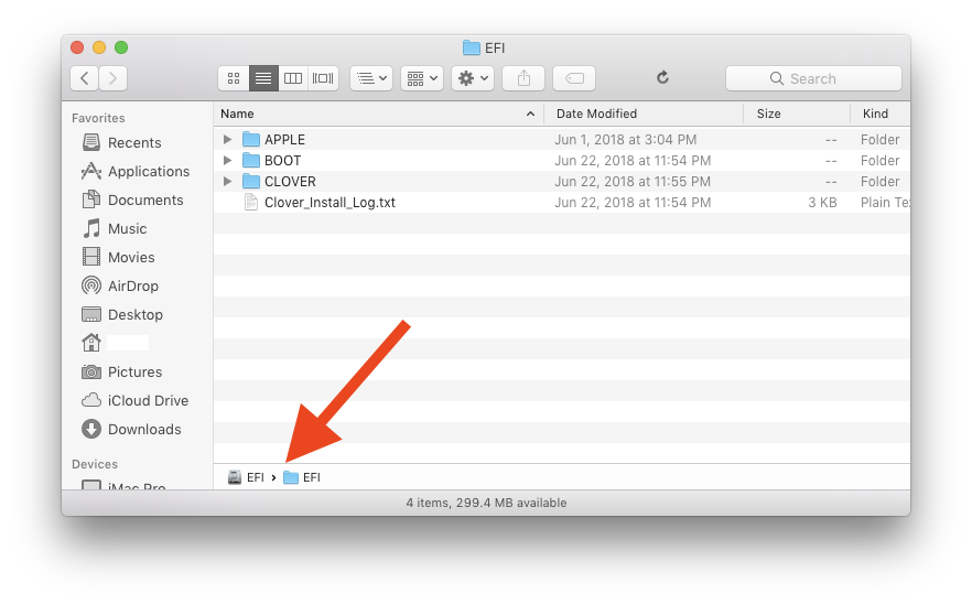

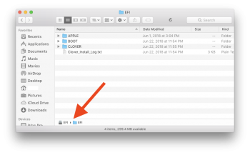

When I switched from my MacPro5,1 to hackintosh, I just put the EFI folder on my MacPro SSD and transplanted it to my hackintosh. Worked perfectly.
Remember, the EFI folders go in to the EFI partitions' root directory.

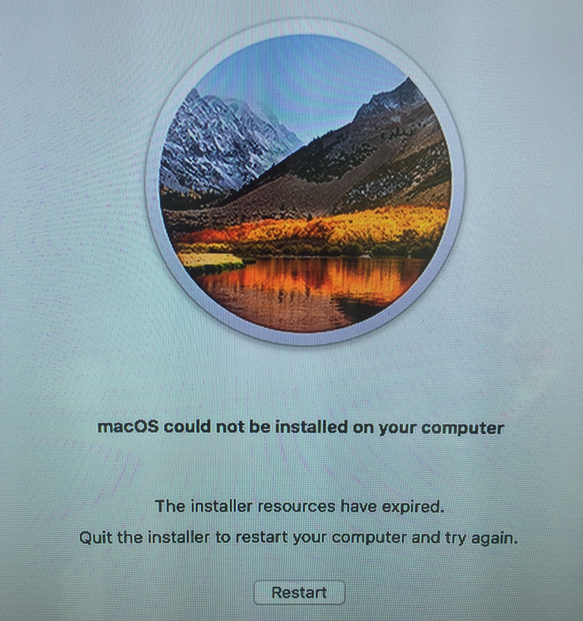

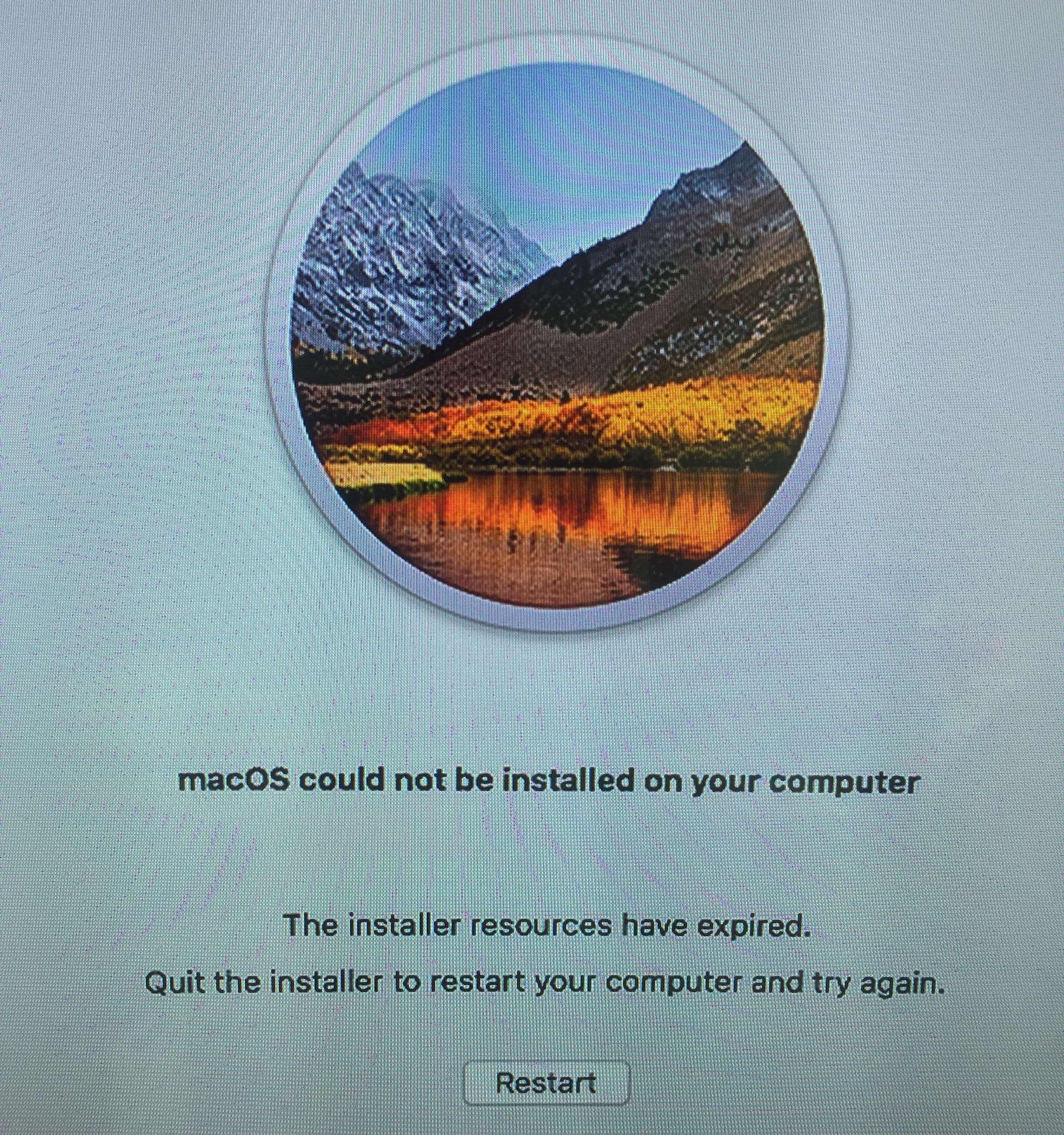

I tried to track the error log during installation, but that’s a bit too fast, something about can’t covert to APFS then suddenly restart even the loading bar no to the end yet (but the target partiton did converted to APFS).
I can manually select the Hackintosh SSD during boot to let the installation continue. But that may be the reason causing this failure during installation
[doublepost=1530258203][/doublepost]Anyway, obviously clover works, MacOS / installer can boot. So, if the problem is just can’t perform the MacOS installation. I can easily overcome this by cloning the current working OS to there.
[doublepost=1530258413][/doublepost]I have 100% confidence can make it work now. Thanks partychef! Just need some time to make it work later :D
[doublepost=1530258964][/doublepost]As long as I can make his thing boot MacOS and read all my current Mac Pro’s drive. I will have no fear about the Mac Pro failure anymore. This should be fairly easy to achieve :)
[doublepost=1530259125][/doublepost]In fact, I completely forget your post (about how you transfer from Mac Pro to Hackintosh), but just keep reading the TonyMac website about how to install macOS via USB. I shouldn’t do that at the beginning. I should just follow your “clone method”. Again, Keep It Simple Stupid is the way to make things work.

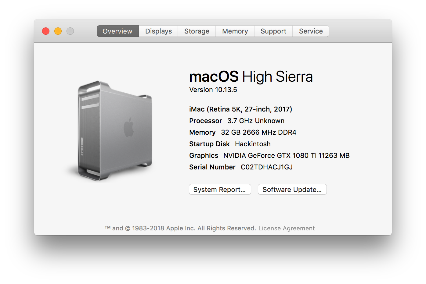

Yes, I read that. Will double check that if I can't boot from the clone.
Anyway, if I can boot from clover, does that mean this is not an issue already? Or can still causing unknown bug?

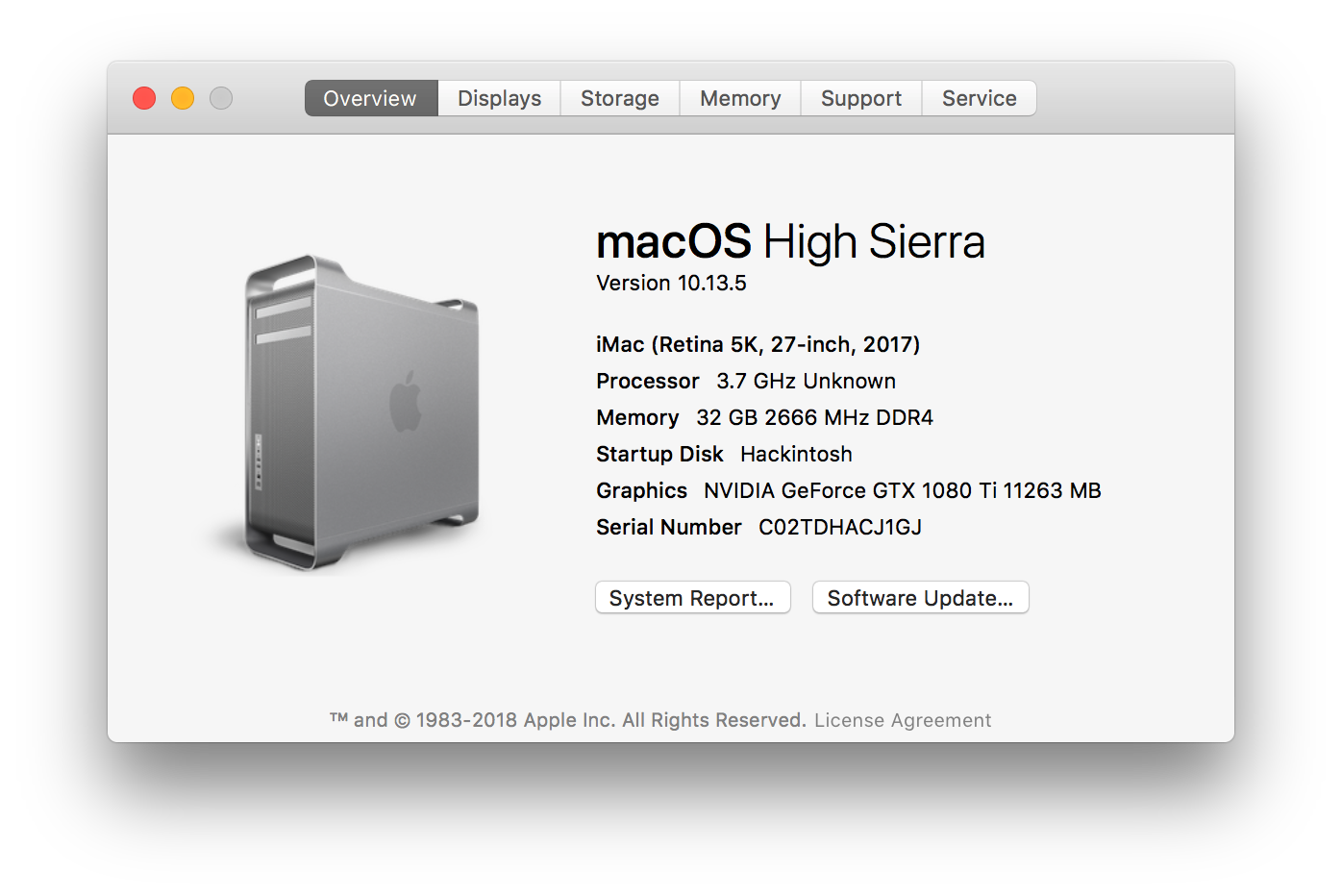

[doublepost=1530263898][/doublepost]The clone method work! Exactly two steps. Clone and copy EFI folder, that’s it! I didn't even clone the whole user profile to the new SSD, but just part of it for testing purpose to save time. It can still boot.
Thanks for pulling me back from the “wrong” way.
[doublepost=1530264379][/doublepost]It’s so simple, no more black screen even using 1080Ti.

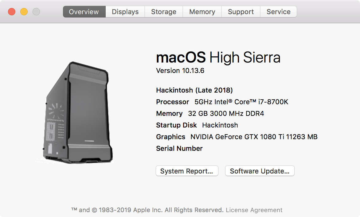

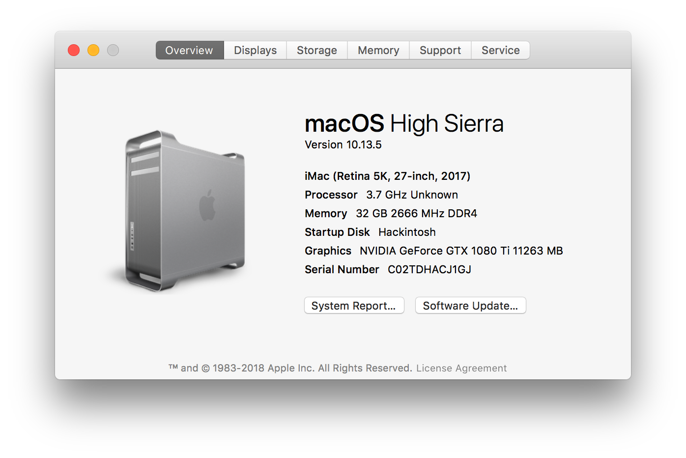

Finally have some time to learn more about the Hackintosh.
Manaually tuned the CPU to reduce operating temperature (rarely go above 70C now).
Memory speed fine tuned.
Latest clean 10.13.6 installed.
Switched to APFS, so far so good.
Clover updated.
Learnt how to remove the 15 USB ports limit.
Learnt how to fix audio.
About My Mac info edited.
The next one will be learn how to identify each USB port and properly disable the unnecessary port to make it natively run at 15 ports. Already finish the reading, just need some time to do it.
Also, I may replace all stock case’s fans by the Noctua fans. The stock fans are OK, not too noisy, but just loud enough to catch my attention. I think the Noctua fan can do much better.
And realised that as long as the initial Clover installation is done. And clone the whole EFI folder to the backup boot drive. Then it’s almost like handling a Mac.
In fact, I intentionally use Clover (from SSD) to boot the 10.13.6 USB installer (native MacOS created installer for real Mac, not unibeast). I can use that to erase the SSD (just the OS partiton, not the whole drive. Similar to what we can do in the recovery partition), and install MacOS natively like a Mac does.
If this can be done, then nothing on the Hackintosh is not recoverable. With multiple drives and multiple Clover installation on each boot driver, then the setup will be extremely safe. No matter we mess up the OS or mess up the primary drive’s Clover. We can still easily boot from another drive (another good Clover) and fix the bad one.
This Hackintosh is still mainly a Windows computer at this moment becasue i want to utilise the 1080Ti’s video hardware encoding ability. Also, only Windows can release the true power of the 1080Ti in gaming.
I only have 2 computers. So, make much more sense to let you cMP continue serve as the primary MacOS computer for all daily usage. And let this Hackintosh ready PC serve as an assistant computer with Windows to do everything that MacOS can’t do.
But at least, I now know how to transplant all my hard drives to the Hackintosh to “respawn” my cMP in no time if it die again. TBH, the cMP is getting old now. More and more strange failure cases on different forums. Really can’t let it be my one and only one computer.
Once again, pastrychef, thanks for brining me to this route, your “EFI” folder save me lots of time.

Please try this EFI folder. It should allow you to boot in to macOS whether it be a clone of your Mac or the macOS installer as long as it is macOS Sierra or higher. Mojave public beta should be fine too.
