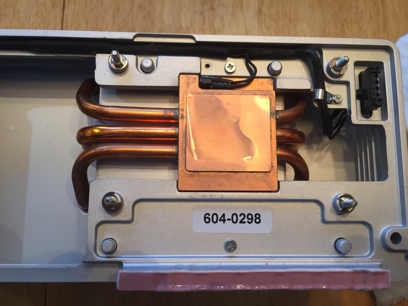

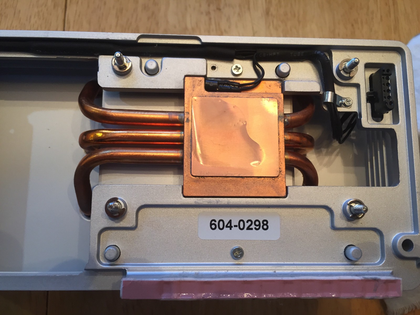

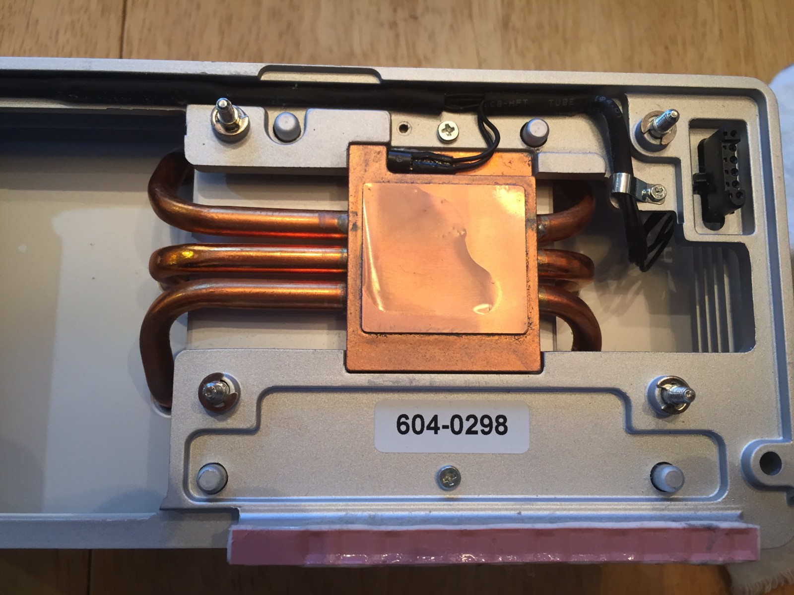

Apple used all aluminum heatsinks on the Mac Pros 1,1-5,1 so don't use the liquid metal on them!!!
Yeah, I needed 1.4v to get my i7-8700K to 5.1GHz. I felt that was too much and I backed it down to 5GHz and have been running it at that speed for close to 10 months now. Rock solid.
I mean the contact point, not the heatsink main body. That looks like copper to me.
Reactions: peanuts_of_pathos
You can also use the liquid metal on your video card if the heatsink base is copper or nickel plated copper. I did it to my Vega 56 and saw very nice improvements.

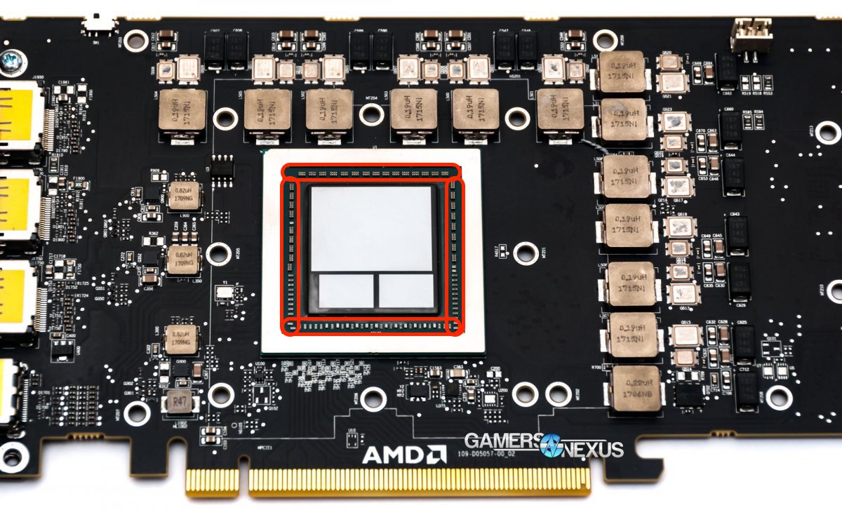

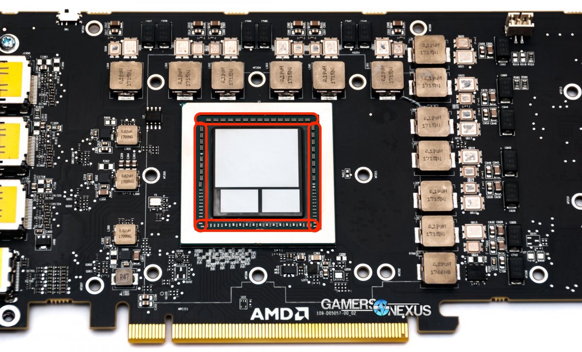

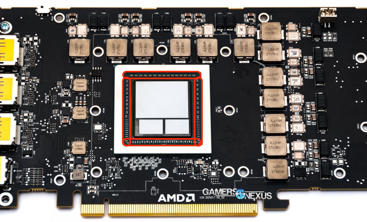

May I know did you give these components any protection when you apply liquid metal to the GPU?
They looks very close to the chip. Even I have confidence I won't apply any liquid metal directly onto those electronic components. I am thinking may be I should apply some colourless nail polish to protect them.

Yes. I applied some clear nail polish on the components around the GPU die and HBM2. That should prevent any damage in the event that liquid metal leaks.
After doing this, I used undervolting and overclocking on my Vega 56 to bring performance to near or better than stock Vega 64 levels while still keeping temps at or below 80C. Keeping the temps at or below 80C is important because it prevents the Vega from throttling. I did this with a reference style cooler/heatsink.

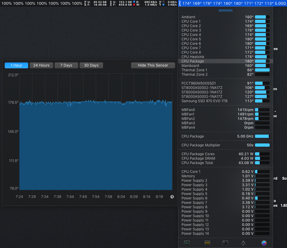

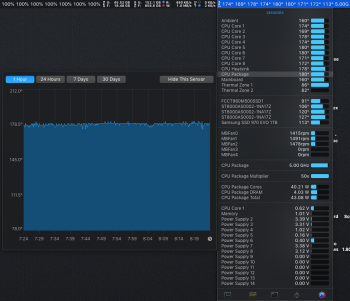

Just take my time to apply liquid metal to RX580 and W3690. Success!
And now, with undervolt, even running Furmark, my RX580 won't go over 75C, and don't even need full fan. And I need 10min Furmark to make it achieve 75C temperature. The cooling is definitely more effective than before.
On the cMP, the effect is again very noticeable. The CPU now can hardly go over 76C with roughly idle fan (system ambient 33C). With AS5, it usually stabilised at 78C with fans spin up to around 1350RPM (my own fan profile). And that figure was with 30C system ambient.
Even I don't really need it, but quite happy now. Let the liquid metal do its job is better than let it sitting in my tool box.
The next one will be my Hackintosh's 1080Ti, but I really need some time to study how to open the PNY XLR8 1080Ti properly. It doesn't like normal card. e.g. It seems the backplate cannot be removed. An interesting card.

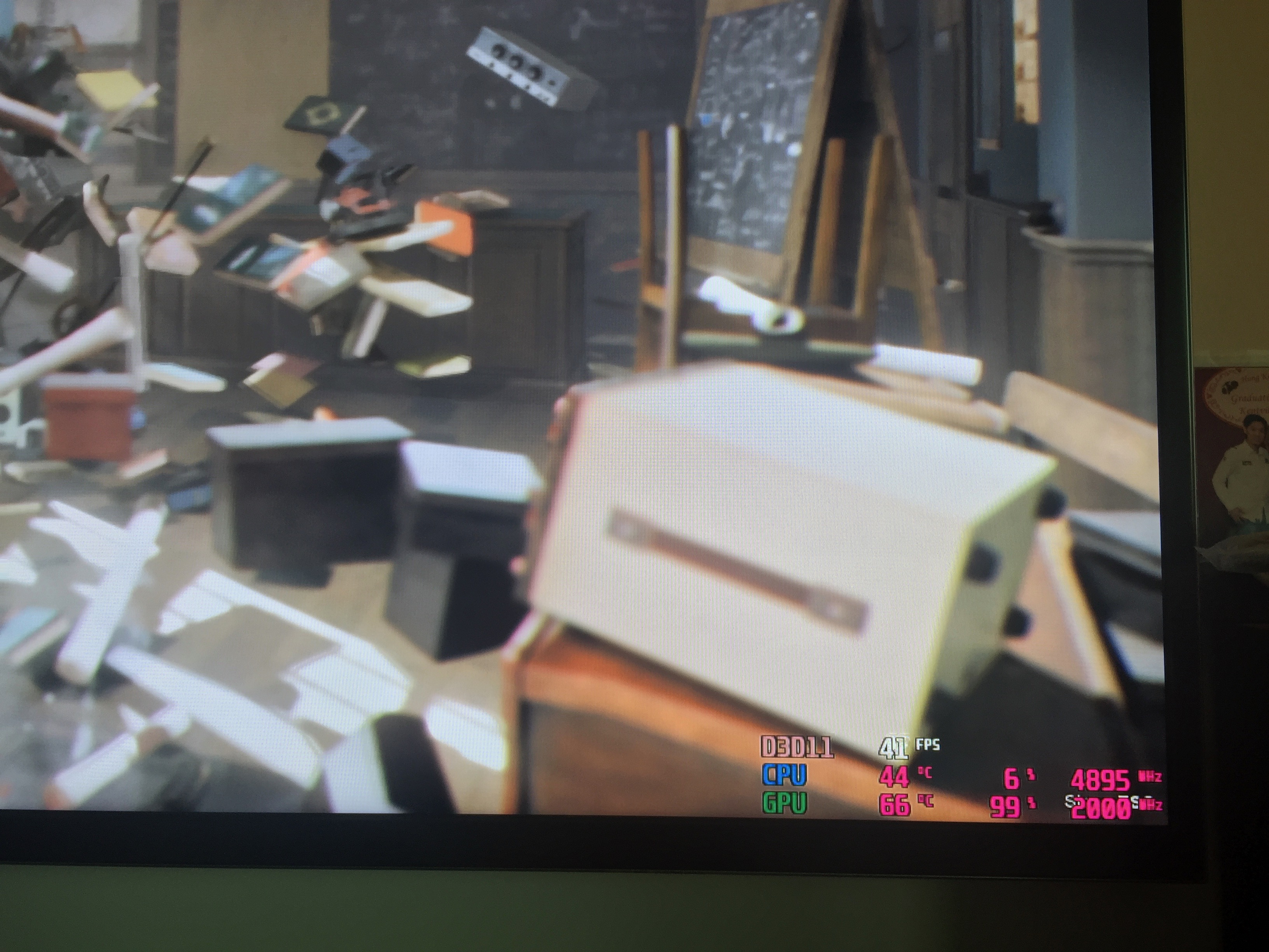

Update 1: 1080Ti also done. Crazy effective now. Can run Superposition @2000MHz and the GPU can just touch 71C. Again, that's 15C cooler straight away.
Anyway, learnt something. Those colourless nail polish works.
When I apply liquid metal. I usually apply it to the surface, then turn it upside down, and use the
syringe to suck out all excess liquid metal (the liquid metal will looks like stalactite if too much. So easy to determine).
However, this time, due to the fan connector is so tight. I don't want to pull it too hard just in case break it. So, the cooler was attached to the card all the way when I mod it. Therefore, it's not that easy to turn the card upside down. So, I skip that part, and just apply liquid metal like normal thermal paste application. Apply it, looks good, then put the heatsink back on.
But this time I am over confidence. The PNY cooler is really well manufactured. The gap between GPU and heatsink is really tiny. Even the liquid metal looks thin enough to me. Actually, still has little bit leak at the corner position (when I put the heatsink back on).
Therefore, some of liquid metal "touched" those resistors that right next to the GPU die.
I didn't know about it. Just re-assembly the Hackintosh and fire it up......no image. Change the output to use iGPU via motherboard HDMI, the Hackintosh still working, but the computer can't see the 1080Ti. Oh~ I may damaged it.
So, open it up again, and I see the leakage now. Then I use forceps and some tissue to remove the leakage, and try to put the heatsink back on a few times. Make sure nothing will spilt out and able to touch those resistor again.
Once finish, re-assembly the card (and the Hackintosh). The 1080Ti back to alive!
So, those nail polish works, nothing really breaks. And I am a happy Hackintosh user again :D

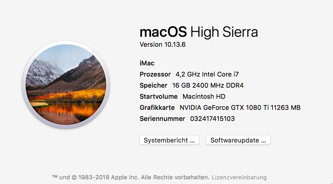

Hey Guys,
I just wanted to share my first hackintosh experience with you.
What is it?
- Corsair one pro ti (7700k, 16gb ddr4, 1080ti, 480gb m2, 2tb hdd)
- macOS high Sierra
- Dual Monitor via DP & HDMI
What works?
- iMessage (out of the box)
- AppStore (out of the box)
- sleep/wake
- nearly everything else
What does not work?

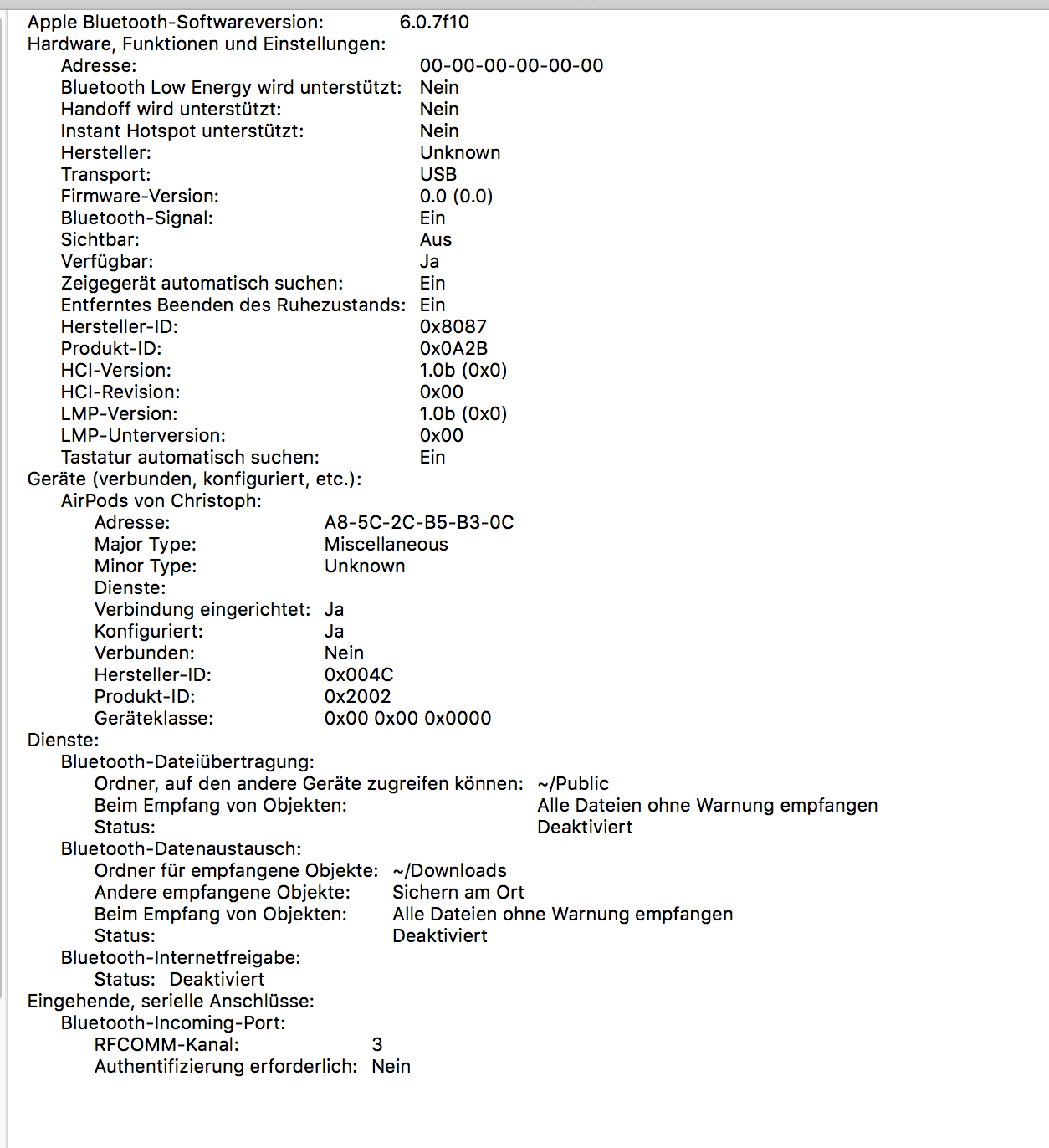

- WiFi
- Bluetooth (it says working, but it isn’t, and i don’t know where to get a kext)

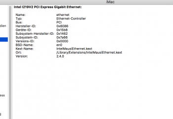

- LAN is super slow, shows about 5 MBit while my MacBook Pro gets 400k (don’t know how to fix)
I’m extremely satisfied with this setup. It works just like you’d expect a Mac to work - in a small and good looking form factor.

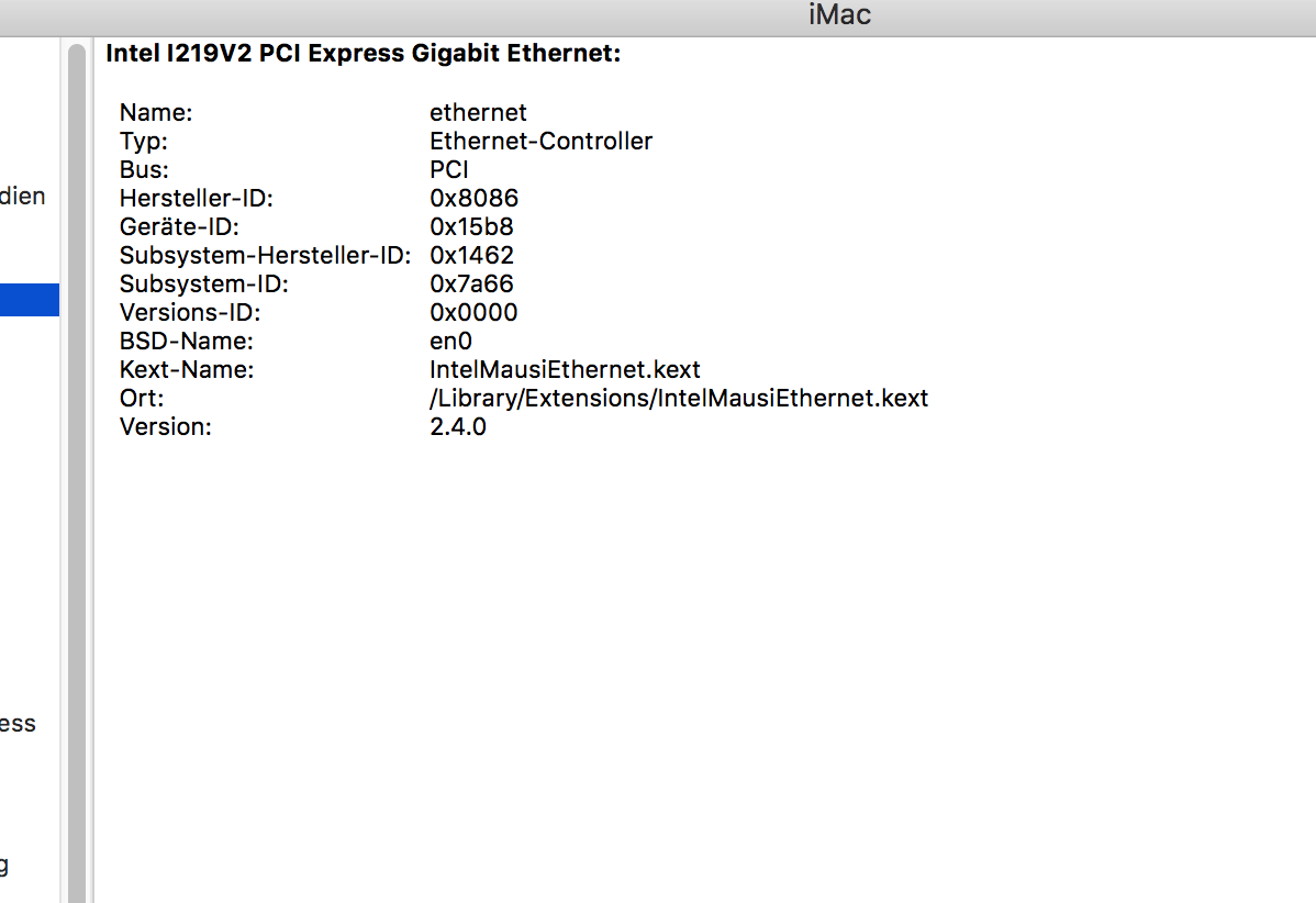

You will likely need to swap out the Wi-Fi/Bluetooth card for a compatible one for Wi-Fi to work.

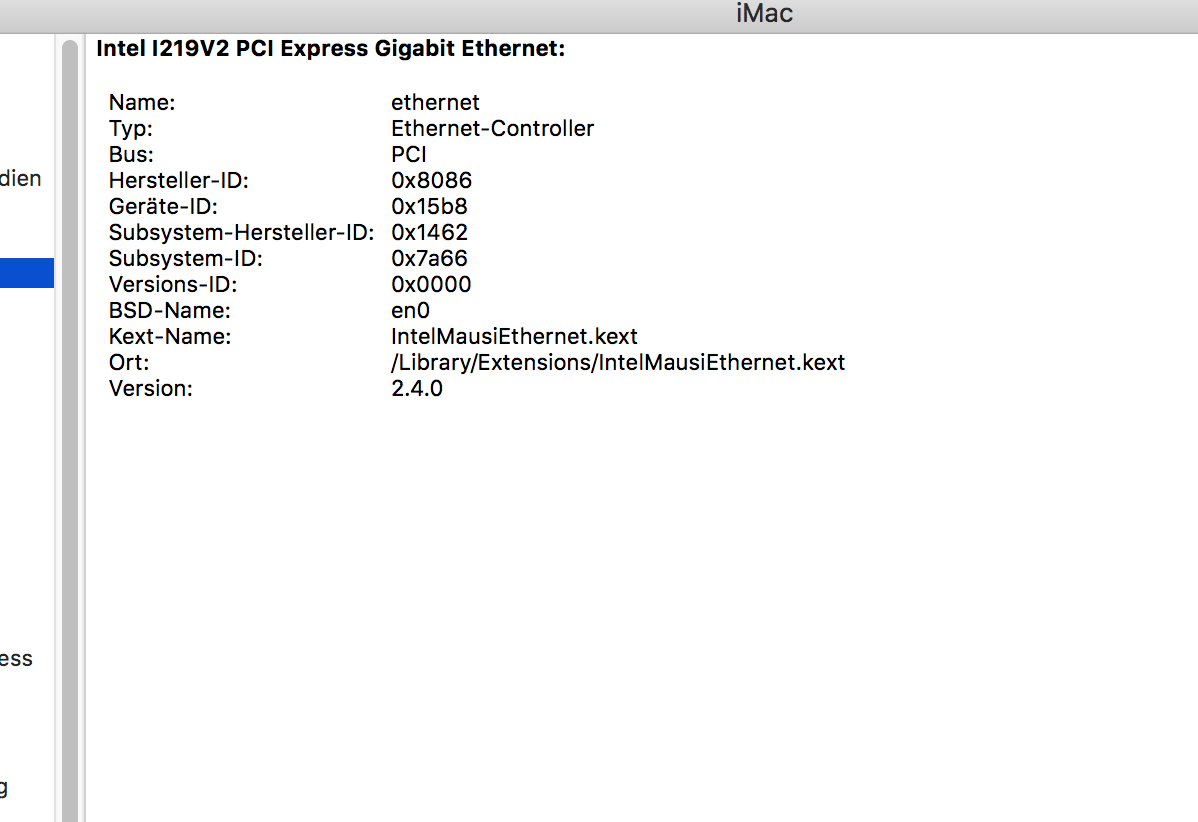

What kind of NIC does your computer have? Are you using the correct driver for it?
It looks like you have the right driver for your ethernet. Not sure why you are getting slow speeds.

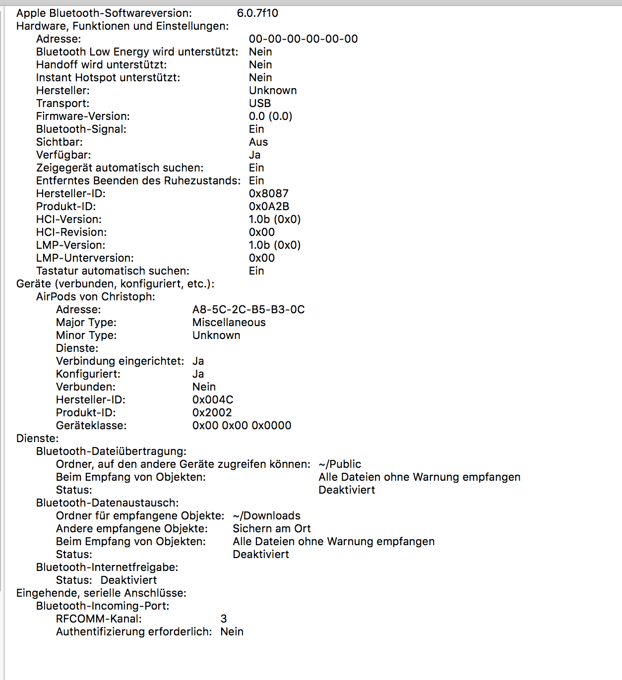

Your Bluetooth needs some work... Please see here: https://github.com/RehabMan/OS-X-BrcmPatchRAM

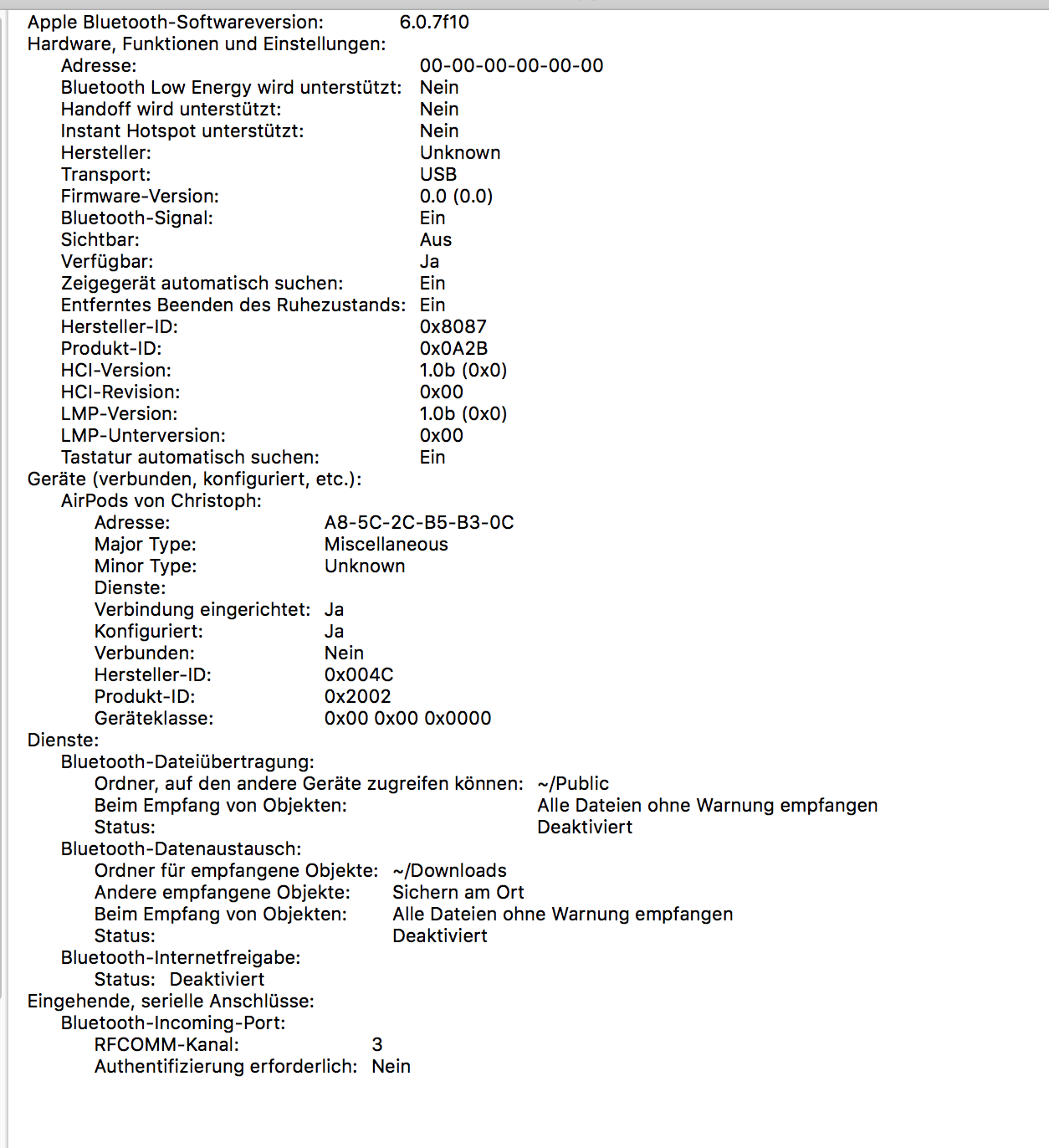

Okay. I tried and I tried and I tried, but I just can't get it to work. So I thought a bluetooth dongle (CSR) might solve the problem - but it didn't. I think the main problem is, that MacOS recognizes the internal bluetooth as working and prevents bluetooth from the dongle.
I tried it with bootflags to disable the internal bluetooth -> not working
any ideas?
any ideas?
I need more info. What kind of Wi-Fi/Bluetooth card are you using? Which kexts are you using? Have you made an SSDT for USB?
okay, don't ask me why, but my internal bluetooth started working today. I installed parallels for app-testing purposes and decided to play a bit with the bluetooth dongle. So I tried to connect the internal BT and the dongle to windows, both worked. When my internal bluetooth was connected to windows, the dongle worked on MacOS. But after a complete restart of my hackintosh things got very strange: macOS started to recognize my internal bluetooth - and now it seems wo work like a charm without any help of the dongle.
