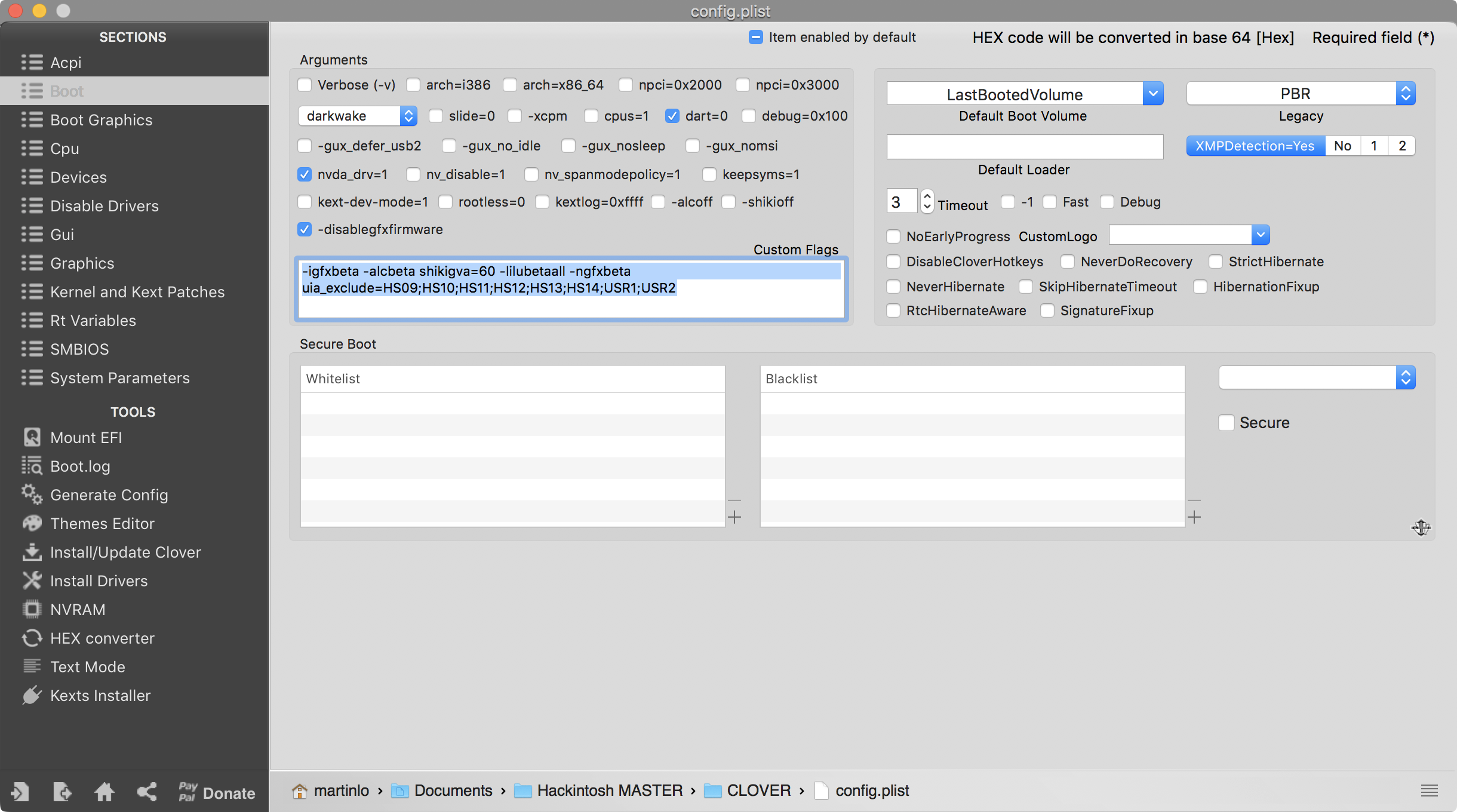

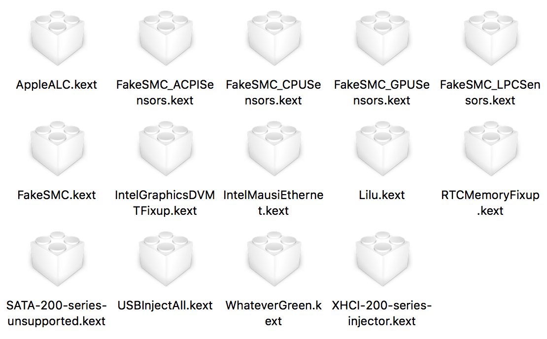

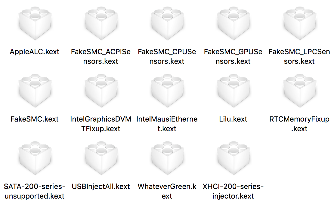

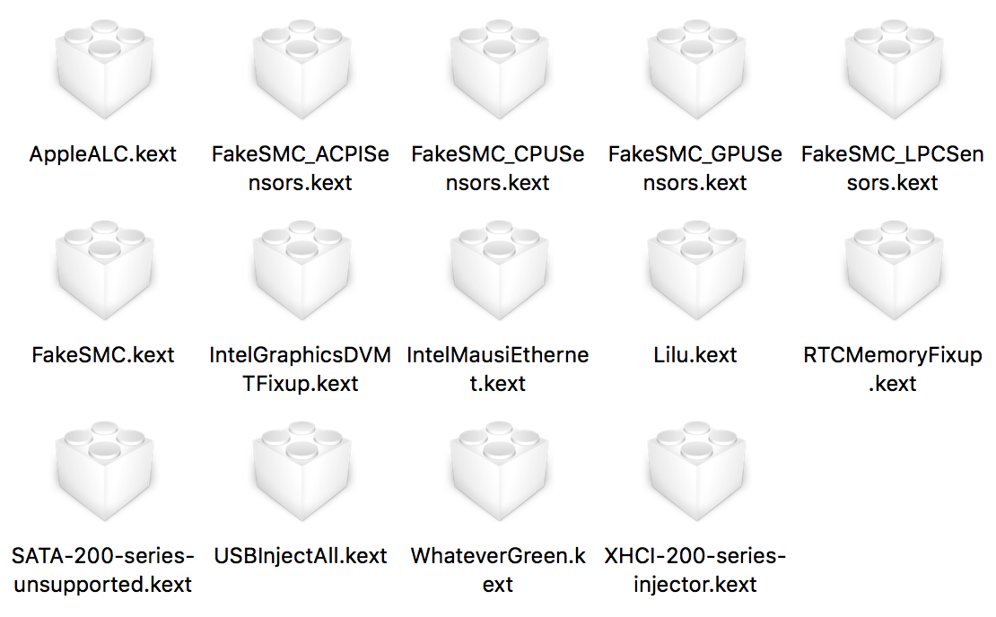

TheStork, may I ask you some questions about Clover boot arguments?
This are all the kexts I have in EFI/Clover/kexts/Others

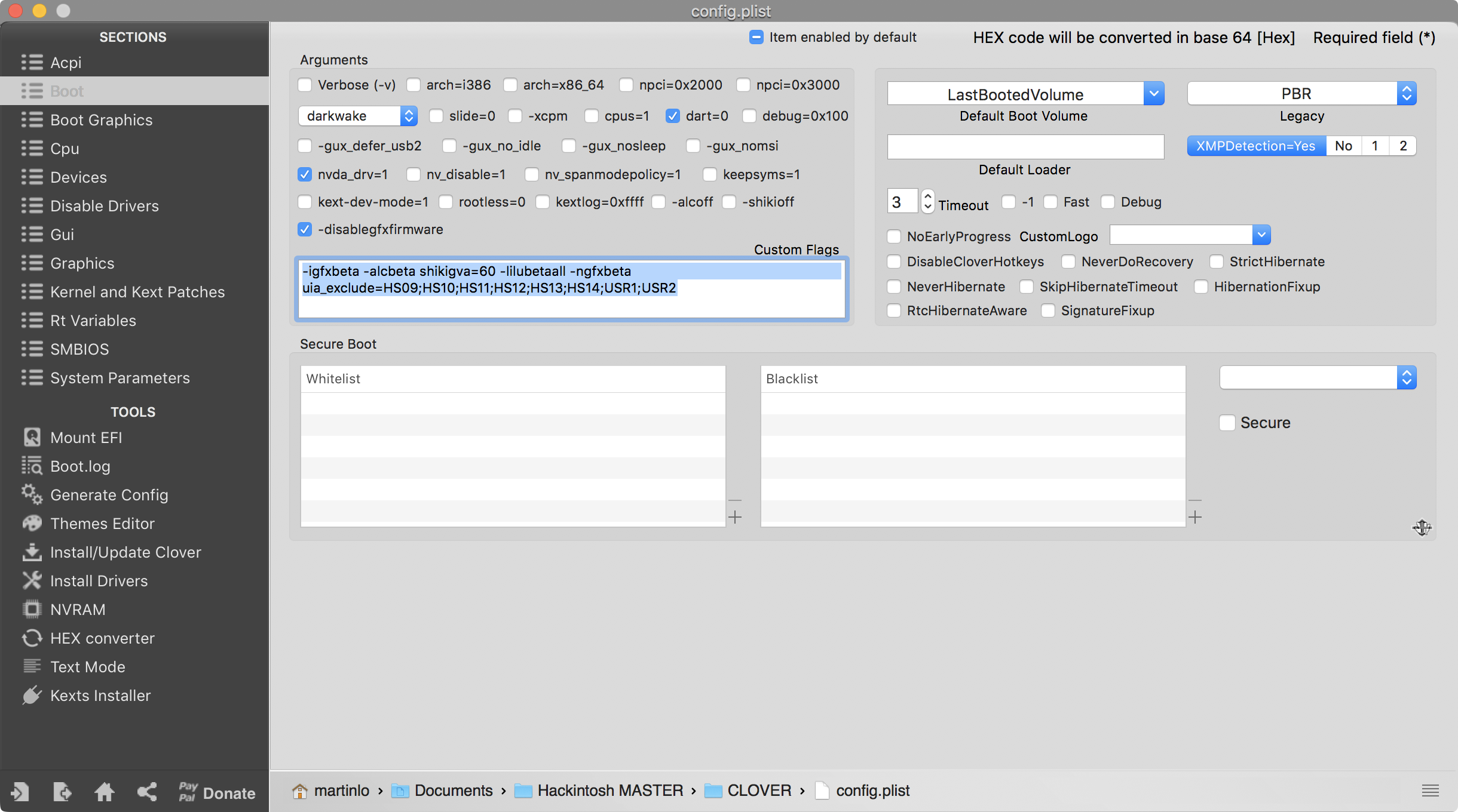

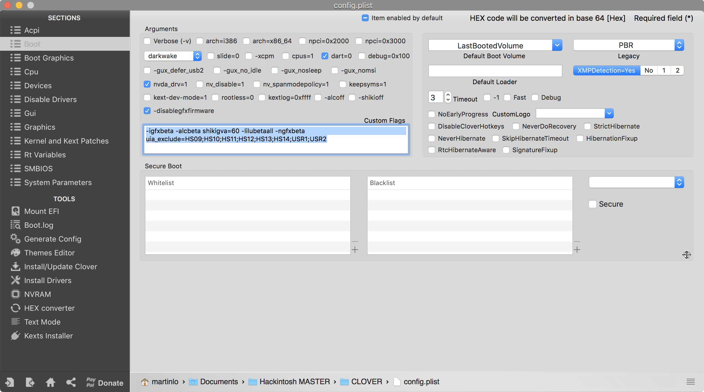

And this are my boot arguments
Am I correct that "-igfxbeta", "shikigva=60" and "-ngfxbeta" has no function now and should be removed? Because IntelGraphicsFixup.kext, Shiki.kext, NvidiaGraphicsFixup.kext are all removed (integrated into the WhateverGreen)
Million thanks in advance!
I don't have any kexts in /EFI/Clover/kexts/others/. All of my "hackintosh" kexts are in the /Library/Extensions/ as that's where MultiBeast puts them in accordance with Apple's policy. I've never had a problem with putting the kexts in
/Library/Extensions/. However, I've never booted into Recovery, either. Some users have stated that the FakeSMC should be in .../others/ for that purpose as booting Recovery doesn't use /Library/Extensions/ kexts.
I don't use those boot arguments as you have stated the newer WhateverGreen takes care of the problems those boot args are support to correct.
I'm using the latest (as of late February) versions of Luli, WhateverGreen, AppleALC, etc.
I see. Thank's for the reply. I am so new to Hackintosh, so much to learn.
My Hackintosh is working perfectly now. May be I just keep the boot argument in place. Better not to fix anything that working properly.
Yes, I think they -igfxbeta and -ngfxbeta can be removed. The shikigva= flag is still valid. Also, you can try shikigva=1 to see if it helps enable iTunes DRM content.
Also, as far as I know, IntelGraphicsDVMTffixup.kext has been bundled in with WhateverGreen.lext now, so you can remove that foo.

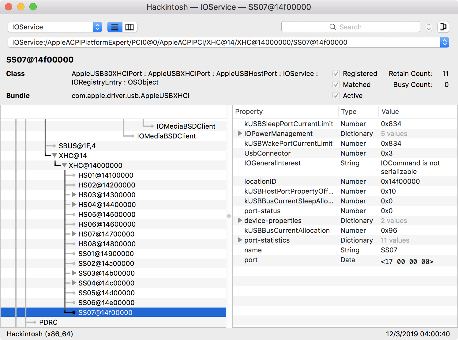

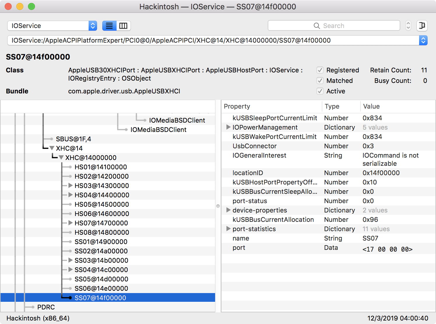

Check IORegistryExplorer to make sure it only sees 15 USB ports or less. USB 3.1 gen 2 ports are not included in the 15 port limit.
Thanks for the reply. Will try that.

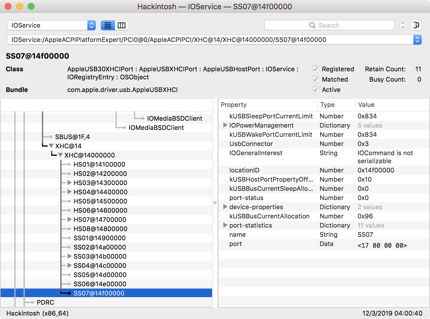

I have a safe master copy of Clover EFI folder on the Windows EFI partition anyway. So, should be very safe to mess around the macOS EFI partition's Clover :D
Yeah, I finished the ports mapping yesterday. And now only has 15 ports (not including USB 3.1 gen 2 ports). SS07 is redundant to me at this moment. But later on should be use for the wifi / bt card.

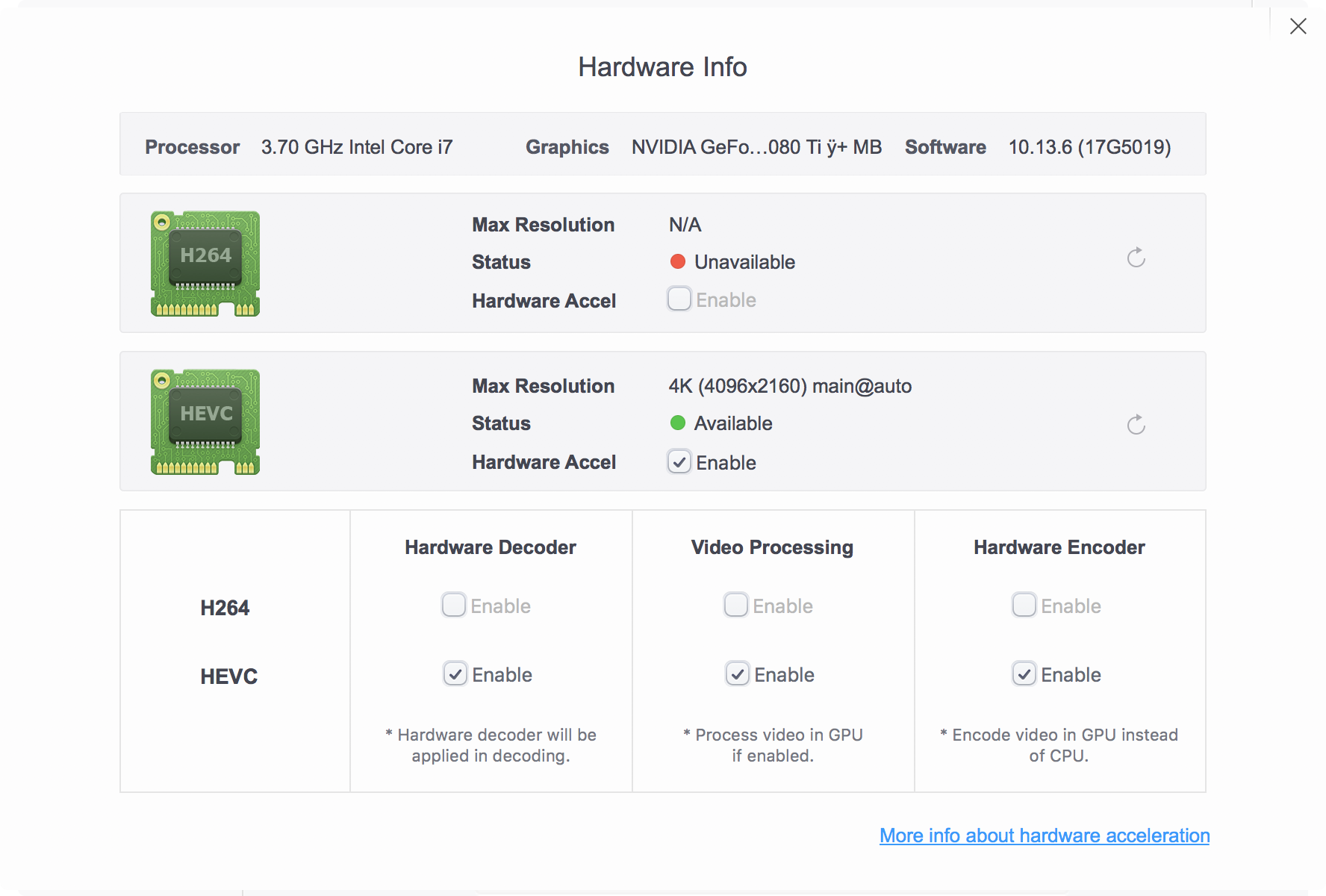

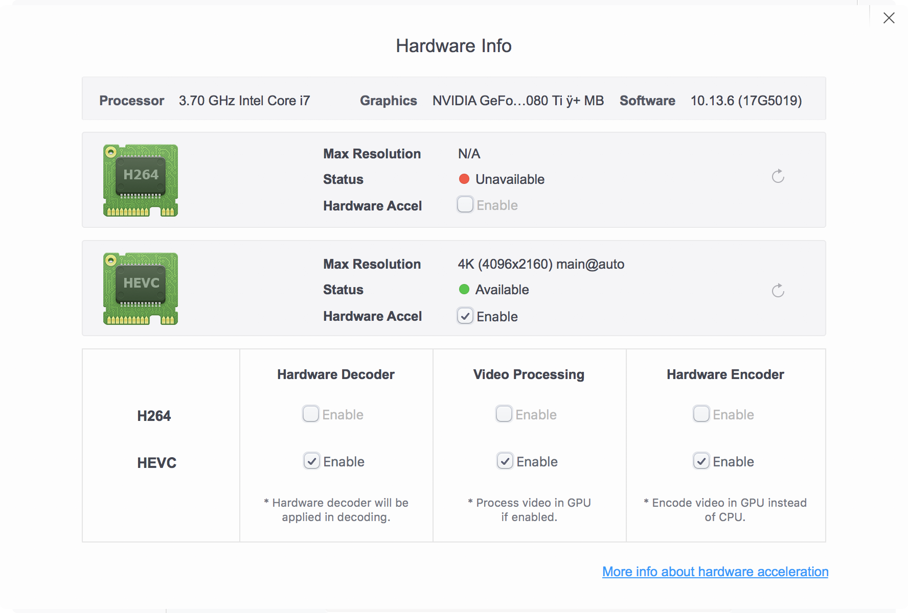

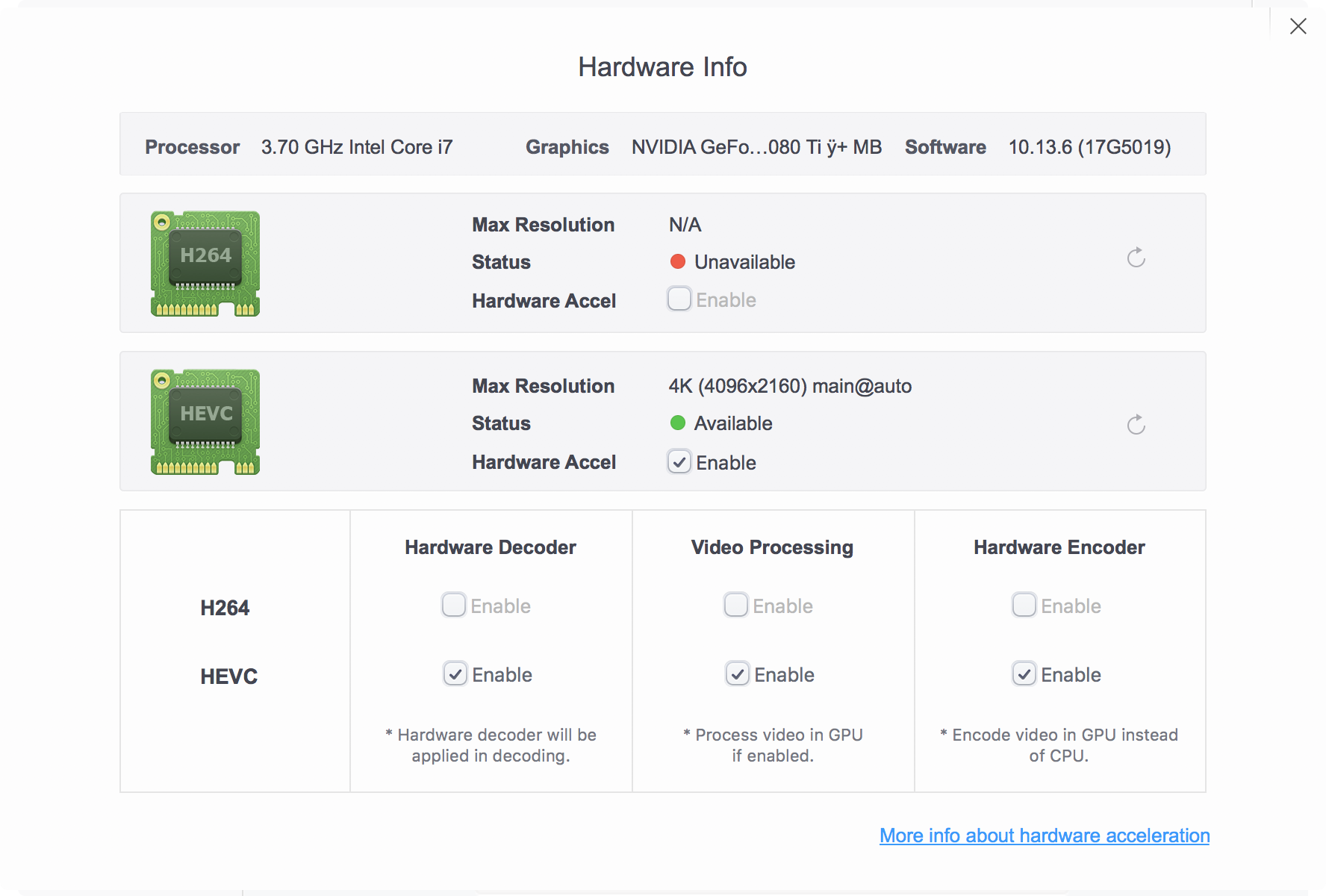

[doublepost=1552335540][/doublepost]I am back with the -igfxbeta and -ngfxbeta removed, and shikigva=1.
Boots fine, everything still works.
However, I don't have any movie in the iTunes library. I can play the trailer. Not sure if that's DRM protected. But as per others report. shikigva=1 breaks H264 hardware Accel support.
[doublepost=1552336346][/doublepost]Just found that I have few free movies in the iTunes library.
And can't play them with both shikigva=1 or shikigva=60.
Yes, always keep a USB flash drive with working EFI on it. Also, I have written instructions on how to keep just one single USB flash drive with working EFI for multiple hackintoshes in this post.
Please try shikigva=61 to see if it enables iTunes DRM and H264 + HEVC.
I have been using shikigva=1 and iTunes DRM and H264 + HEVC all work. But I don't know why everyone seems to have different results with the shikigva= setting.
Tested, same as shikigva=1 in my case. H264 broken + no iTunes DRM.
May be different hardware (e.g. different dGPU), and different OS version (I am still with 10.13.6 due to 1080Ti), etc make the difference.
Maybe... I haven't tested on High Sierra or Nvidia. I sold my GTX 1080 to get my Vega 56...

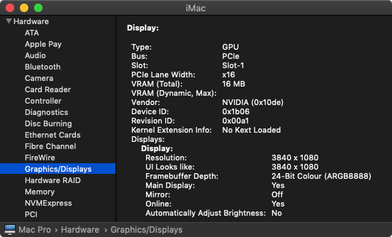

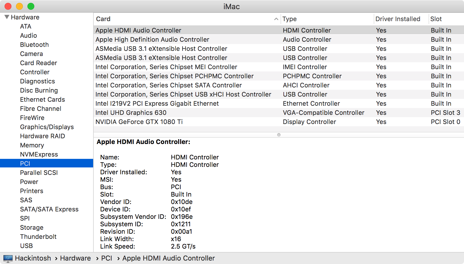

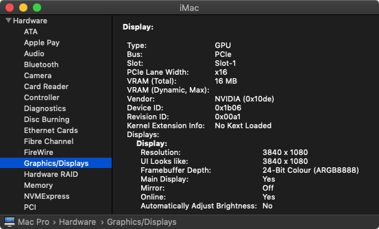

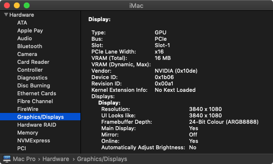

Just make a quick test. Which doesn't mean much, but more for fun.
I reboot my Hackintosh to Mojave (the primary boot drive that from my Mac Pro), it boot to the desktop without any issue (with correct Clover EFI folder, this Hackintosh is really just like a cMP, which is really great). Monitor connected to the 1080Ti, EFI able to drive my 3840x1080 monitor properly.
Of course, without web driver, no proper acceleration available, but iStat can still see both GPUs. And Airplay still available. However, iTunes video still can't be played under this config.

I have a few question want to ask after studying on tonymacx86. Since I know that you switched from cMP to HS with greate success. I hope you don’t mind to provide me some extra guidance. I wish to ask at here rather than PM, so all others can benefit from the discussion. And I would like to thank for providing such a good guide to me. I plan to follow your guide.
https://www.tonymacx86.com/threads/...wi-fi-ac-build-w-i7-8700k-amd-vega-56.239969/
Before we go deeper. The very first question I want to ask is if your build can take a 32cm long graphic card? (Update: found the answer. This case can take up to 34cm card, good for my 1080Ti)
My PNY XLR8 1080Ti is pretty long. And I don’t want to go for another GPU at this moment yet. (I know about the recent web driver issue. But it seems Nvidia fixed that in the latest release).
If this doesn’t work, then I need to get another case, or even another mother board. Million thanks in advance!
Thanks a lot for making this on the forum, it's one great learning experience that will benefit many people. I am one of those. Ever since your help in helping me moving from an old Mac Mini to an old Mac Pro, I have been very pleased with the quality discussion in this forum. Recently I upgrade to M2.NVME and Mojave 10.14.4, really fly. But my itchy hands told me that some time in the future, I will have to move on to the Hackintosh path. This is a great mocking exercise and seeing two great minds interact.
Many thanks to you and pastrychef!
