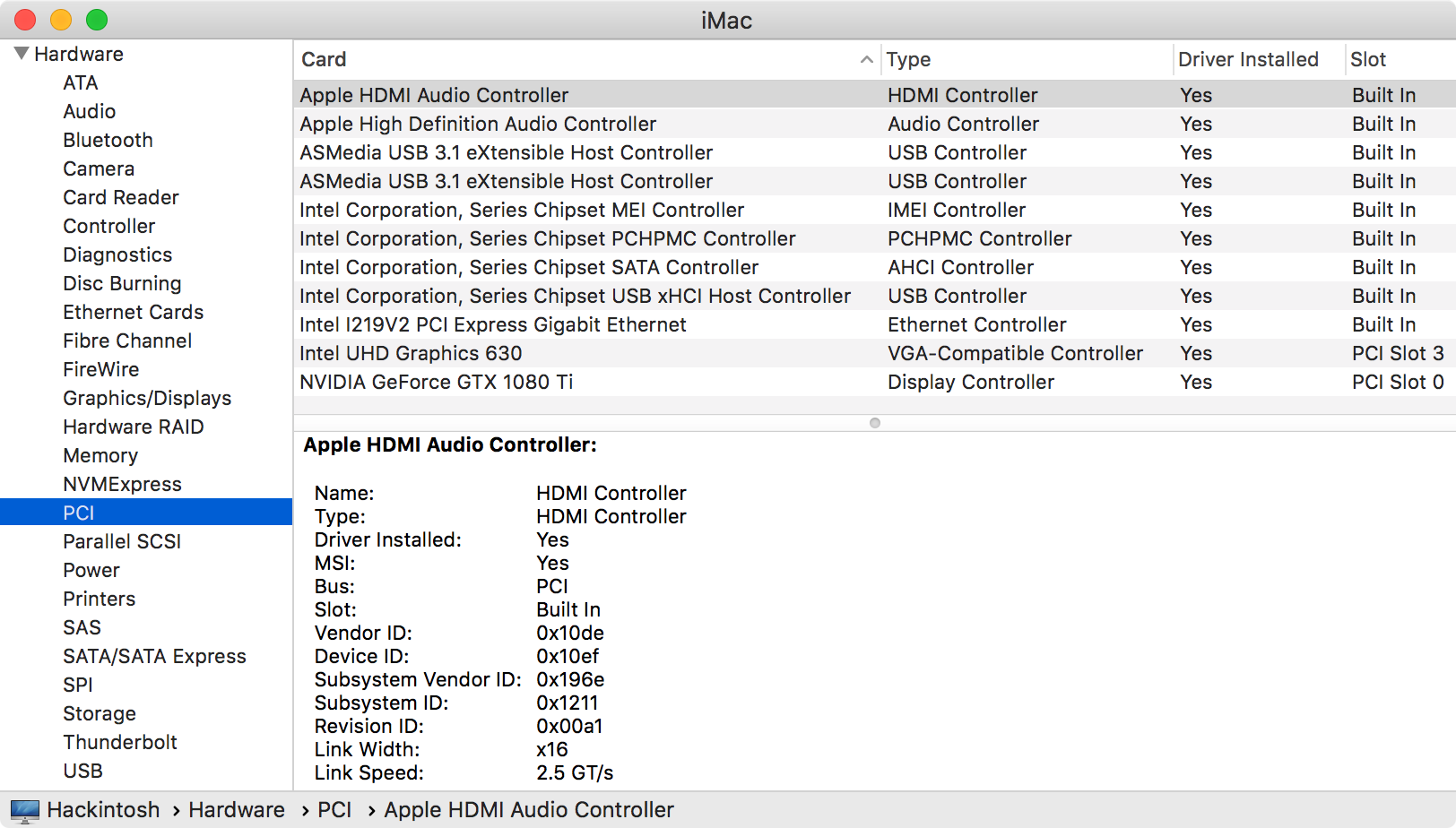

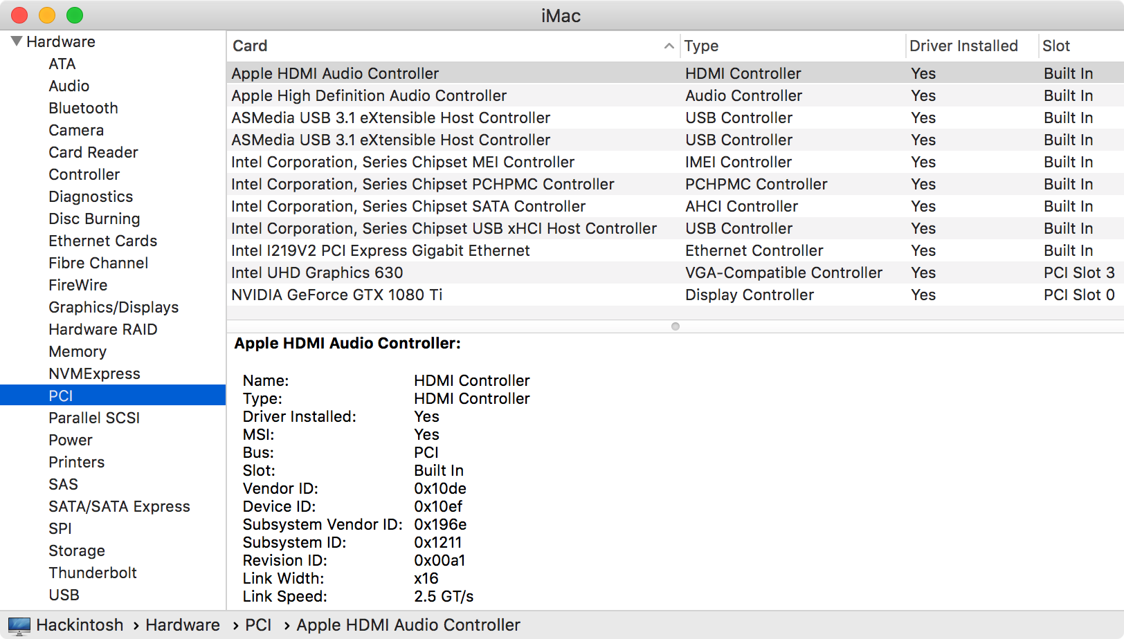

I've tried using SSDTs to populate the PCI section of System Information and found that the system ran weird with them. Keep testing to make sure everything is running right.
Personally, I ended up getting rid of all those SSDTs and everything ran better.

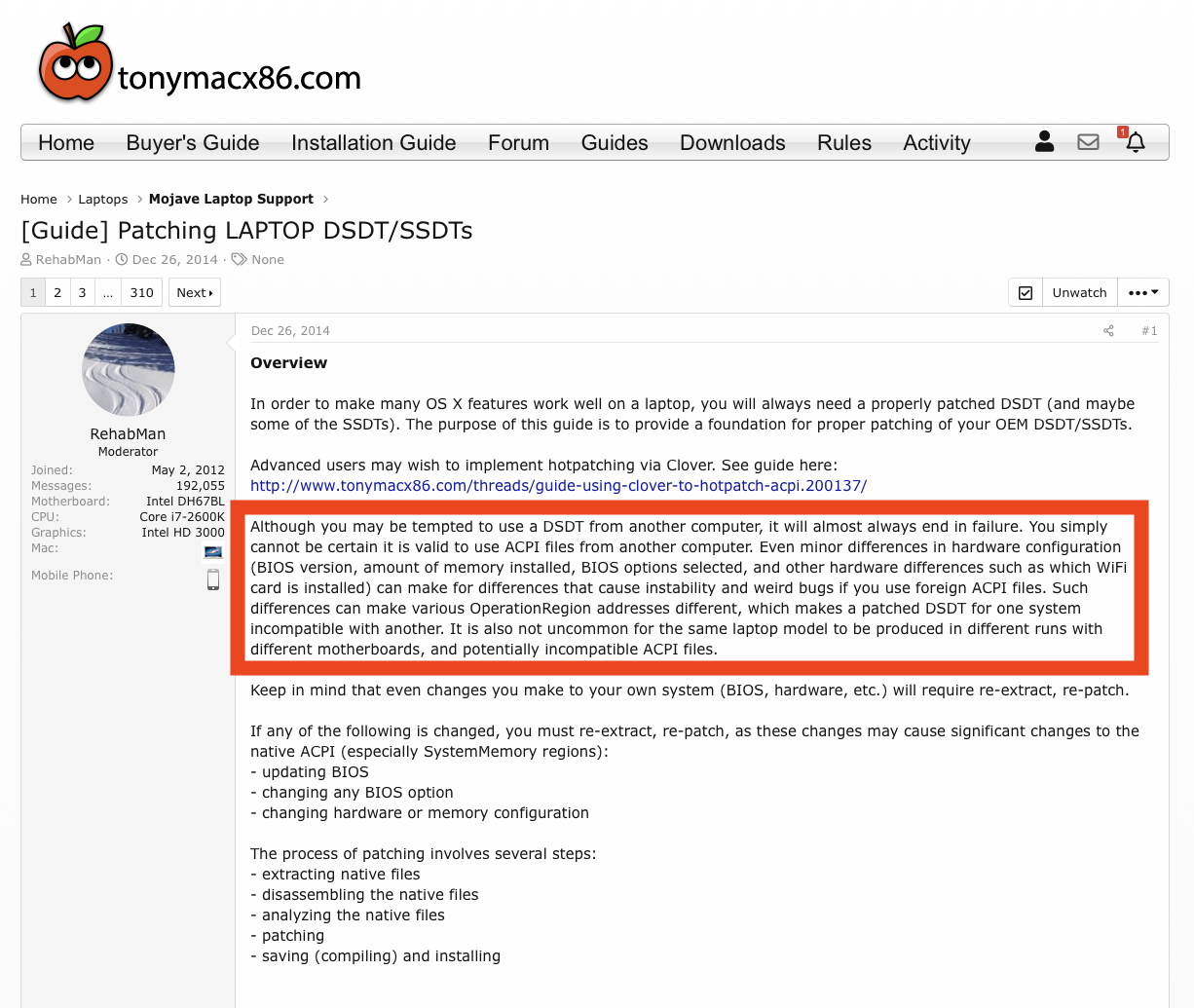

It's hard to specify... I mean, it worked... But things just didn't feel quite the same and not for the better...

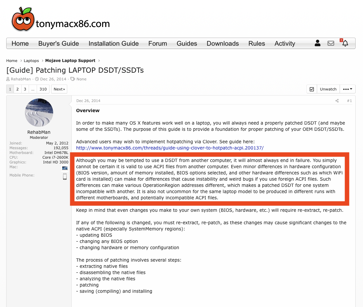

Also, using DSDTs made for another system is not recommended at all:

Source: https://www.tonymacx86.com/threads/guide-patching-laptop-dsdt-ssdts.152573/
Thanks for the info, I understand that every single hardware change may need a new DSDT patch. That's why I want to do it myself.
The DSDT file I download has very very similar config as per my Hackintosh. So far, everything work as expected. But I will continue to monitor it.
I will study the patched DSDT, compare it to my original dump. And see if I can figure out the correct way to do it.

If you want do populate System Information > PCI yourself without relying on someone else's DSDT, you can try this method.

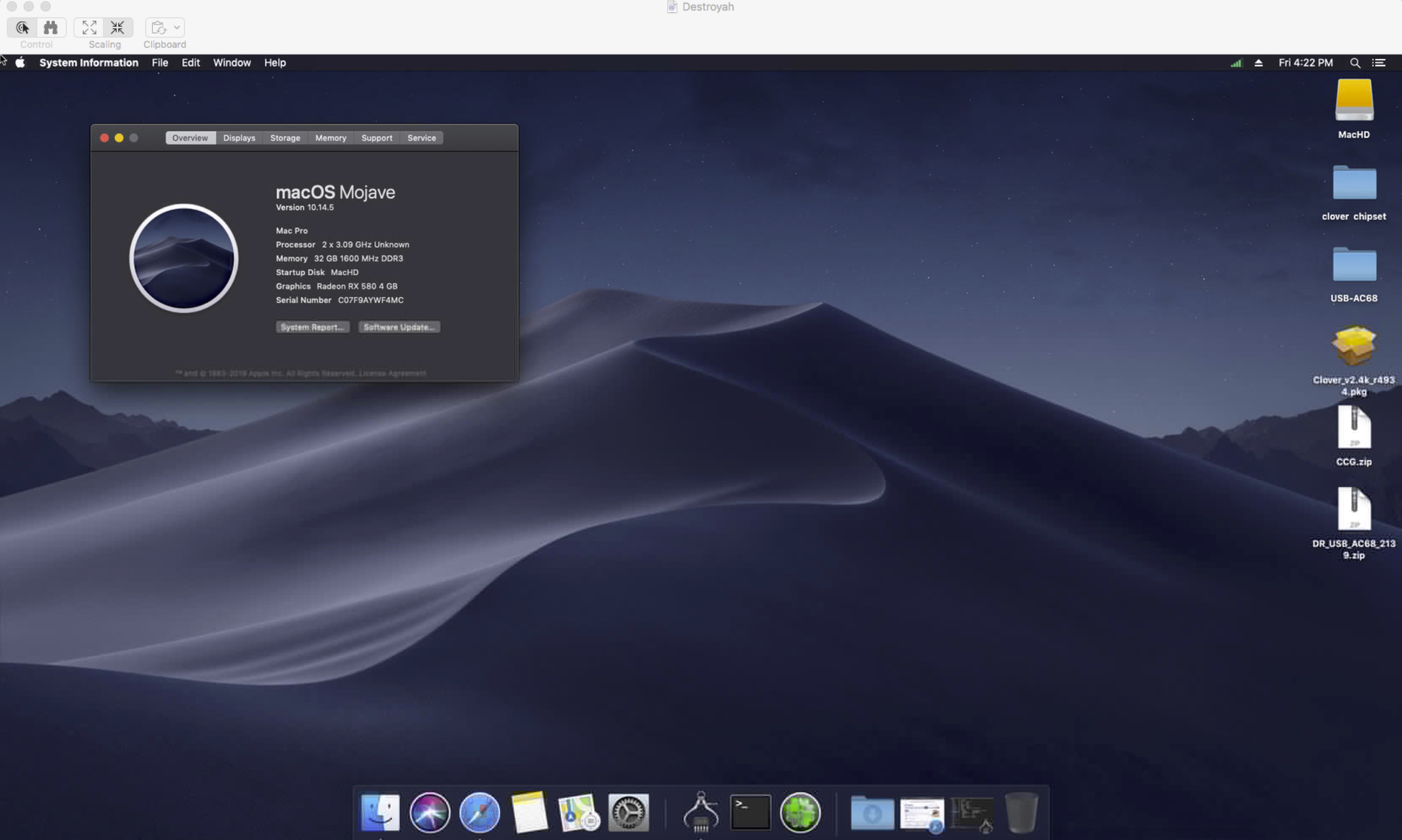

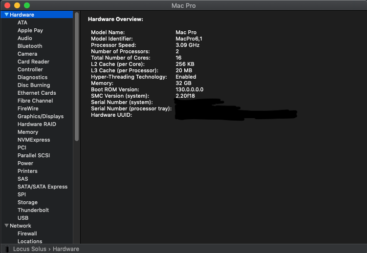

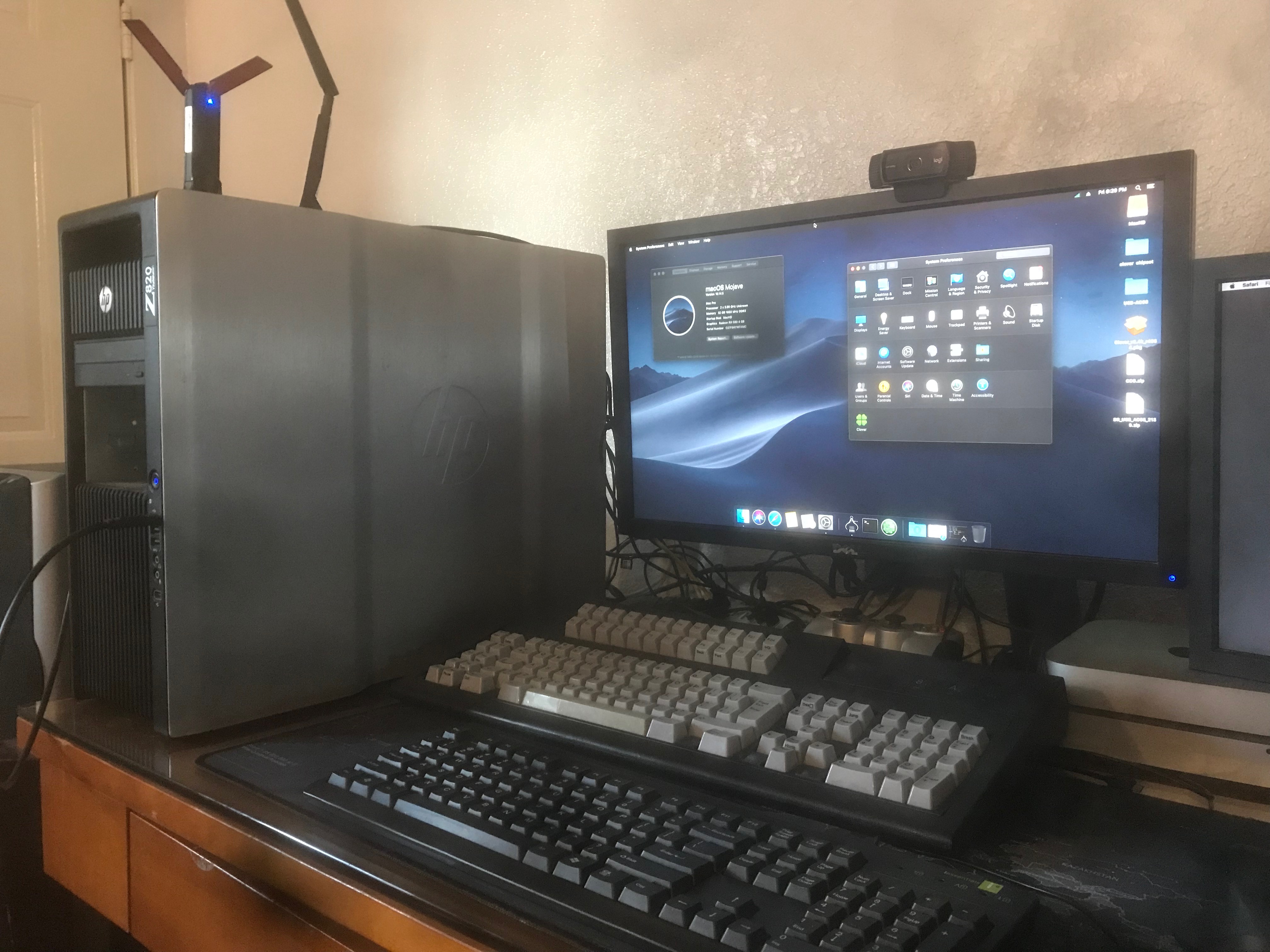

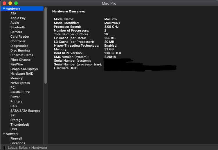

Figured I'd post here - finally got the Z820 booted to Mojave desktop. Hardly anything works, but I'll tackle that tomorrow. It's dual 8 core at 3.1GHz / 32GB / RX580 / GT 1030 / Thunderbolt 2 / 1TB SSD / 15k spinners.
Almost nothing aligned exactly with any existing guide. I had to piece together solutions from all over the place. Basically I've just gotten it to boot to the desktop. Lots of kexts still need to be installed (sound, ethernet, TB (although I hear this just worked for some folks), internal drives).
I'm doing this in my spare time as an exercise to see if it's feasible for me to maintain a fleet of these for my shop. Ideally I'd be using ESXi, but I couldn't get that to work. Lots of work to be done still, but this was a milestone.
Please excuse the mess; this is very much a work in progress.
First of all, huge thanks to MaLd0n at Olarila.com forums. He provided me with kexts, DSDT, etc. to get me this far. Now I've been (mostly) through his method, it makes sense and I would use it again. With his assistance I have ethernet, sound, and internal drives working (firewire too). Main thing left is the Thunderbolt 2 card.
Geekbench is ~2214 single core and ~31,700 multi (didn't save the screenshot). These aren't V2 CPUs, my BIOS is too old. Single core is slow, but multi seems to be on par with 8 core iMac Pro and 12 core nMP (I have 16 cores). Not bad for a cheap box, and I just need them to feed some GPUs data, which they will do and then some. I'm pretty satisfied so far.
We'll see how stability, updates, etc. are long term, but I haven't had an issue with the ones I paid for.
Anyone considering it, I'd say give it a shot. If we get updated Nvidia drivers, I have a couple GTX 1070s ready to drop in. If we don't, I may have to settle for a couple of Vega 56 for now.
