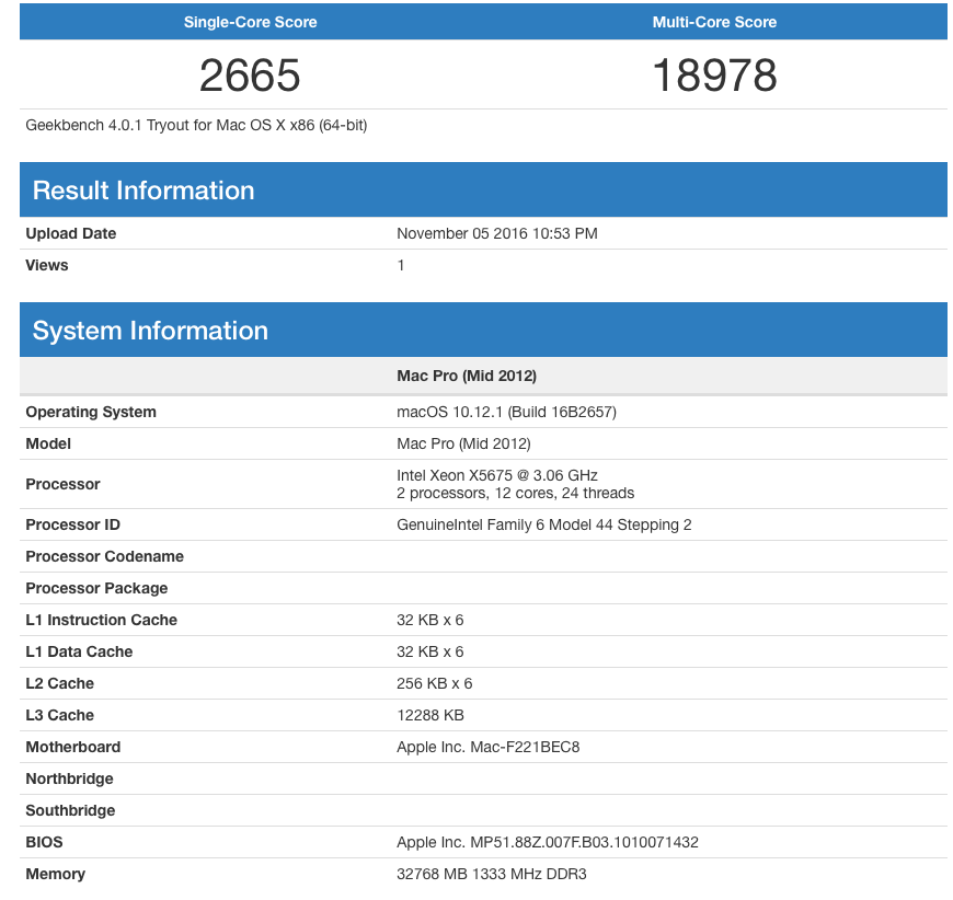

I am getting a geekbench of 2,679/16,354 on my 2009 (flashed to 2010/12) mac pro with an upgrade to dual x5675. I am selling it on craigslist and had a couple of folks say something is wrong with it as it should be over 20k. I note a poster in this thread had a similar situation and received the same feedback. I have done the SMC and PRAM resets. The mac information utility is detecting dual x5675 at 3.06 ghz and the ram is running at 1333--all this indicates a fully operational mac to me. I did note a poster here who had x5690 and was getting over 20k geekbench.
I would love to increase the geekbench on this box, but I don't have any ideas on what more I can do. I can only imagine a hardware issue, but I find it hard to imagine a hardware issue that makes it slow--one would think a hardware issue would break it altogether. So, any suggestions, I will give them a try. Thanks.

GeekBench 3 or GeekBench 4?
4 I ran 3 with an earlier version of osx and the results were comparable.
Geekbench thinks I have a 2012 mac pro. I hope I flashed it with the right update.
May be you should try GeekBench 3 again, and make sure the computer is idle before you run it (e.g via activity monitor).
The results should not be comparable between GB3 and GB4. Also, there should be no "year" info.

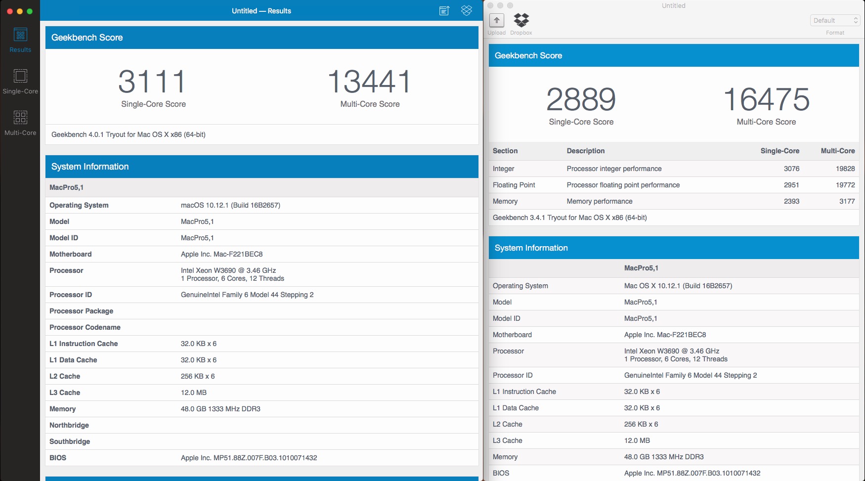

I can take a look. I am seeing the w3690 single having the same performance as my dual x5675. When I looked at benchmarks of the two processors, the 5675 was not that far behind the 3690, but the cost was a big difference. I have done my benchmarks with nothing else running on the mac.
My big question here is: Is there something holding my system back? Some sort of wrong drivers or configuration setting? When I upgraded the cpus, the mac picked them up right away, but I had to do the pram reset before it properly picked up the ram as 1333.

The difference is actually bigger than expected. X5675, 3.06GHz turbo 3.46. W3690 3.46GHz turbo 3.73
Let's consider the base clock.
(3.46-3.06)/3.06 = 13%
However, we are talking about single core performance, so, we should consider the turbo frequency
(3.73-3.46)/3.46 = 8%
And now, what's the actual performance difference in GB4?
(3111-2679)/2679 = 16%
The performance difference here is almost double then what it should be. Of course, 16% is not a huge number, and technically, the single core performance difference should be less then 10%.
Anyway, yes, it's possible to modify some plist file and cause low CPU performance. However, I don't see that happen on your Mac.
Again, if you get similar numbers in both GB3 and GB4, then something is wrong. You should try GB3 again.
Also, may I know where you see your 2009 flashed Mac Pro ident itself as a 2012 model? Any screenshot?
Thank you for your attention to this. I will fire up the computer tonite and get a screenshot of that GB4 with the 2012 version on it. I have re-run the geekbench a number of times both in gb3 with an older OS and with gb4. Nothing else was running, and the sierra is a brand new standard install with absolutely nothing new installed.

Here is the information I got from running geek4 one more time.

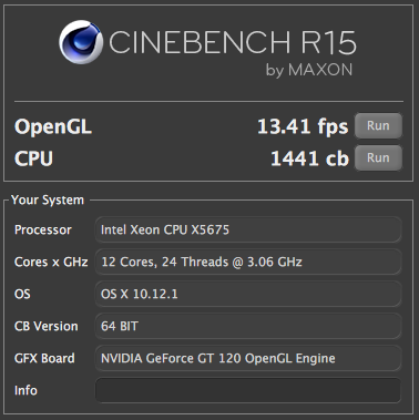

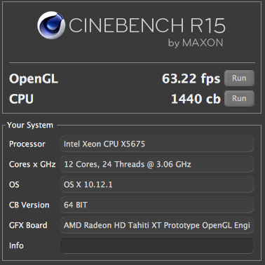

Thanks again for the great system. I have finally finished the 1st steps in getting it ready for some FCP work. Still need to optimize video and such, but I think I have a good start so far.
  • 512GB SSD with fresh copy of Sierra installed
  • R9 280X Dual-X GPU installed with 3GB
Still need to look into flash options for the GPU, and optimize the OS a little more for FCPx . Will possibly be installing a PCIE SAS card to up the internal drive speeds a bit, but haven't decided yet.
Went from over 2 minutes exporting on the BruceX test, to 27 seconds now. Really happy so far. The clean install appears to have helped up the Geekbench scores to a number closer to what others expect.
