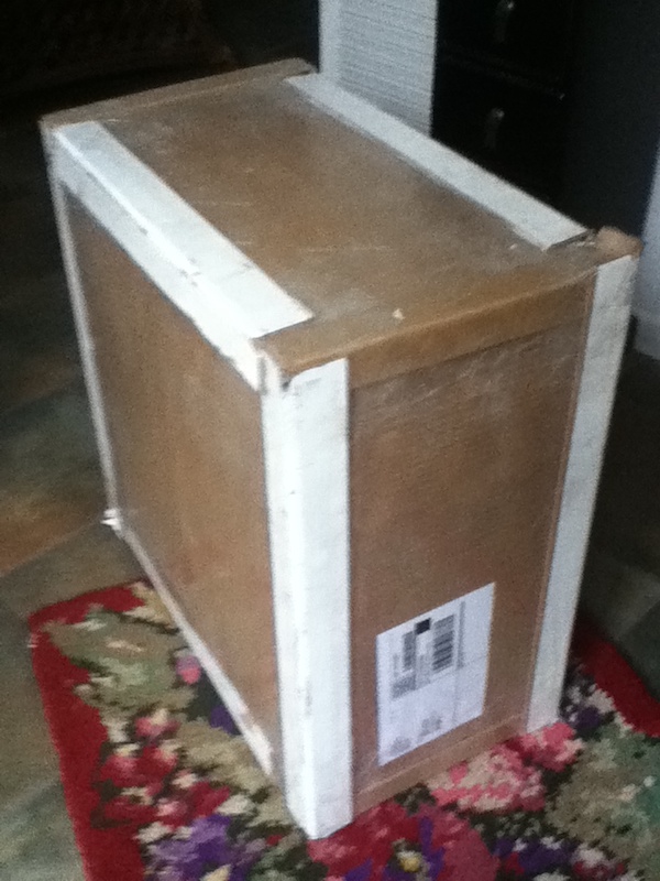

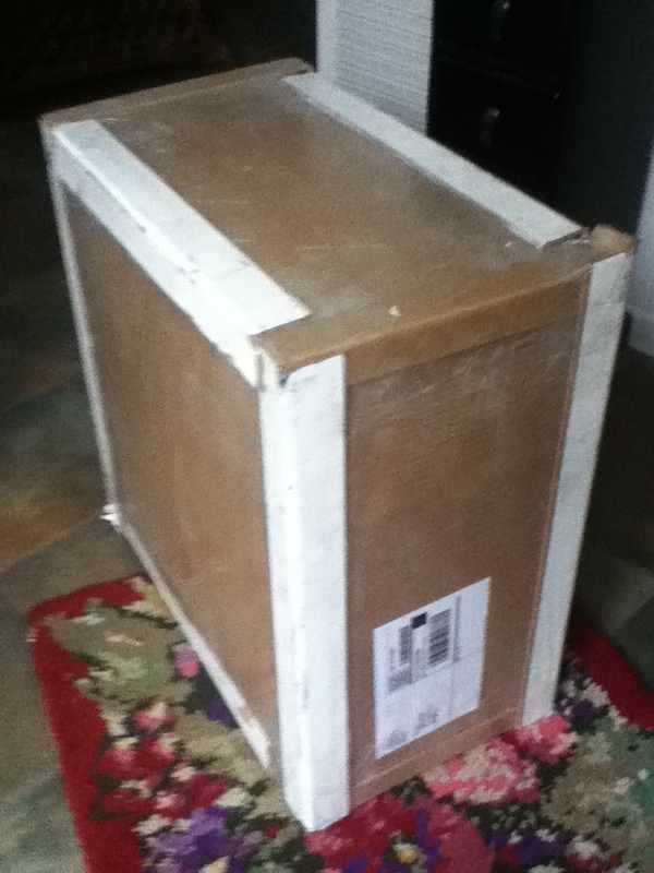

Received my MacPro 4,1 yesterday, and I just had to show what a good job of packing the eBay seller did.

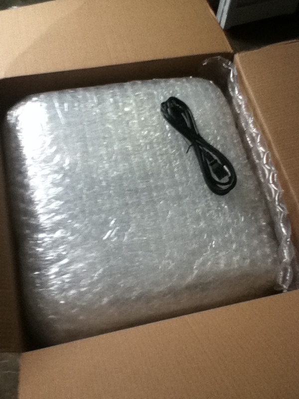

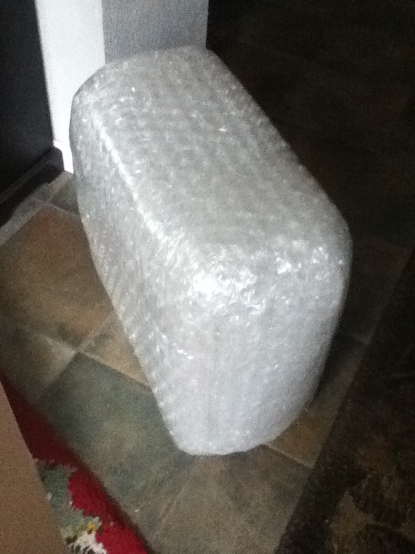

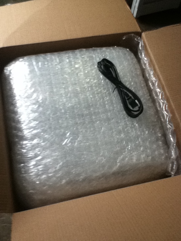

Every edge and corner of the box was reinforced with angle thingies and the computer inside was totally encapsulated in very thick bubble wrap.
Needless to say even UPS couldn't damage this package.:p

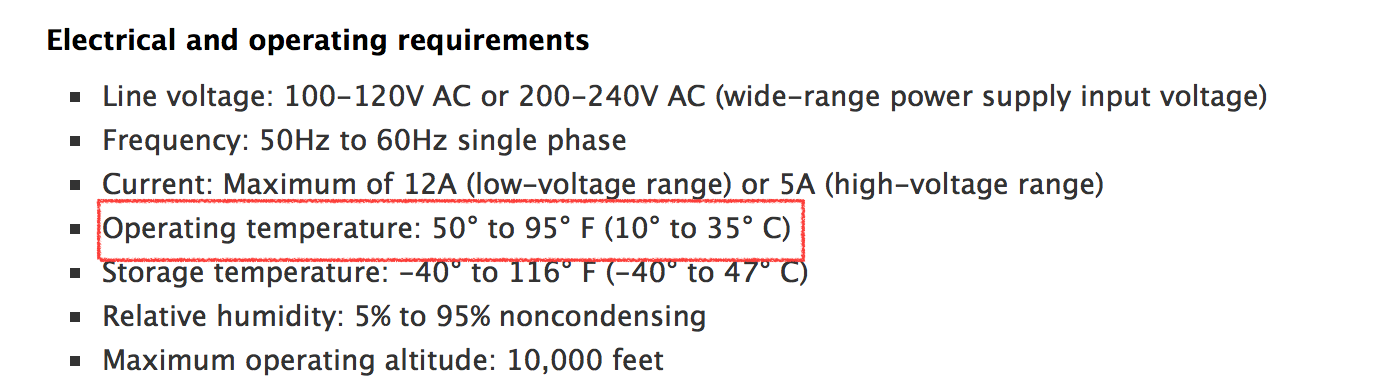

My room temp sits around 25c and the listed max ambient temp for the mac pro is 35c, which it hits almost always after running for a little while which is why I'm concerned.. I'm fine with moderately loud fan settings I just want to figure out a safe fan setup to stick with through summer where it'll likely reach closer to 30c room temp

Where you saw Apple specifying 35°C? Every country near Equator stays over 35°C most of the year.

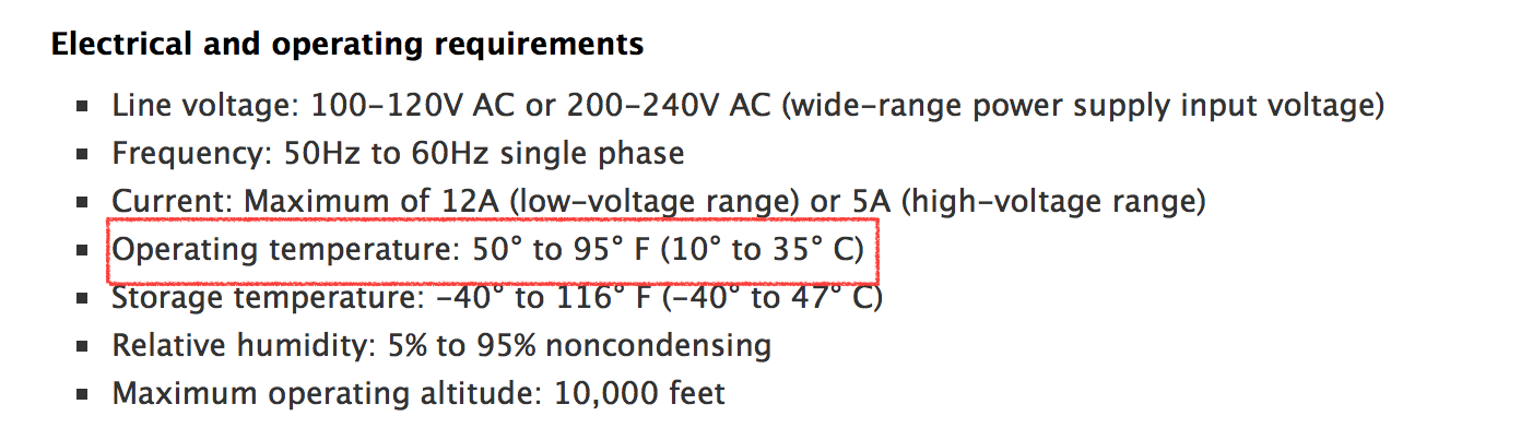

Under the 2009 tech specs on apple's page it refers to the max operating temperature to be 35c
