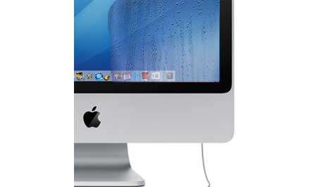

Well, then, I'm stupefied has to how the condensation is occurring, especially in one of the pics you linked to:
That one looks like it's being run in a steamy sauna while cold air is blasting on the front glass.
I find it very difficult to believe that a temperature-acclimated iMac is capable of such a temperature differential between one side of the glass and the other as to produce condensation in even rather humid environments.
However, the specs say it should run in 50° to 95° F (10° to 35° C) temps with 5% to 95% noncondensing humidity, so, if the condensation can be replicated in that environment, I'll buy it. But I still am suspicious of these reports, because the science behind it just doesn't seem to hold up. The temperature of the glass has to be below the dew point of the air inside the iMac for condensation to form.
I believe that was the 'fake' image - there were a lot of them posted a while back.
I wouldn't be surprised if that one was fake. I just grabbed the first four off Google that I saw. As it mostly seems to be happening in the bottom right of the screen, perhaps there's a peculiarity of the air current from the fan which affects that particular area of the glass.
I believe this was too - it's amazing the lengths people go to - however I believe this one had some humour behind it !
http://homepage.mac.com/hallvalla/links/imac2.jpg
