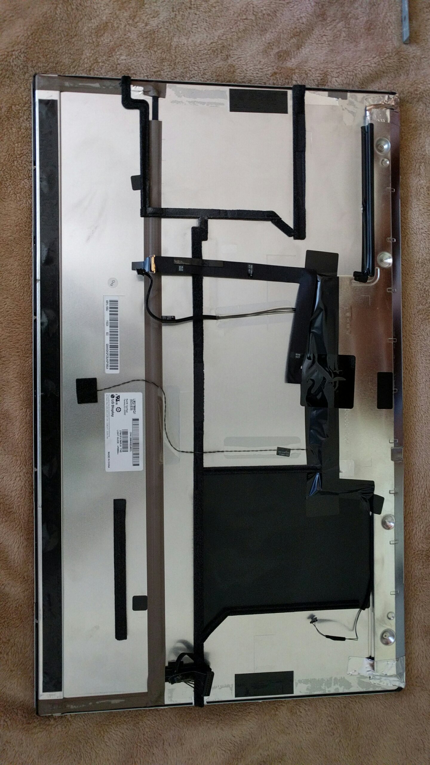

Can anyone confirm what kind of aluminum tape is used on the rear of the LCDs? I'm looking to buy some.
I've read instructions in this thread and elsewhere and watched videos about how to open up an iMac LCD and clean up the dust that's trapped between the backlight if it exhibits smudging and black dots, like mine. But in order to do that you have to either cut or peel the aluminum tape that covers any screws and shields the display of exposed joins.
Here are some items I've found online:
Tape 1
Tape 2
Tape 3
Which of the above is appropriate for the job and which isn't?
If all else fails, can I simply use good ol' regular sticky tape to seal it back up again?

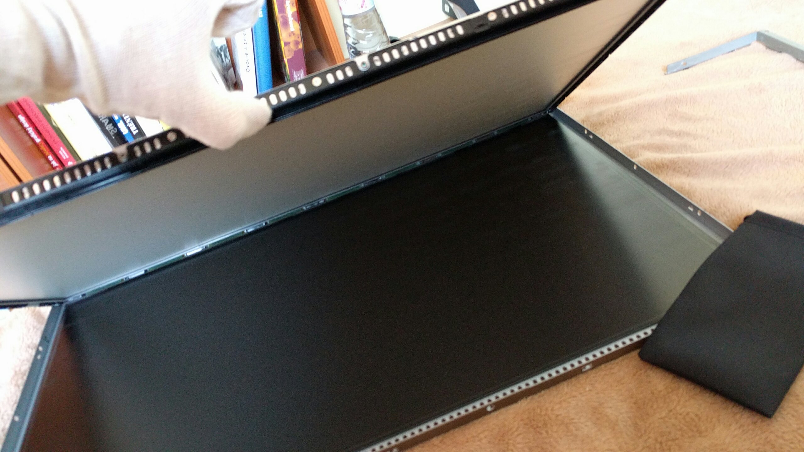

As a note for anyone fixing their 27" screen, its best to take off all the shielding tape when disassembling and reinstall it when you're done. I've done this myself after learning the hard way, if the shielding is compromised too much it'll cause high pitched noise to emanate from the speakers when the LCD is on.
I used 3/4 aluminum tape I found at Home Depot.

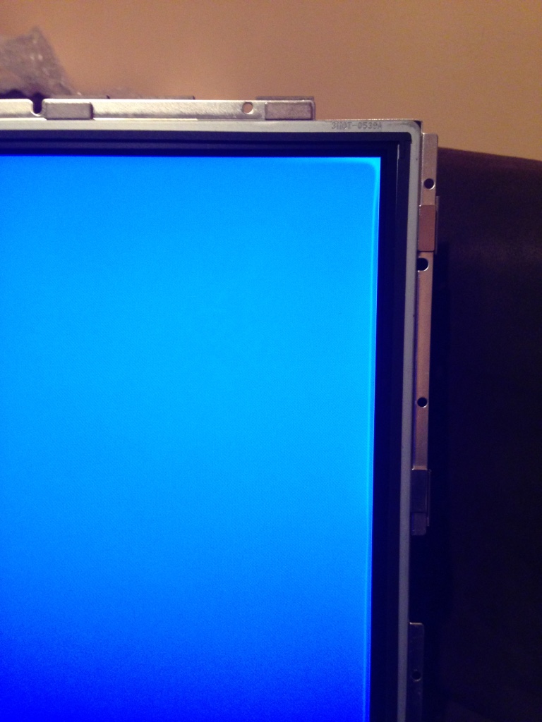

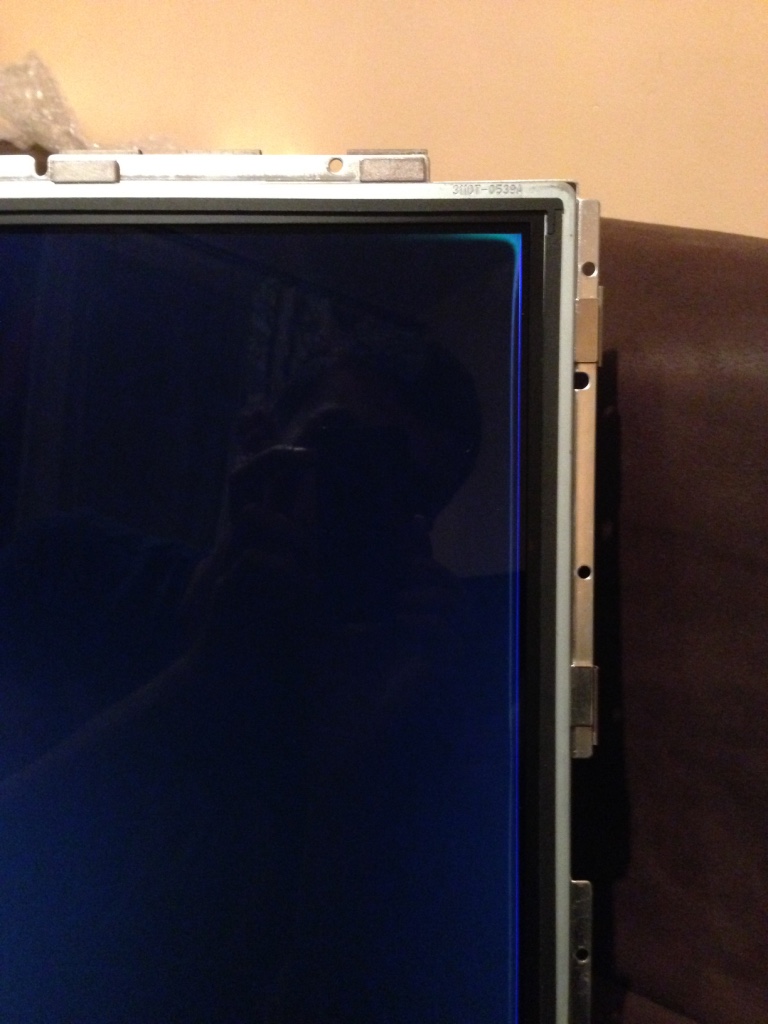

This thread is pretty much stale, but thanks to it I've got a courage to clean my iMac 27" 2011's display. Dust is gone, but I've got some slight backlight bleed now in bottom left corner. So I guess I'm going to dismantle it once more :)

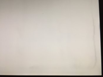

I've an iMac 27'' Late 2013, I opened for removing an insect and dust. When I used a glass spray to remove dust from the glass sheet (there are 3 sheets between the LCD and the front glass, this is the middle one, seems a fresnel lens) cames off a semitrasparent dust placed over, which was not removed using only a cloth. In addition other dust is present, and more visible because located behind the lens.

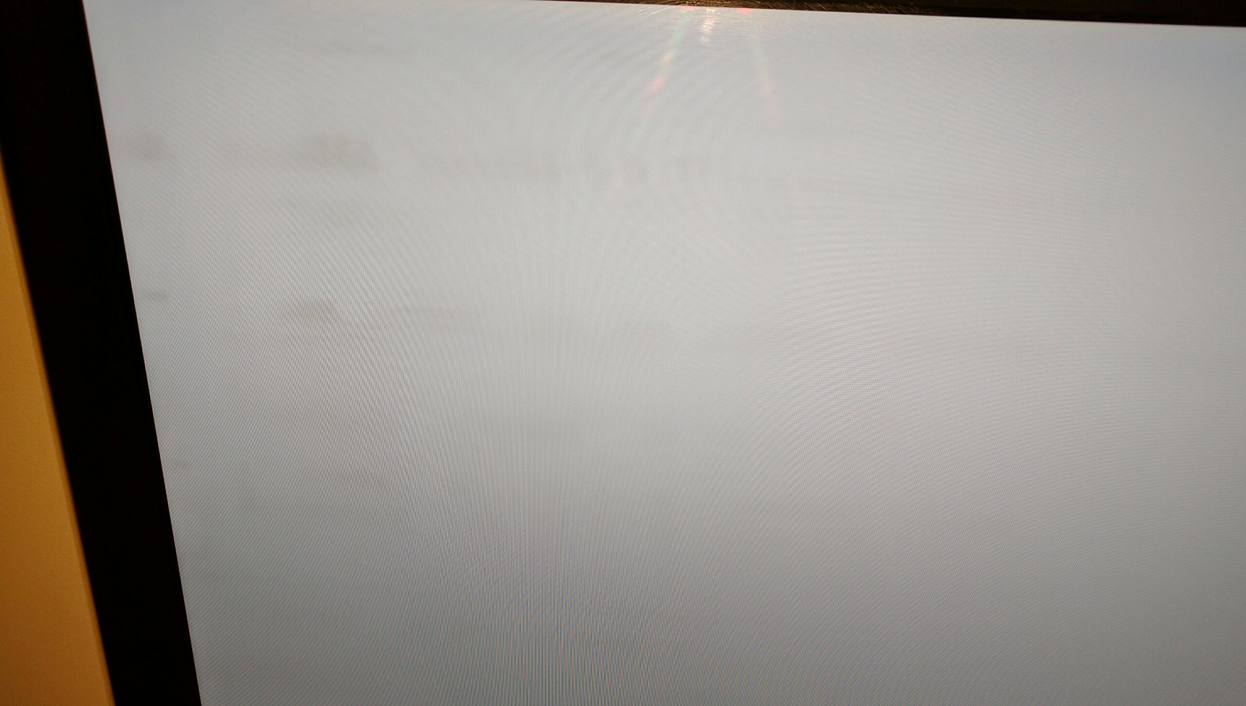

Do you guys think this is dust or condensation?
It seems that this smudges only appear when the display is warm. Is there a way to freeze it? I mean, by fans or etc.
Thanks
