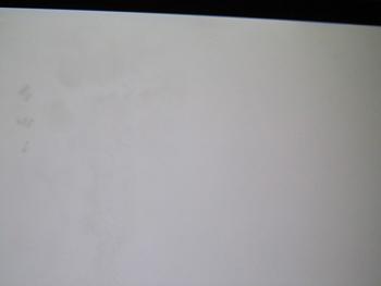

Can anybody advise me what my options are i've a 2011 i5 27" iMac that i think has dust under the screen (tried taking the first screen off but its behind the 2nd lcd) I've not got applecare.
Are people getting these screens replaced outside of warranty?

I'm booked in for a genius bar appointment sunday i don't hold out much hope.If they won't do it i'll go down the diy route.
I'm going to point it the problem is quite common online etc fingers crossed :p
Success took my iMac in this afternoon and the guy knew then problem straight away and said it was covered even though I'm 8 months out of warranty.They fitted a new LCD that took just over an hour & half I've gotta go back to collect the iMac very impressed!!

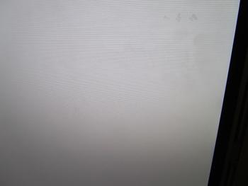

iMac 24" early 2009 shadow lines
Hi,
I have an iMac 24" early 2009.
I've been reading through the whole thread but a lot of people don't post pictures of their display problem and I haven't seen one that would look like the same issue as on my display.
Here's pic of mine:
Uploaded with ImageShack.us
It's not very visible for now but usually these things evolve. Right now, you can see uneven light, horizontal large shadow lines and vertical thin lines. When screen is on for some time, it gets a little bit better than right when you turn it on.
(A few irregular stains in the right upper corner are on the outside and not a problem.)
Anyone had a similar issue and knows if a "simple" cleaning Oggy describes would solve the problem?

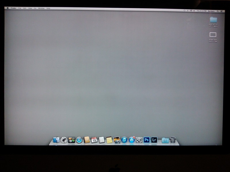

iMac Early 2009 pics
Update: we opened the display and cleaned it inside, it was dust indeed... however, it didn't all go away, even though I did press a bit to make sure it will be cleaned well since you don't want to open it again... It looks like dust/dirt really sticks to it with time so I should have probably used a glass cleaning detergent like someone did in this thread.
It is better than before so I'll keep it like this and won't open it again unless it gets worse with time.

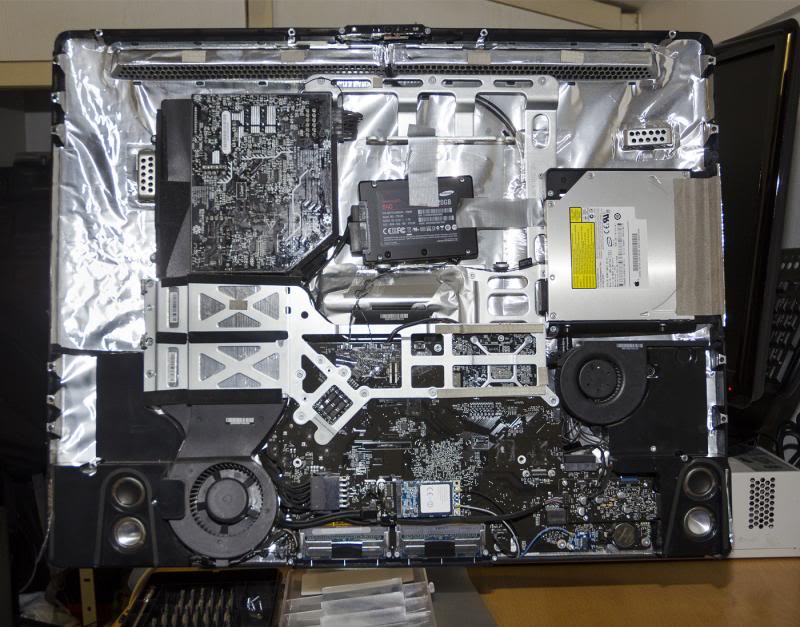

Someone wanted us to post pics of our open iMacs so here they are. I took only two, was too stressed and busy during the procedure to think about taking more!
I also want to say big thanks to Oggy and the community for this thread!
Display before it was opened:
Opened iMac 24" Early 2009 with a SSD in place of the hard drive:

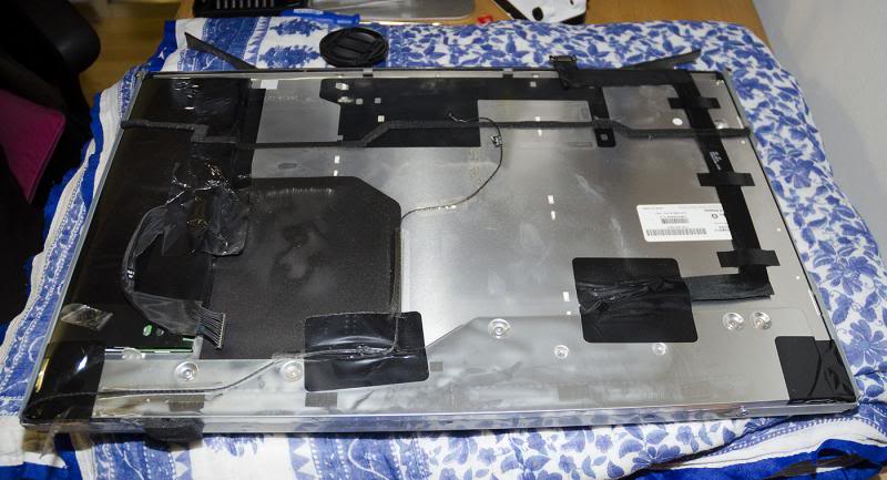

Success! I finally did this! Been thinking about it ever since this thread started.
(The smuginess seemed to stop progressing after a while and was mainly on the edges of the screen and I just got used to it.)
But the SSD I had put in there died. When I replaced that I decided to go for it. Getting the display panel out of the frame was a bit beyond my comfort zone but I made it through.
Thanks Oggy and others that made this possible for me!
My screen is now nice and clear, edge to edge. Woohoo!
