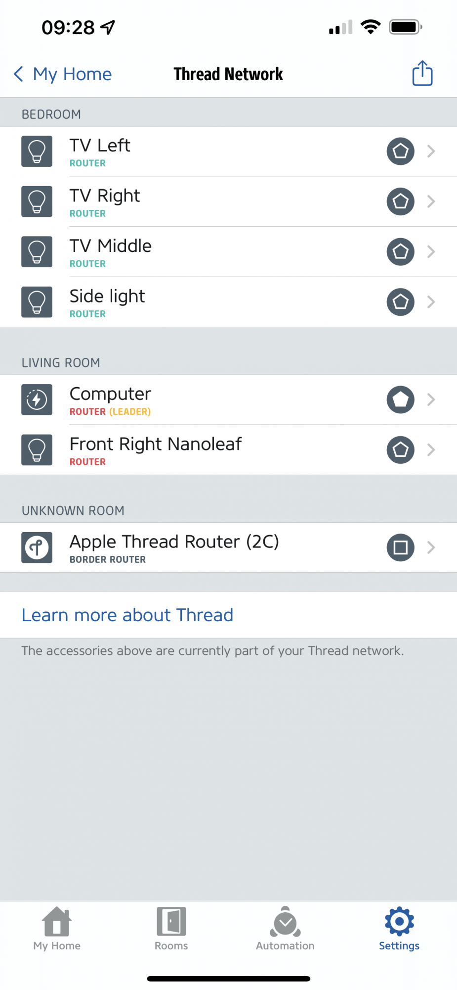

Strange, mines is all working with 6 Nanoleaf essentials and one eve smart plug. I only have one HomePod mini. I can see that the eve smart plug has taken over as the main boarder router after the HomePod mini. It’s the farthest one away but it’s all working as expected.
I’ve thought about buying an eve powered thread accessory partly for the increased visibility of thread topology. Is it worth considering it…the app UI expose significantly more information?
You can use the eve app to view details on your thread network even without an eve accessory. I got it as it was on sale otherwise I probably would have gone something cheaper. It is very good tho!
Are you sure of this? I’ve just keep getting a spinning circle and “Checking Network Status” text in the Eve app Thread network. No Eve accessories currently but a several HomePod Minis, AppleTV and a Wemo Stage
Yeah this is what I see. I saw the same without the smart plug before I bought it. The smart plug is the “computer”
The Eve thread topology list view will work without an Eve device but an Eve device provides the app with some more metadata. I know one of the additional features is that the HomePods and Apple TV’s with thread radios will show up on the list.

@Itinj24 I have never seen screen you showed in the above link in the eve app, I have had a good hunt around and its just not there on mine.
Edit- just spotted that could be the screen before anything is set up.
