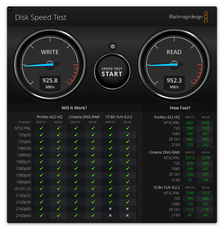

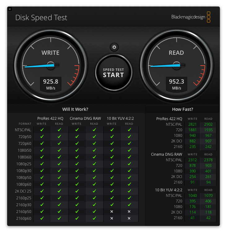

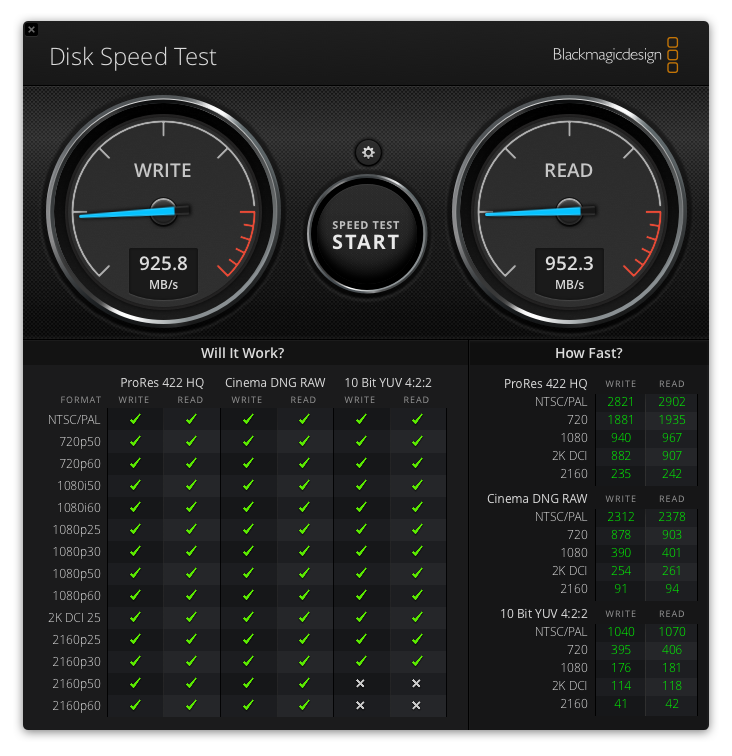

Heres some results with the same Samsung 970 EVO Plus 1tb drive.
One is in a J5Create USB-C Enclosure (slower) and then moved to a JEYI TB3 Enclosure.
Can also confirm the JEYI comes with two TB3 cables - short (and horrible unless lying flat beside the computer) and a 50cm which is good.

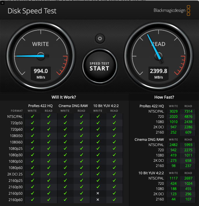

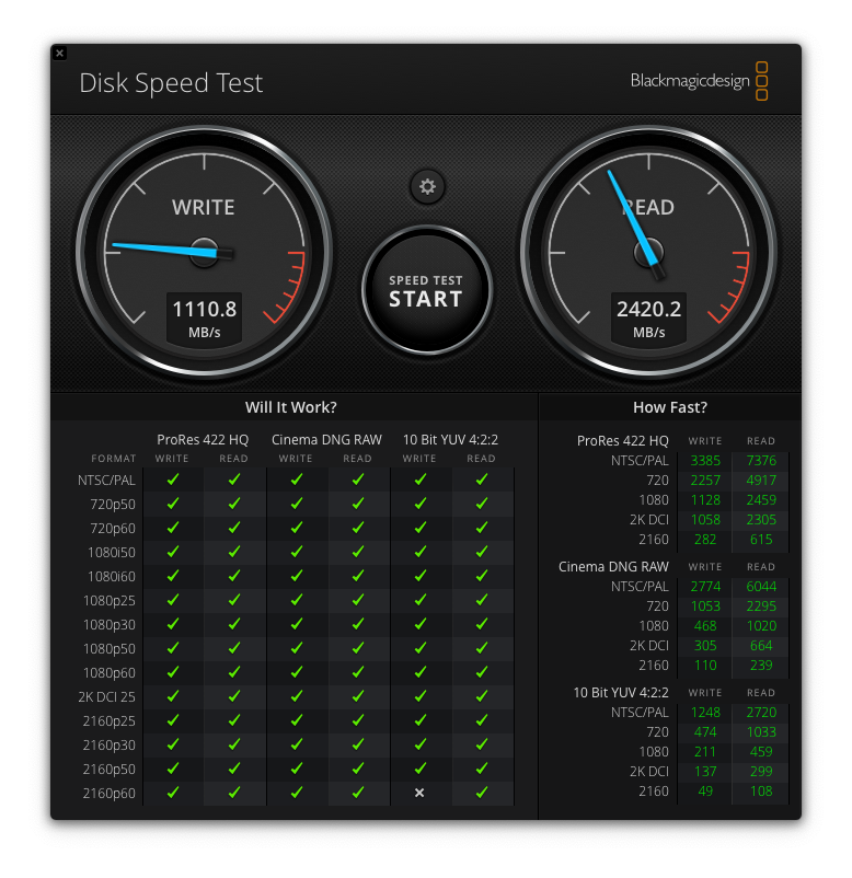

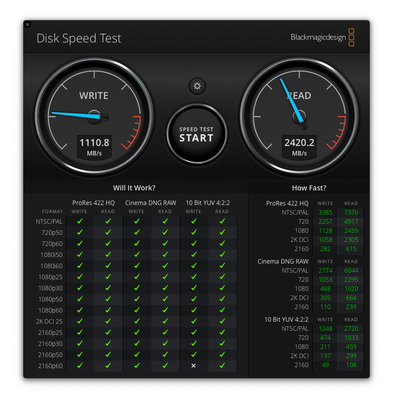

I've just fitted a Sabrent Rocket 1TB into the Orico TB3 enclosure (the one with the fins) and I'm getting very slow write speeds. The current link speed is only listed as 2 lanes rather than 4. That's the problem, but what's causing it?
OK. I removed a USB C hub I had some hard drives plugged into and seem to be getting mixed results. Again, what's causing that?

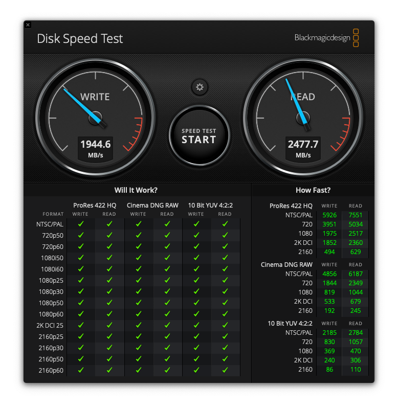

Test 1

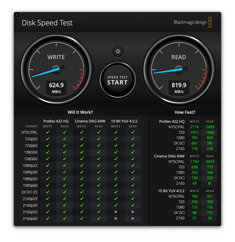

Test 2 immediately after
Test 1
You are getting 2459 MB/s read which is more than two lanes. Where are you seeing two lanes?
Yes, after repeated running, it seems to be all over the place as per the screenshots above - there is no consistent benchmark as it's either all, one thing (read) or another (write), if that makes sense.

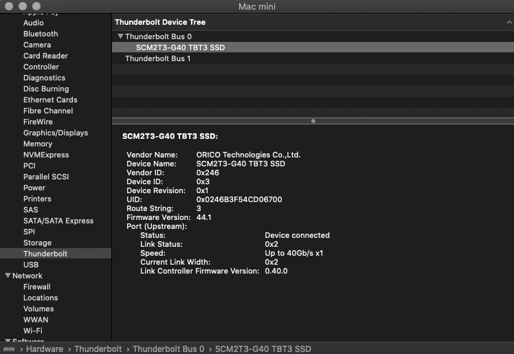

In System Information, the only TB3 device is the Orico enclosure. I assume "Current Link Width: 0x2" means only 2 lanes? I may be wrong, fair enough.

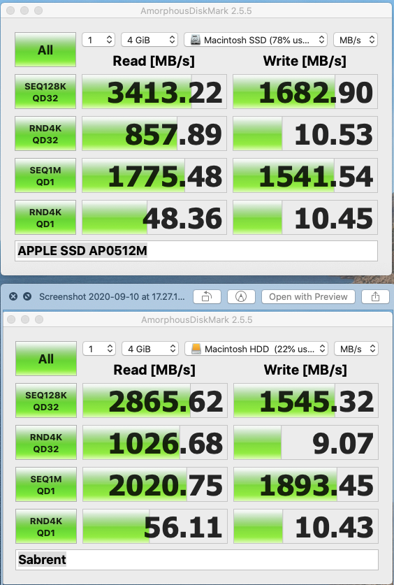

Those are Thunderbolt lanes. A Thunderbolt connection is two bidirectional lanes (2 for send, 2 for receive, 8 wires total in the USB-C connector).
PCIe lanes is different.
You should always see link width 0x2 for Thunderbolt 3 which are combined into a "40 Gbps x1" connection. It may say 20 Gbps x1 if you are not using a proper Thunderbolt 3 cable, or if you are using Thunderbolt 2.
Thunderbolt 1 might be link width 0x1 with "10 Gbps x1" connection (maybe x2 for a Thubderbolt display for two separate 10 Gbps x1 connections).
