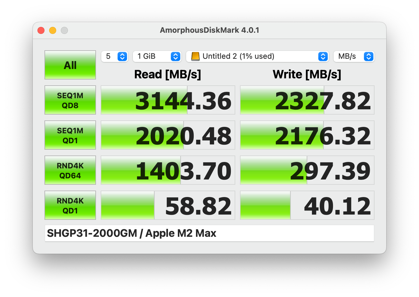

Purchased two 2TB SkHynix P31's (placed in their respective Acasis TBU405's) for my (then) impending M2 Mac Studio arrival; I can explicitly report that when both are attached, only one is populated on the TB bus... the other connects @ USB3.2 10Gbps/s (no matter which attachment to any of the remaining three, available TB ports).
Have an OWC TB->2xDP adapter connected to (and successfully working on) one of the four TB ports.
When one P31/TBU405 is connected, I get excellent results:

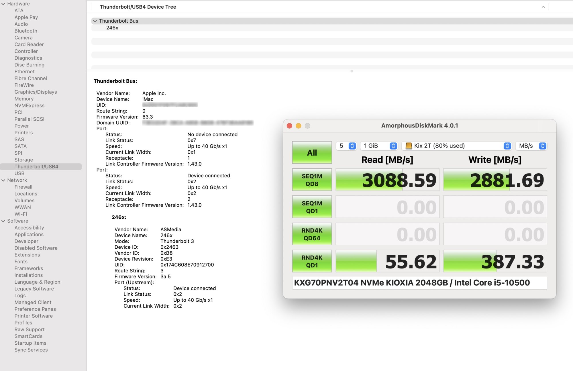

Your assertion is incorrect and you’re misinformed.
Intel Macs with only TB3 are fully compatible with the ASM2464 USB4 chip. That is to say, they don’t fall back to USB 3.1 as TB3 40Gbps mode is fully supported by the ASMedia chip.

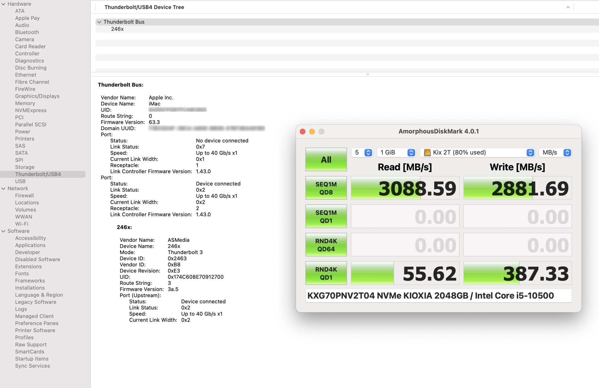

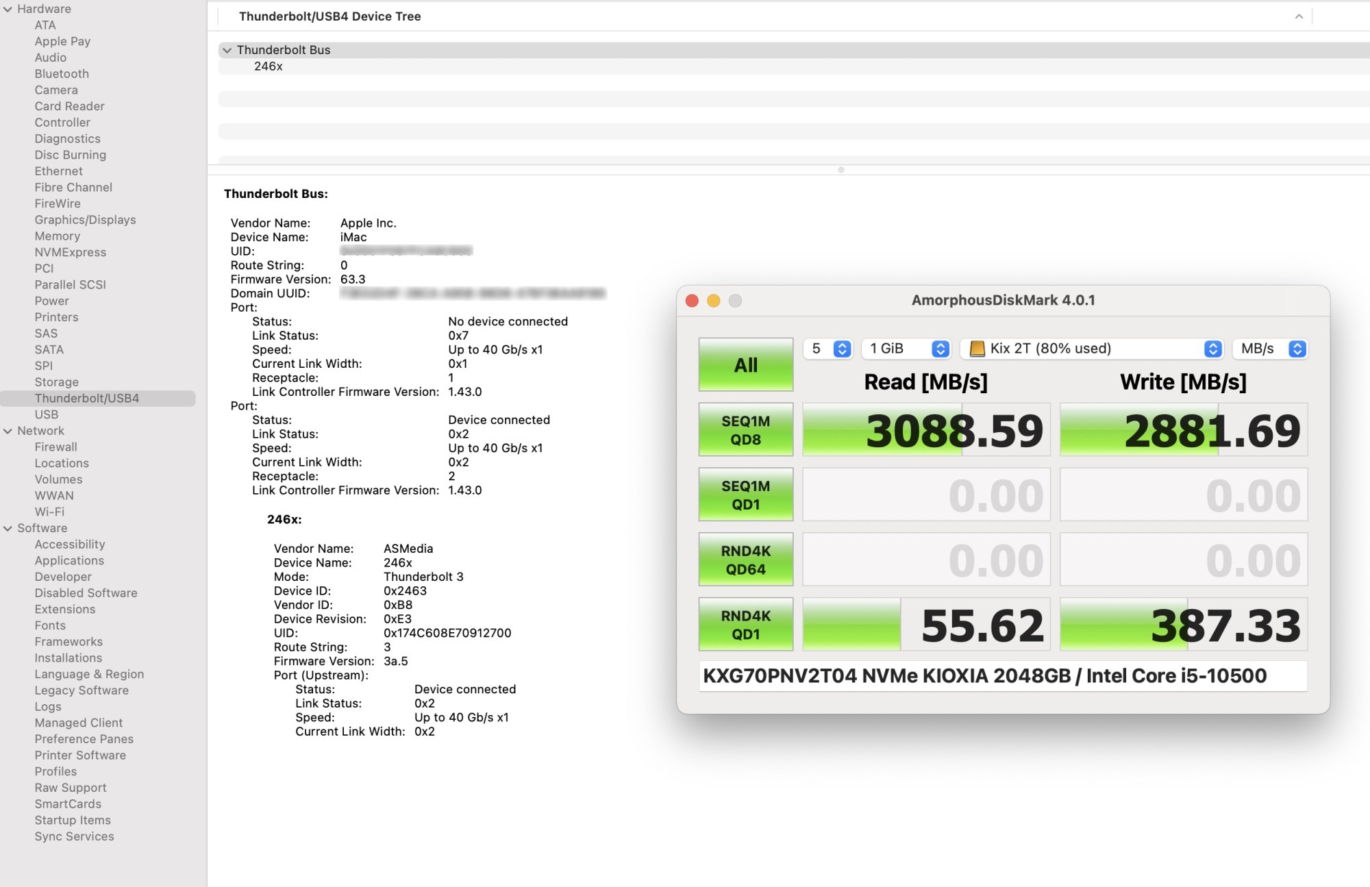

Here’s my 2020 Intel iMac with TB3 connected to an ASM2464 enclosure:

Something doesn't add up with your iMac's System Profiler. We know for the fact that no Intel Macs is supposed to support USB4 (I hope I am not remembering this wrong). If so why does it says "Thunderbolt/USB4 Device Tree" on top?
(EDIT: I just checked a MBP2019 16" and then a MBP2015 15" here, they both say "Thunderbolt/USB4 Device Tree" so it seems to be the norm, like an umbrella term)
Further, the ASM2464 chip is running in "Mode: Thunderbolt 3"? With a negotiated links of 2 at 40 Gbps no less.
And then you got the speed test to prove it. So it is not just a report, the SSD does run at "full" speed.
These just go against what has been known and tested on older Thunderbolt and USB4 devices out there so far. It looks like this ASM2464 chip is bringing some new capability, or maybe it unlocks some backward compatibility that was previously not possible?
