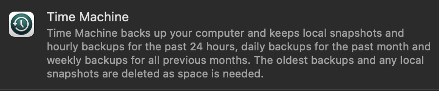

None of these are the issue for me. Also, regarding #1, Time Machine automatically overwrites the oldest backups, so that would never be an issue:
It is not that simple.
Deleting the oldest backup only frees up a very small amount of space - the space occupied by files that are unique to that particular backup - the majority of files will also be present on more recent backups and so their space is not made available. It may require many backups to be deleted.
Mostly this works fine, but there are circumstances where this process can break down - most obviously when the physical size of the disk is not much larger than the data being backed up and there are lots of new files needing backup.
I believe it is indeed that simple. Notice is says the oldest backups (plural), meaning it may delete more than just the oldest one if more space is required. This has been working for me flawlessly since Time Machine came out in 2007 . . . until Ventura. Ventura mucked something up for sure. But even if you're right, then why does Time Machine not generate an error message?
Let's assume that the oldest backup was the first backup and many of the files there have not changed since. When TM runs out of space it would not delete those files since they have not changed. It only removes deleted files. In the worst case (no file changes at all) there would be no change in size if you delete the backup.
If file1 has not changed and file 2 has:
When TM deletes it still keeps the latest version of the file. For example, let’s assume we have two files file1.txt and file2.txt. The file1.txt was changed once and file2.txt was deleted. If there is enough space TM will store 2 versions of file1.txt and deleted version of file2.txt.
When the backup disk fills up TM will delete old (first) version of file1.txt and the last version of file2.txt. TM will not delete the last version of file1.txt because there is still hard link (from the last back up) pointing to it.
