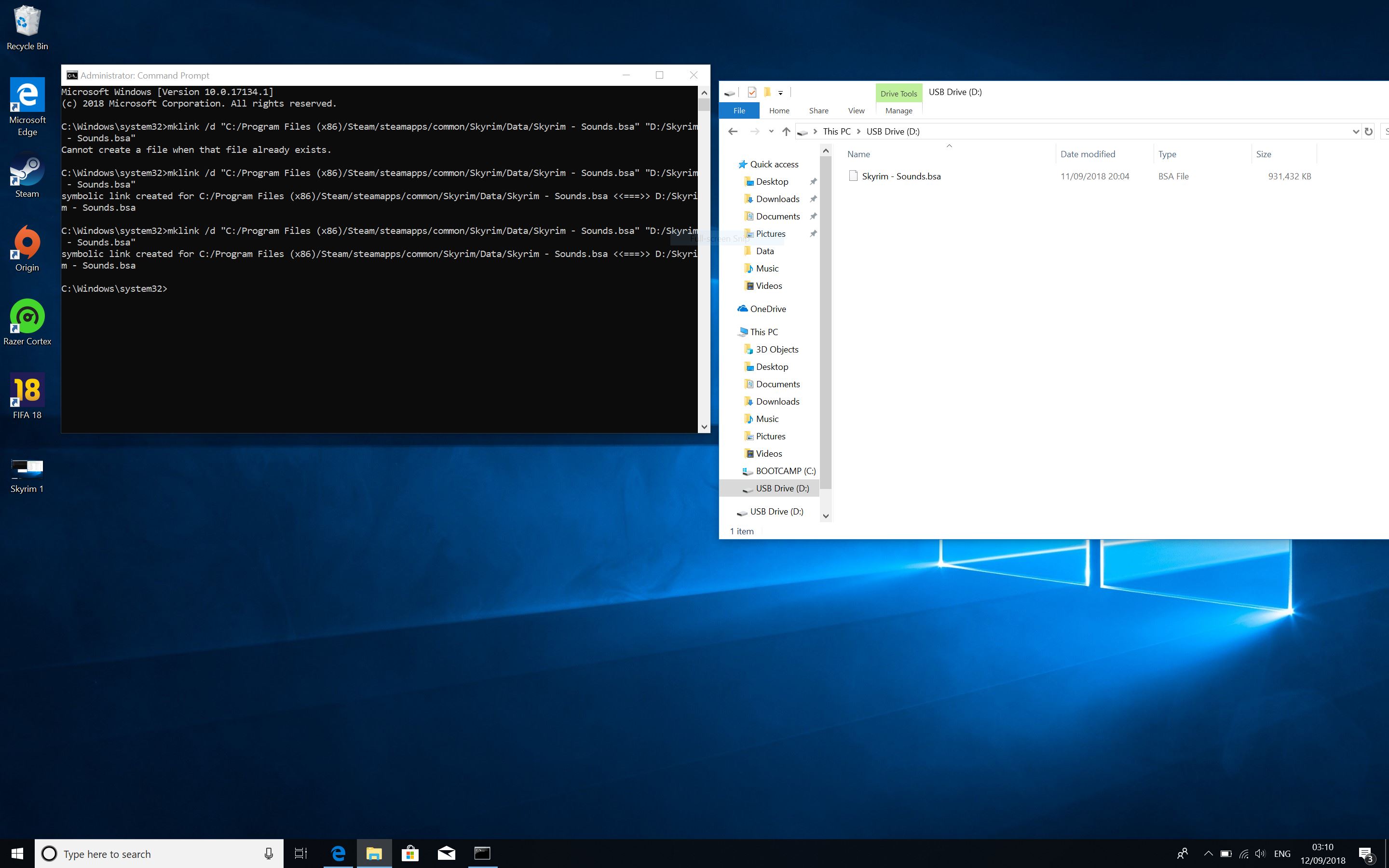

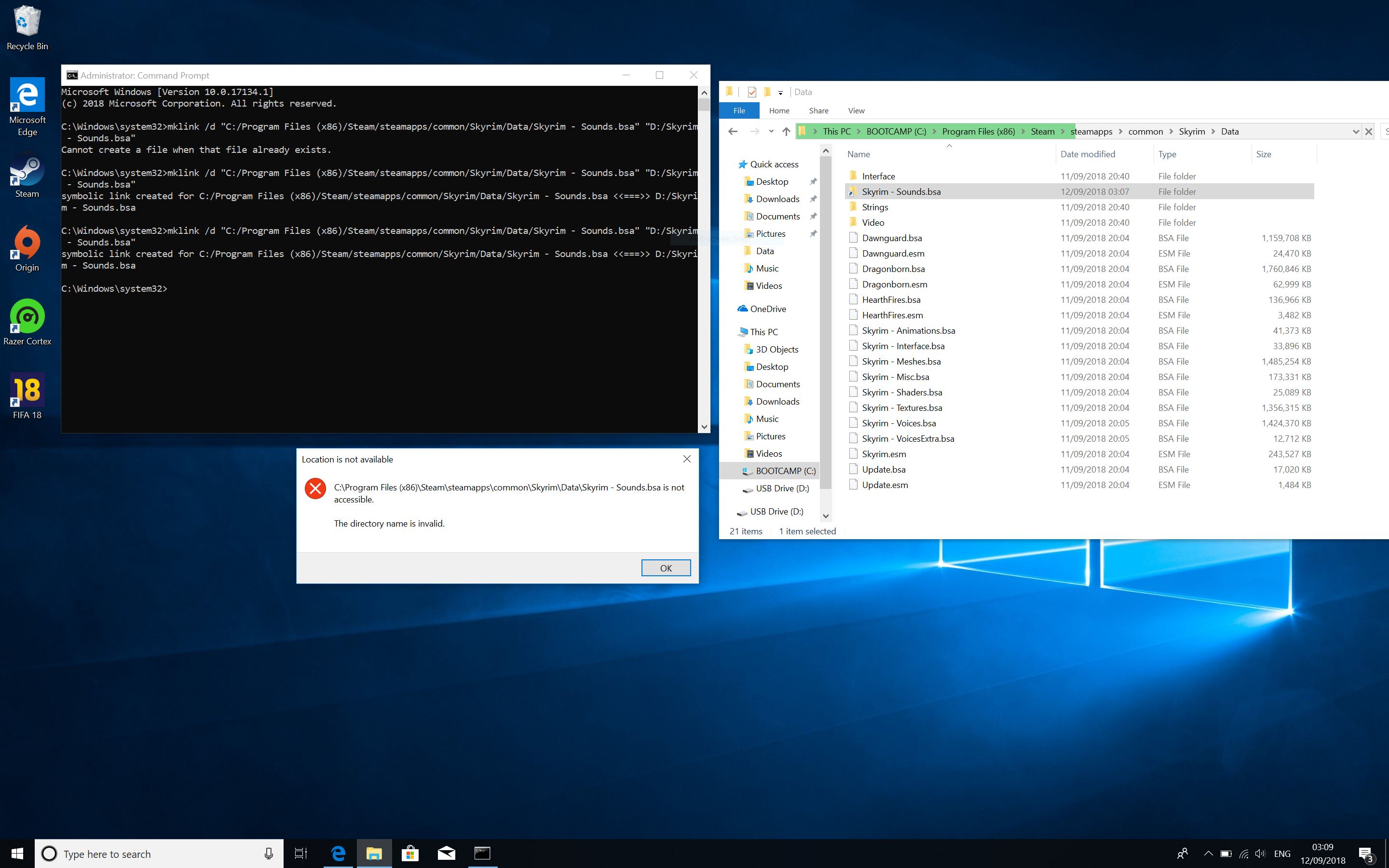

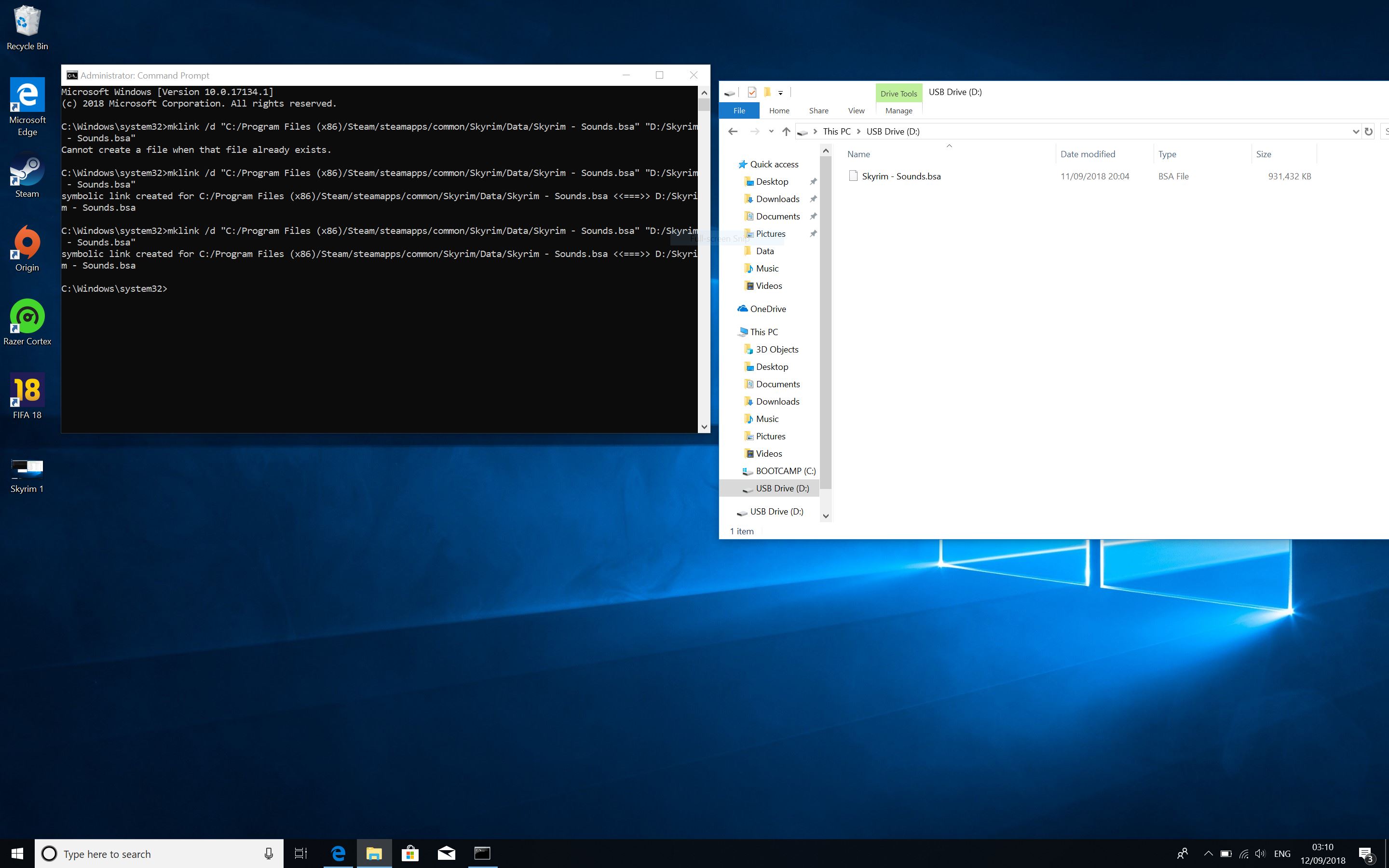

Hi All - I'm having the same problem here on my MacBook - I have created the symlink as Krog suggested - but instead now I have no sound on Skyrim... - its probably me creating the symlink incorrectly - I have attached photos so you can see how I've done it... - its saying the directory is invalid when I try and open the symlink file to see if the sounds.bsa file is in there?... - any help would be very much appreciated - ive spent ages looking for an answer and it seems such a shame to fall short now - Thanks for your time🙂

Hey seamus it looks like you accidentally created a directory/folder instead of the symlink. When you ran what Krog said in cmdprompt you added a /d infront of mklink, likely the cause of your problem. Try again without the /d and see if it works.
Also just so you know you might have to also symbolically link the Voices file if you keep having problems (like not being able to hear your characters shouts).
You good sir are an absolute genius - can't believe I missed that - all works perfect now - had to symlink the voices.bsa and voices extra files as well - works a charm - thanks so much again🙂
