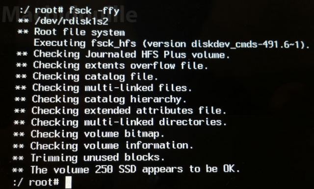

Thought I'd add a comment for my Intel 320 series. I just got done doing the fsck TRIM method noted HERE on Hardmac. I installed the patch and booted in single user mode, and sure enough, it showed that unused blocks were being trimmed, just like this:
Whether it actually did anything, I do not know. I hadn't noticed a lack in performance. I just wanted to do an experiment on it and thought I'd report back. Afterward I restored to pre-TRIM patch state, and rebooted. Reboot was a little slow, so I ran the terminal commands and rebooted again. Back to normal now.
