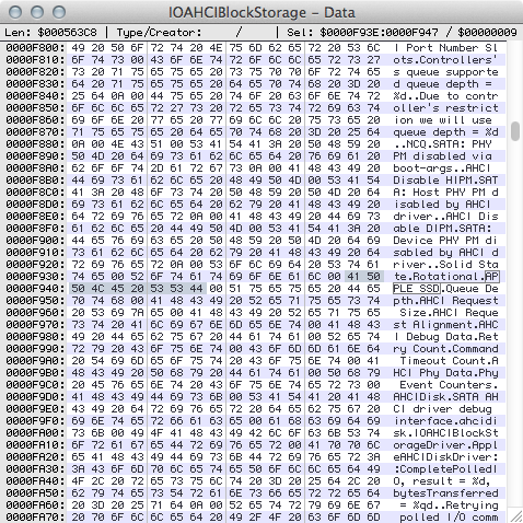

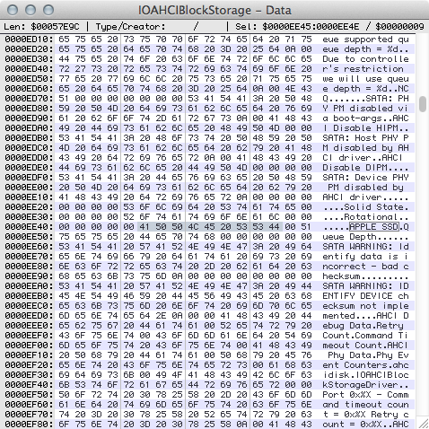

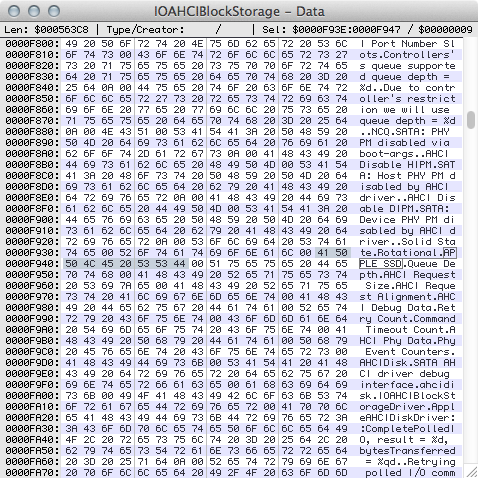

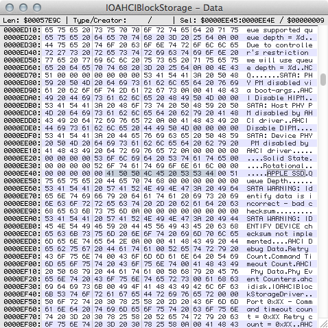

Sorry but you are wrong! The IOAHCIBlockStorage kext in 10.7.0 Lion is not the same as in 10.6.8 Snow Leopard.
The IOAHCIFamily kext have the same version in 10.6.8 and 10.7.0 but the included IOAHCIBlockStorage kext is not the same.
The IOAHCIBlockStorage kext has different version (1.6.4 in 10.6.8 and 2.0.0 in 10.7.0), date and size if you compare them.
You can also compare the binary files via the cmp -l terminal command or analyze the binary files in the different kext versions.
Please see the enclosed pics where you replace the APPLE SSD text in the binary file. Still not convinced?
Code:
-rw-r--r--  1 root  wheel  360092  8 Jun 01:48 ~/Desktop/10.6.8/IOAHCIBlockStorage
-rw-r--r--  1 root  wheel  353224 18 Jun 22:11 ~/Desktop/10.7.0/IOAHCIBlockStorage
