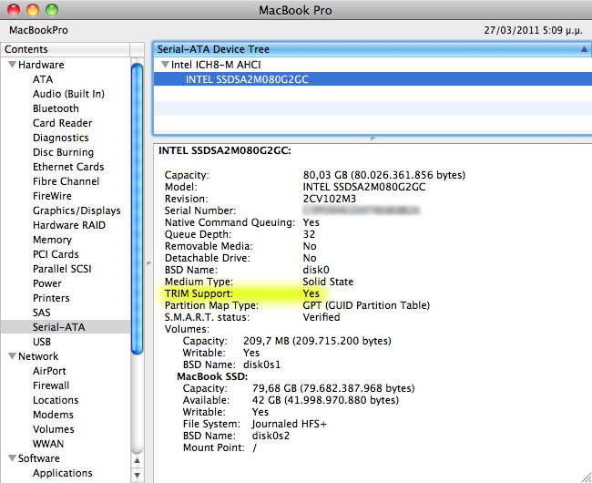

Dear Cindori, you were probably reading my mind. Thank you for your hard work and your findings, alongside everyone else involved in searching and patching. I manually installed the v2.0.5 IOAHCIFamily.kext that includes the plugin IOAHCIBlockStorage.kext (the binary with the zeros) and upon reboot, it worked on my MacBookPro3,1 and my Intel X25-M (80GB)!
I agree with you, perhaps 10.6.8 will bring TRIM to everyone with "APPLE SSD" whilst we sit and watch... or patch 😀
Thanks again to everyone.
