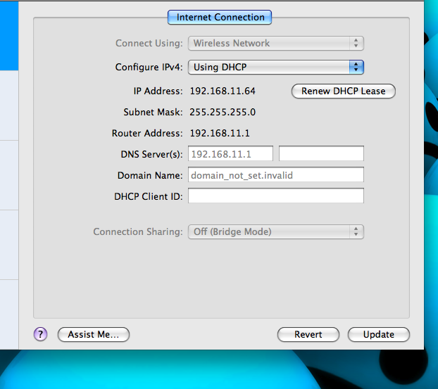

How come in the airport utility when I select my time capsule and then the internet option I only an internet connection tab and no others, also I cannot change the connection sharing? It is there but it cannot be changed.
I have sorted out a picture of what I mean
well, for this to work, you have to the updater on some computer on your home network.
but you say it's working now?
i'm not sure about the options for the time capsule, i only have an airport extreme
