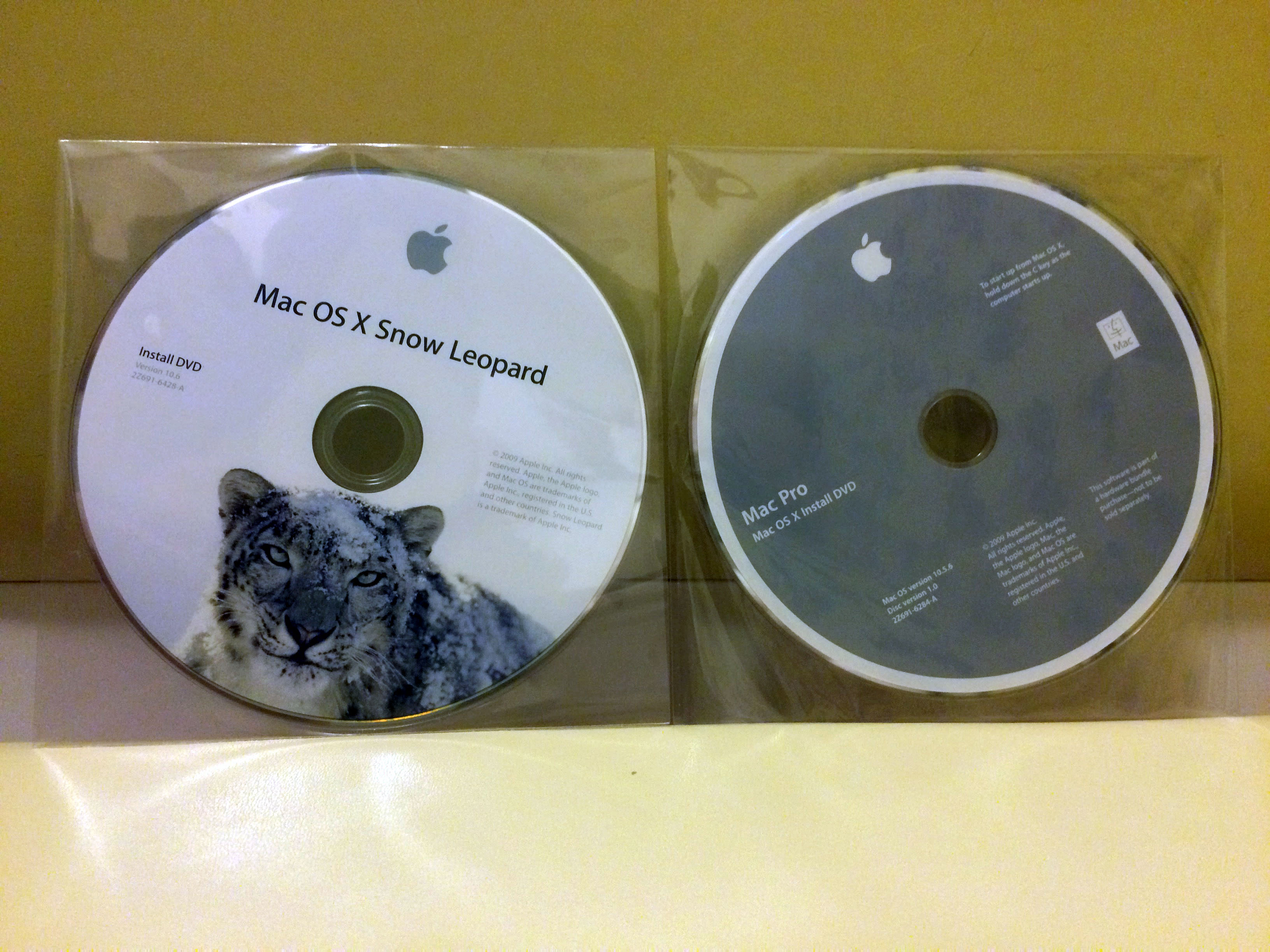

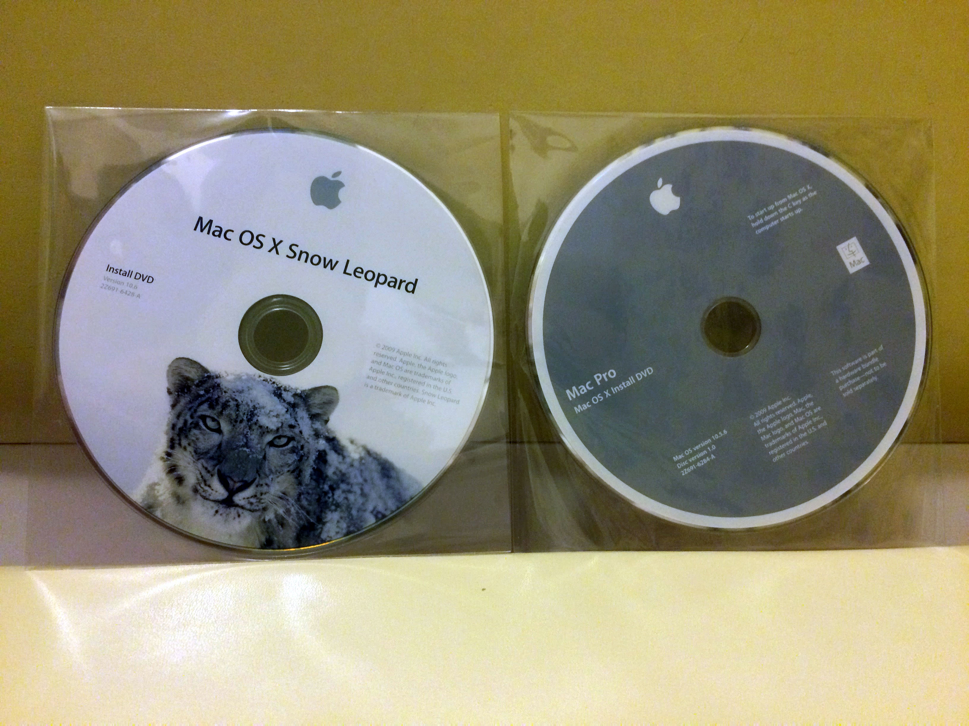

Do you have the left disc or the right disc? The left one won't work, the right one should work.

It is the right one.

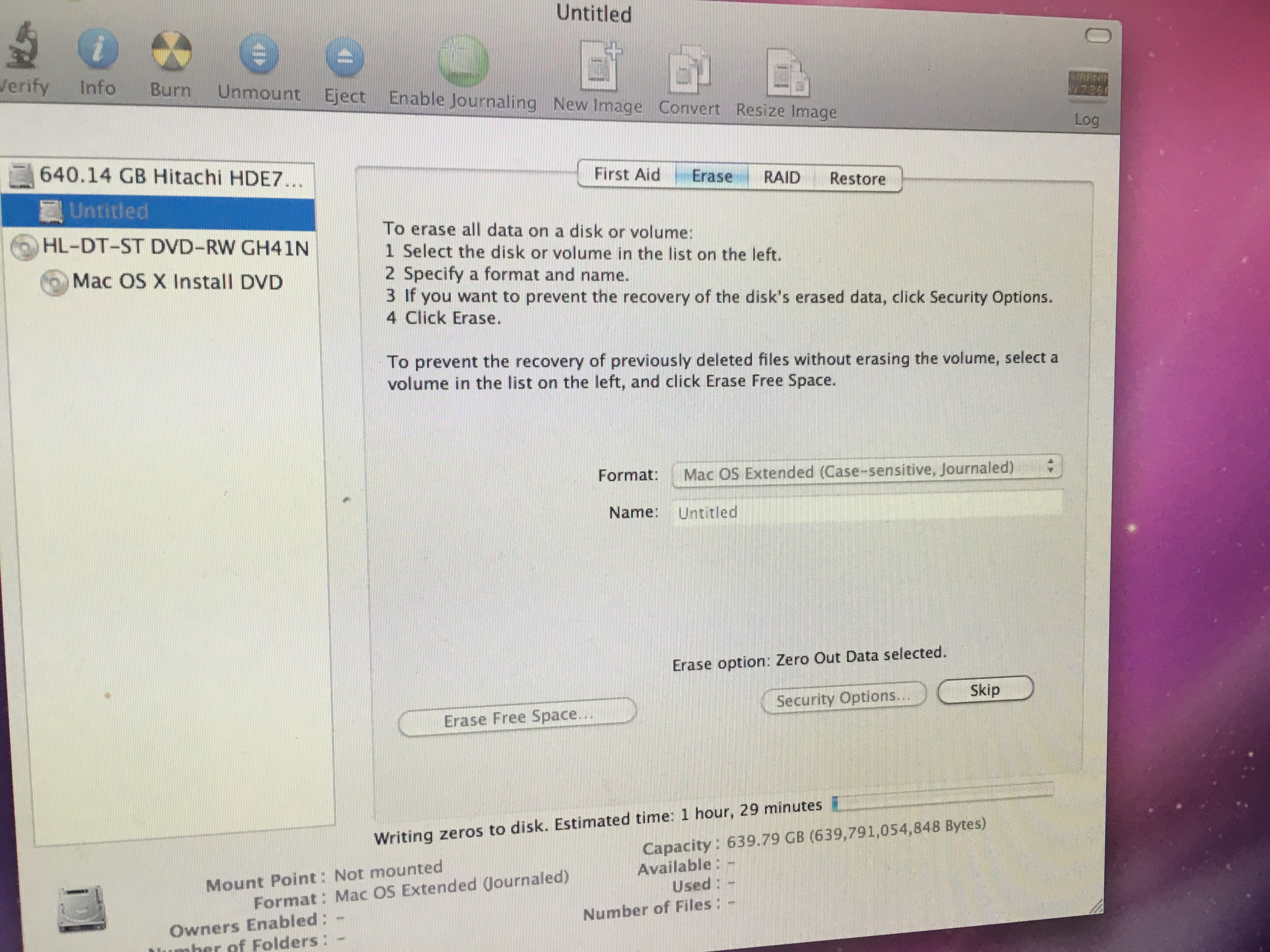

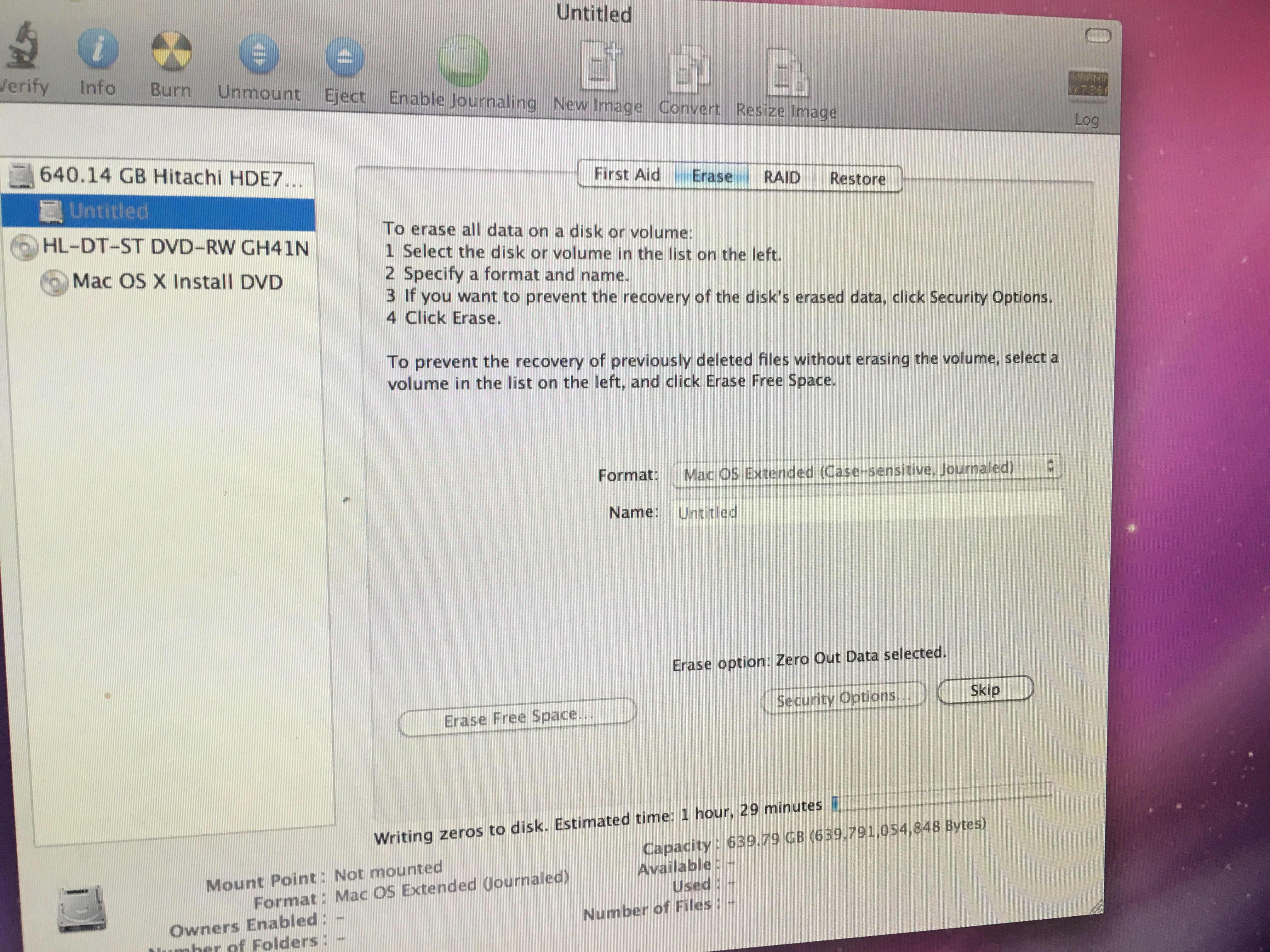

[doublepost=1459826330][/doublepost]This is what I'm doing now ...does this look correct...?

In your earlier screenshot it looks like you selected one of the secure erase options, and that takes some time to complete. Did you let that finish? If you did, you should be all set. It looks like you selected the drive then did a secure erase, which will format the drive into one large partition for you to install the OS. You do not need to erase then also make a partition. The erase procedure you did already makes the partition.
So what happens now if you quit Disk Utility then tell it to install the OS? That should now work.

1. You are using that grey Snow Leopard 10.6.4 CD that came in the box new with the Mac Pro?

In regards to the cd there is a chance that it might not be as I bought it 2nd hand.
It sounds like you are doing everything correctly and based on the error message you are seeing, I'm thinking that CD is not the one that came with the machine. Those grey CDs are model specific. So for example, you cannot take that grey Snow Leopard CD from a MacBook and use it on a Mac Pro.
