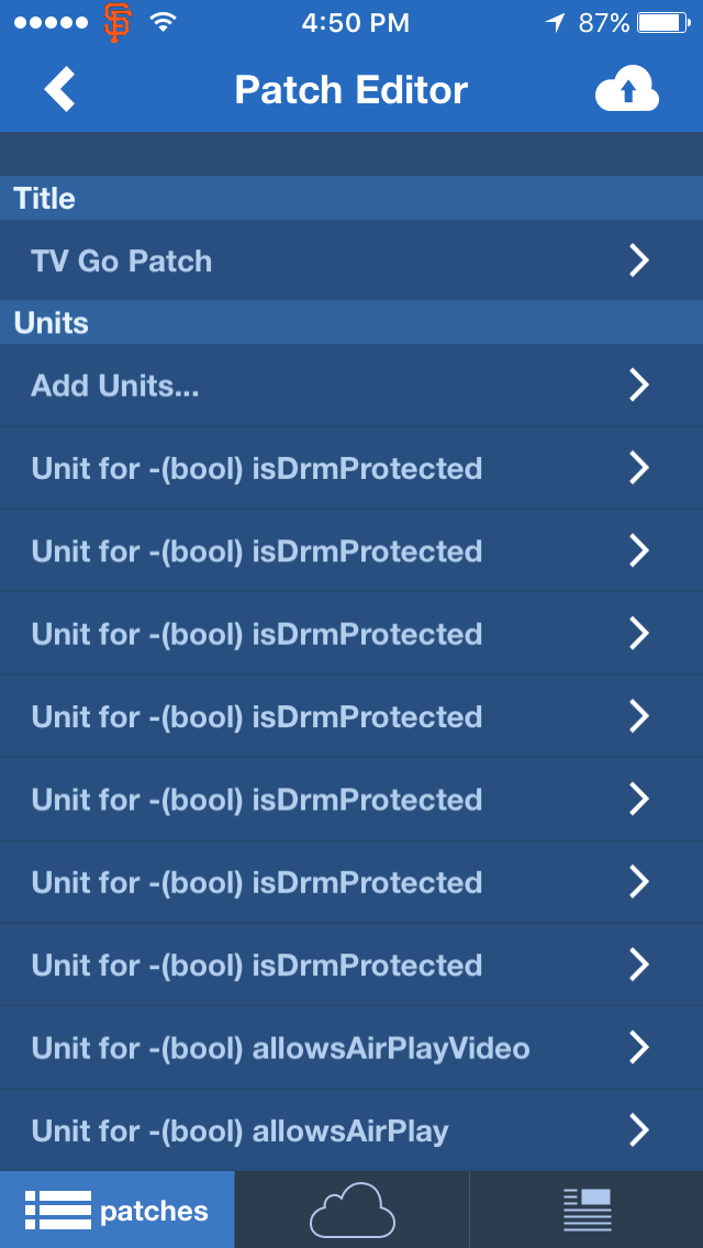

Okay, I found my patch for the Xfinity TV GO app that I had upload a while back when I first created this tutorial. I haven't tried them yet but once I can confirm it's working I'll post the unit names and values. If you would like to test it yourself first then follow these steps:
1) Download and install Cracked FLEX 2 from Cydia
2) Open Flex 2 and switch to the cloud tab (tap the cloud button on the bottom menu)
3) In the "Installed" list, look for the TV GO app, it should be called "Player", and tap on it.
4) Download the following patches:
- Player Skips Commericals
- Remove Jailbreak Check
- TV GO Patch
DO NOT DOWNLOAD THE AIRPLAY PATCH IN THIS LIST. That path is not mine and I have never tested it out so I don't know if it will work.
5) Tap back to the "Installed" list and go back to the top of the list
6) If you have the cracked version, the first app in the list will be the FLEX icon with the name "Uploads on Server Cracker". Tap on that.
7) This list is shows all the patches uploaded by users that have the cracked version of FLEX 2. (Most) Patches are in alphabetical order.

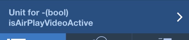

8) Scroll all the way down to the "T"s and look for TV GO: Enable AirPlay Video. Download this patch.
9) Go back to Patches tab (tap the list icon on the bottom menu) and turn on all the TV GO patches you just downloaded.
10) Enable AirPlay Video (NOT MIRRORING) and any video you play from the app will be sent via AirPlay Video(NOT MIRRORING) to the Apple TV

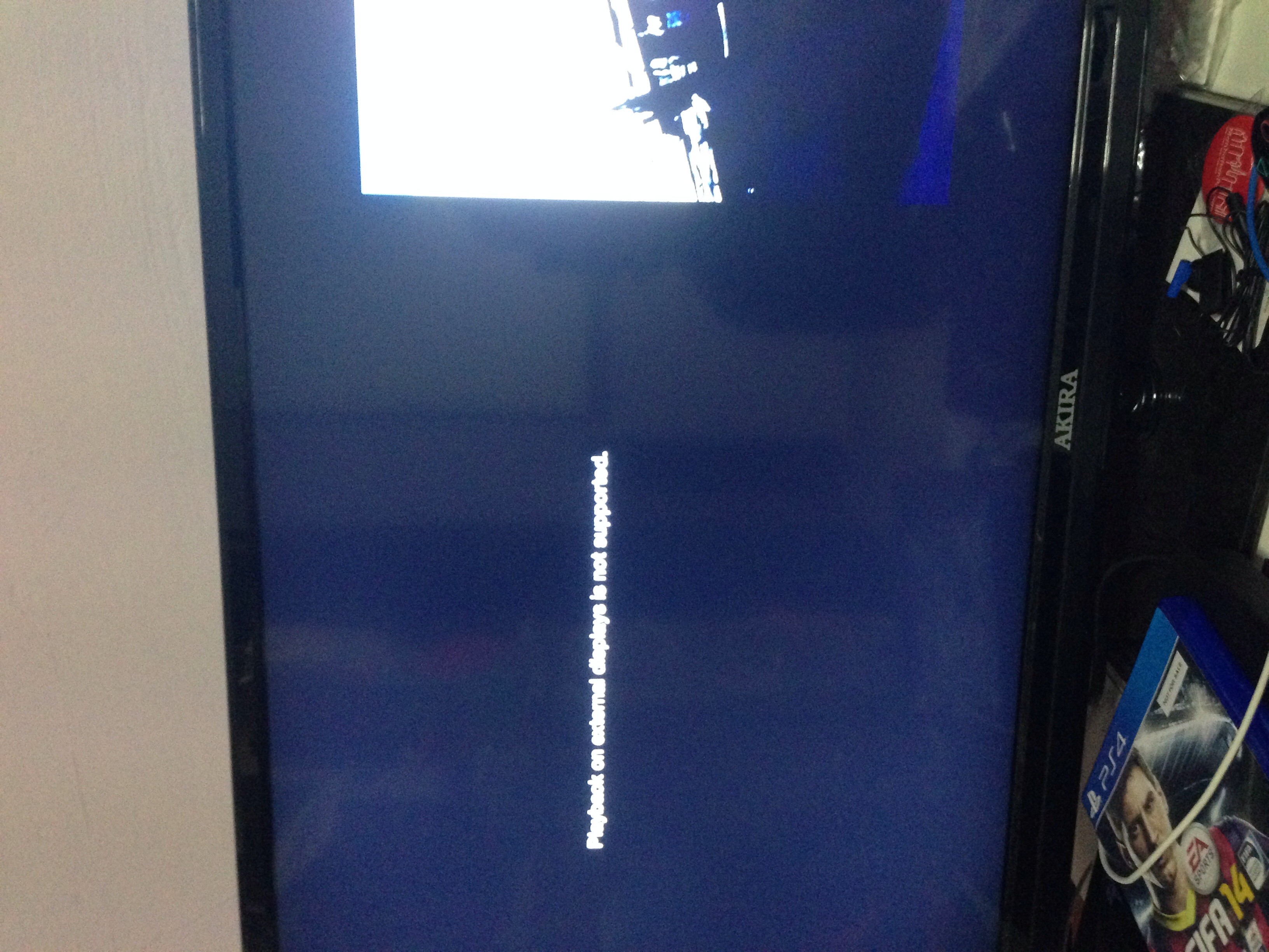

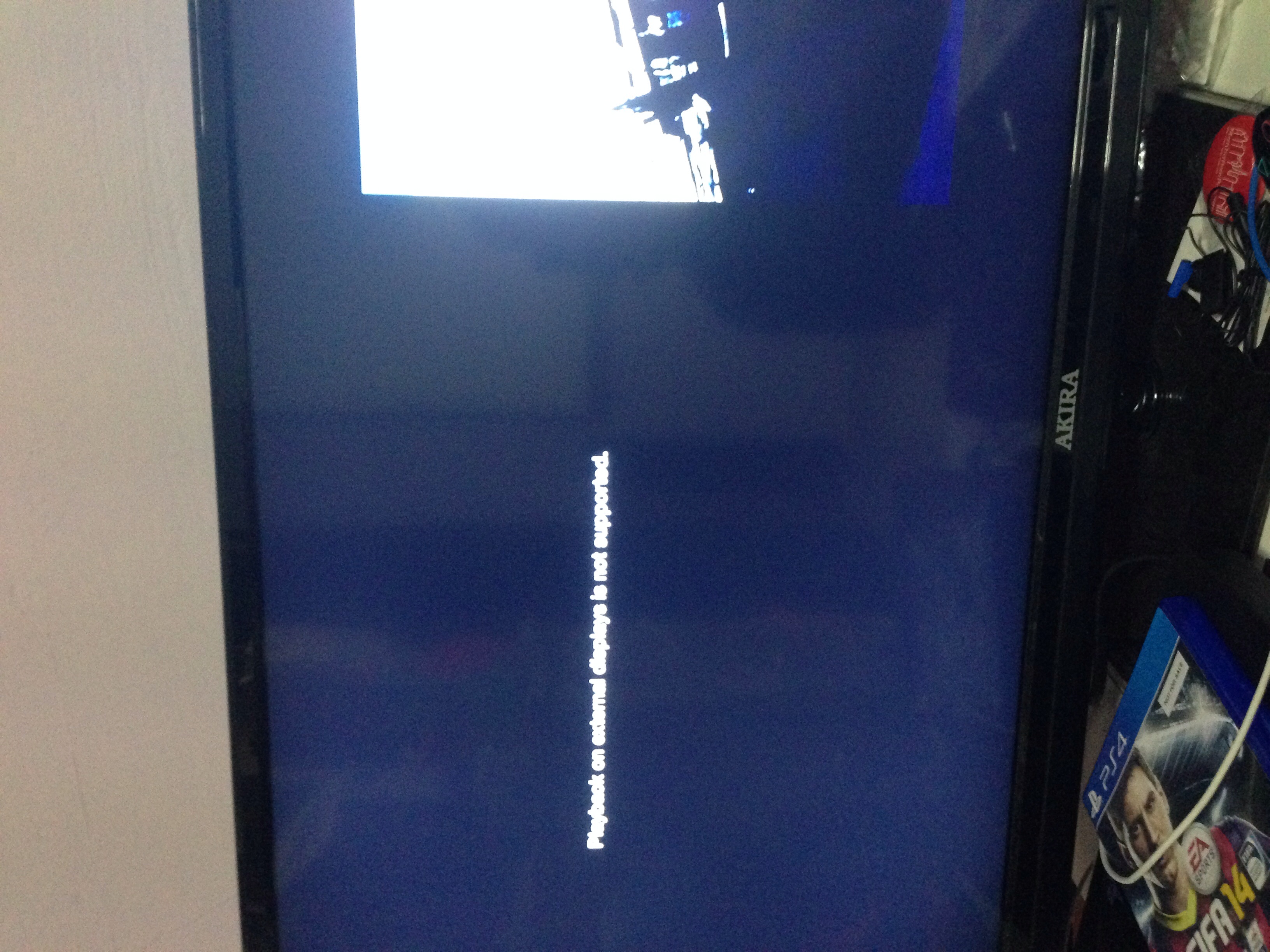

I tried using displayout and get the following image with half the screen block. Is there anything that I can do to remove the black part via flex 2? Sorry for the rotated image.
The only thing I can suggest is to look at the units of an HDMI out patch that works, and see what was modified.
Go to Cloud in the Flex 2 app, then the Installed tab. This should give you a list of your installed apps. Pick one that doesn't have HDMI out, and see if there is an HDMI out patch for it. Verify the patch works, and then comb through the units to see what was modified.

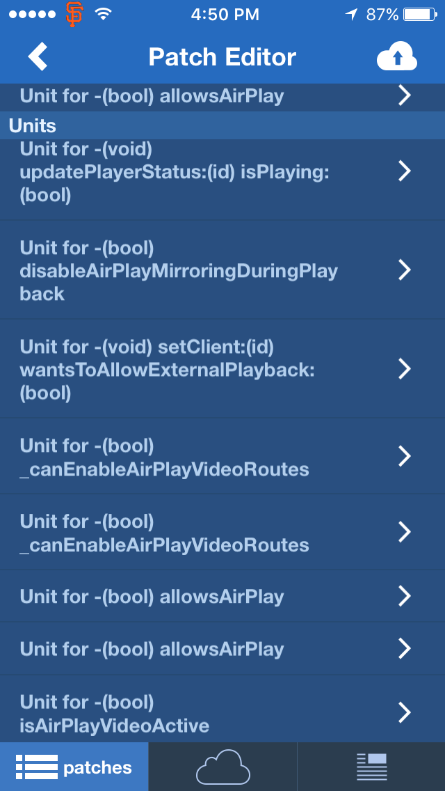

I'm using the latest version of Xfinity TV 2 Go app with AirPlay using the values listed in this thread. I did not use any cloud patches; I entered the values manually listed in the OP. Here they are for reference (18 total).
This only works if mirroring is turned off, and I found that I have to disable screen autolock to keep the stream going (regardless of whether or not the app is enabled to run in the background via any of the options in Watchdog Pro, etc).
I heard a rumor that Xfinity is going to allow AirPlay in the near future, in the meantime, this works great.
As mentioned in the thread I linked, some reported that they had to start the stream and let it play for 10 seconds before enabling AirPlay. I have not had to do this, but it's good to know just in case.
