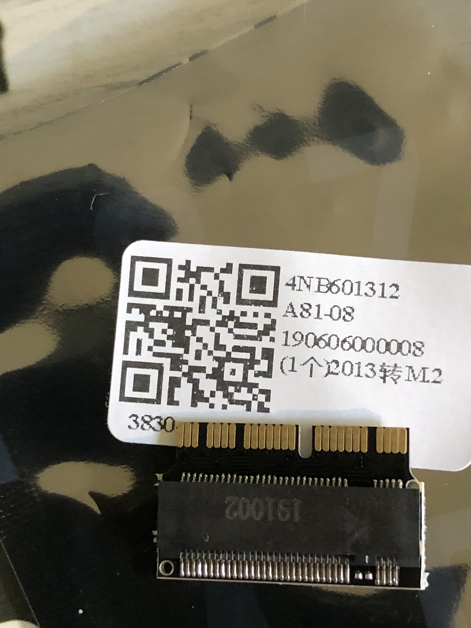

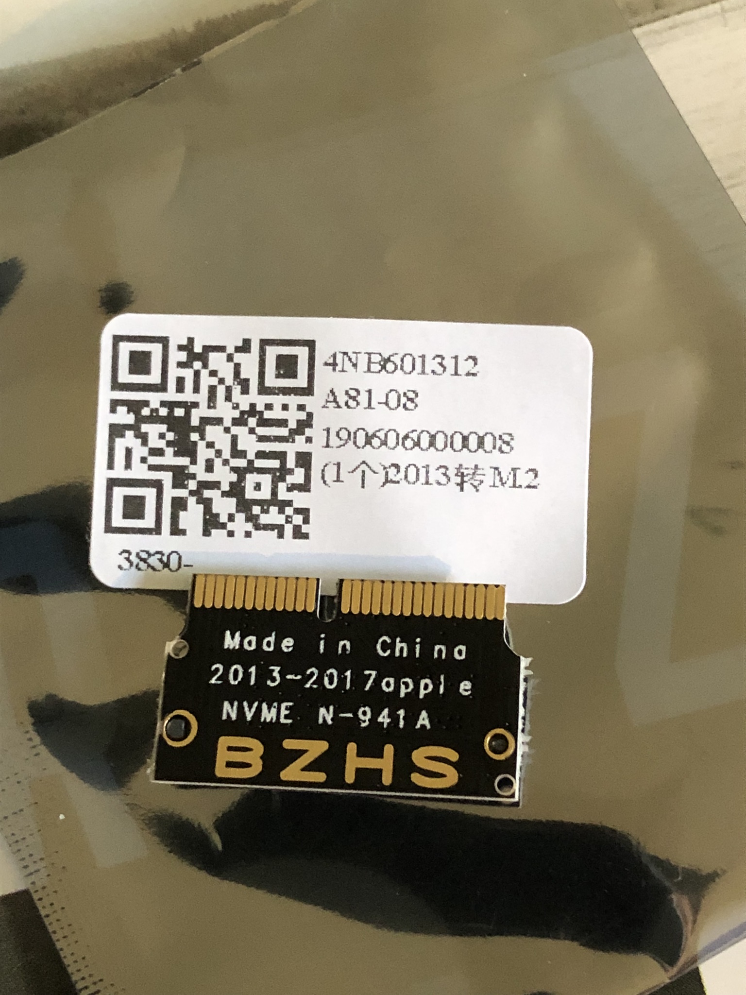

I purchased a cheap no-name adapter ($2.34 USD with free shipping to Canada) from eBay and lexar NM 600 240 GB (https://www.canadacomputers.com/product_info.php?cPath=179_1296&item_id=139194) to use in an early 2015 13" Air. This combination works perfectly with a fresh install and a restore from a TM backup. SSD is recognized as x4 drive and allowed a bootrom update to happen when I upgraded from High Sierra to Mojave.
This adapter is slightly bigger than the small, black Sintech; therefore, I had to fiddle a bit with positioning to get the drive screw inserted.

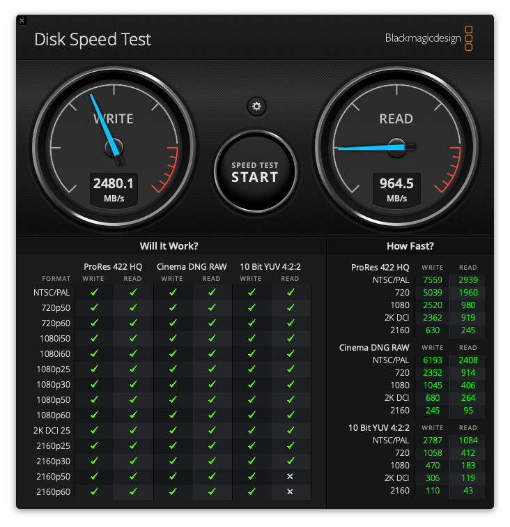

Black Magic reports originally around 2500 write / 2000 read.
After maybe 2/3 additional runs, write speed will maintain (or at least build to it's high), but the read speed will drop off a cliff.
I'm sure it's been covered in one of the 200 pages here, but would someone be kind enough to clarify why?

This is what I suspected, cache being full (using the 5GB file size) - With the 1GB file test size no issues - so I suspect that's the cause

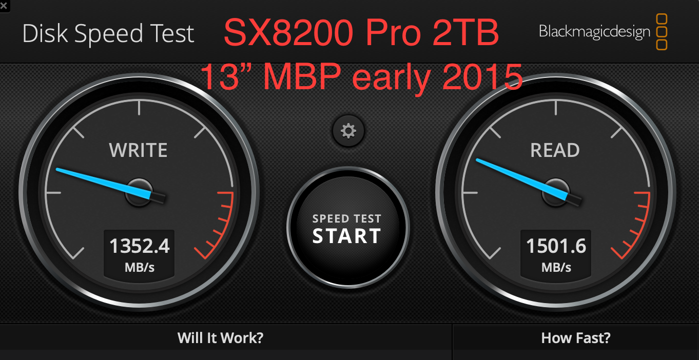

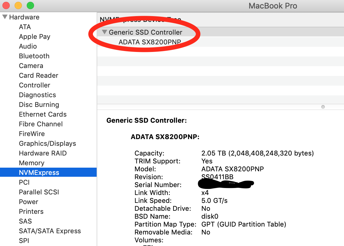

13" Macbook Pro Retina early 2015 + long black Sintech + Adata SX8200 Pro 2TB
Interestingly, unlike my SX8200 1TB (non pro) in my 13" MBP Late 2013 which shows up as "Apple SSD Controller",
the 2TB Pro shows up as generic
Given the failure of the two Sabrent 2TB drives, I feel like I should be stress testing this somehow.

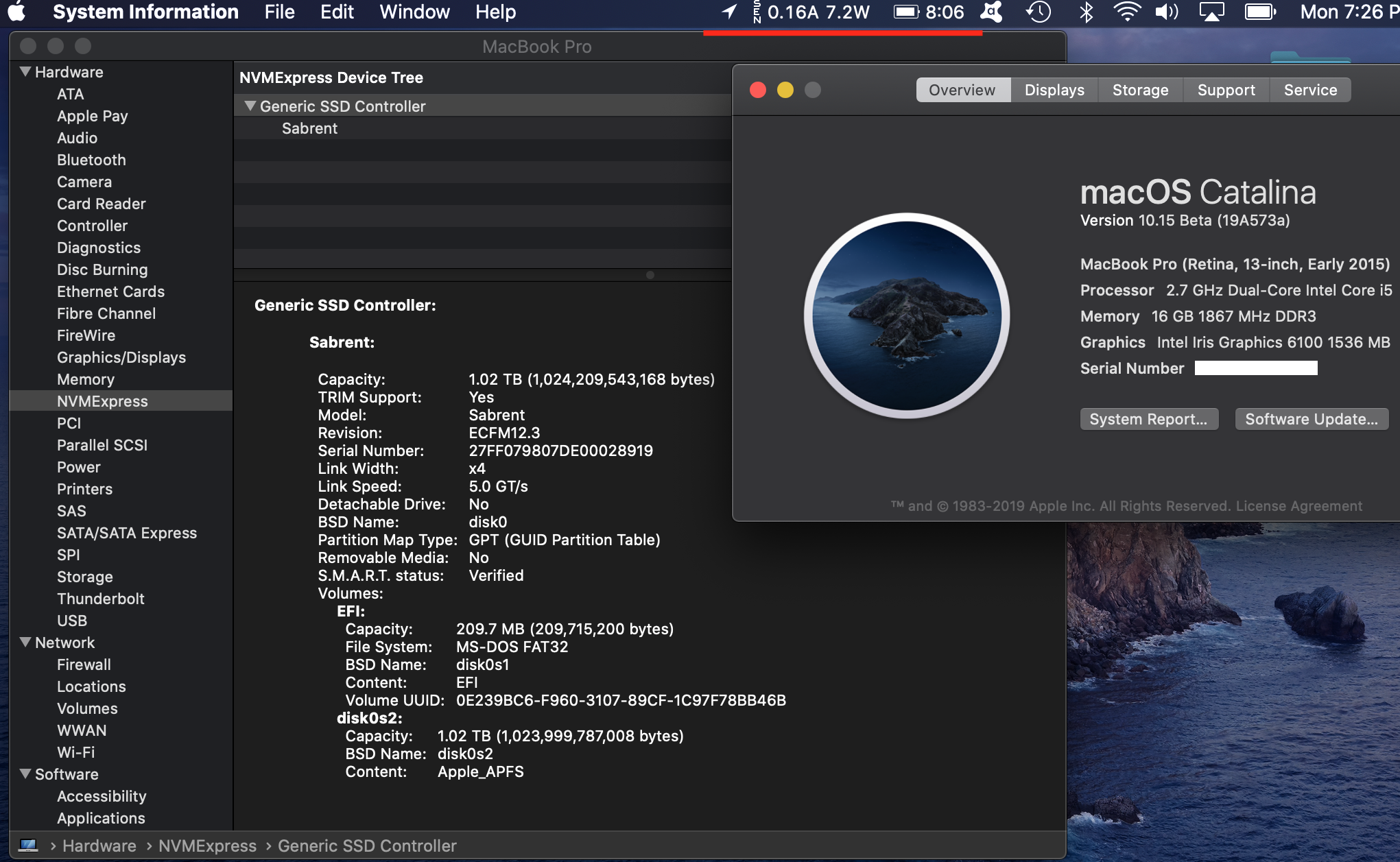

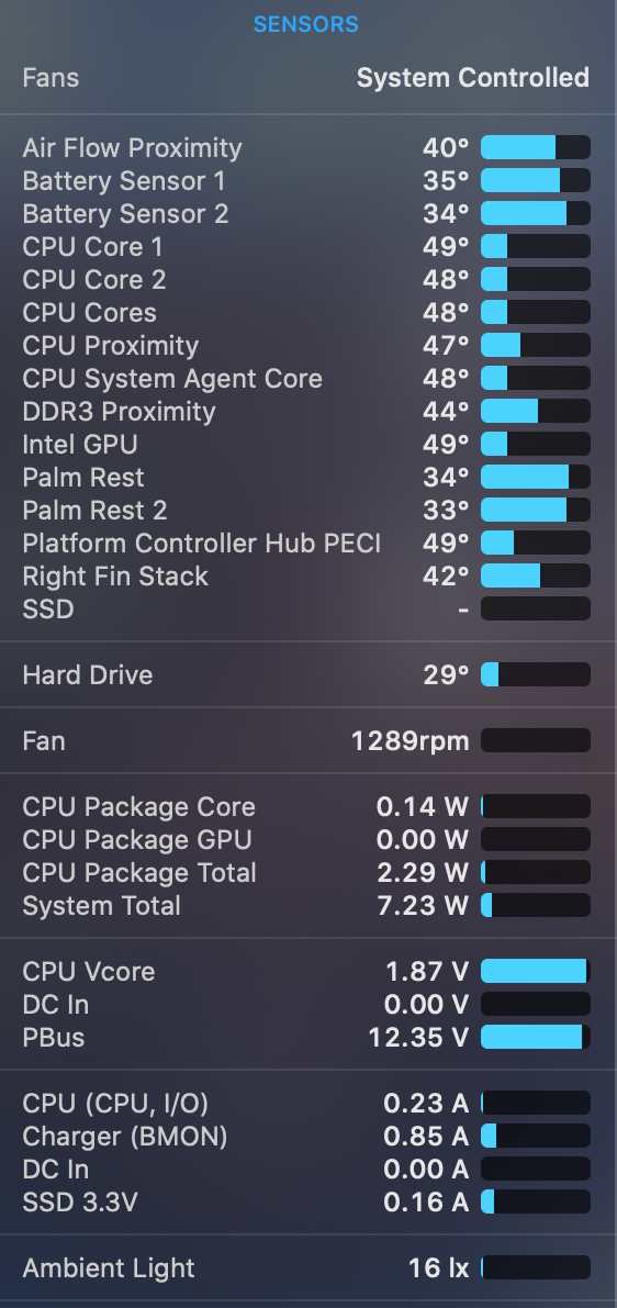

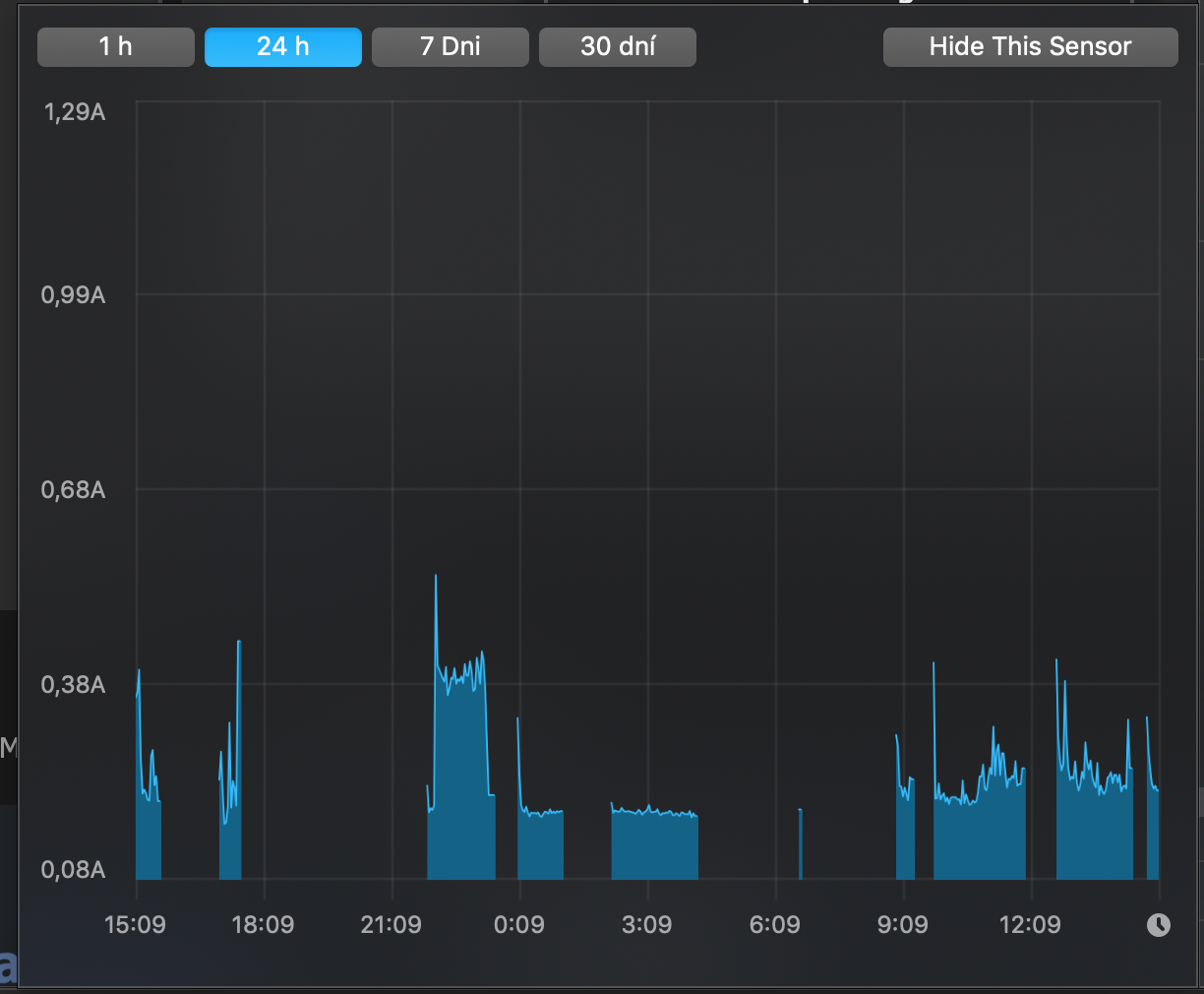

Same problem here, I have Macbook Pro 15 Mid 2015 with Sabrent 512Gb SSD and I've got 3 hours of basic work on macbook. My boot rom is 192.0.0.0.0. Is there any solution for this ? Is there any better SSD with lower power consumption than sabrent ?
This is power consumption of my ssd it's basically between 200 and 550 mA.
I think that Sabrent rocket has almost the lowest power consumption available. About your power consumption, you might want to check elsewhere.
Been eyeing to switch from sabrent rocket myself. My 970 Pro (I wanted speed at the time) is consuming 0.3A minimum, 0.66A average, and 1.6A at load. Thats translate into 1.5W idle to about 4W at load. vs Sabrent's 0.5W idle 1.4W load.
Also, I get about 4-5 hours out of my rMBP 2015 15" (DG). my BootROM version is 195.0.0.0 (from Catalina Beta FW update). (I force it to update using /usr/libexec/efiupdater)
