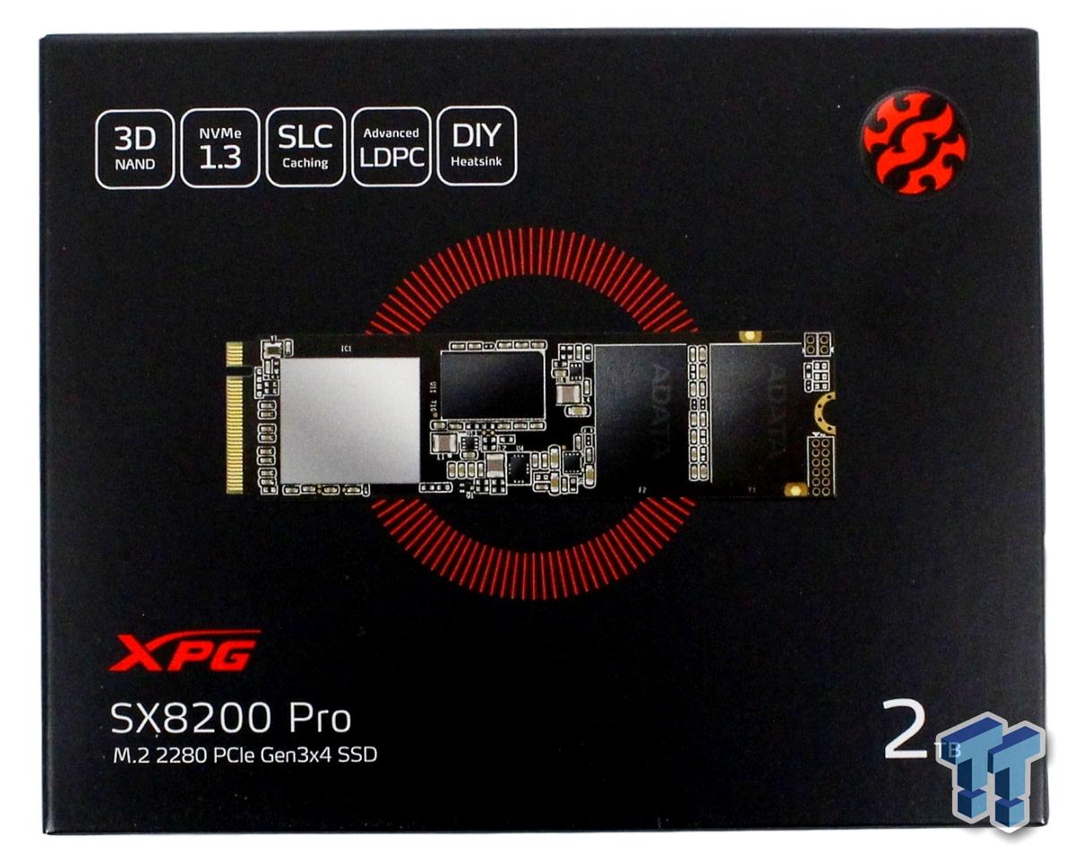

Yeah, I was hoping to not spend the extra $120 that the Samsung 970 EVO Plus costs. What are the benefits of the Samsung 970 EVO Plus versus the ADATA XPG SX8200 Pro 2TB?
For my view of Samsung vs any other.
1.Better utilities (Magician + bootable ISO for firmware updates). For reference, Sabrent utilities don't know info their 2TB version, their UI Sucked, and firmware update on website is .exe only and is hard to find. YMMV on other Phison-based SSD Vendors.
2.Better Performance; Their flagship is almost always the fastest in the market. Though Evo is not the flagship sub-brand, it's darn close as they use same controller and design, just differ on TLC NAND vs MLC for PRO, until 980 Series that is (It's All TLC now). And they don't have 970 Pro 2TB either.
3. Personal experience.
Been using Samsung since 840 Pro. Never failed me. (unless you count 970 Pro being a power hog w/ ASPM off on macOS, but it's not its fault lolz, and is Now fixed w/ NVMeFix.)
for ADATA vs Samsung see:
However, note that 970 EVO Plus 2TB version benchmarks put it at the same performance mark as 970 Pro 512, just a tad bit lower IOPs (2000 lower I think)
If we are to go by Wendell's video, the performance should be roughly on par.

So for my 2014 MBP SSD upgrade, I have a Sabrent Rocket 2TB drive in hand. However, since I ordered it, I've become aware of the reconfiguration with a lower DRAM quantity and also higher power usage. I'm wondering if I should send it back and replace it with the XPG SX82100 Pro 2TB. Is there another drive I should consider?
Thoughts?
SX8200 Pro should be fine. Although its slightly hotter but that still a best bang for bucks drive. It even beat Samsung 970 EVO in various scenario. Just make sure you use short adapter. SX8200 is using double side design for the component.
I ordered it and I already have the short adapter. Thanks for your advice.
