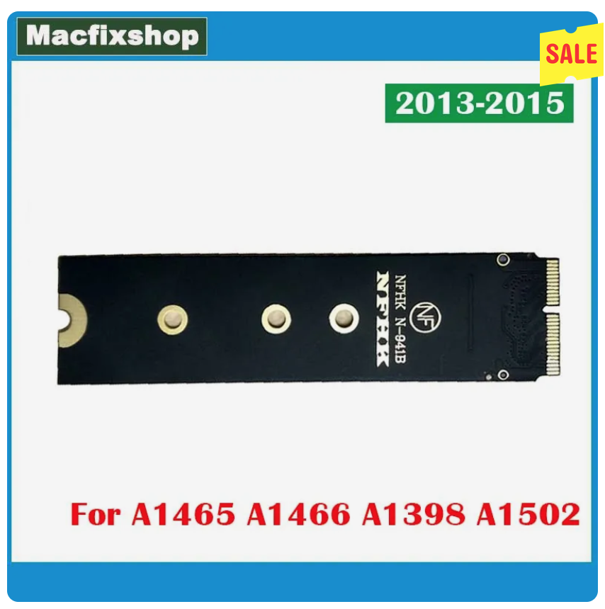

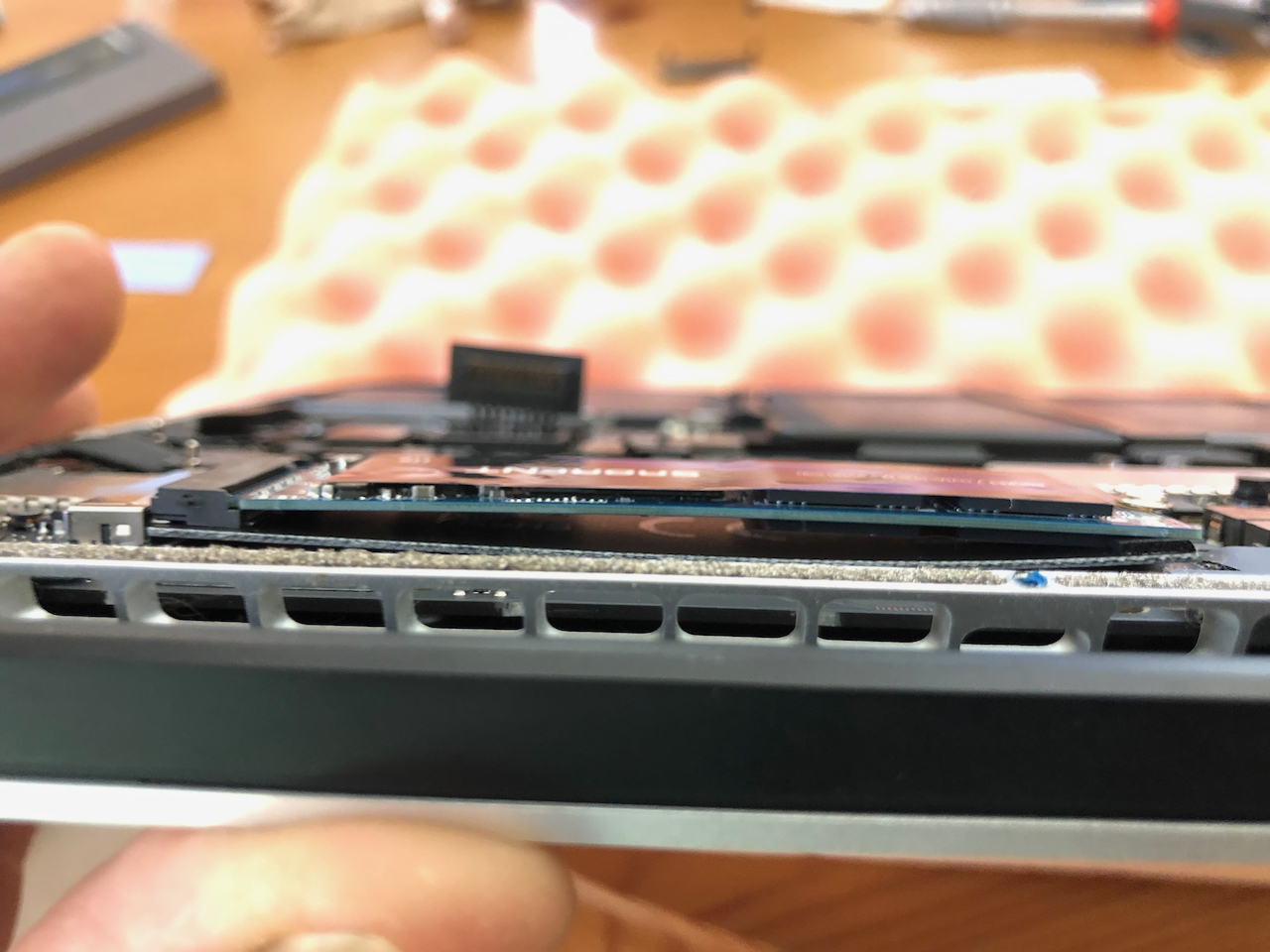

I have another question for those who know. I replaced the SSD on my a1502 (MBPro 13" Mid 2014) with a non-original one, took an Apacer 1TB.
The new SSD's PCB is slightly bent when inserted into the adapter and fastened with the factory screw. How critical is this for the disk's lifespan? Is there a hack to avoid bending? If I don't screw it, my PCB is slightly tilted relative to the adapter and will probably press against the back cover or wobble, or it may even pop out of the connector during use (although it feels tight). Unfortunately, I didn't take photos. The laptop is assembled now and everything works normally.
Which adapter are you using?. Not sure about the 2014, but my 2015 15" took the long Sintech adapter very well. I ended up with that as my original Mac-2015MBA, I had ordered the long adapter and discovered it made the SSD so elevated with the SSD I chose, that the case back was pressing down on it pretty significantly. I then ordered the Sintech short adapter and it was fine. I hung onto the long adapter and good thing I did cuz that worked fine in my 2015MBP. Having the case back press down on the SSD will definitely cause issues at some point, if not immediately. The SSD needs to be screwed down and secured. So long term you might want to look into that if it is pressing down on it with it being secured, plus it should not be in a bent position. That will also cause failure at some point.
Reactions: macpro_mid2014

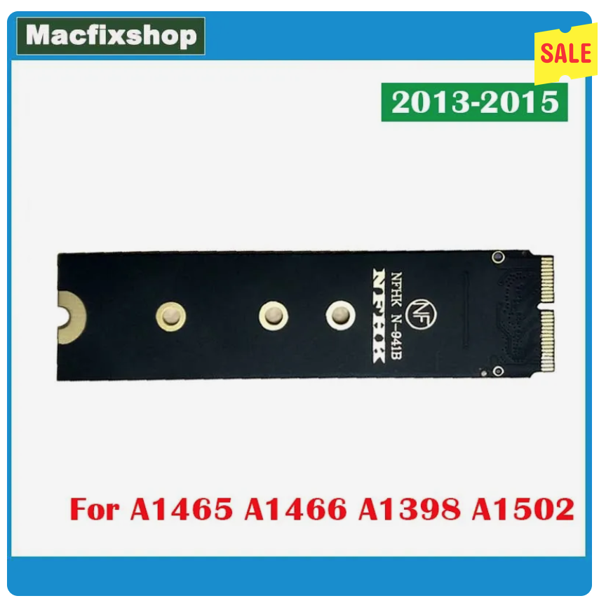

This one: NFHK N-941B
It is difficult to buy Sintech in Russia, even from China. I ordered another, shorter adapter with similar markings: NFHK N-941A, hopefully it will provide enough space for proper SSD installation.
Well, that looks similar to my long adapter. That's what I have in the 2015MBP. The short one like i said is what i used in the 2015MBA. I just now actually took that and the 2TB drive out of the MBA and put the 512gb Apple SSD back into it and loaded Linux Mint 22.2 on it.. that's what i'm typing on now. Good luck.. Hope the short one works better.

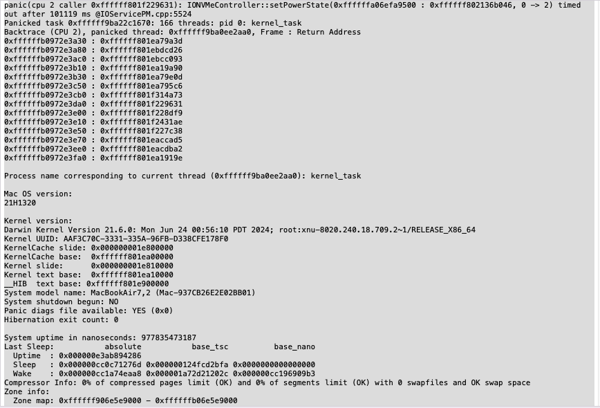

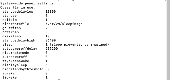

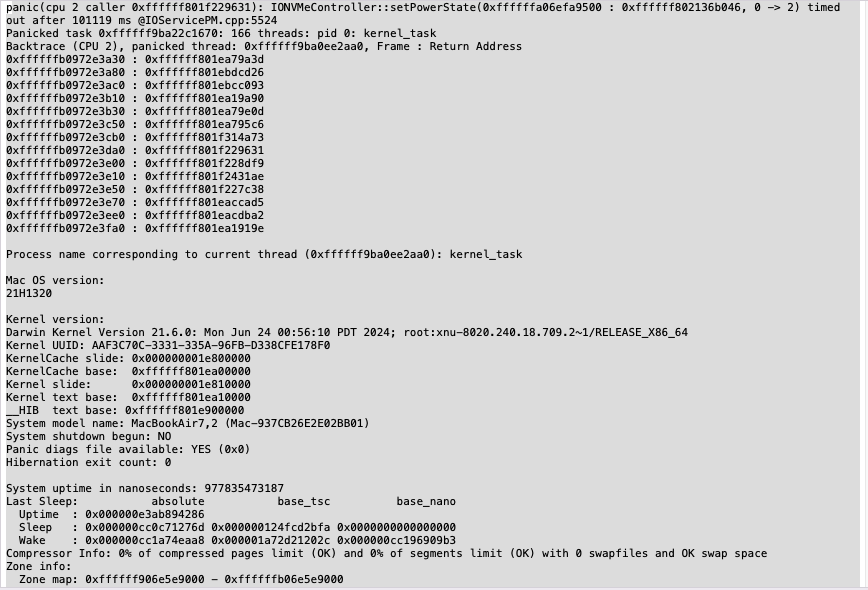

Just upgrade my Mac book air (2017) to 2tb using MSI SPATIUM M461 it works fine but have a problem when sleep/wake,it will kernel crash,i tried the pmset command but it`s not working,really appriciate if anyone can help me solve this problem thank you!View attachment 2432263View attachment 2432264
