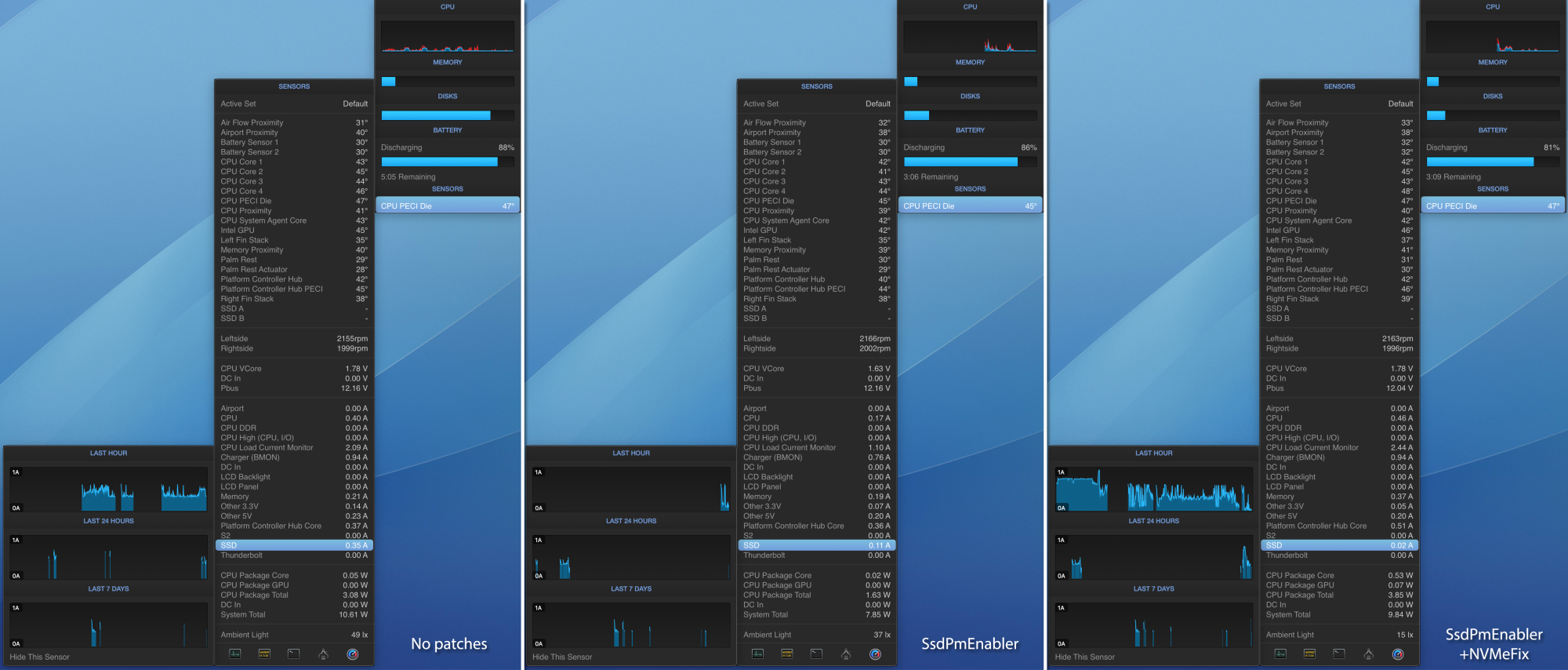

Reporting in with my results after a successful SSD upgrade.
MacBook: MacBookPro11,4, A1398 mid-2015 15" Retina with 2.2GHz i7 4770HQ (integrated graphics only)
BootROM: 489.0.0.0.0
Adaptor: "Zerone SSD to NVME Adapter Converter Hard Disk Adaptor Card for 2013 2014 2015 Macbook Pro/Macbook Air"
SSD: Crucial P5 Plus 2TB CT2000P5PSSD5 (came with a hefty heatsink attached, which had to be removed and thermal paste cleared out)
SsdPmEnabler: v0.1.1
NVMeFix: 1.1.2
Install steps:
1. Updated to macOS 12 Monterey with original Apple SSD still inside MacBook.
2. Swapped out SSD with the Crucial P5 Plus.
3. Clean-installed macOS 10.14 Mojave via USB bootable installer.
Speed test with the Crucial SSD gave me 2.7GB/s write and 2.4GB/s read speeds:
I initially noticed that the battery was draining quickly so I tried installing some patches for better power management:
Without patches, it was idling at 0.35A current draw. With SsdPmEnabler, it went down to 0.11A (68.6% less than without patches). With both SsDPmEnabler and NVMeFix, it went down to 0.02A (94.3% less than without patches).
Haven't encountered any kernel panics or crashes so far, however I noticed that under the energy saving settings there is no longer a slider for computer sleep, only for screen-off. Hibernation mode appears to be set to mode 3.
Reactions: macpro_mid2014

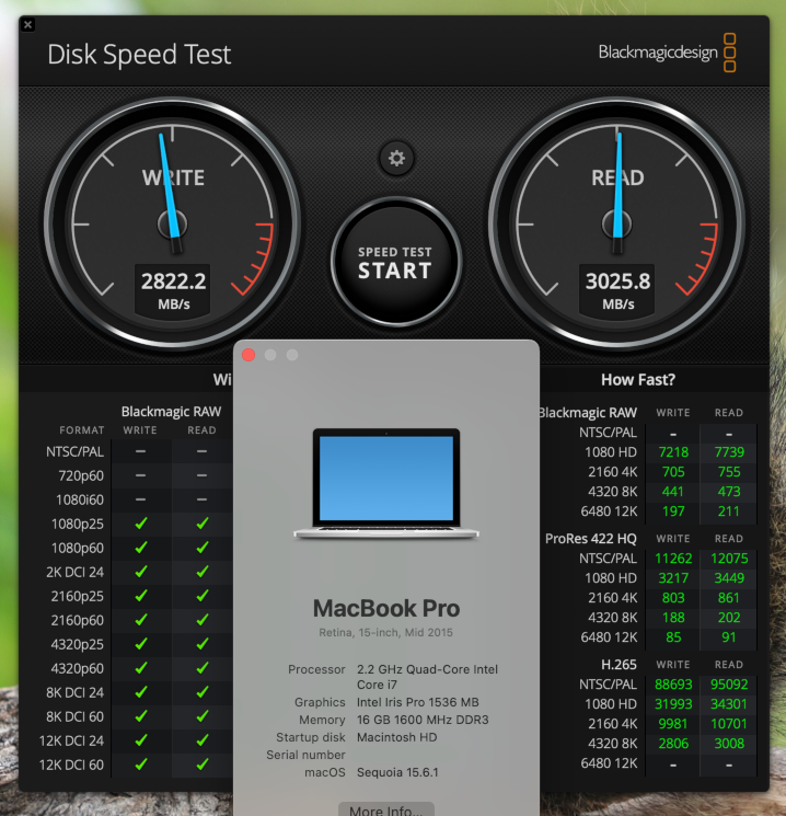

I upgraded my 2014 Macbook Pro a few months ago with a 2TB SK hynix P41. I had absolutely no problems and it's fast: 2800 write, 3000 read.
(I expected at those speeds to have decent bootup time in Sequoia, but it's still about 4 times slower than booting up Mavericks - with around 700 read/write!)
Edit: it's actually a 2015 Macbook Pro. (who knew? ;))
Reactions: darwinboxselector
Really? I never had a 2015 MBP so I didn't know. All I know is it is nearly 3 times the speed of the one I replaced.
How did you mesure those speeds? Did you use Blackmagic Disk Speed Test or AmorphousDiskMark to measure?
Due to hardware limitations, the 2014 MBP tops to around half of the speeds you reported.
Could you post a screenshot showing the results of any of the two apps above and the exact model of your MBP (like MacBookPro11,X where X is 1,2,3 or 4.)?

Well, I'll be a son of a....
Somewhere along the line, I seem to have gone mental - and mistakenly started thinking that I got a used mid-2014 Macbook Pro when actually I had a mid-2015. (must have gotten confused with the model number 11.4 - my previous new 2013 Macbook Pro being model number 11.3)
Here's the screenshot anyway:
