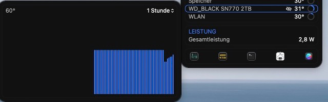

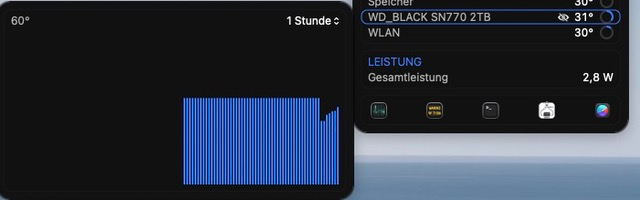

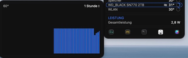

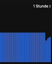

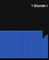

This is normal for at least from Dez. 24 and the Temp view of the External was the initial reason for me to buy iStat.
If you Switch Language it will come back most of the time.
I have informed the iStat Team 16.12.2024 and it has not been better since.
This is part of the second E-Mail i have send them in Dez24:
(btw. my 4TB WD SN850X does the same and i have now sendet an aditional E-Mail to the iStat Support Team)
In the attached Pic you can see that the Enclosure with the WD_SN770 2TB is listed with the old Temp and was not conected, after connecting the actual Temp was not shown, after i changed Lang from EN to DE the Sensor did show the Low Temp as visible.
After Disconecting the Temp is further shown as last measured.
