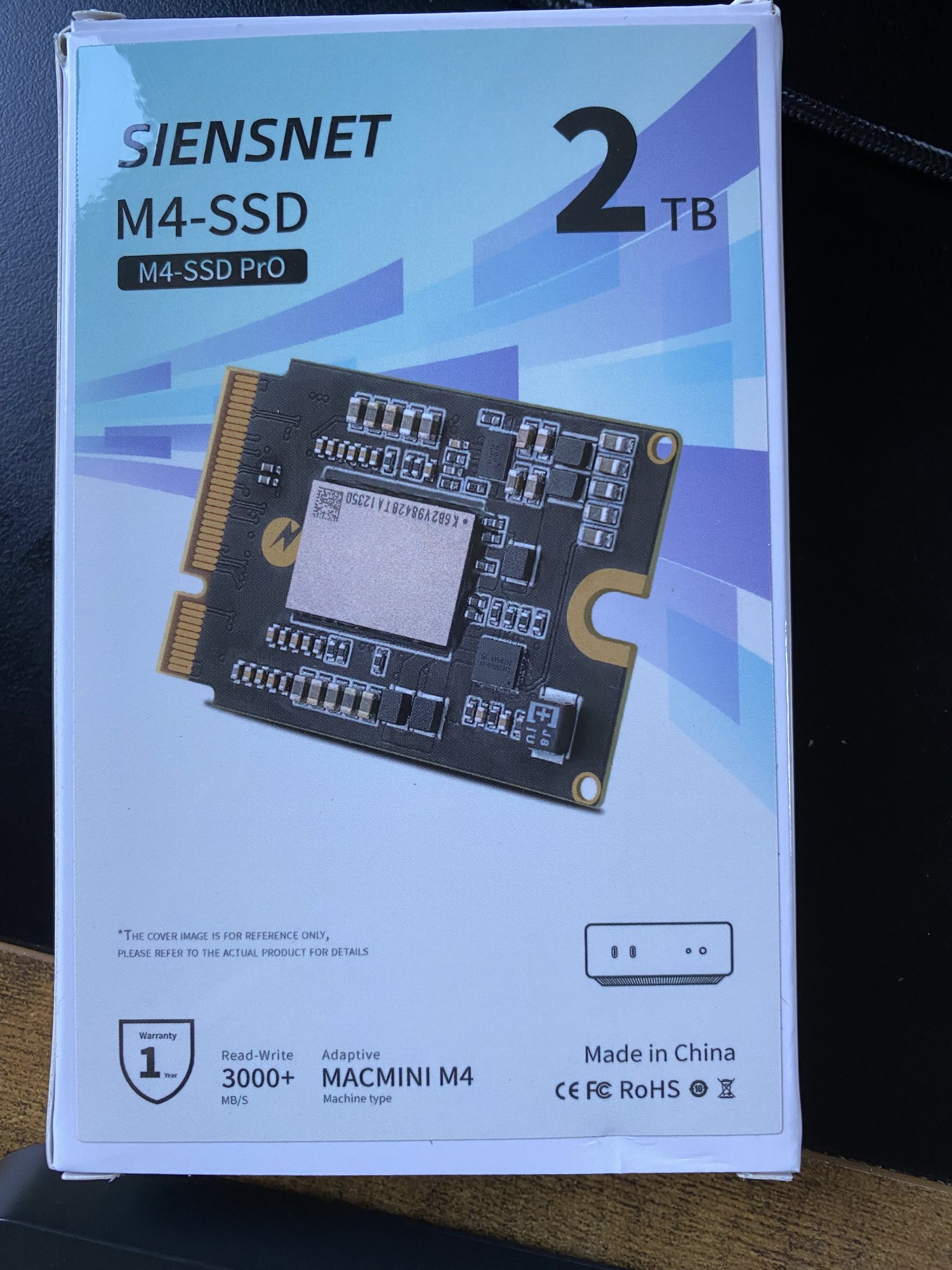

I orderd a Mac Mini and the 2TB NVME/SSD directly via Amazon from a Seller called Siensnet.
I´ll see how it will work out, the description was good so i hope the Best.
"SIENSNET hard disks are made by major manufacturers with surface mount technology, using brand new particles for better quality, stability and durability."

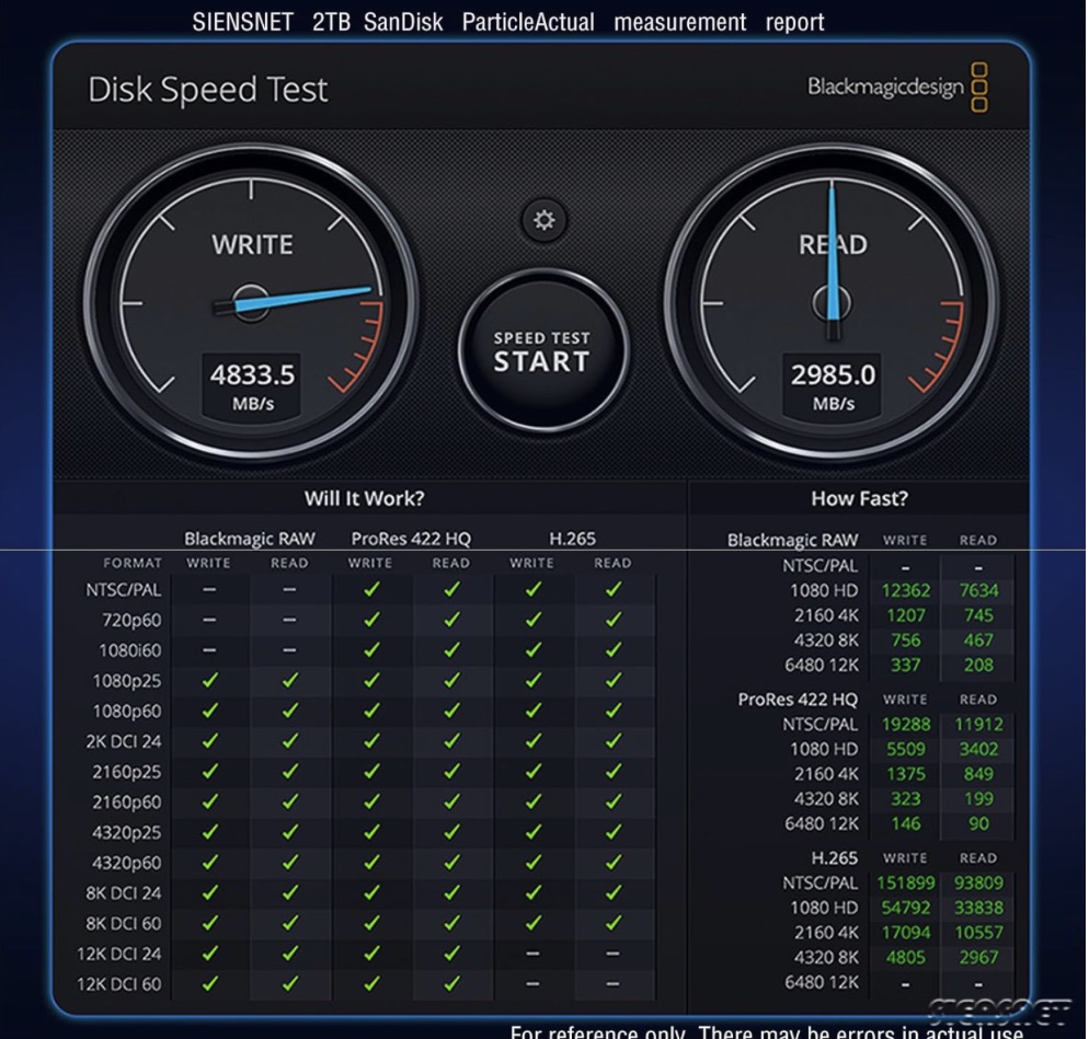

I could also finance via Amazon/Barclay here in Germany and guess it will be the SanDisk version (Image Text of SpeedTest suggest this but was not mentioned in the Ad Text).
for 250€ it was a bargain and has a 1 Year Warranty as well.
Images are from Amazon - Siensnet:

Yes... not new ? The same as AliExpress so I tried it, also because the description leads to the assumption that the NVME was not soldered at home... 😎

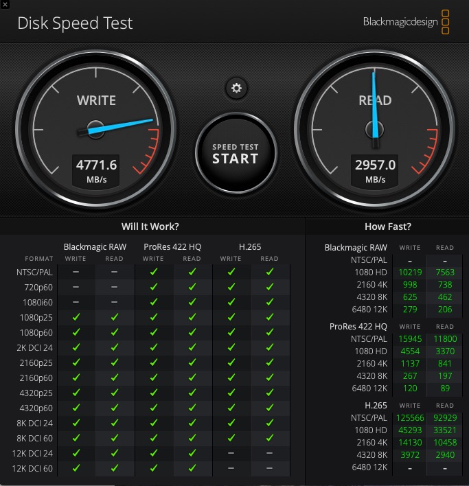

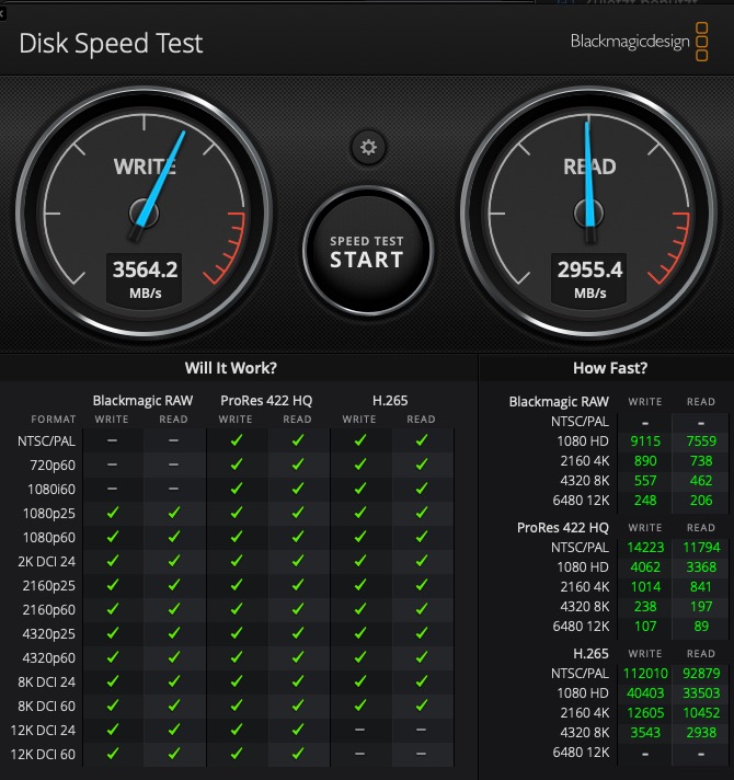

So...
the internal 2TB SSD/NVME for the Mac Mini M4 that I ordered via Amazon from Siensnet makes an excellent impression.
Ultra fast shipping, ordered on Saturday and delivered the following Friday from China to Germany Cologne.
Looks perfectly processed and thanks to the excellent toolset and the flawless immediate function, I had the installation and migration from the previous external 4TB Acasis TBU405Air done in just under an hour (approx. 750GB migration, now I can pack more on it 🙂.
Time will tell how reliable it is but it just works and I had 0 problems.
And it is fast, i noticed the change immediately and this is now also faster than the MBA M2.
I do not care about the BlackMagic Test but i´ll do it later because there are still mds processes running...
This is while 30% CPU usage + MacOS running the first installment routine Scans on the SSD:

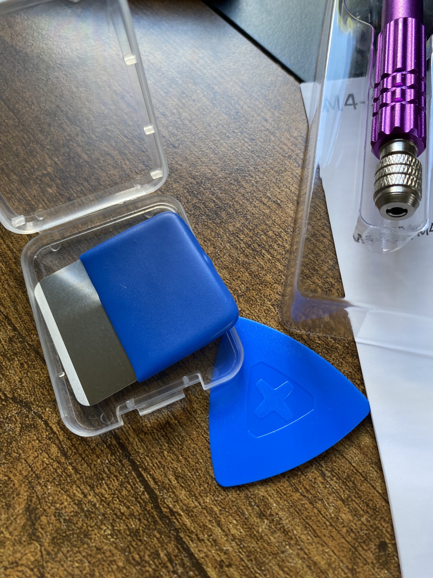

Attached are a few photos of the packaging etc.
Also the extra thin metal tool was really necessary and the set is really well thought out in every detail.
Thanks Siensnet, good job so far.

I did my m4 mini upgrade from 512 to 2TB on Monday. Used the JCID version purchased on aliexpress.
Everything went flawless, and I now have writes of 4500, and reads of 3000 MB/s.
Hardware install took about 10 minutes; FW, software, and restore from backup took about 30-40 minutes.
