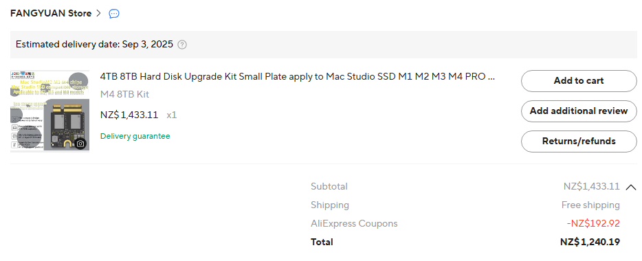

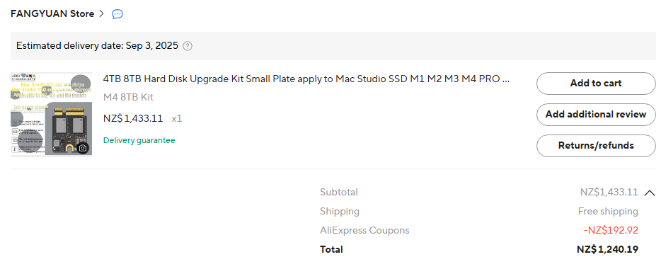

AliExpress prices have gone up. When i purchased, they were having a winter sale so i got further $200 off
I could try, and eventually, I'll find a workaround to get a new Mac and perform the restore.
I've looked on AliExpress, but the prices are the same. Do you have a link?
I just looked at the price now and it has shot up alot from what i Paid. I bought from this seller in the link below.

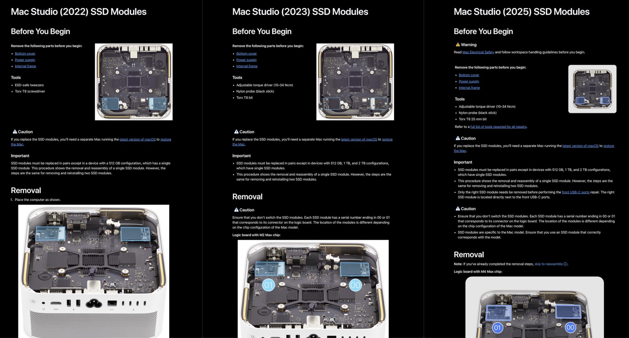

Over in the Apple self-repair guide for the Mac Studios, I captured the bits that detail the number of cards:
To summerize:
M1:
1 card: 512GB
2 cards: 1TB / 2TB / 4TB / 8TB
M2:
1 card: 512GB / 1TB / 2TB
2 cards: 4TB / 8TB
M4/3:
2 cards: 4TB / 8TB / 16TB
So yeah I was slightly wrong, the M1 gen split was between 512GB and 1TB, only then in M2 the split moved to between 2 and 4TB.

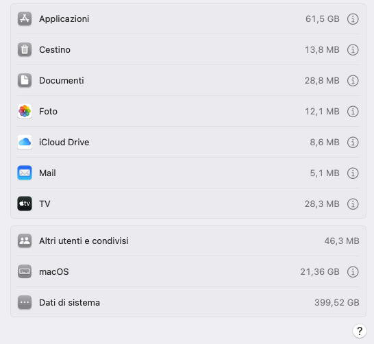

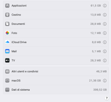

I am getting confused, perhaps also because I need to translate this into Italian. On the M1 Max, is the difference between upgrading from 512GB to a single 1TB card very different from upgrading to two 4TB or 8TB cards? If the difference is minimal, I might be able to overlook it. My main problem is with program installations. I mainly use the Adobe suite, which takes up a lot of space, and I often have to uninstall one program to use another.
2TB will get you around 6GB/s and the 4TB / 8TB options will get you 7.4GB/s on the M1 Max until you run out of SLC (cache) with very large file transfers.
Then you will be getting 1.5GB/s on the 2TB (when running out of SLC) and 3.2GB/s on the 4TB / 8TB options.
You can install applications to external SSDs to mitigate this problem on desktop computers like the Mac Studio. It supports USB4 (40Gb/s) so you can expect around 3.2-3.4GB/s depending on SSD (and if the NVMe SSD is at least double channel PCIe v3).
Reactions: JedNZ and TheStork
Thank you so much, 2 TB would be enough for me. Yes, I often have large files, but if I can save money, I can also wait a little longer 😂. The external drive idea is interesting, I could actually try that! In any case, I did a little more research and saw that a lot of space is taken up by system data.
