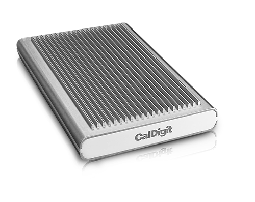

Caldigit has just released a portable USB 3.1 enclosure using Gen 2 USB C interface running at 10gbps. bus powered too:
CalDigit Tuff drive

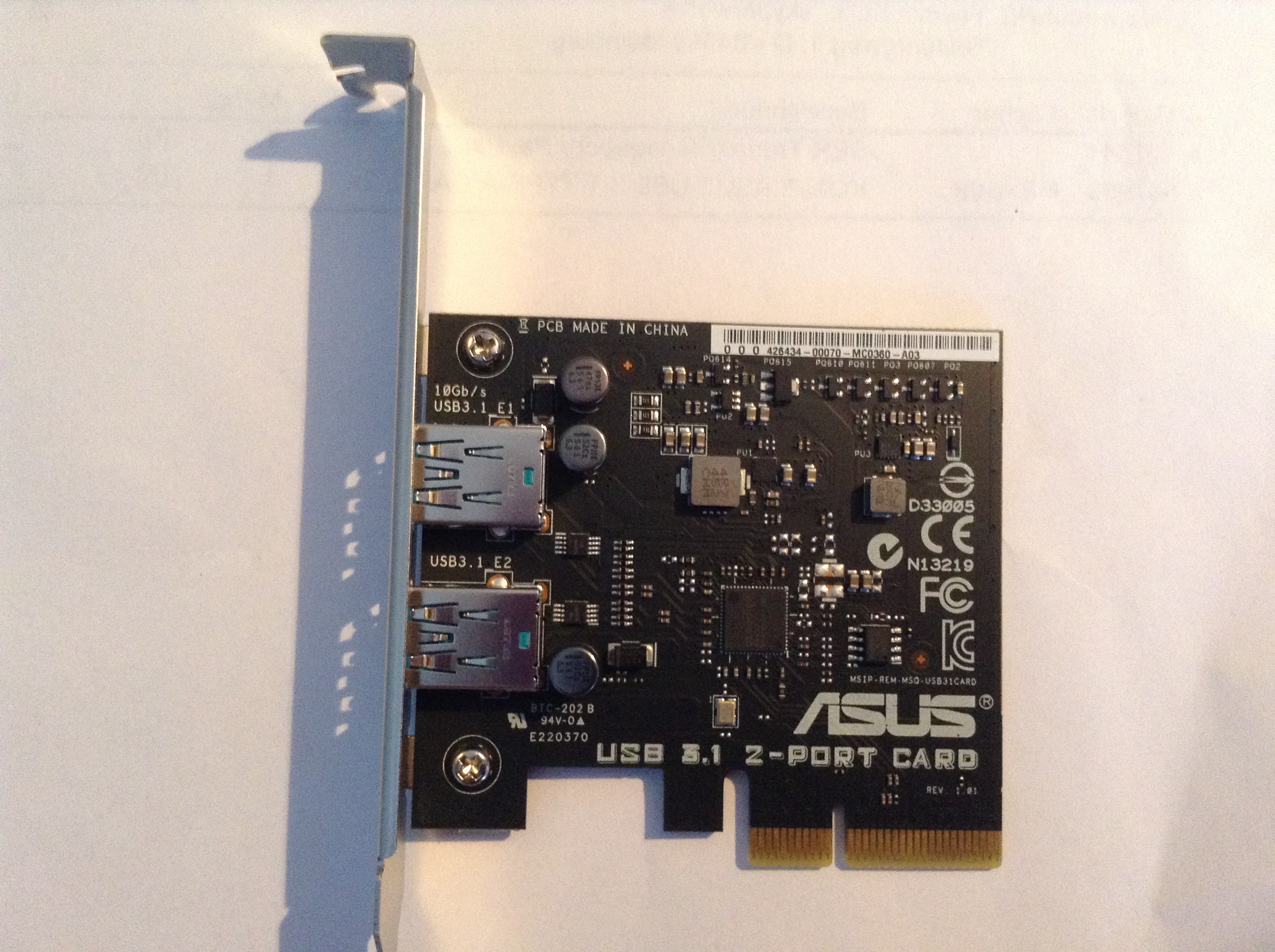

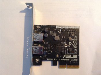

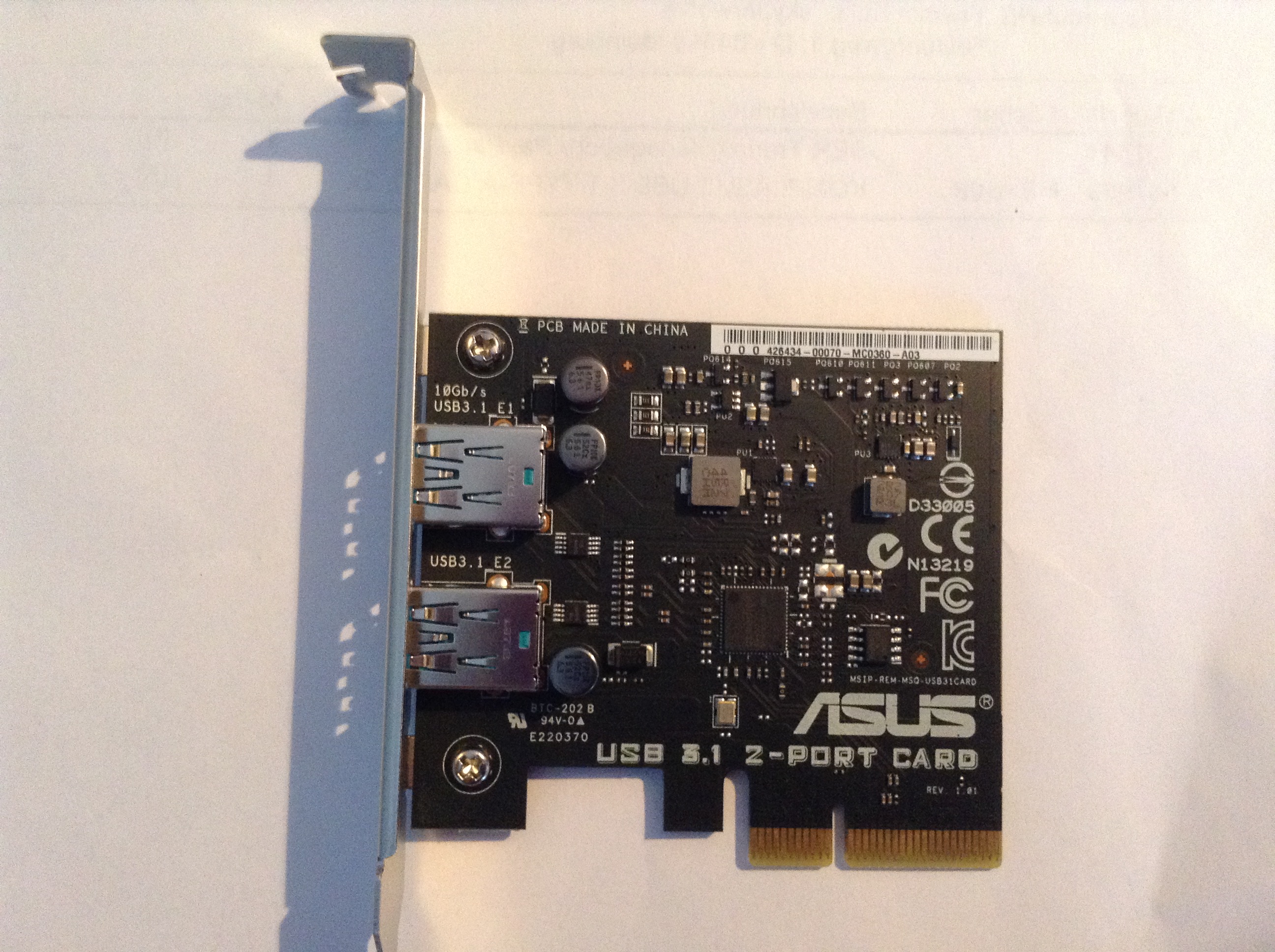

I just received my ASUS USB 3.1 TYPE-A Card (controller chip on the card is an ASMedia ASM1142). it even works in OS X Mavericks 10.9.5 out of the box. it's recognized as a USB 3.0 hostadapter (2 PCIe lanes @ 5.0 GT/s). I don't have any USB 3.1 peripherals to check wether it works at speeds above the 3.0 standard...
http://www.asus.com/Motherboards/USB_31_TYPEA_CARD/
I can confirm this claim. I just bought the same card and added it to my Mac Pro 4.1 (flashed to 5.1). Placed it in the 4th PCIE slot and it shows as 5GT link. Works in both Windows & and OSX Mavericks WITHOUT any additional driver installation.

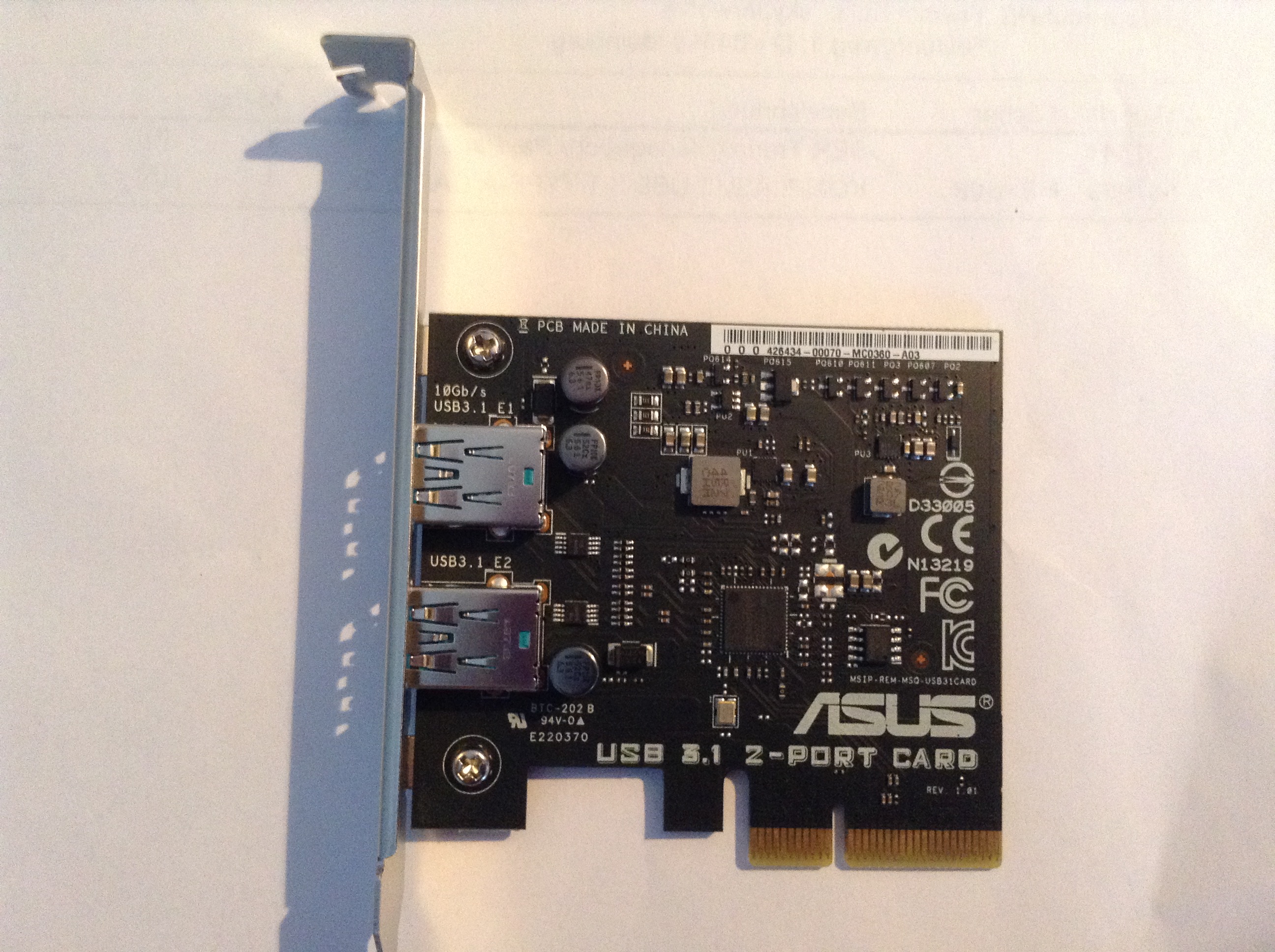

Hello I am confirming the Asus USB 3.1 card works in Mac Pro 4/5.1 with following caveats.
This card appears as a USB 3.0 device in Yosemite and also Windows 8.1 Bootcamp. Installing the Asmedia driver in Windows makes it appear as an Asmedia XHCI 1.1 Controller. I have a spare XP941 blade and will test it as an external drive when my NGFF to USB 3.1 adapter arrives.
When I first booted Yosemite the only device I plugged into the card was my Apple keyboard. When I unplugged it the keyboard my computer shut down and automatically rebooted. I'm not going to repeat that in case it damages something.
CalDigit Tuff drive
That's cool - but isn't it limited to SATA 3.0? That's about 500MB/sec. if you put in an SSD. I don't see a point in this and you can probably save money and get a USB 3.0 enclosure instead.

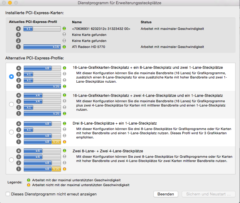

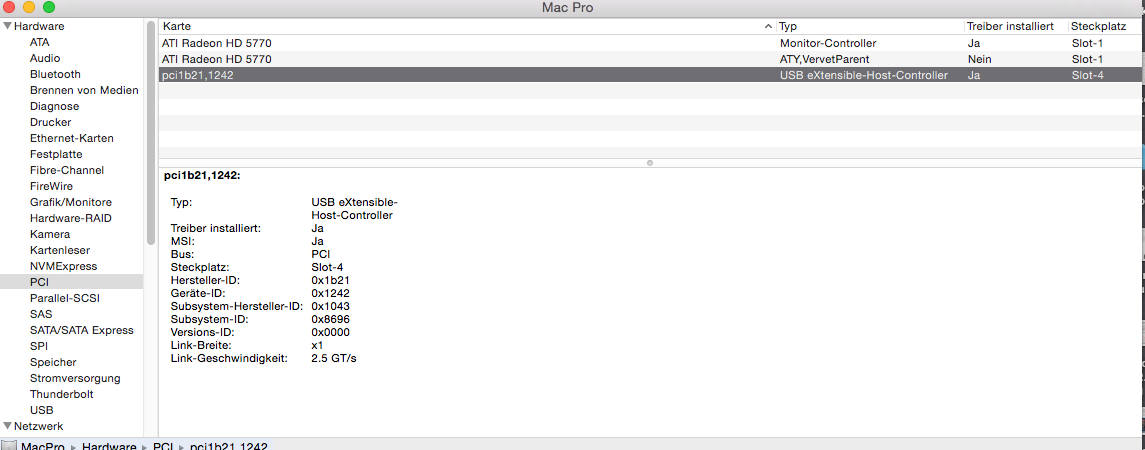

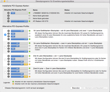

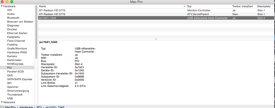

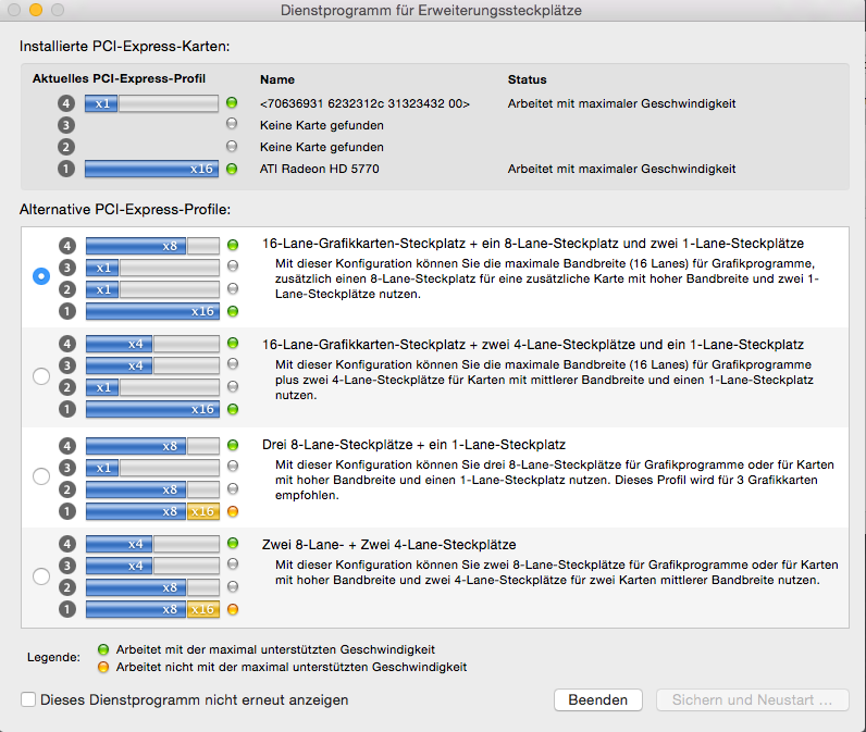

Hi guys,
I've finally bought the ASUS USB 3.1 USB card (the one with the A type connector).
Don't have (yet) any 3.1 device, only a 3.0 hub and a 128GB flash disk.
No need for a driver under Yosemite 10.10.4.
I've put it in slot 4 in my MacPro 1.1.
The only thing is, the "Expansion Slot Utility" shows the card running at x1 speed.
But slot 4 is configured for x8 an the card support x4.
So, it should run at x4.
Does one knows how-to configure or what should I do?

View attachment 567856 View attachment 567857 View attachment 567859 View attachment 567860
There is no XHCI 1.1 support in OSX yet so no need to try to bench it.
The card is physically x4 lane. It operates at x2 lanes electrically. If it can't negotiate the correct link it will operate at X1 lane. This is an issue with different devices that dont understand Mac EFI.
If it doesn't negotiate in any other of your slots that means you will need to wait to see if a Mac solutions provider offers. For your Mac that has PCIE 1.1 you need a electrically x4 lane card otherwise you will never see USB 3.1 speed
Thx for the reply.
I thought, XHCI is already with USB3.0.
Anyway, I will try at least another slot for x4.
At the moment, I don't need 3.1, 3.0 is ok as far as I don't the devices, and no need for drivers.
