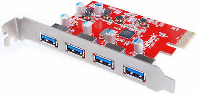

today i received this https://www.ebay.co.uk/itm/NEW-Inateck-4-Ports-3-0-PCI-E-to-Interface-USB-3-0-Expansion-Card-for-Mac-Pro/143371755947?ssPageName=STRK:MEBIDX:IT&_trksid=p2057872.m2749.l2649 usb expansion card but it does not work , maybe the problem is that i have to use extra power but i am not willing to do this , is there something else i can do ? My mac pro see's the card but when i put on a sd card reader nothing is appeared at the desktop and no power light from the sd card adapter light's on
Some cards are okay without their external power connector hooked up, generally for self-powered devices, but this is "iffy" and many/most cards are not. Also, it looks like your card uses the VIA chipset. I've not seen anyone mention VIA chipset compatibility, and I suspect that Apple's MacOS drivers don't support it. I just searched the thread and found nothing.
So I speculate that you have two problems: (A) you've not connected power to the card's molex connector, and (B) it's not compatible with MacOS.
The safe bet is to return your card and get one of the recommended ones in the first post where someone has verified it works. This is what I recommend. Using a card with a chipset that's used by Apple in their Macs ensures current and future support in MacOS.
If you really want to push through with your existing card, which I do not recommend, then you can give the GenericUSBXHCI drivers a try. I think they support VIA chipset. If true, this solves problem B, but not well. Like all third party KEXTs, this driver may have problems with newer versions of Mac OS. Also you still have problem A, so you either have to hope for the best that the card doesn't need power, or you have to apply power.

the card is suposed to be compatible with my mac pro as the seller told me ...
i downloaded one of the files attached i opened th xhcdump , right?
1.
Throw it away. Why do you think they put a MOLEX power socket on the card ?

This is an excellent Inateck USB 3.0 SATA powered card. I have one.

it looks like the connector cable inside the unit is diesigned to fit into some kind of usb motherboard header socket which the mac pro doesn't have.
Wait a second doesn't the pcie slot provide cards with 75watts? Even more if it needs it?
I've never plugged in extra power to my usb cards and all is peachy without. 3.1 cards at that.
Inateck makes a few different cards, and I can tell you from experience that not all of them work in a Mac Pro - for reasons @ActionableMango lays out above. I bought one that *seemed* like it would work, but it did not. The KT-4004 (at the time, the correct model) just plugged in and has worked well ever since. A close look at the Ebay add would seem to indicate that while the seller *wanted* this to appeal to a Mac Pro user, the description (See Feature 1) makes no mention of Mac Pro. No doubt the seller copied the information from some place else.
Return it and get the proper one.

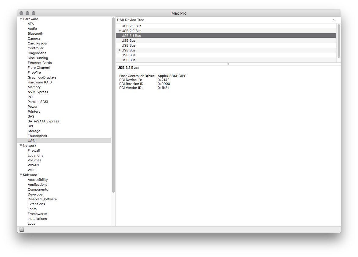

Hi, as I'm building a cMP to replace my 2010 MacBook Pro as my daily computer, this forum has helped a lot to find the right information.
EDIT: Mac Pro 5,1 Mid 2010, Boot ROM MP51.0089.B00 (for now)
For a USB 3.1 card I choose the StarTech PEXUSB312A2 (ASM2142 chipset), as it is USB 3.1 Gen 2, but cheaper than the Sonnet Allegro Pro USB 3.1. Here's my report so far, maybe it can be helpful for someone:

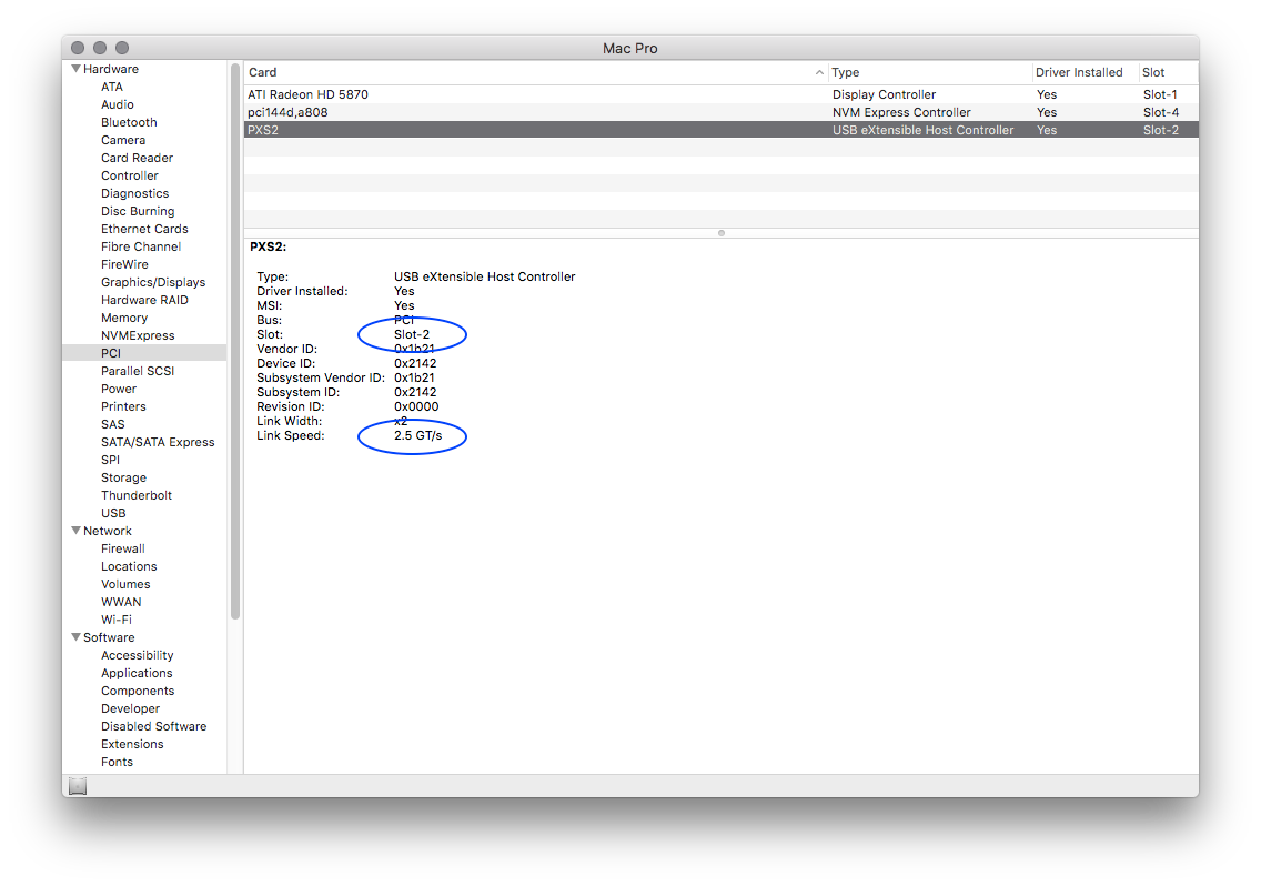

  • When installed in PCIe slot 3 System Information states 5.0 GT/s
  • When installed in PCIe slot 2 System Information states 2.5 GT/s

Is this normal behaviour? Those lanes/speeds/switches/busses get me confused. I'm on High Sierra, while waiting for a Metal card. After upgrading to Mojave (and the latest firmware), will anything change?

Which Mac Pro do you have? I guess it must be MacPro4,1 orMacPro5,1 because slot 3 gives you 5.0 GT/s. Slot 2 in any cMP 3,1 or later should allow PCIe 2.0 in slot 2.
You say you don't have the latest firmware for the MacPro5,1 that came with Mojave?
The latest firmware should make PCIe 3.0 cards run at PCIe 2.0 speed at boot. You can use the fast.sh script to change the speed from PCIe 1.0 to PCIe 2.0. Use the pcitree.sh script to verify the speed change. #482
You can use the scripts to benchmark slower speeds in faster slots to see what you gain. There are ways to add PCIe 3.0 slots to your cMP (very expensive).
You don't get all the benefits of the ASM2142 with the PEXUSB312A2 in a cMP because you are limited to PCIe 2.0 x2 (8 Gb/s) instead of PCIe 3.0 x2 (15.75 Gb/s). The best USB 3.1 gen 2 card in a cMP is one with a PCIe 3.0 x4 switch and ASM2142/ASM3142 or a Thunderbolt 3 add-in card.
The PCIe 2.0 x4 switch in the Sonnet Allegro Pro USB 3.1 allows the two ASM1142 controllers on the card to be used but each ASM1142 is limited to PCIe 2.0 x2 (8 Gb/s). A switch has an added benefit in the MacPro3,1 (and maybe earlier) because it allows converting the PCIe 2.0 x2 of the ASM1142 to the PCIe 1.0 x4 of slot 3 and slot 4. Otherwise the ASM1142 would be limited to PCIe 1.0 x1 speed (4 Gbps) because those slots don't support x2 (only x1 and x4).
My ( spare card ) Sapphire 7970 Dual-X twice showed up running at 2.5GT/s x 8 Link width.
I shut down, removed the power cord, removed all PCIe cards - installed a spare HD 5870 - rebooted with the " TRIPLE Chime " NVME / PRAM reset.
Then shut down again and re-installed the Sapphire 7970 . .
. . . . Voila ! back to 5.0GT/s & x 16 Link Width :p
The above apparently ( in my case ) ' re-set ' the PCIe slots.
NOTE :
I recommend installing PCIe USB cards in only PCIe slots 3 & 4.
My USB3.1 is in slot 4 5.0GT/s Link width 2 no problems at all.

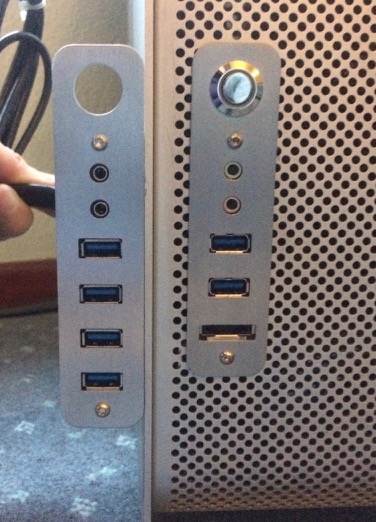

...is there anyone on this forum or elsewhere that sells modified front panel pcb's?
Check out Laser Hive's replacement front panel. It was designed for hackintosh case mods but you might be able to use it. Unfortunately, it does away with the Front Panel Firewire ports. I don't know if FW is important to you. (I rarely use the Front Panel USB or FW ports.)
Thank you for pointing to this modification TheStork, but I want to keep the case stock (and I really like the tactile quality of the original power button). But I guess this discussion belongs in this thread.
So my question remains: what USB 3.1 (10 GBit/s) PCIe x4 card has an internal connection?
