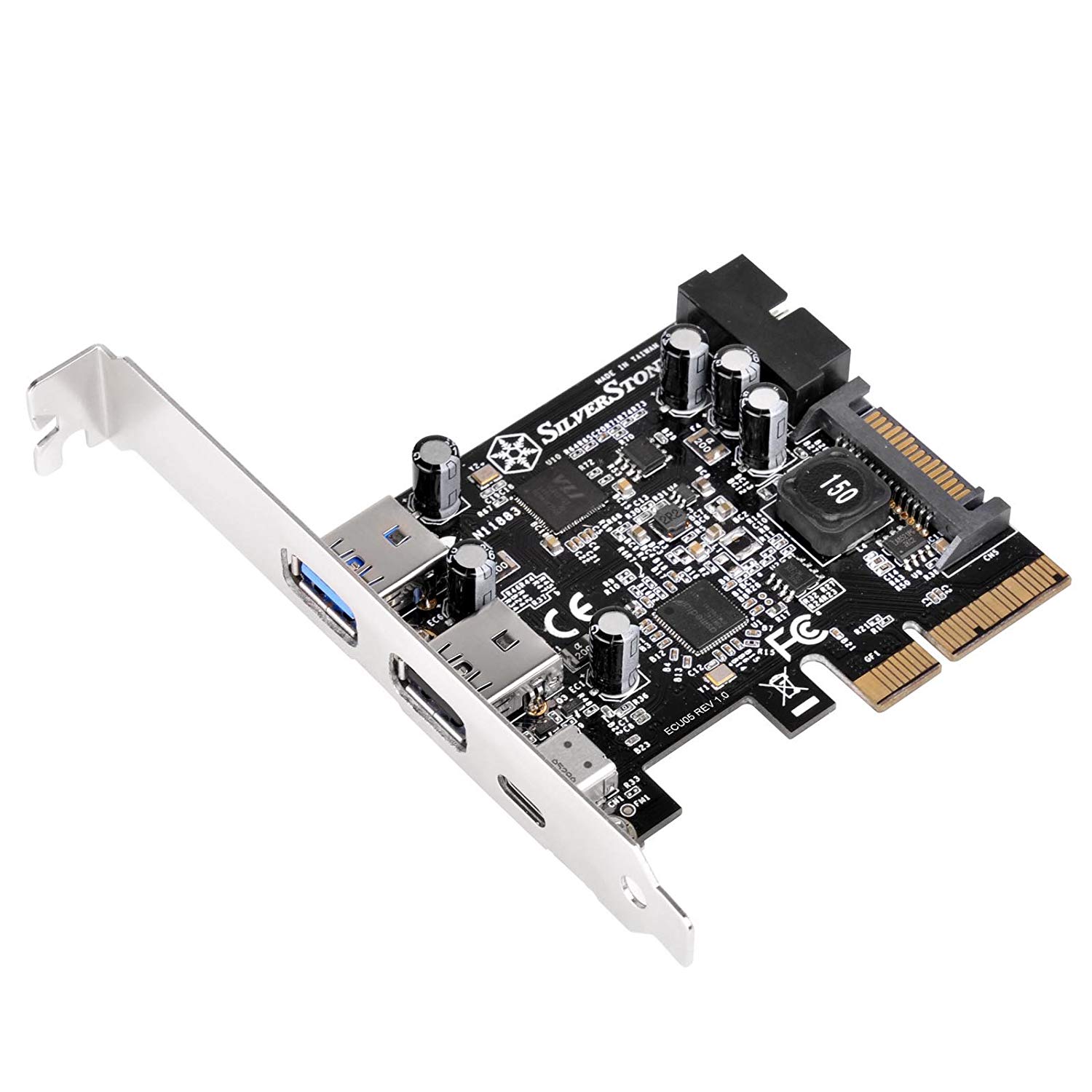

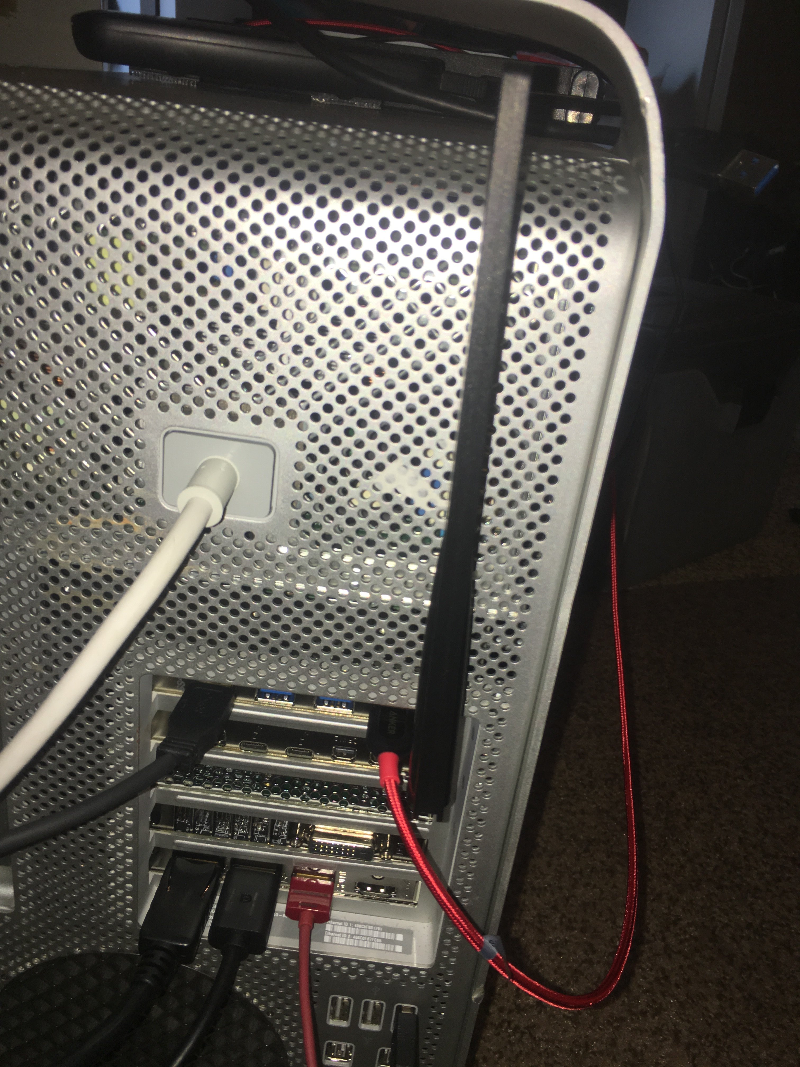

'SilverStone Technology Silverstone USB 3.1 and 3.0 PCIe Card with External Type C and Internal 19 Pin Connector Model ECU05'

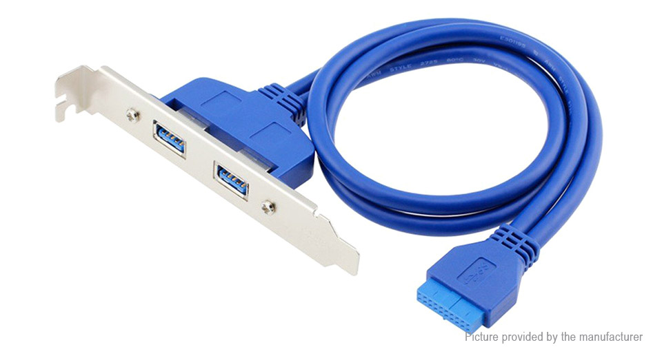

Highly recommend it. I've also expanded it with a usb 3.0 header to a pcie plate for 2 extra ports. Does not need external sata power from what i can tell..but then again i've never maxed out all 5 ports at the same time.

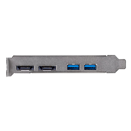

THEN i bought another plate to replace the last one to include 2 eSATA ports from the 2 spare SATA ports from the dvd-drive bays.
That is a PCIe 2.0 x2 ASM1142 based USB card. It only has one USB 3.1 gen 2 port limited to 8 Gbps because of PCIe 2.0 x2 so it can't do more than approximately 765 MB/s. The other four USB ports are provided by a VIA Lab VL812 hub (USB 3.0 four port hub) so they are limited to approximately 400 MB/s.

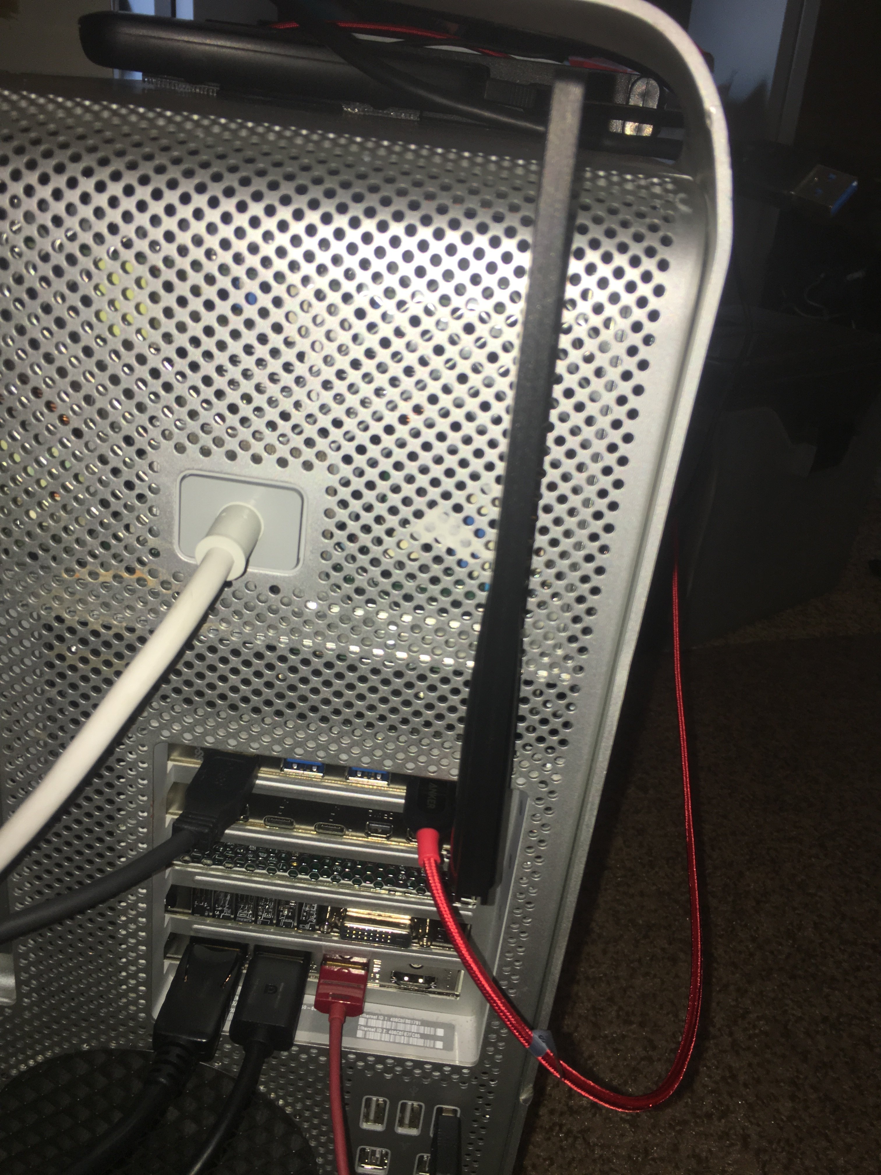

Can I put a PCI card USB 3.0 safely in slot 2 of my PowerMac 5,1? (PCI-E x16)
It's a card that was installed in a PCI-E x4 slot 3 of my previous Mac.
It's a card that was installed in a PCI-E x4 slot 3 of my previous Mac.[/QUOTE
The only card I have that fits neatly above the RX580 is an Inatek K4004 USB 3.0 card. Its small and has almost nothing on the underside to possibly interfere with the RX580's fans.
I had a Sonnet USB card in Slot 2 and the RX580 fans hit it.
Are slots 3 & 4 being used? It seems like a waste to use a 4x usb 3 card in a 16x slot.
If you're worried about any interference between the graphics card and slot 2 some people have used popsicle sticks to separate the cards. I personally used a folded up Sams Club card, wedged between the cards.

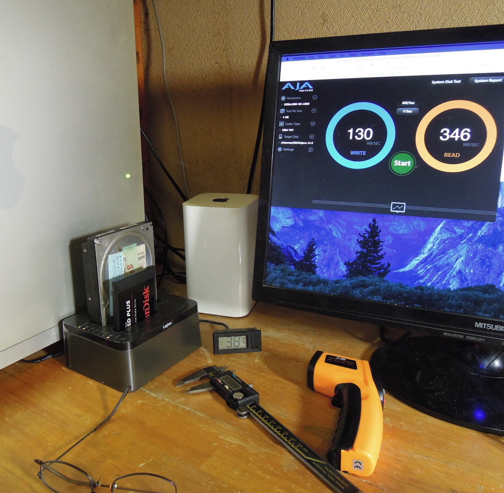

Today, here in Japan I bought a TWO bay 2,5" & 3,5" Logitec LGB-2BDPU3ES USAP USB 3,1 external dock for ¥3,400 ( US$ 23). I'm not sure that this dock is available outside of Japan.
I haven't opened the dock case yet but I assume it has an ASMEDIA chip. I'll edit this post after I check it.
As the pic shows, it's not exactly fast but I like that it has two bays as I'm very busy consolidating a ton of files to various drives.

You can see the AJA speeds on the monitor in the photo it posted.
Slow but useful because of the two drive ports.

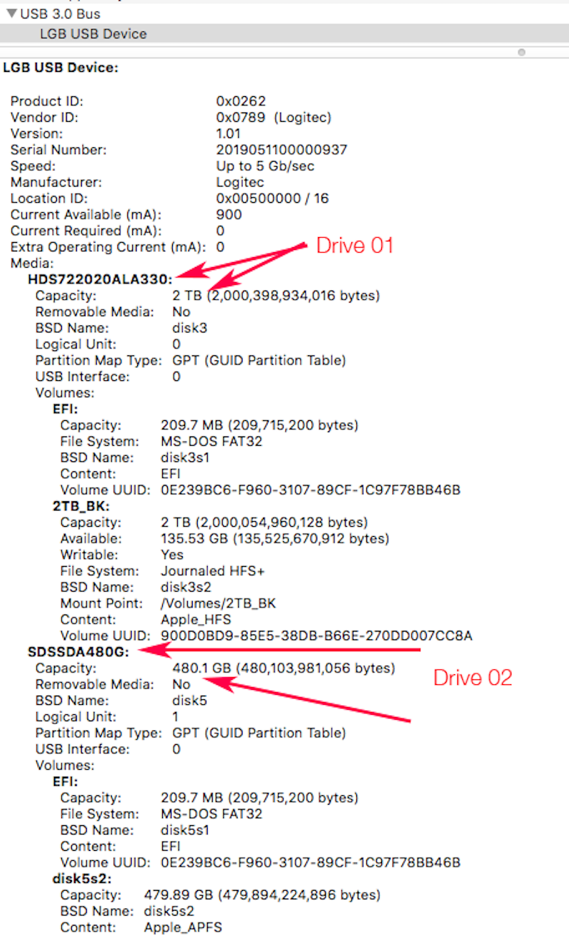

OK ! This Logitec LGB-2BDPU3ES USAP USB 3.1 ( 2 bay) Dock has an Asmedia 1156 !
I can't find info on the ASM1156. Post the system_profiler result so we can see if it's implemented as a hub (to support two drives).
That only shows one drive. Is there a second LGB USB Device? What hub or bus is it connected to? Show the entire chain starting from the USB bus, please.
I put the correct grab in just now.
Thanks. I didn't understand that USB allows for multiple media devices under a single USB device (no hub). I guess that makes sense since a USB device can have multiple functions/interfaces/endpoints. Without reading the USB spec, I don't know if multiple media is provided by multiple interfaces or a single mass storage device class interface. ioreg and USB Prober.app would probably make that clear.
