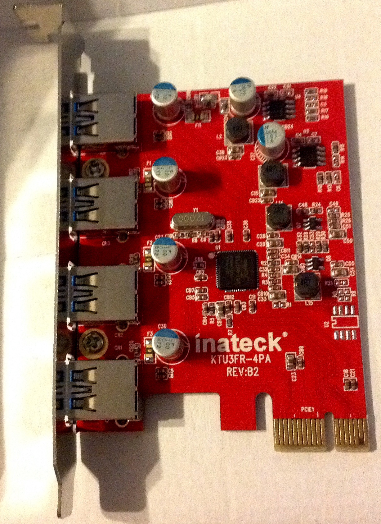

One of the comments in the feedback section for this card had the following info from Inateck customer support:
Posted on Jan 24, 2014 1:12:34 AM PST
The Inateck Team says:
Dear customer,
We are gladly to inform you the updated version of the Inateck USB 3.0 PCIE card for Mac Pro will soon be launched in 10 days.
No extra power cables will be needed since it can be powered through its own PCIE port which makes it a bit more stable.
Thank you once again for taking the time to share your insightful review.
Warm Regards,
The Inateck Team

I actually have the card in question. I'm still bound to bed due to recent surgery so I can't do a full review just yet.. It does not require additional power, nor are there any connectors for that purpose.
Here are a few pics of the product. Please excuse photo quality, they are taken in the bed with me from my iPad, and lighting is poor.
I tried to attach several pics, but only one seems to be allowed.
I think it's safe to say "rev B2 and later" don't require power then. Updating first post.
