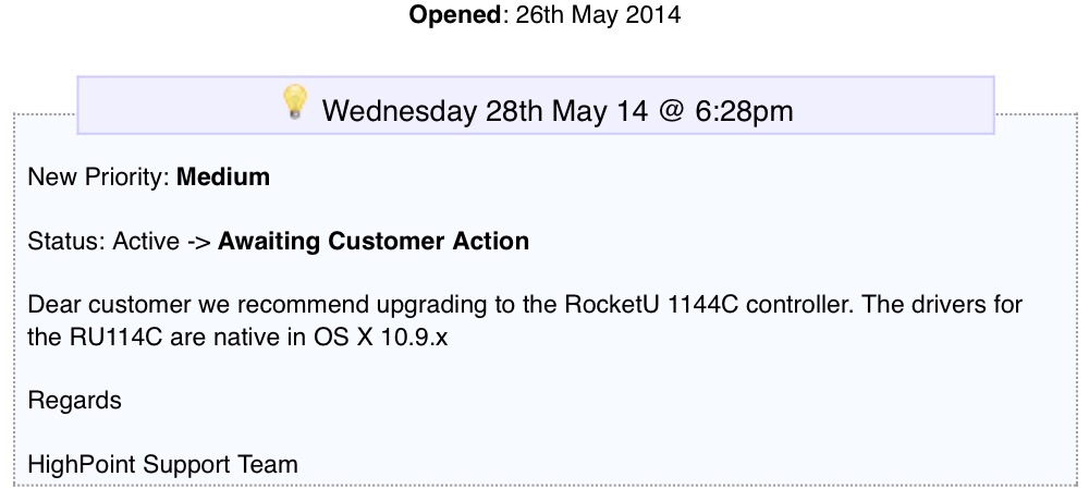

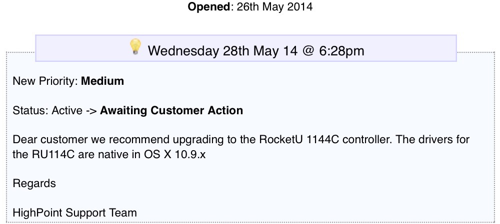

I just discovered that Mavericks doesn't seem to play well with ASMedia based USB 3.0 & 3.1 cards. both, the HighPoint RocketU 1144C and the ASUS USB 3.1 TYPE-A Card are totally unrealiable for me if used under OS X 10.9.5 Mavericks. at least writing data to a WD Elements Portable USB 3.0 harddrive doesn't work well. tried the same with OS X 10.10.3 Yosemite and everything was fine. went back to the Sonnet Allegro USB 3.0 PCIe 4-Port on my main machine (which still runs OS X Mavericks).
I'm sorry to hear that Mike. I used the 1144C with Mavericks and it was totally reliable with my WD drives. I don't have the "WD Elements" but I do have the the My Book and some WD drives in 3rd party enclosures. Strange that the issue goes away under Yosemite. HighPoint Tech. Support informed me that it is definitely supported in 10.9.
