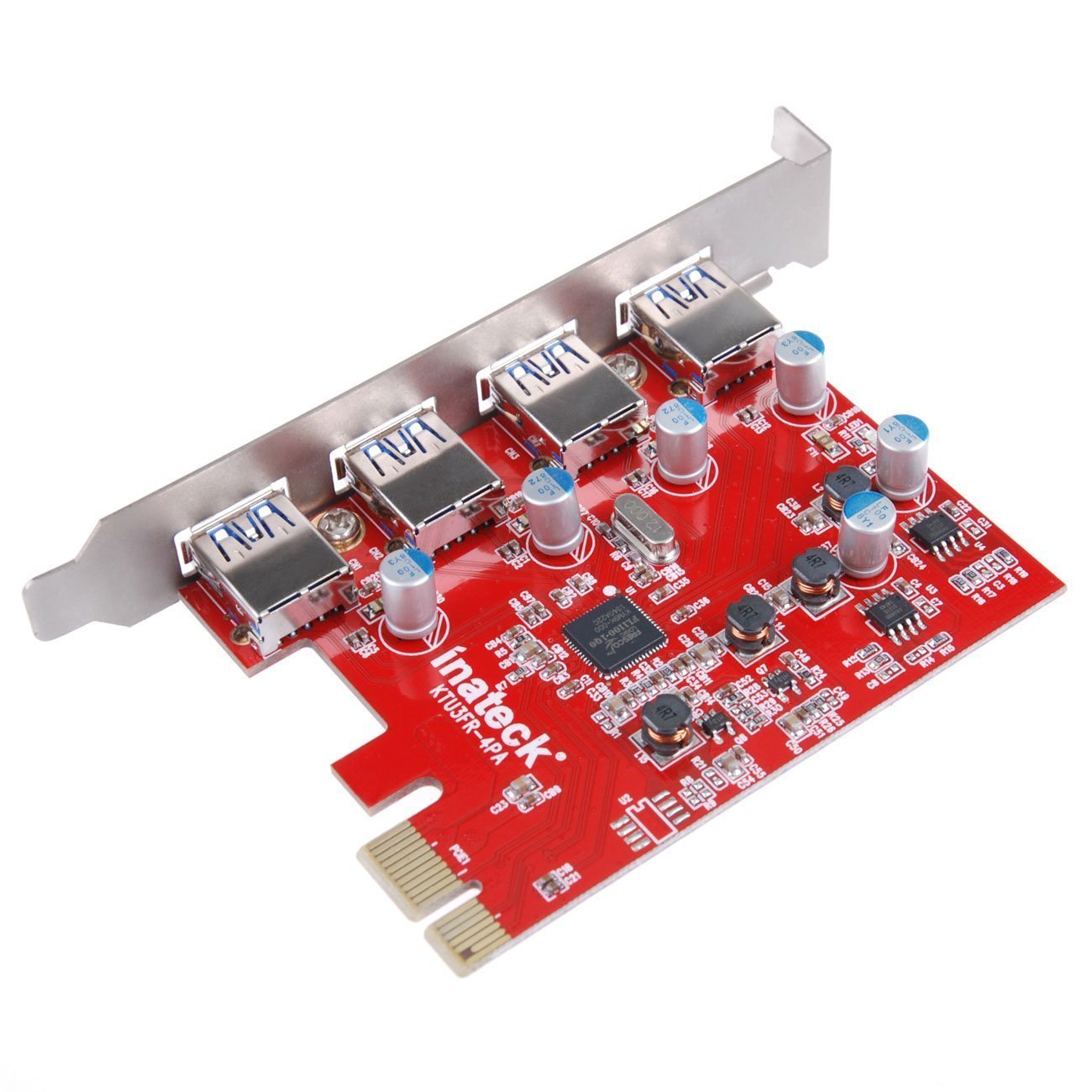

Well that is why I bought the card because i thought it was designed to work with the pro.
There are a few threads on the Inateck forums with the same info that the card won't work. Im not disputing that yours doesn't work, I can only go with the fact mine doesn't.
I bought the card from amazon looks just like this
http://www.amazon.co.uk/Ports-Inate...qid=1432302118&sr=8-1&keywords=inateck+kt4004
Im at work atm so will have to have a look at the revision when I get back.

Well, perhaps you simply got or choose the WRONG CARD!
I got 2 cards - one was for the MAC (which still works very well) and another one was the wrong one (did NOT work, because someone at Amazon packed the wrong one) which was exclusively for WINDOWS. Shurly, the latter does not work - sent it back and got the right one.
There are also nearly identical PCI-cards from Inatech for WINDOWS!
So - make shure you got the right PCI-card (the KT 4004 and NOT the wrong one)
http://www.amazon.de/gp/product/B00B6ZCNGM?*Version*=1&*entries*=0

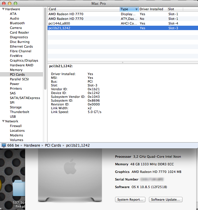

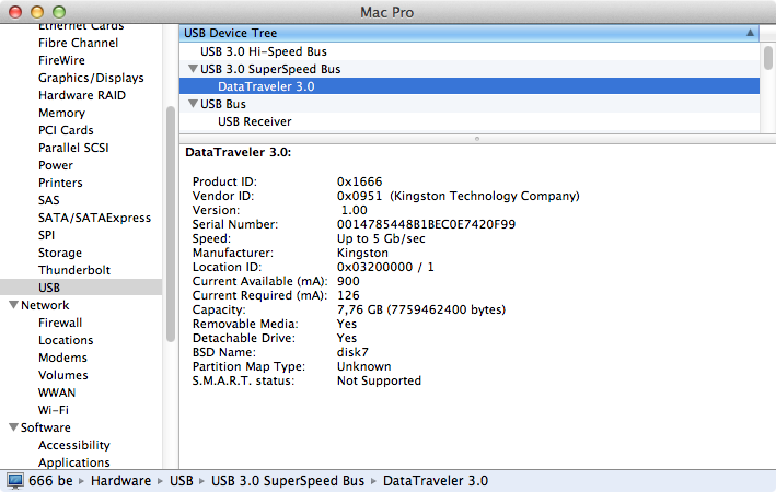

Mountain Lion support, are you sure? Is the chipset Asmedia ASM1142? Others are reporting no support except 10.10.3 and newer.
Yes, I am sure. And yes, it is Asmedia 1142 chipset, the only USB 3.1 chipset for now in the market.
Yeah, it does work indeed OOTB. See attachments.
