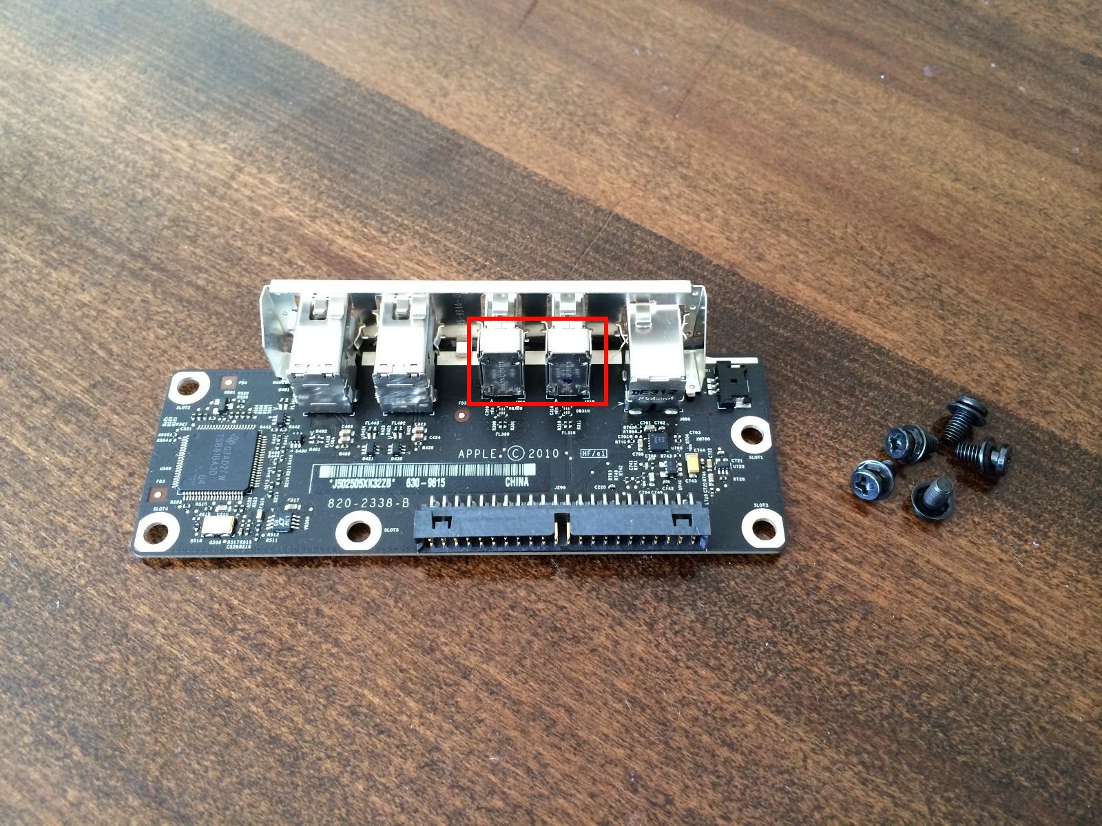

Is there any way to convert the front facing USB port into USB 3.0?
Yes, but it's a hardware modification.
The front facing USB 2.0 ports don't have all of the pins needed for USB 3.0, so you'd have to clip the two existing USB 2.0 ports off of the front PCB:
Then mount two USB 3.0 ports in the same physical space with something like this:
Or maybe those ports aren't spaced the same as the Mac Pro, in which case you might be better off with something like this:
Then run the cable from those ports to a Mac-compatible USB 3.0 card with an internal 20-pin header such as the Inatek KT-4006:
http://www.amazon.com/Cord-free-Inateck-Controller-Internal-Connector/dp/B00JFR2H64
I think most of this procedure would be quite easy. The only step I am uncertain about is how to mount the ports in a sturdy enough way to handle people inserting and removing a tight fitting USB plug.
There are also cables with 20-pin header and a single USB 3.0 port. You could replace just one port to have one each non-bootable USB 3.0 and bootable USB 2.0 at the front.
If you ever want to restore this to stock, just get a replacement front PCB part. If you don't mind used parts, they are pretty cheap on Ebay.

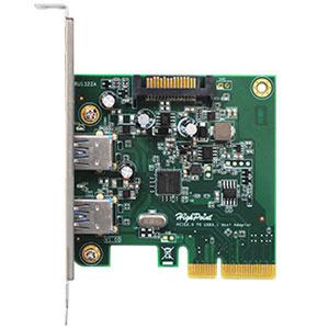

Installed El Cap GM1. Reinstalled ASUS 3.1 card. It's still a 3.0 card to OSX. No 3.1 drivers yet, but that's probably because Macs won't get it until Thundebolt 3 arrives with it.
The picture shows an Asmedia chip.
The manual says:
"For Mac OS X 10.9 or later version, the embedded USB driver is native support RocketU 1322A."
We need CRJackson to get on this. ;)
Have a look at post #20 here.
It is the ASMedia, it will work in 10.10 (don't remember if I tested it with 10.9, but I'm sure it will). It acts like a USB 3.0 not a 3.1 w/OS X so far. Sent it right back to them. I can't say what I'd like to... Read between the lines...
