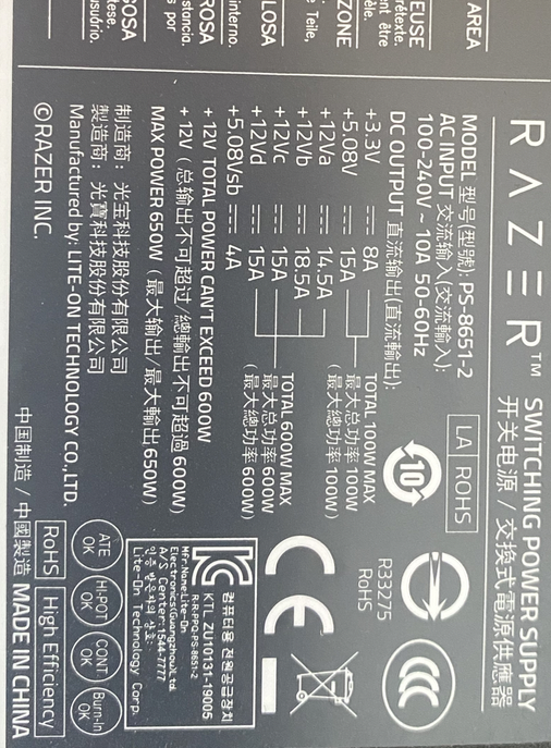

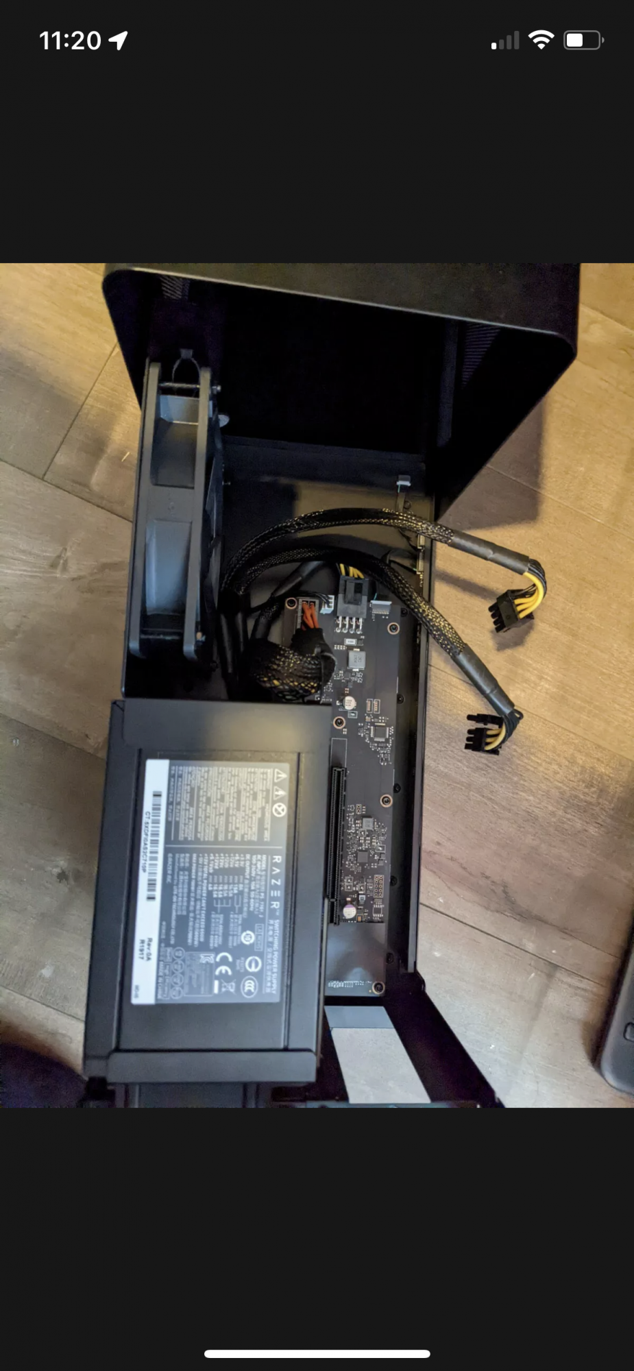

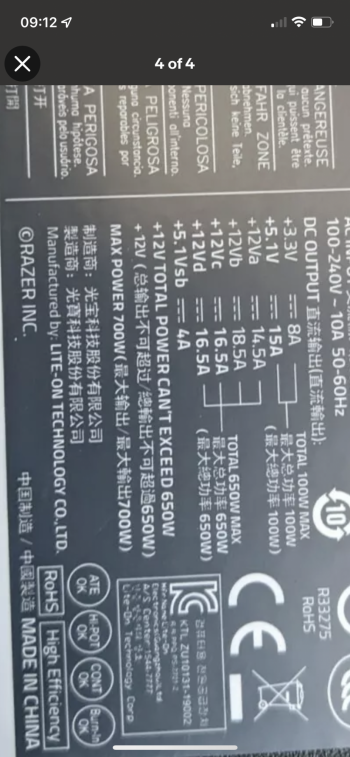

Razer Core V2 is/was 500W, but I haven't come by a Razer Core X anything else but a 650W PS yet. But maybe tsialex has better info on this. Core V2 is a little bit different design externally too, with lookalike handles like cMP.
Then there is a Razer Core X Chroma too, with 700W PS and 4xUSB + 1GB ethernet (this box is a dual controller design).
edit. opened up mine, for your peace of mind, please see pic.
And yours appears to be a Chroma version, with 700W power supply. At 200 canadian it is dirt cheap.
  • Love
Reactions: EvilMonk

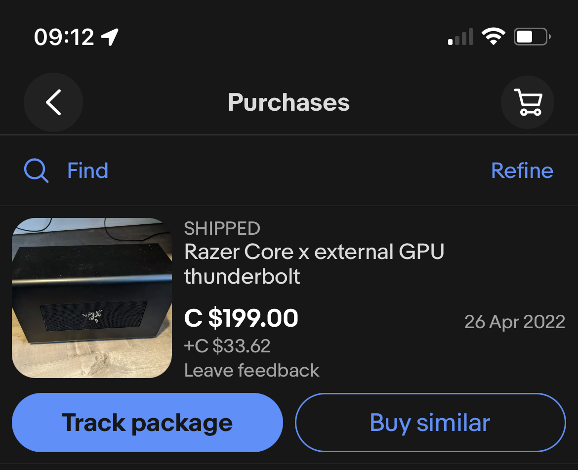

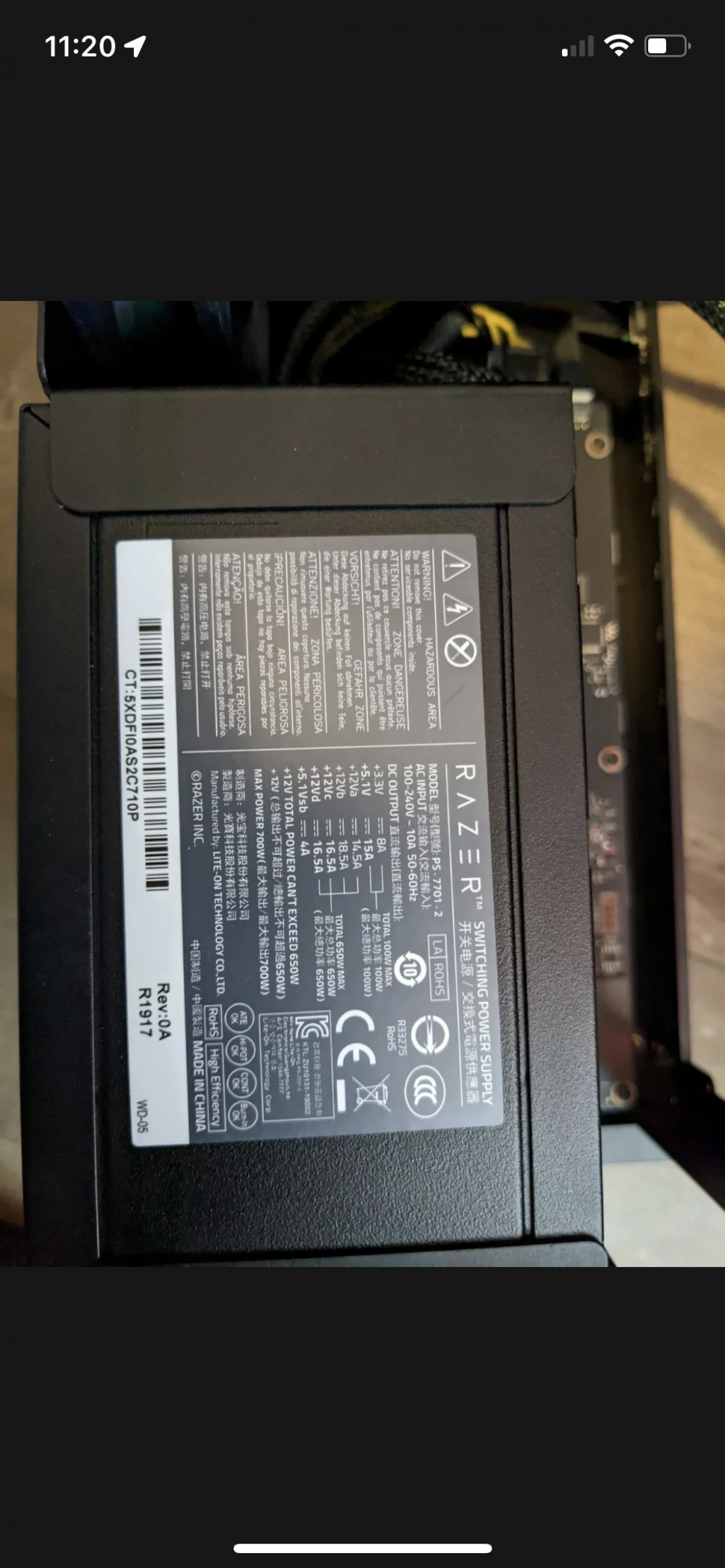

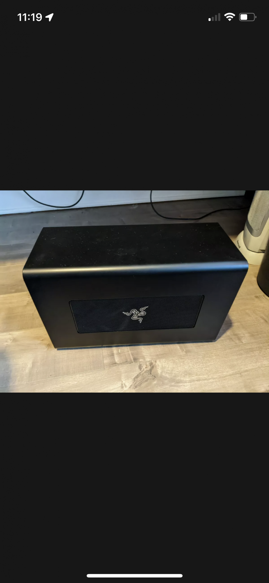

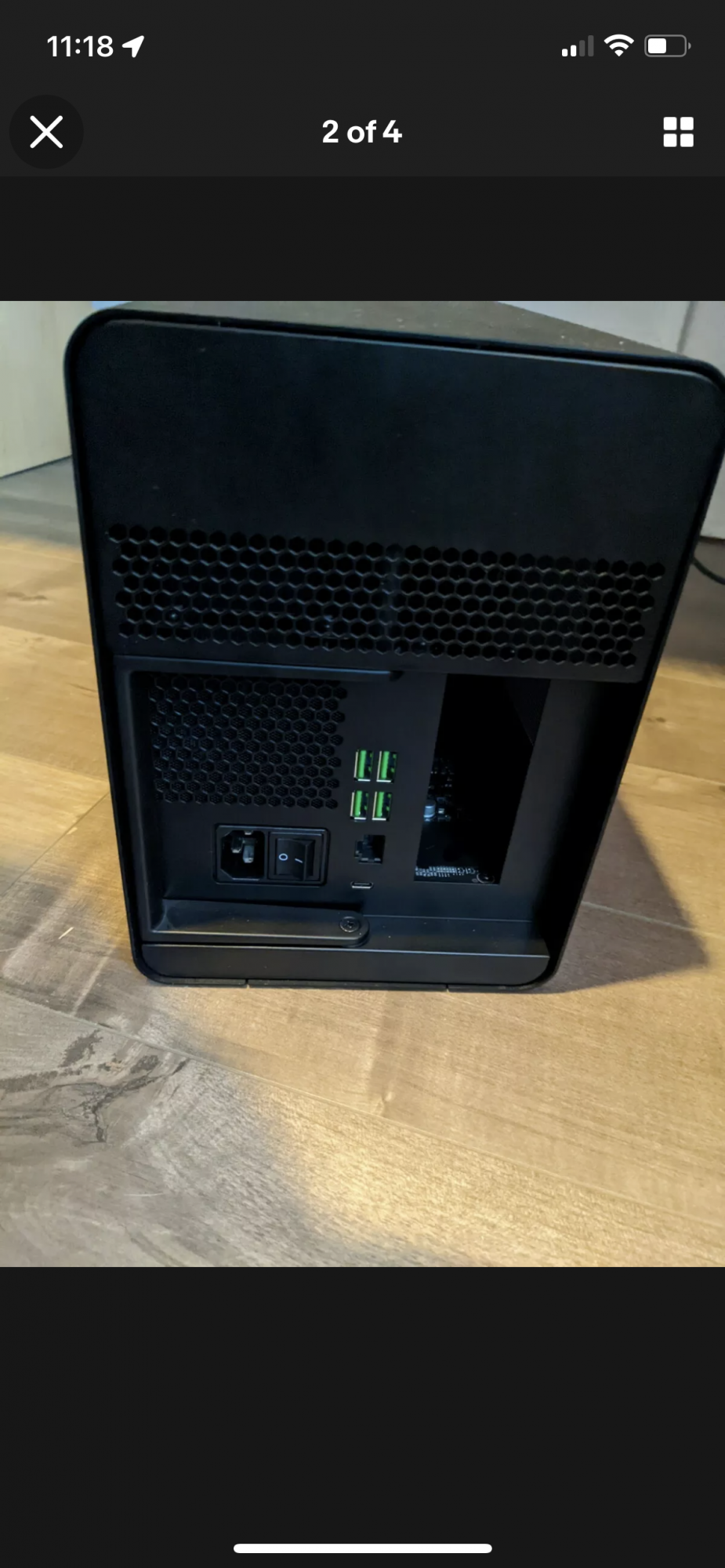

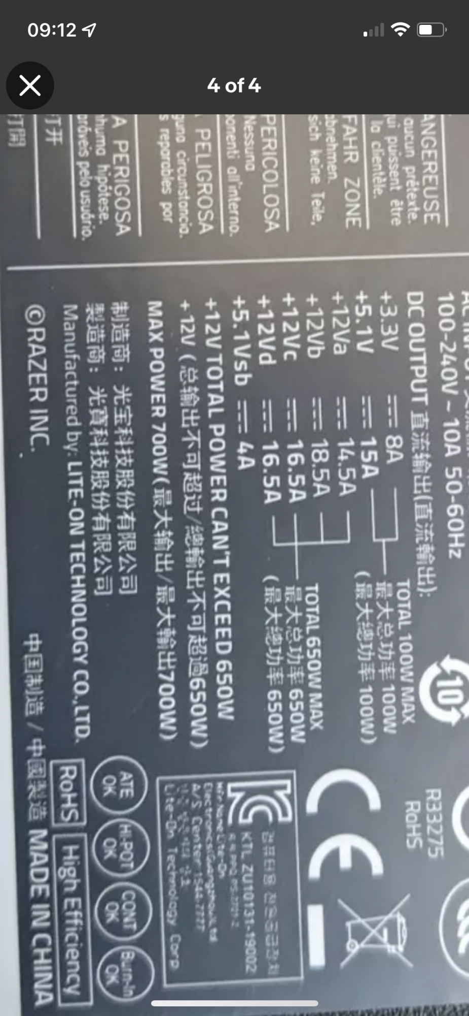

OMG that’s awesome I looked at the tracking and it’s supposed to be delivered Tuesday ? I had no idea it was the high end one I picked one from Canada to get it faster and skip the waiting on customs since it’s hell with COVID measures.
Just looked at the pictures of the one I got and I got a chroma without knowing it ?????‍♂️

So since it’s a Razer Core X Chroma does that means I can put any GPU in it without power restriction?
All the cards you listed above, yes, the Razor X Chroma will be able to power them.
