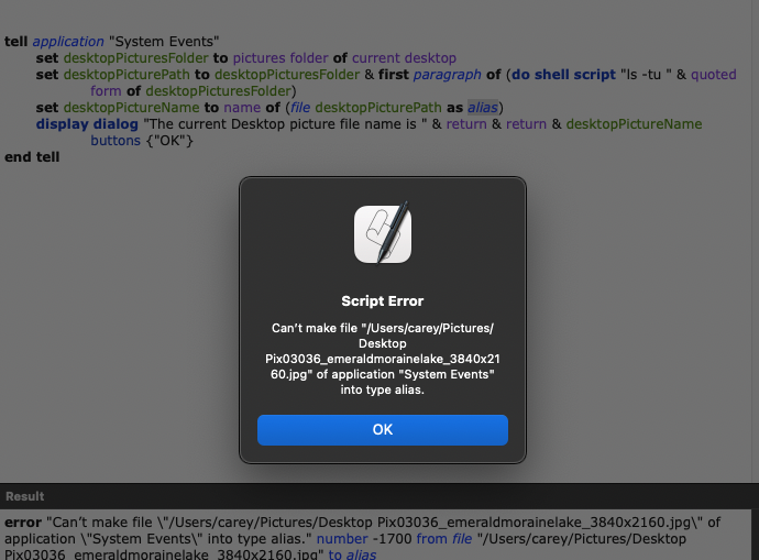

I'm getting an error for this on Big Sur:
error "Can’t make file \"Macintosh HD:Users:carey:pictures:Desktop Pix03036_emeraldmorainelake_3840x2160.jpg\" into type alias." number -1700 from file "Macintosh HD:Users:carey:pictures:Desktop Pix03036_emeraldmorainelake_3840x2160.jpg" to alias
I'll play around with it later, see if I can come at that from another angle. But FYI, the script I'm copying has a nifty output mechanism that I'll be using. It pops up a dialog to show you the answer and lets you copy the image name or open it.

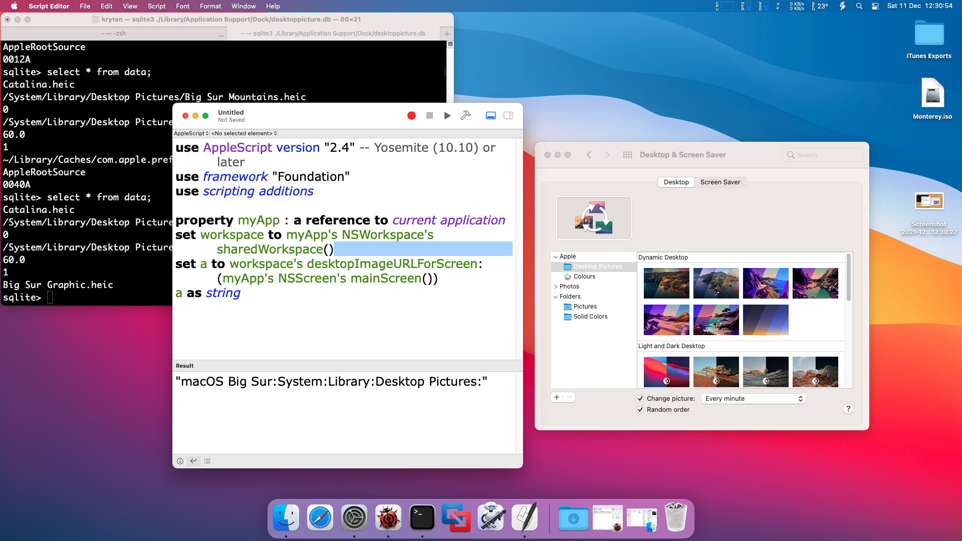

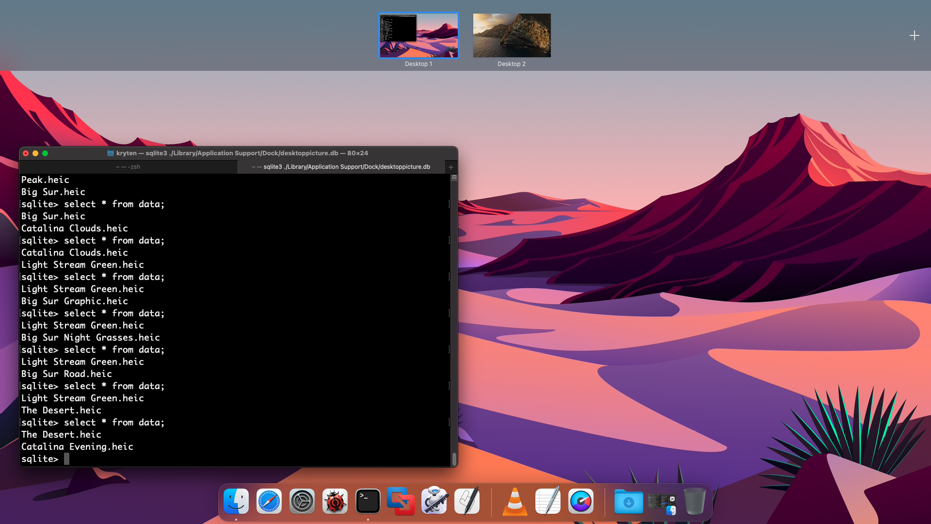

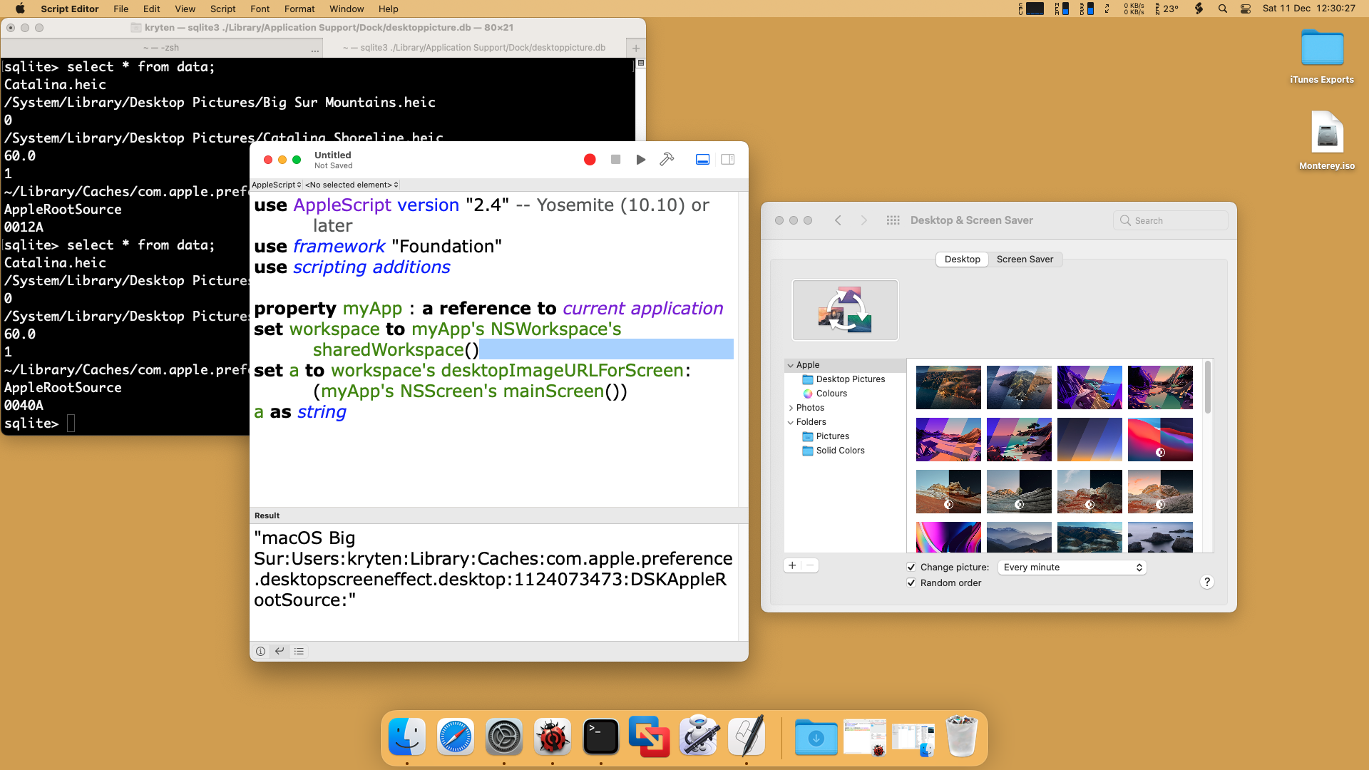

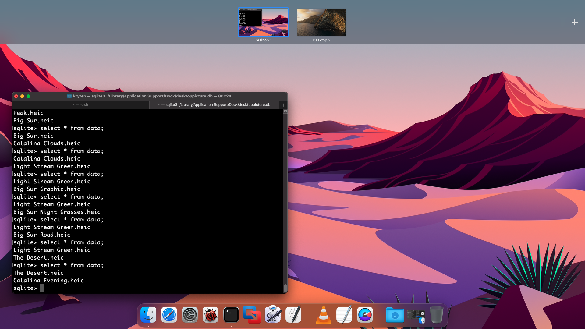

You can find some info in the desktoppicture.db file located in your Library --> Application Support --> Dock folder.
You can find some info in the desktoppicture.db file located in your Library --> Application Support --> Dock folder.View attachment 1925746

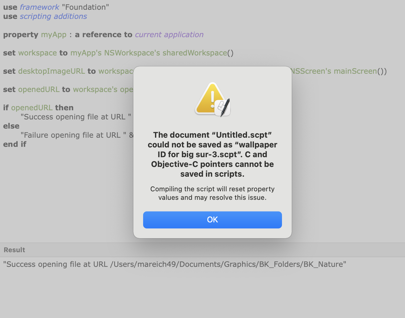

@Mark FX
That ASObjC script also works in Big Sur, although like in your original script the returned folder path does not include a trailing slash (oddly enough, coercing the URL to text instead does keep the trailing delimiter). The missing delimiter just needs to be inserted when adding more items to the path.

The script runs without errors on Big Sur, and Finder opens the correct folder, but the actual image is not opened. Nor identified as far as I can tell.
Also, when attempting to save this script, an error is generated:

Recompile and try to save the script again. A quick test with Mark FX's script produces some funky output on my end when randomly choosing a picture. Looking at mac-mike's result that also seems to point to a folder URL.
Trying to get the current desktop picture is weird, no matter what you do. Using System Events results in the default picture, not necessarily what is being shown. Using NSWorkspace, the desktopImageURLForScreen is actually the selection in the preference, so if you happen to be using random items from a folder, you just get the specified folder. Using the file access date is also problematic, since you can get the default picture even if it isn’t being used. Even the desktop debug menu gets it wrong, and that is provided by Apple.
The best approach seems to be to use the SQL database, but that doesn’t always seem to get it right, either - it doesn’t help that what is in there is pretty cryptic. It would appear there is a reason why there aren’t any ready solutions to be found out there.
The posted code is AppleScriptObjC code, and not plain vanilla AppleScript.
So you can't save it as a script with a ".scpt" file extension, you can only save it as an application or text.
When you go to the "Save" menu option, and the save dialog box appears, select the Application or Text option from the "File Format:" combo box.
Secondly as previously stated, this code may not work as expected on "Big Sur", as I can only test here on "Mojave".
So my posting was aimed at Red Menace who knows AppleScriptObjC and has "Big Sur" to test with, so that he could come up with a solution for you.
